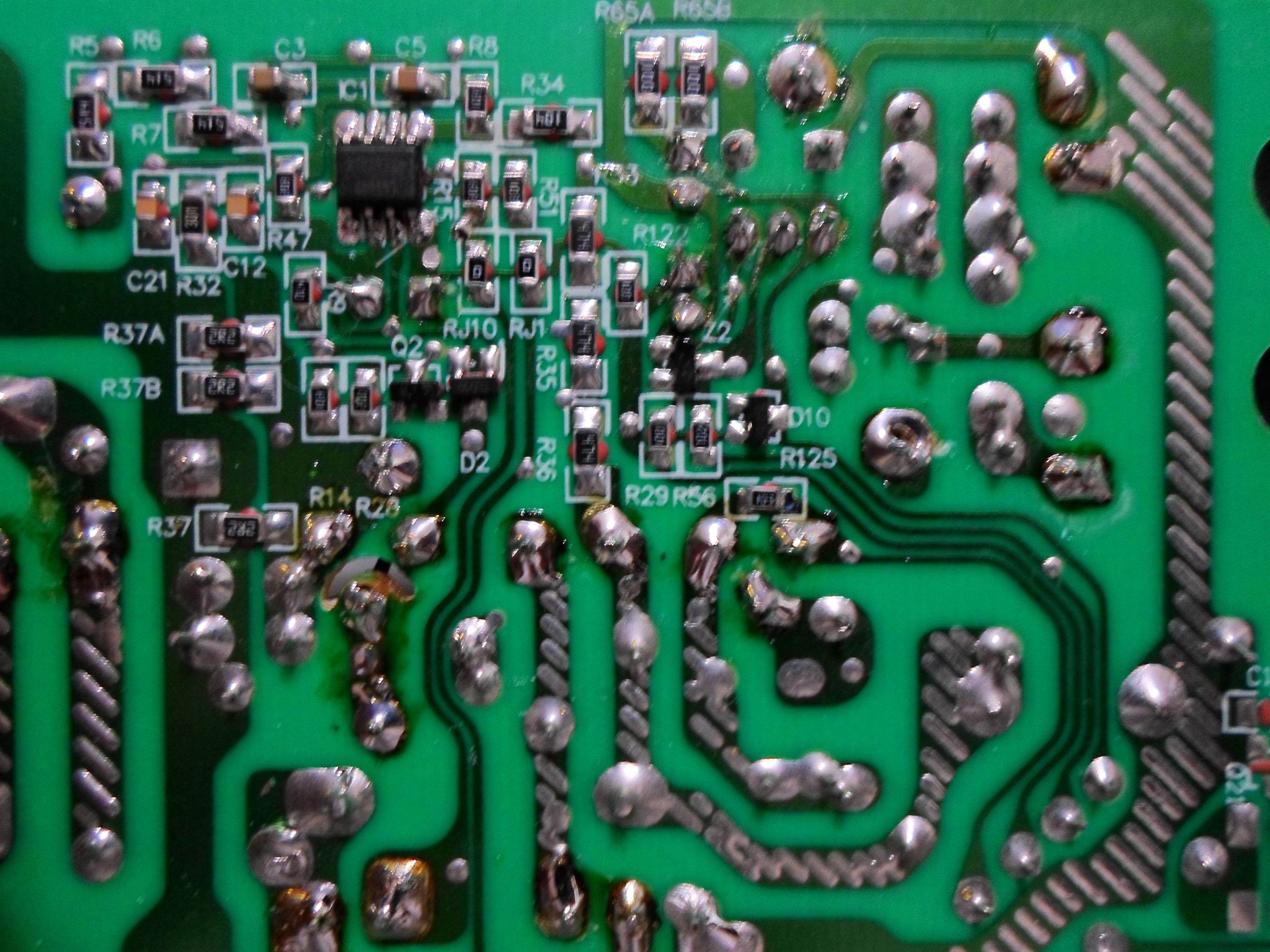

        OK, we need to trace out the VCC pin back to a switched transistor that get its B+ form the AUX winding of the 5VSTBY transformer.
        Can I get 1/4 section pictures of the bottom side of the board so I can slearly see the traces?

            Re: Akai LCT3285TA Power Supply Issues Unstable 24V
            Bud those pics good enough?
              Here's another closeup of that IC

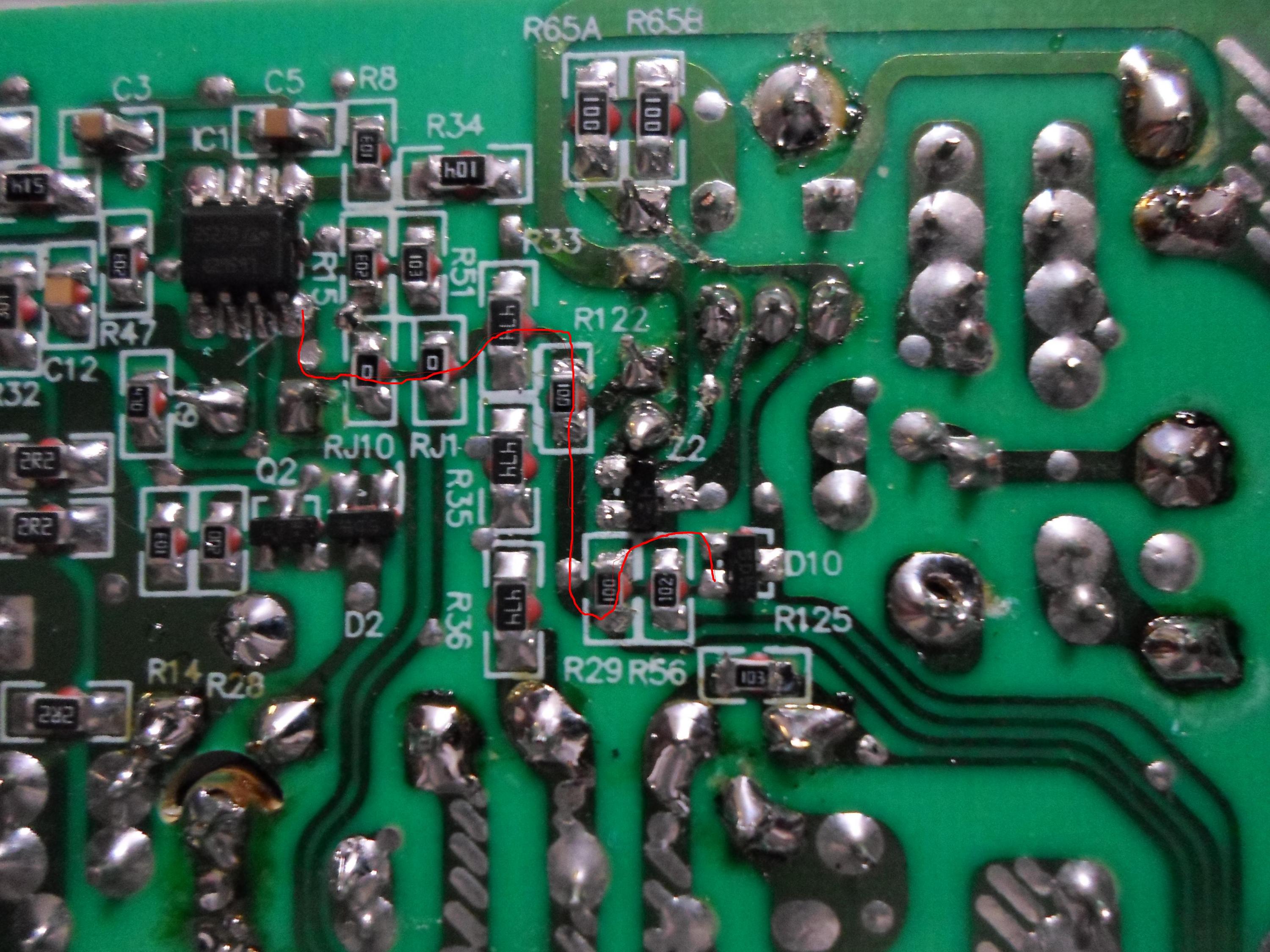

                OK I started tracing from VCC pin and it follows thru two 10 ohm resistors and then to D10. D10 tests good, but both 10 ohm resistors are open/very high ohms (in circuit). Do you think this is problem?
                  Seems to go to that 2N4401 transistor right above that was originally shorted and replaced. Would that be the transistor we're looking for?
                    Tracing voltage from transistor goes from 14.5V down to 8.5V through first 10 ohm resistor then to 0v through 2nd 10 ohm resistor. Should voltage be dropping at all through the resistors?
                      #30
                      Well resistors drop voltage according to V = IR
                      But two equal resistors with the same current should drop same voltage.
                      First drop = 6V
                      Second drop = 8V
                      So there is a disparity between the voltages, the only possibility being that the resistors are not the same. However, if th drop across the first one is truly 6V, it has I = V/R = 600mA! flowing through it, dissipating 3.6W (probably no more than 1/3W rated 1206)... which is not going to work well it would be clearly burning. So we can say that is not likely and it is more likely there is some other problem with the resistors maybe they are open or there is a measurement error.
                      I would look at the L65xx IC being bad, unless some of those resistors are open.
                        I replaced the 2 bad 10 ohm resistors and now have 14V to VCC pin. 24V is stable at 23.8V now, but still only have 161V across cap in standby, and 155V when turned on.
                        I did replace the L6562D before already aswell.

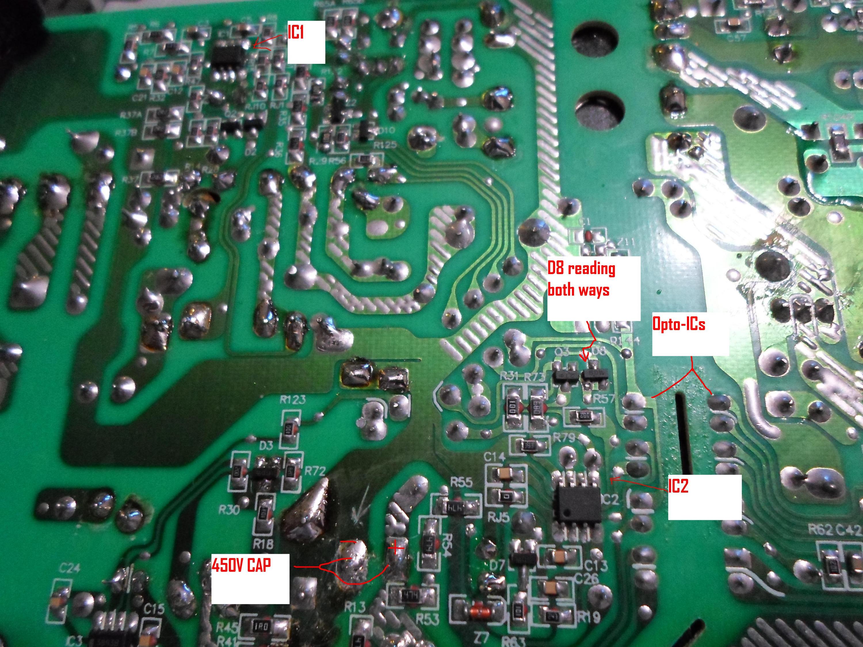

                          Thought Id try to trace BACK from the 450V cap, it goes to an IC2, cant read the # on the chip tho. The other IC was IC1.

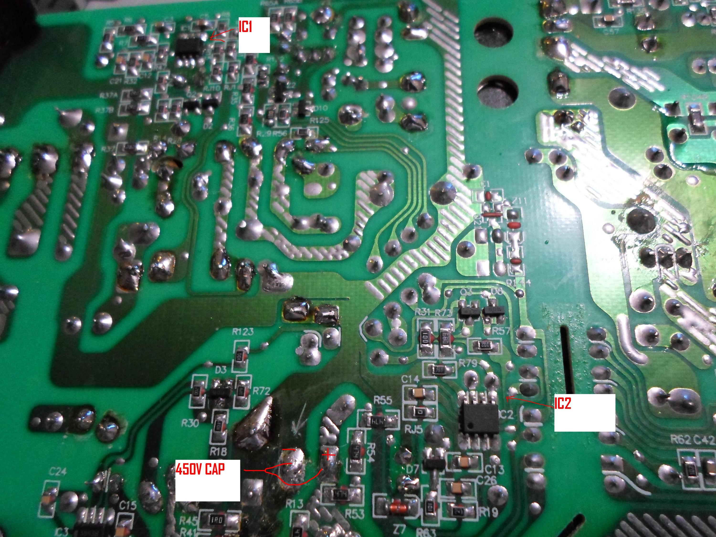

                            Cap location
                              More Info

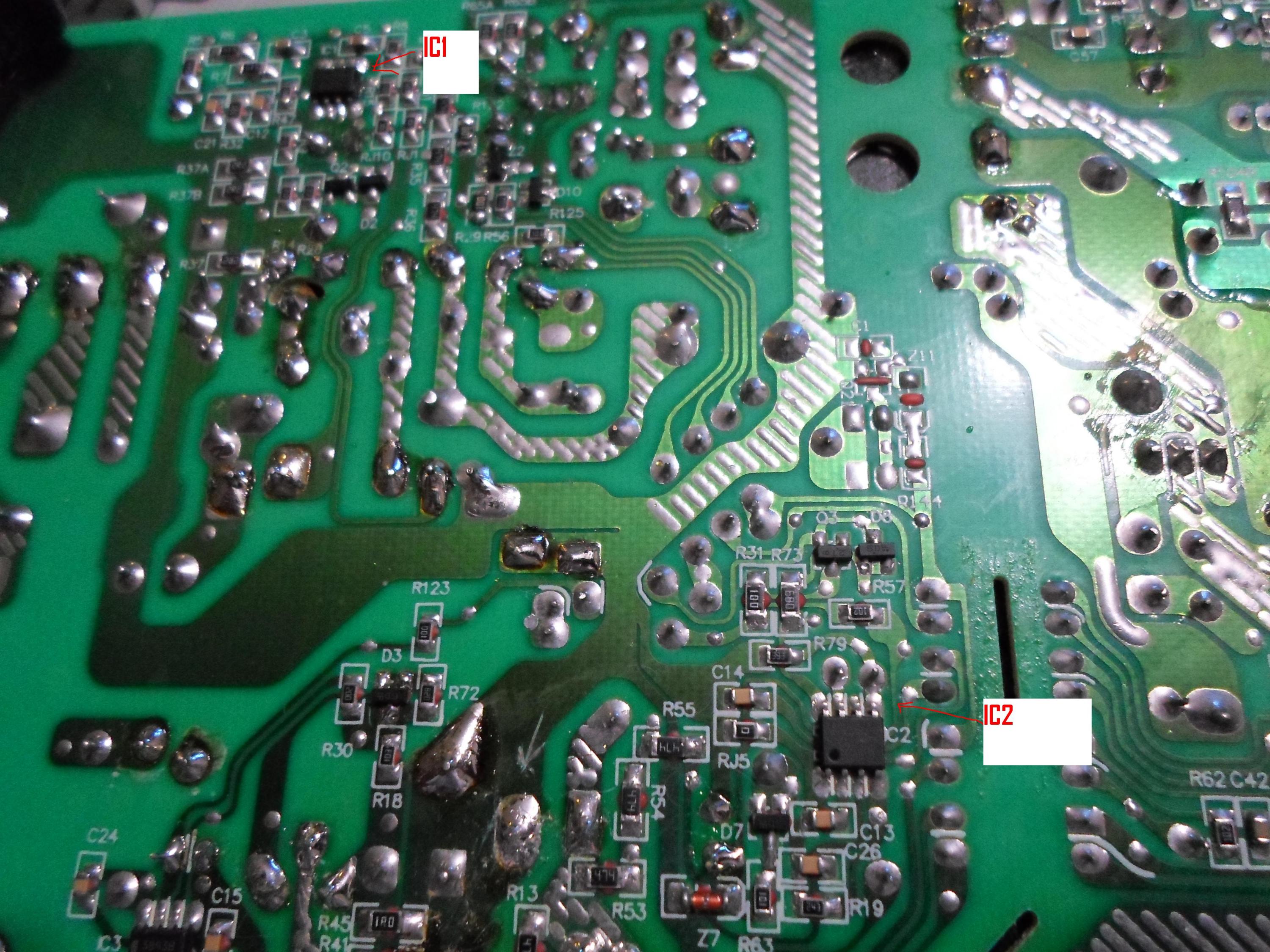

                                Eyes are hurting now but IC2 is a OB2268CP
                                https://cdn.badcaps-static.com/pdfs/...2d6a23c015.pdf
                                Current Mode PWM Controller
