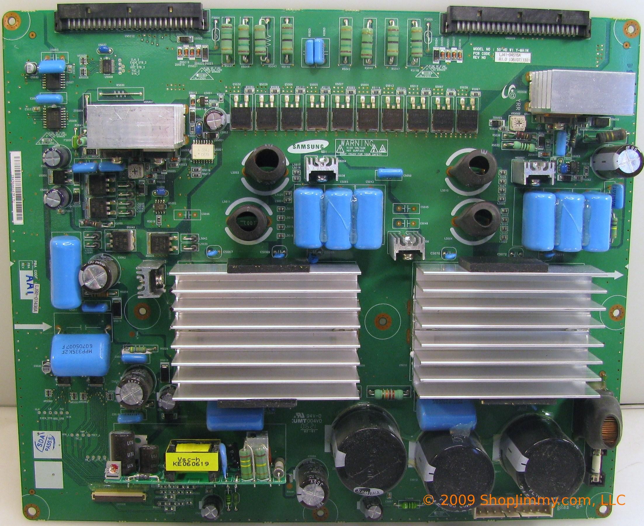

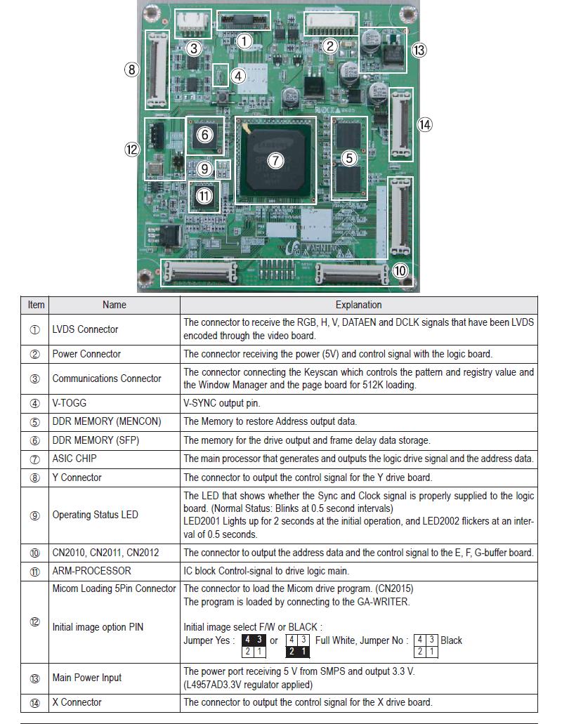

            Sounds normal, I think you may have that part number wrong though.
            Maybe have a closer check of the buffers for shorts and the xmain,ymain. The logic board could be detecting a fault and shutting it down.
            Could be mainboard but I'd check those others first in case there is something obvious you can find.
            Don't know much about these , a couple of snaps from the service manual below for checkpoints.
            The next generation panel which you can use the buffers from yours in, had a habit of shorting the upper buffer and blowing ymains.
            That's all I can guide you with.

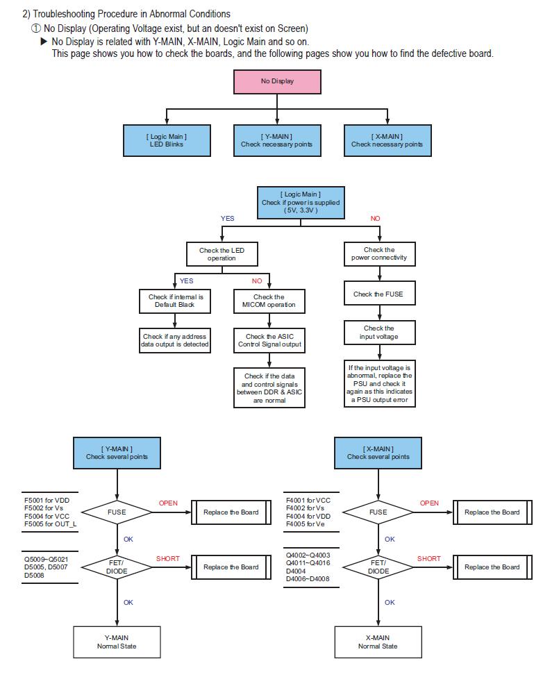

              on power on - green LED on LOGIC board is blinking at 1/2 second rate (normal).
              What I don't understand is the flow chart for checking the Y MAIN from the service manual on page 6-9 from service manual.
              On my set - I don't have F5004 or F5005 on the y MAIN. Also the FET/ DIODE numbering is incorrect ??
              I'm going to try to power up the test pattern today - let u know.

                Yeah, I've come across that before where the manual may not keep up with the revisions. I think I could spot 3 fuses in the photo with a wire link in place of one of those. I guess check what fuses you do have assuming it looks the same? the FETs and Diodes would most likely be all those SMDs.
                I had a Q7, same boards as yours which apparently had a blank screen but sound. I never could get it to fail but it does appear to be how this model goes, intermittent screen loss. I did reflow a number of joints on the ymain but like I say, it never failed. Maybe it was bad joints but I learnt nothing from that one as to what I did fixed it or what?? It was a very heavy TV, 2006/7 era.

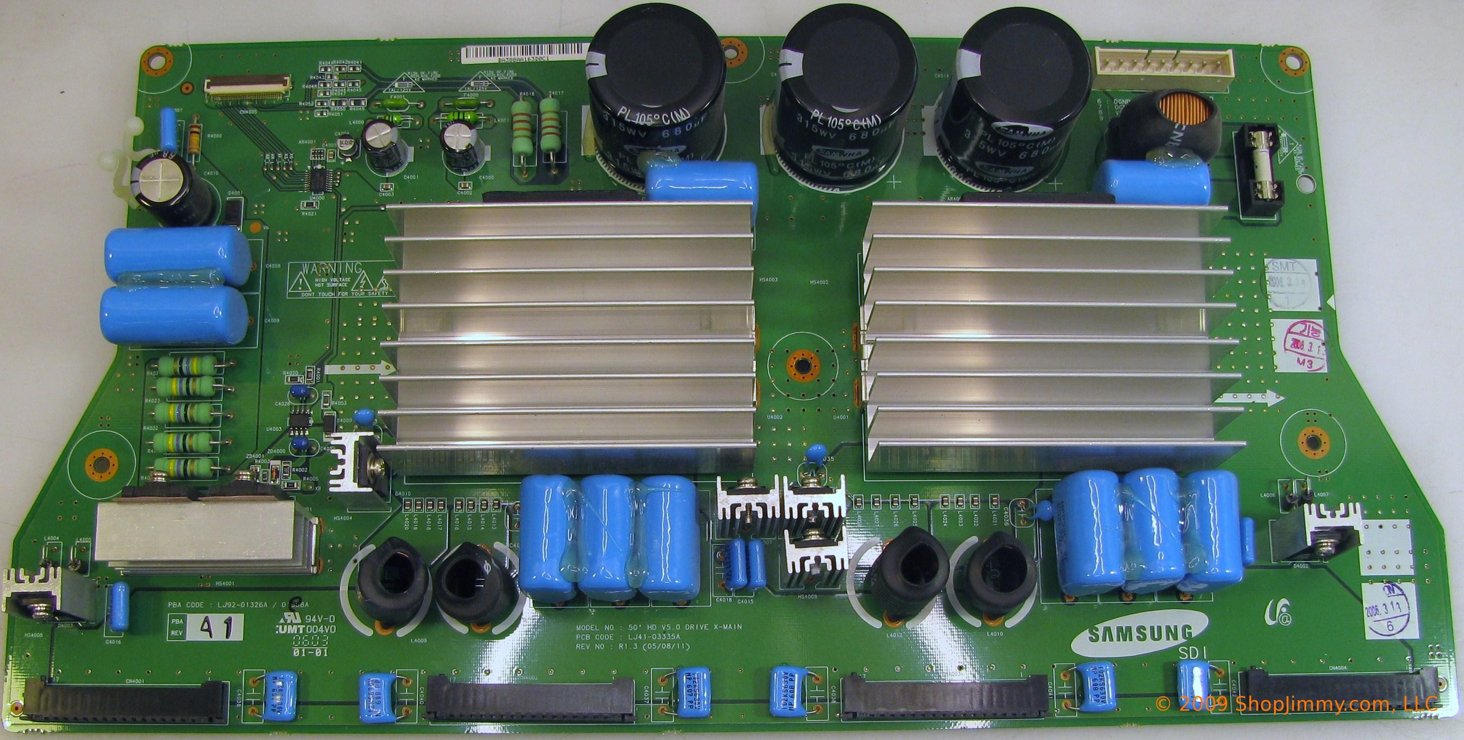

                  Y MAIN - Vset = +191.5 V, V scan = -186.8 V, Vsc-h = -177 V
                  X MAIN - Vs = +202 V, Vb = +111 V.
                  updated part #s: Y MAIN = LJ92-01436A / 01391B
                  X MAIN = LJ92-01326A / 01388A
                  voltages seem to check out - maybe Y Buffer board ??

                    with power on:
                    X MAIN can hear faint buzzing noise.
                    Y MAIN can hear very faint clicking noise.

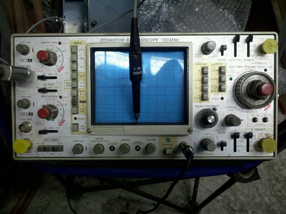

                        Is there a way to check y main board. Have a scope. Thanks
                          Re: HP-S5053 4 blue blinks - no video or audio
                          Yep, you will need a 10X probe and scope rated to at least 400V, 20MHz.
                          • ajshoe
                            ajshoe
                            • Dec 2012
                            • 477
                            • usa
                            whats easiest way to check if y main is functioning ? thanks
                              With the scope... If you post a picture of what scope you have and what probe you have we can see if it is capable.
                              • ajshoe
                                ajshoe
                                • Dec 2012
                                • 477
                                • usa
                                scope says 400V and 10X probe. pics attached
                                  That looks capable. Do you know how to use it? For example if I said set channel 1 to 10V/div and timebase to 10ms/div you would understand?

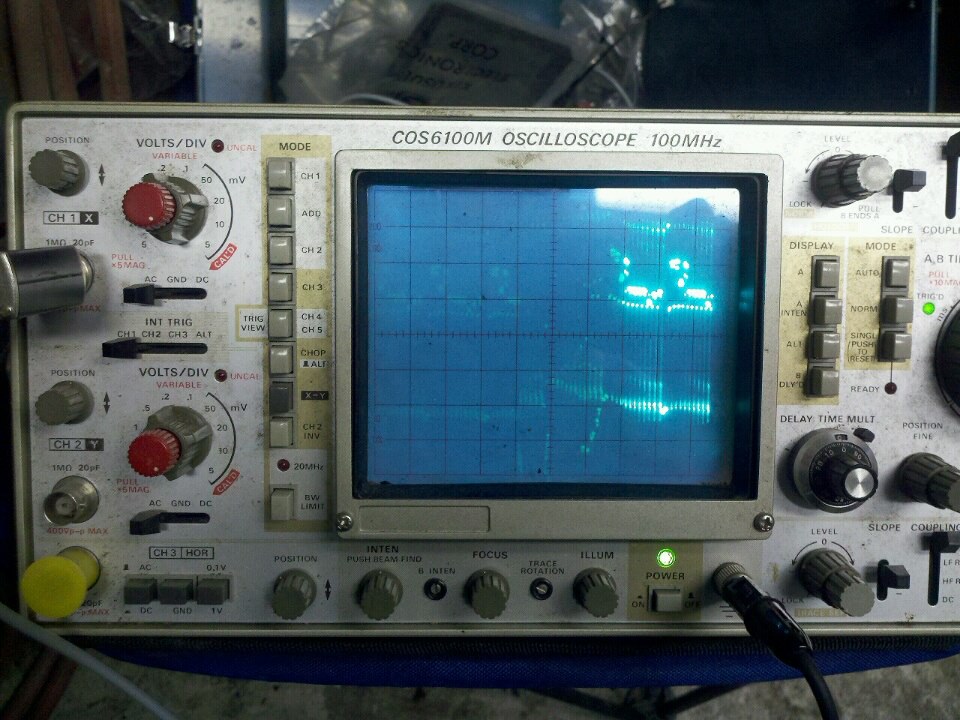

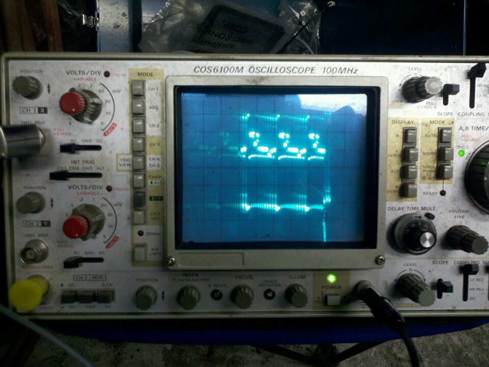

                                    used scope many times - I'm an retired EE. Been on vac - I will look into schematic today. I'm assuming the smd devices (big heatsink) are suspect

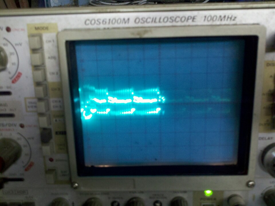

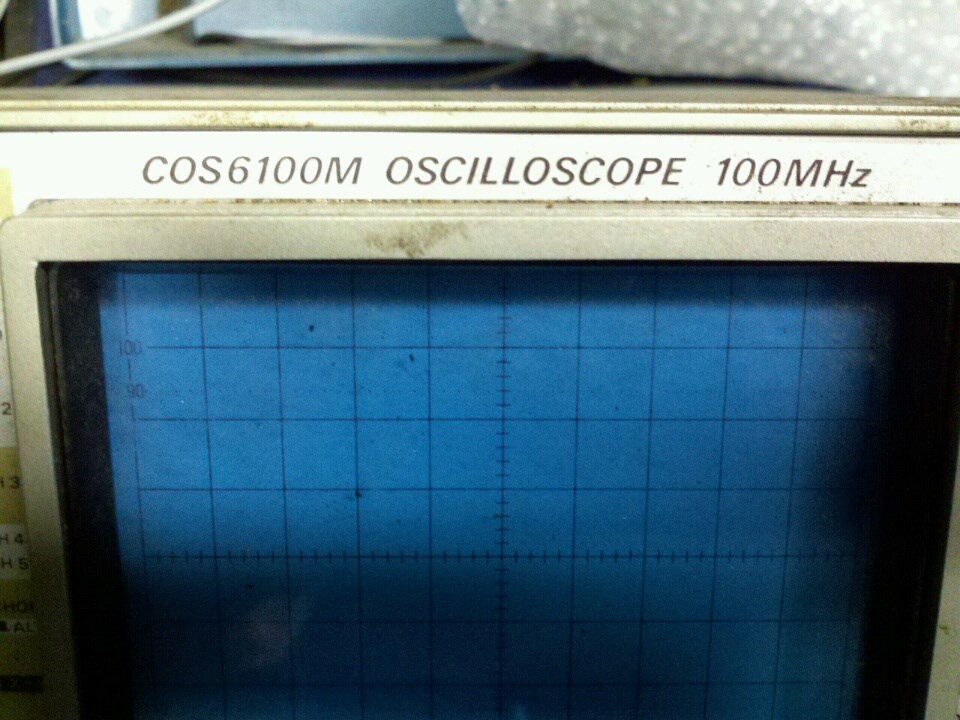

                                      OK, probe set to 10X if adjustable.
                                      Scope set to LINE TRIGGER (60Hz), 10V/div, 10ms/div.
                                      Connect to SOURCE of one of the SMD FETs in the long row Q5030 Q5029 etc. As highlighted.
                                      https://www.badcaps.net/forum/attach...6&d=1373190390
                                      Show us what you see...
                                      • ajshoe
                                        ajshoe
                                        • Dec 2012
                                        • 477
                                        • usa
                                        pic 1 - 2 volt / div
                                        pic 2 - 2 volt / div.
                                        pic 3 - 5 volt / div
                                        on line sync - couldn't get it to sync.
