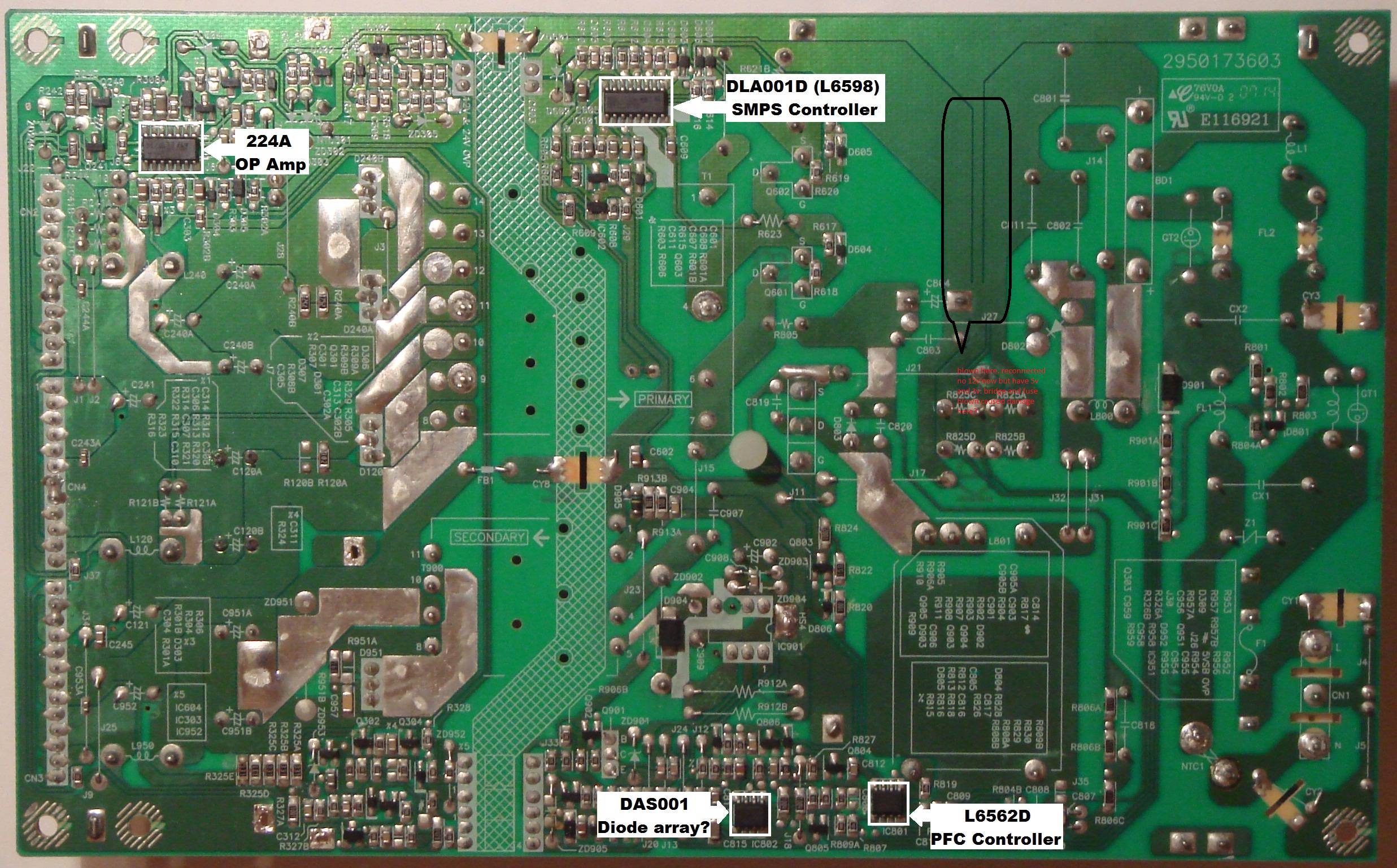

    got a vizio here with a bad trace on the bottom of the powersupply, several traces close need aq pic of the bottom side. if anyone has one or a schematic. looks like a shorted rectifier and blown fuse but I have no output till I jump the traces.

    ok, here is a pic of a supply I found the blown areas has been repaired now I have no 12v supply. the orange vizio logo no white. set not starting.

      think I got the pic this time,
