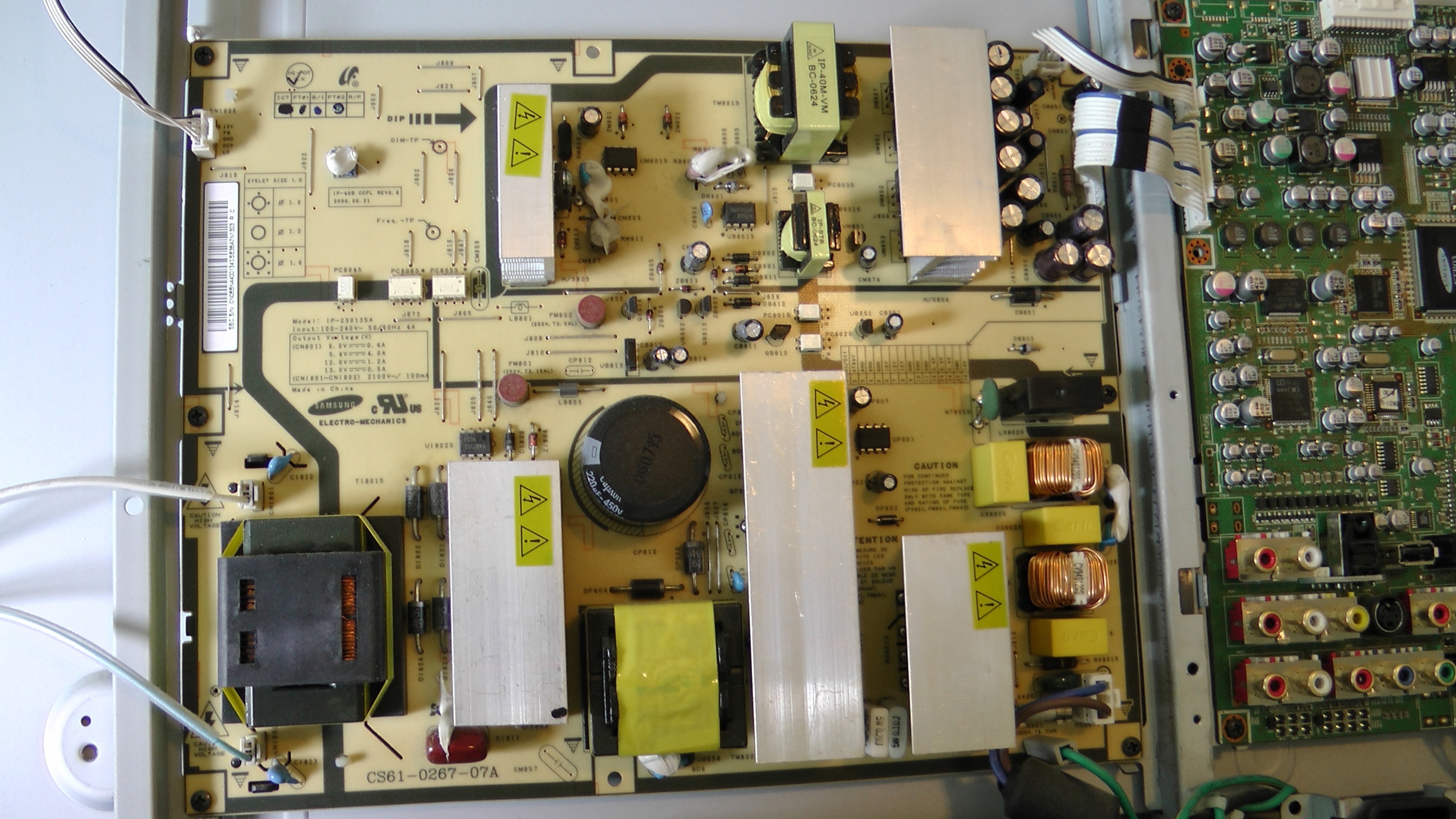

                I tried the TV this morning and the screen is blank, no backlight and sound is working. Now what?
                  Re: Samsung LED TV Model LN-S4041D intermittent loss of picture (sounds still works)
                  Take the cover off, and provide clear pictures of each of the boards in the TV.
                      Here you go. I do not see bulging caps anywhere.

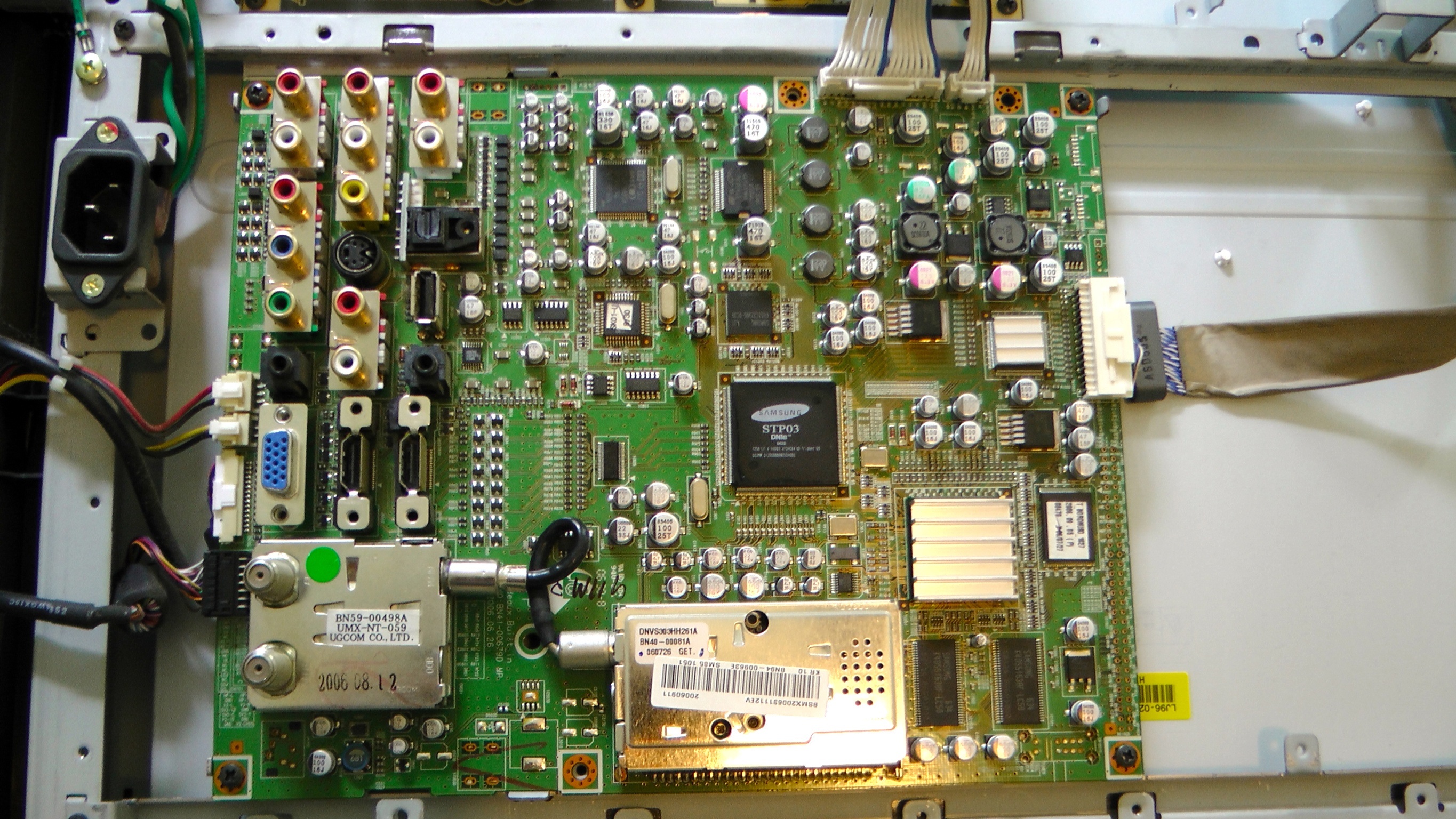

                        Second pic.
                          replace all secondary caps and resolder everything attached to a heatsink on that power supply.
                          that is not an led set either.
                          i see these often.
                            Ok, thanks. All the can style caps or the others also? Should take any readings prior?
                              I tested all the diodes and transistors in circuit. DB851 and db803 appear bad (both directions). Could those be the cause? I am looking for a schematic for the BN44-00134D. Thanks again.
                                Intermittent would be unlikely to be caused by a permanent failure.
                                Schematic of PSU if it's any help:
                                  You were correct tom66. The replacement diode did not fix anything. Should I test the voltages prior to changing out. All the caps? Thanks again.
                                    Yes, check all the voltages on the output side, in particular check the backlight on/off signal CN1803 pin 1.
