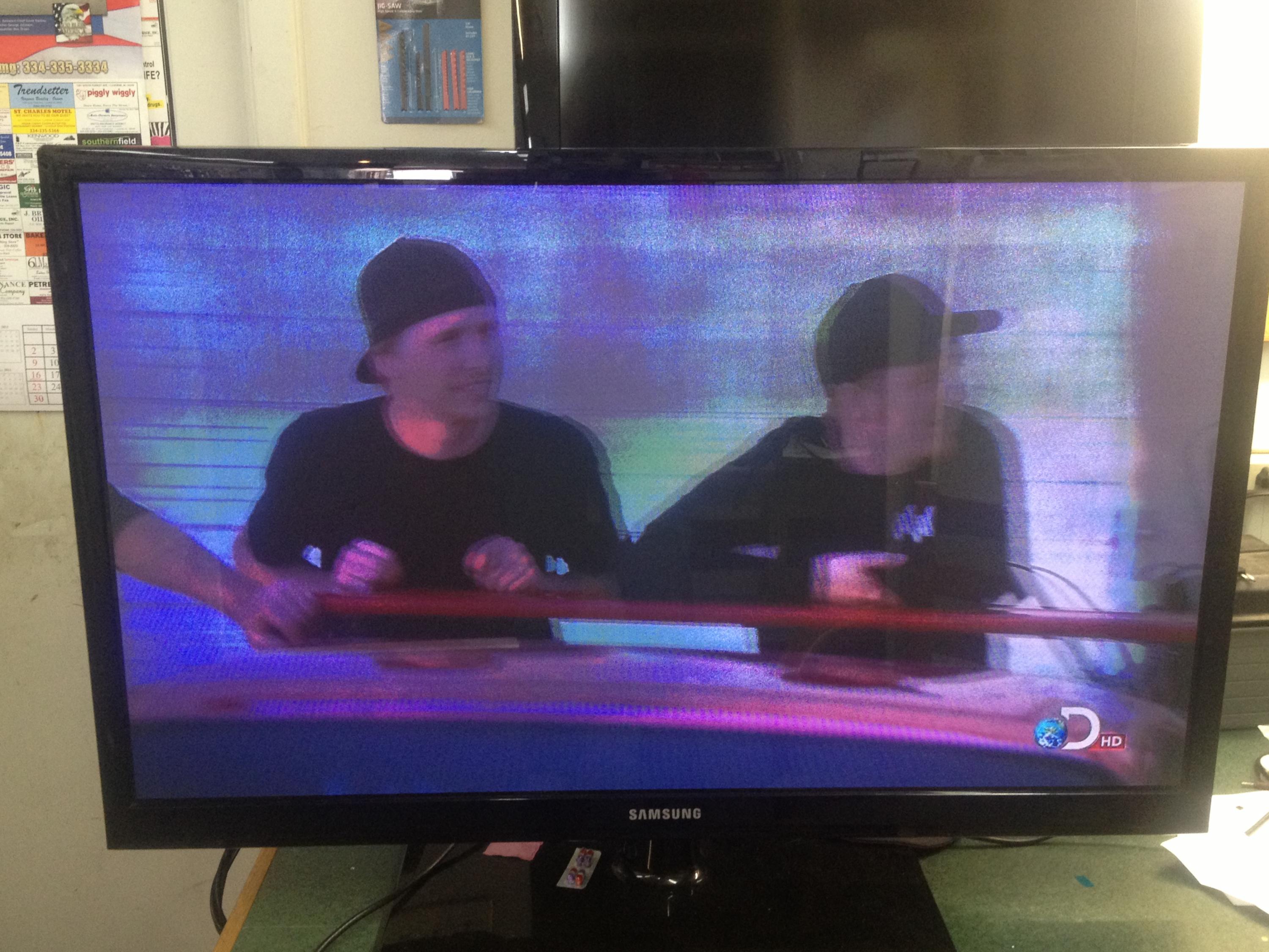

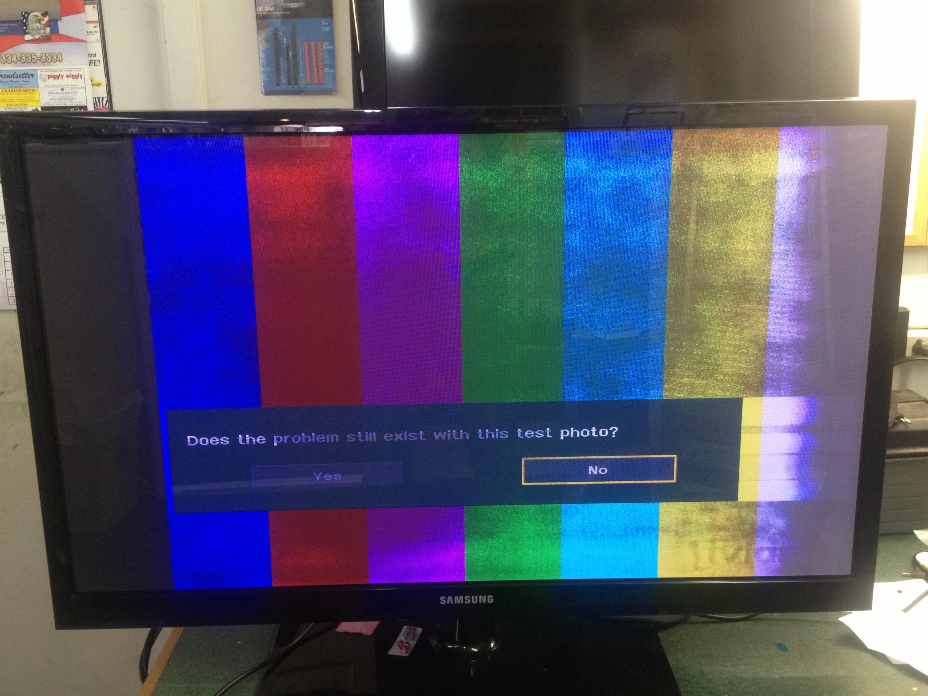

    Samsung PN43D450A2D Picture is Distorted
    My Samsung PN43D450A2D has a distorted picture. If there is no motion on the screen it looks good. Sometimes you can see the previous channel bleeding through. When I received the TV it would not power up. I have repaired the X-Main board and upgraded the firmware to the 1006.6 version. I have uploaded a couple of pictures.

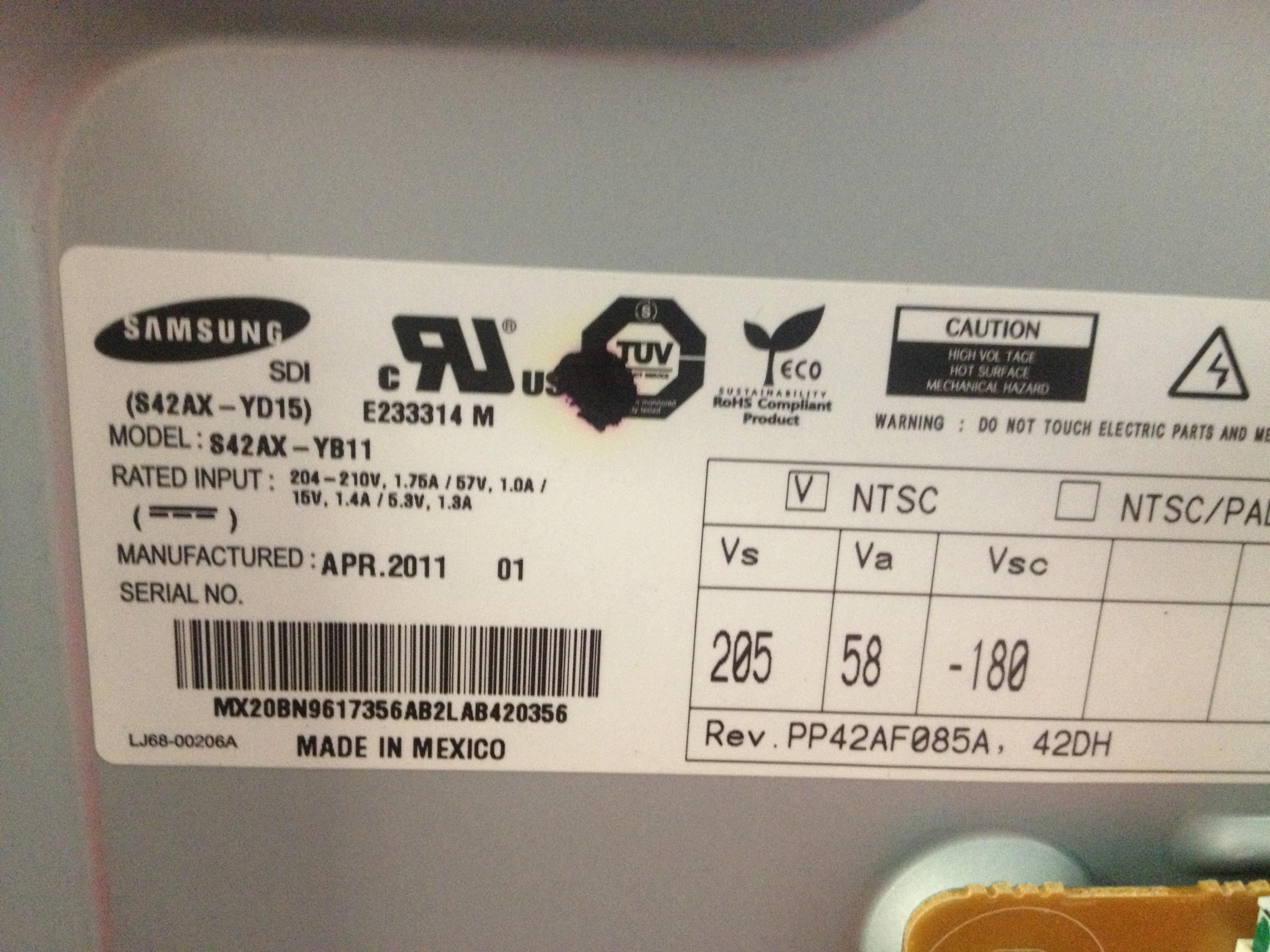

    Re: Samsung PN43D450A2D Picture is Distorted
    On the back of the plasma panel (inside the TV), there is a sticker with Vs, Va and Vsc written on it, near SAMSUNG logo and part #. What does it say?
    • pc_doc_al
      • Jul 2012
      • 45
      Vs 205
      va 58
      Vsc -180
      PP42AF085, 42DH

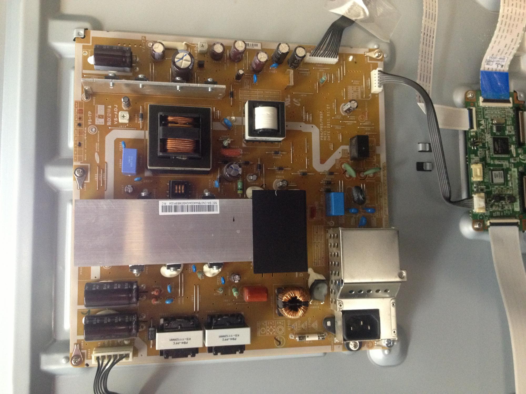

        OK, there are various test points on the power supply for checking these voltages. You will need a digital multimeter, do you have one?
            Can you post a picture of the power supply board?
              Here you go.

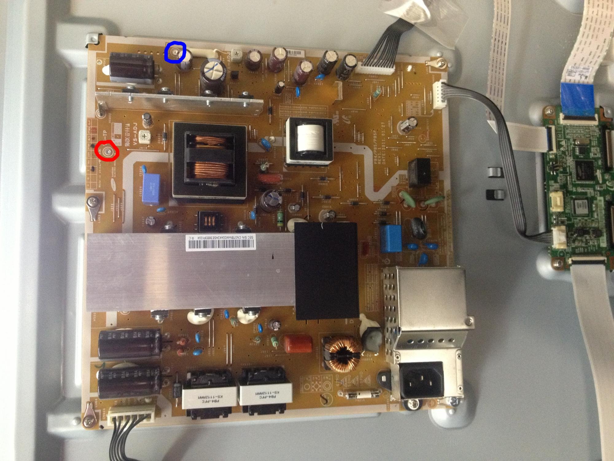

                OK.
                Set your multimeter to the highest dc range.
                The black probe should be placed on the chassis somewhere.
                The red probe should be placed on the red ringed point, the measurement recorded (Vs), then move to the blue point and record the measurement (Va).
                  red (Vs) 204
                  blue (Va) 57

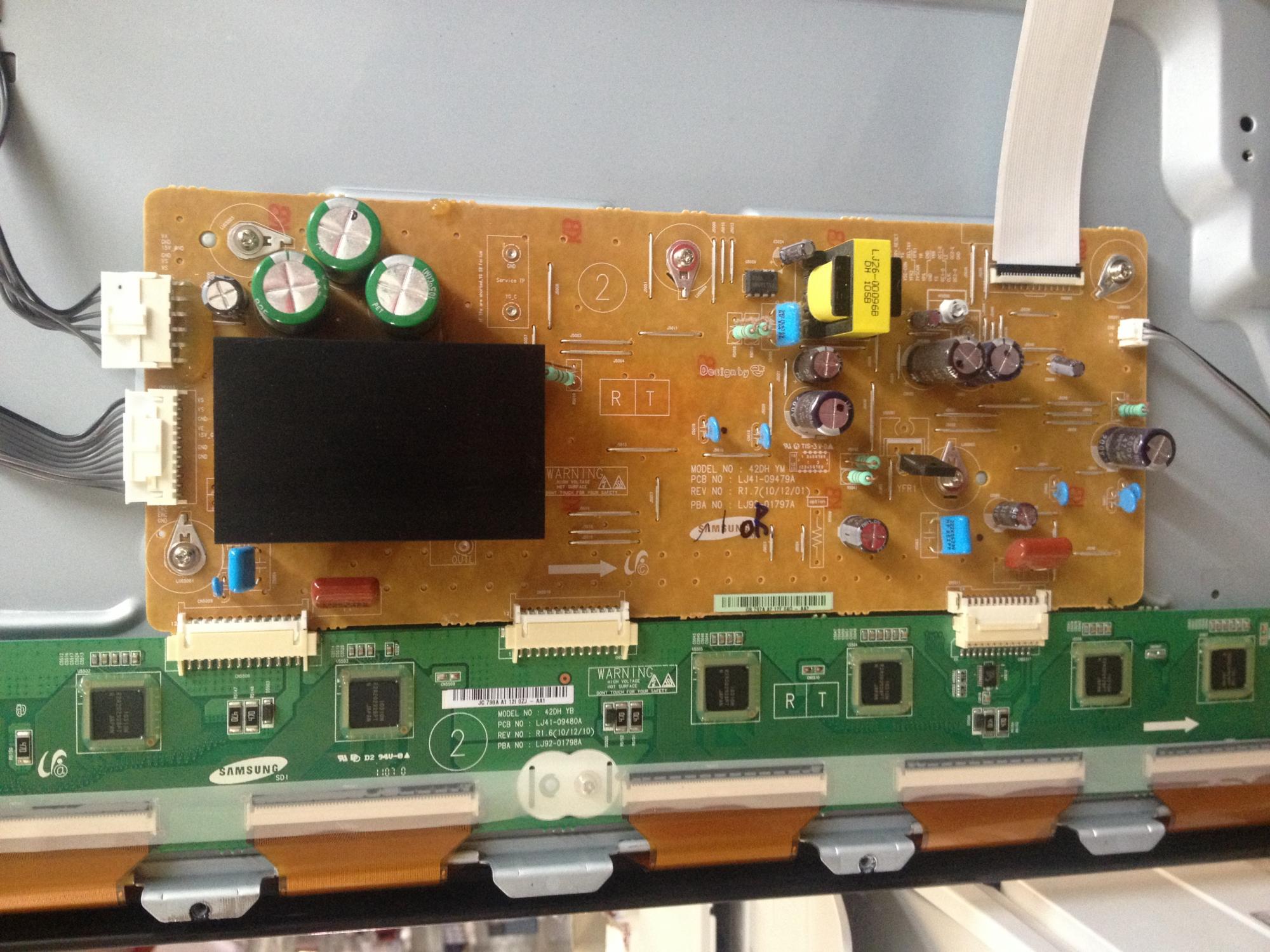

                    Close enough. Can you provide a picture of the Y-main board? This is on the left hand side of the TV, looking from the rear.

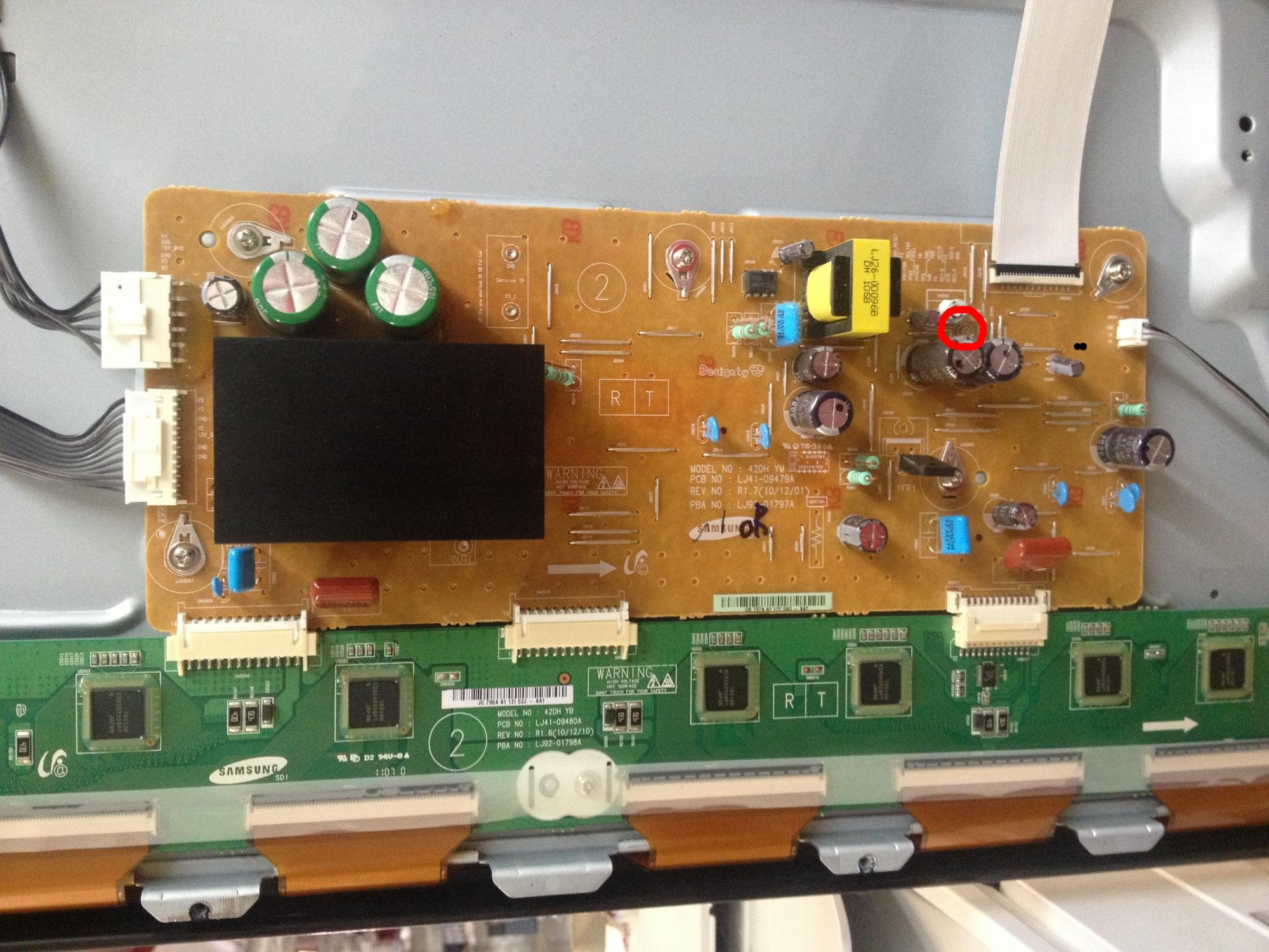

                        OK, here is where to test VSCAN (Vsc), test in the same way as Vs/Va tested.
                          Ok I will post it tomorrow.
                            It reads -178 (negative)
                              Close enough, then. Do you see any points for Ve? I am thinking your new X-main is defective but I'm not certain.
                                it reads 90
                                  Although that is not specified, it sounds about right for this panel. I would consider replacing the X-main again; if not, there's a possible problem with the control board.
