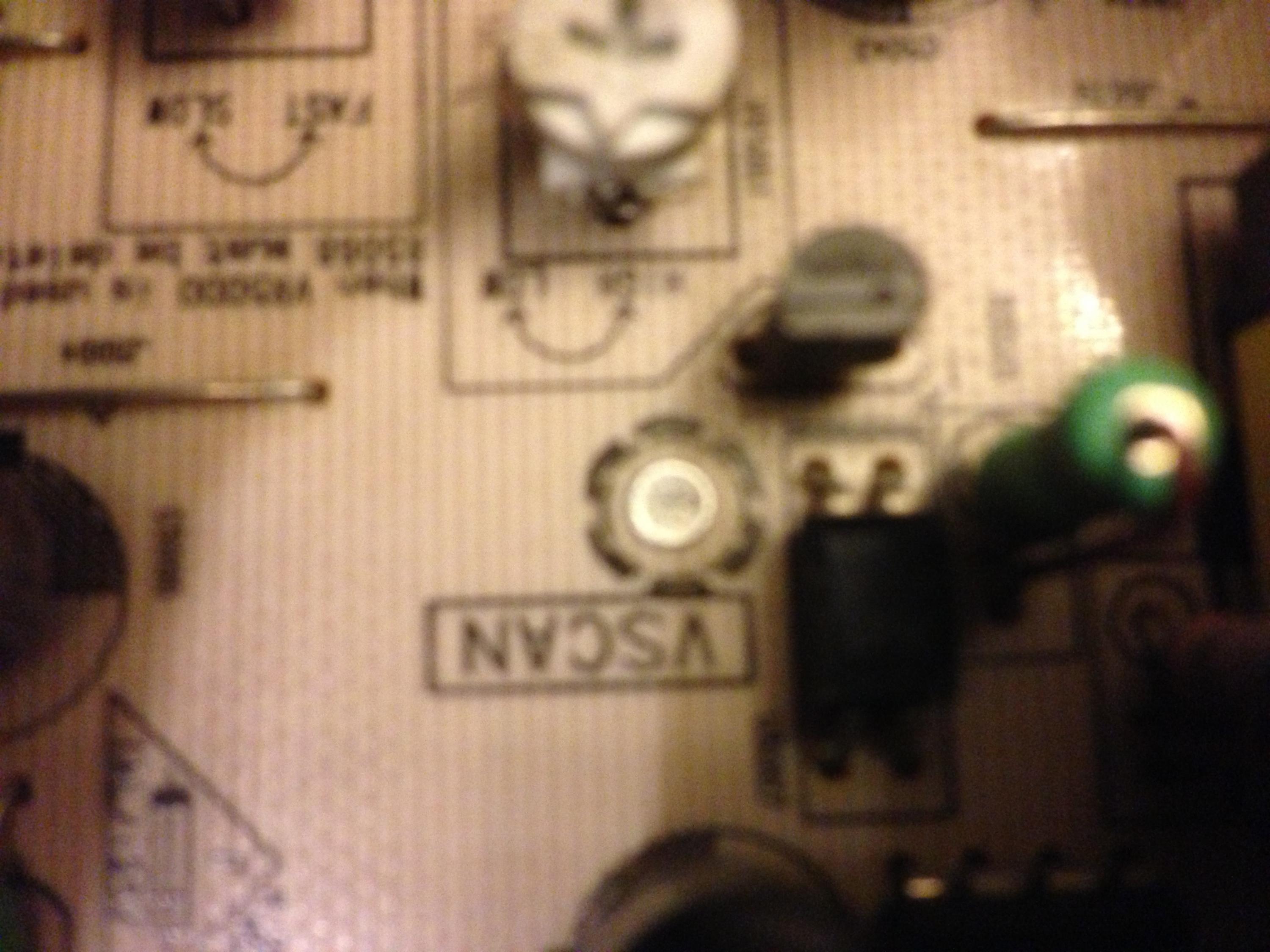

    OK, you found a fault!
    Please unplug the buffer board and see if the readings settle or if they are still bad.

      Excellent, Thanks for helping i feel we are making progress
      Removed buffer and powered up still 9 volts on VSCAN and VSCH same jumping around 40v mark as before
        Re: Samsung PS42A410 has sound but no picture
        So you probably have a bad Y-main board and maybe a bad Y-buffer.
          So. When checking SMPS voltages you have the standby voltage and the 15 CDC but no high voltage?
          There are feedback voltages to the SMPS. Turn off power, wait several minutes for capacitors to discharge. Use your DVM and check for a short across the HV dcv input to the Y or SC. Board. If OK check for short on the Z board. Once the faulty board is located, it can be trouble shooted to component level.

            There are no shorts on the Vs on this panel as there is 208V going to the Y-main, so detailed analysis of the Y-main is necessary to determine where the fault is.
              Thanks so much guys
              Ok I checked the buffer And there doesn't seem to be any shorts
              I did find something strange the VSCAN solder tab where I tried to measure the voltage from that was showing 0 volts goes to ground
              Here's a picture from the solder tab labeled VSCAN on the Y board
                Yeah, the 0V there is bad.
