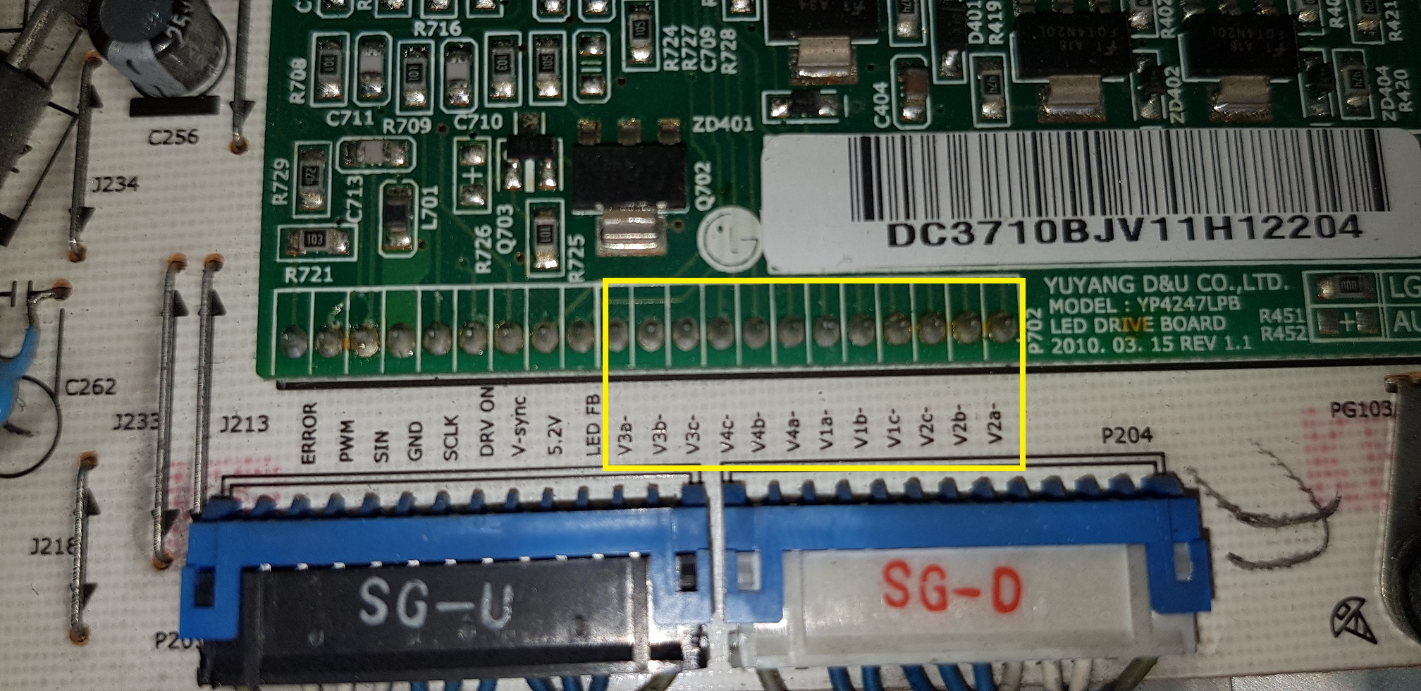

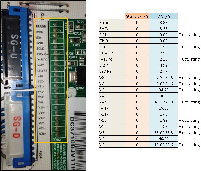

Are these Voltages measured with ref. to chassis GND?
You have 12 LED strings and 12 LED controllers circuits.
If the readings are done with ref. to chassis GND, then it looks like you have some bad LED strings.
BTW, the readings are missing on this one: https://www.badcaps.net/forum/attach...9&d=1519575672
There are 24 pins but you only show STBY condition of only 12 pins and only 12 pins of the ON condition.Last edited by budm; 02-25-2018, 07:36 PM.Never stop learning

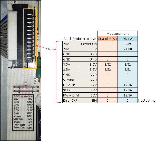

https://www.badcaps.net/forum/attach...0&d=1519575672
Yes, i measured it with ref. Chassis.
do u know are the measurements voltages correct?
u mentioned about the 12 LED Strings/Controller circuits,
are they the likely root-cause for the failure...?Comment
Re: LG 42LE4500 No display
So far it looks like some of the LED strings have have high resistance which are probably due to bad LEDs.Never stop learning

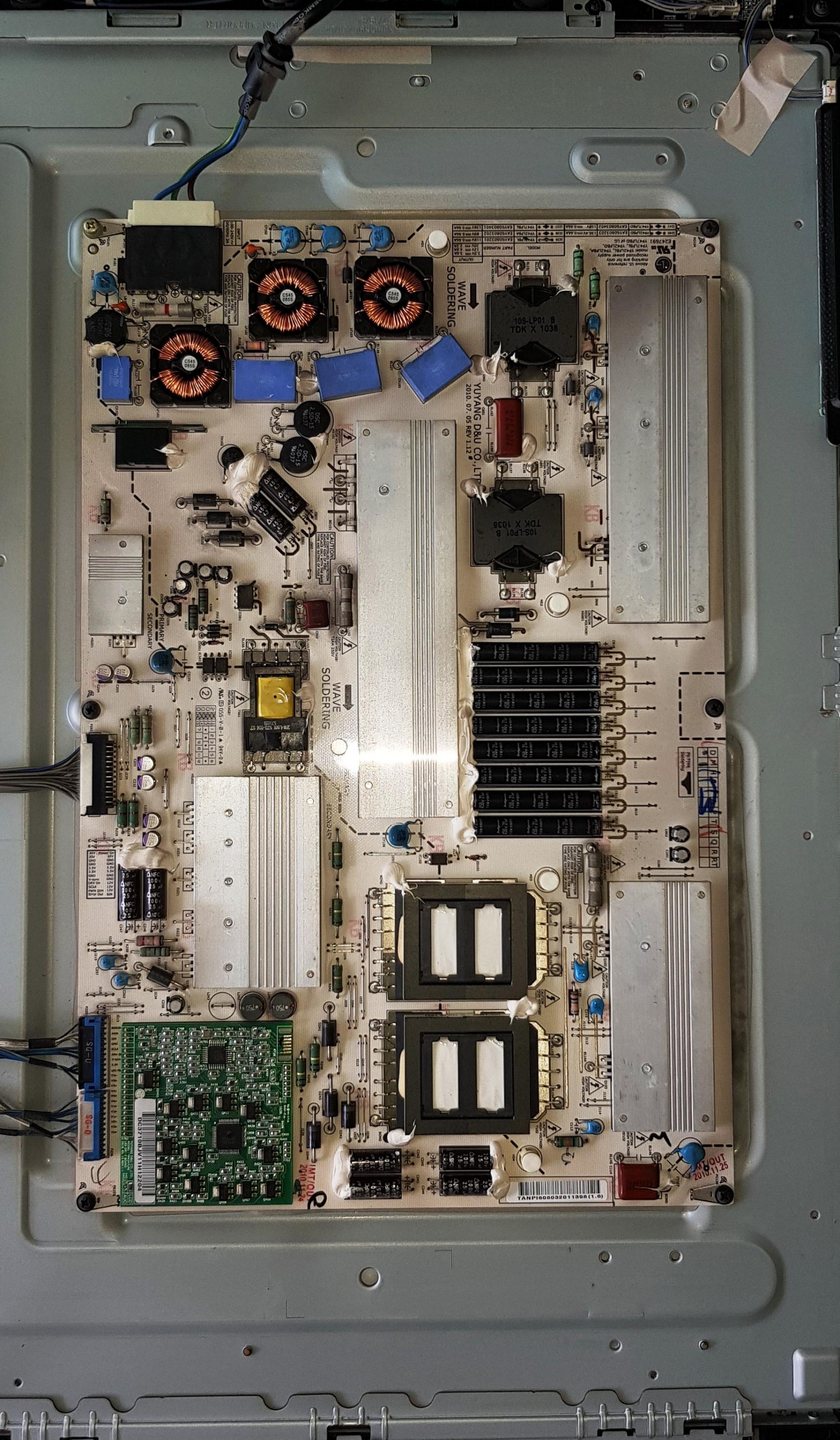

If I were you I would get one of those LED backlights tester, it is worth having one just to give you some idea if some of the LED strings have open circuit or not.
Youe LCD panel for your TV version looks to be made by LG, not AUOP as used in other version of the same model.
There is sticker on the LCD panel model so you can look up and see what kind of LED strips are used in your panel.Last edited by budm; 02-25-2018, 08:00 PM.Never stop learning
