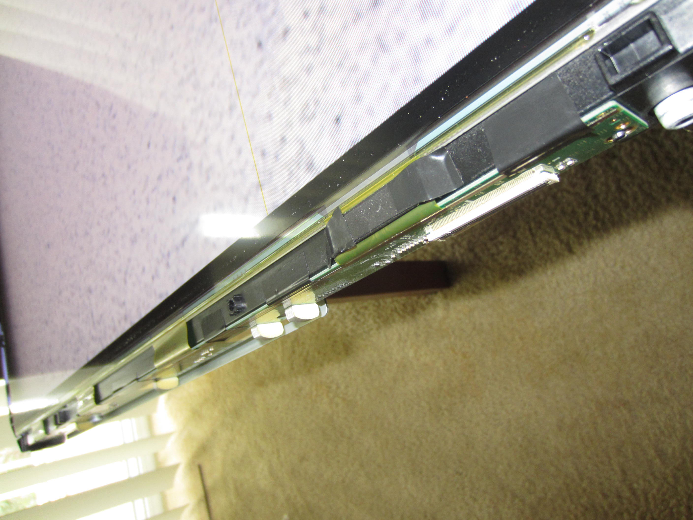

          So I got it all apart last night, man that was a pain. Lots of screws. It was hard to keep track of them all. When I was done putting it back together, I only had 4 left over!! hahahaha
          I found the faulty tab. Once it was apart it was fairly easy to determine which one was bad. I found that it was EXTREMELY sensitive. If I just put the pads on this TAB bond, I had 2-5 very skinny veritical lines through the screen. If I did not put pressure at all, I had the same symptoms as before where the colored vertical lines are on the right 1/3rd of the screen.

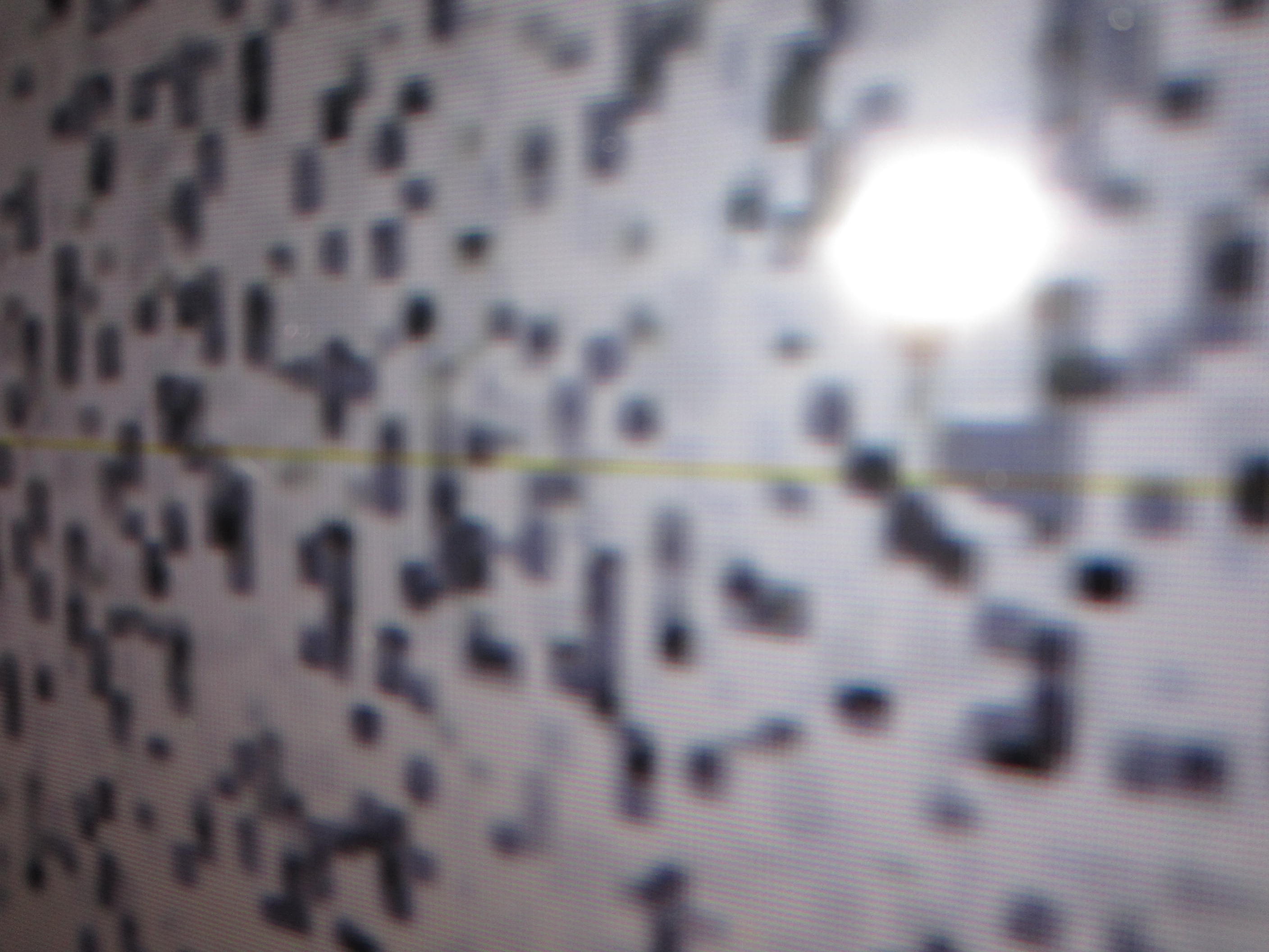

          In the picture below you can see the skinny vertical lines and the large colored vertical lines on the right 1/3rd of the screen. This was my first attempt at reassembly.
          Heres a picture of the foam pads I used to put pressure on the TAB bonds.
          On the one that was EXTREMELY sensative, I used electrical tape to hold the TAB bond in the perfect position that did not put pressure on the bond itself, but laid it flat so it made a good connection.
          It was working for an hour or so after I finished and then I went to bed. I hope it continues to work!!!

              Hi Skienstein,
              First off, YES the tv is still working great. I actually watched two movies last night on it. It gets used every night for atleast 2 hours minimum. If I had to guess, I have atleast 40-50 hours on it since the repair.
              To answer your questions, I used a vinyl foam tape similar to the one in the link below. I had some of this stuff laying around and since I had my TV all a part, I was impatient. It is rated to 200 deg F, which at the time I thought should be good. If I had to do it again, I would use the silicone pads and have the peace of mind that what I used was rated to a higher temperature.
              The tape I used that is similar to the that in the link, has an adhesive side and I was able to stick it directly on the tab bond itself. Once the TV is assembled together, The metal frame presses on the foam pad, which puts a little contact pressure on the tab bond ensuring good contact.
              One thing I had to do for my uber sensitive tab bond was put a piece of electrical tape on the bond, then I put the foam tap on top of the electrical tape. I talked to a local TV repair guy who said he has had some success with superglue although I didn't really like this idea.
              I think the idea is that you have to make these bonds contact when they come a little loose.

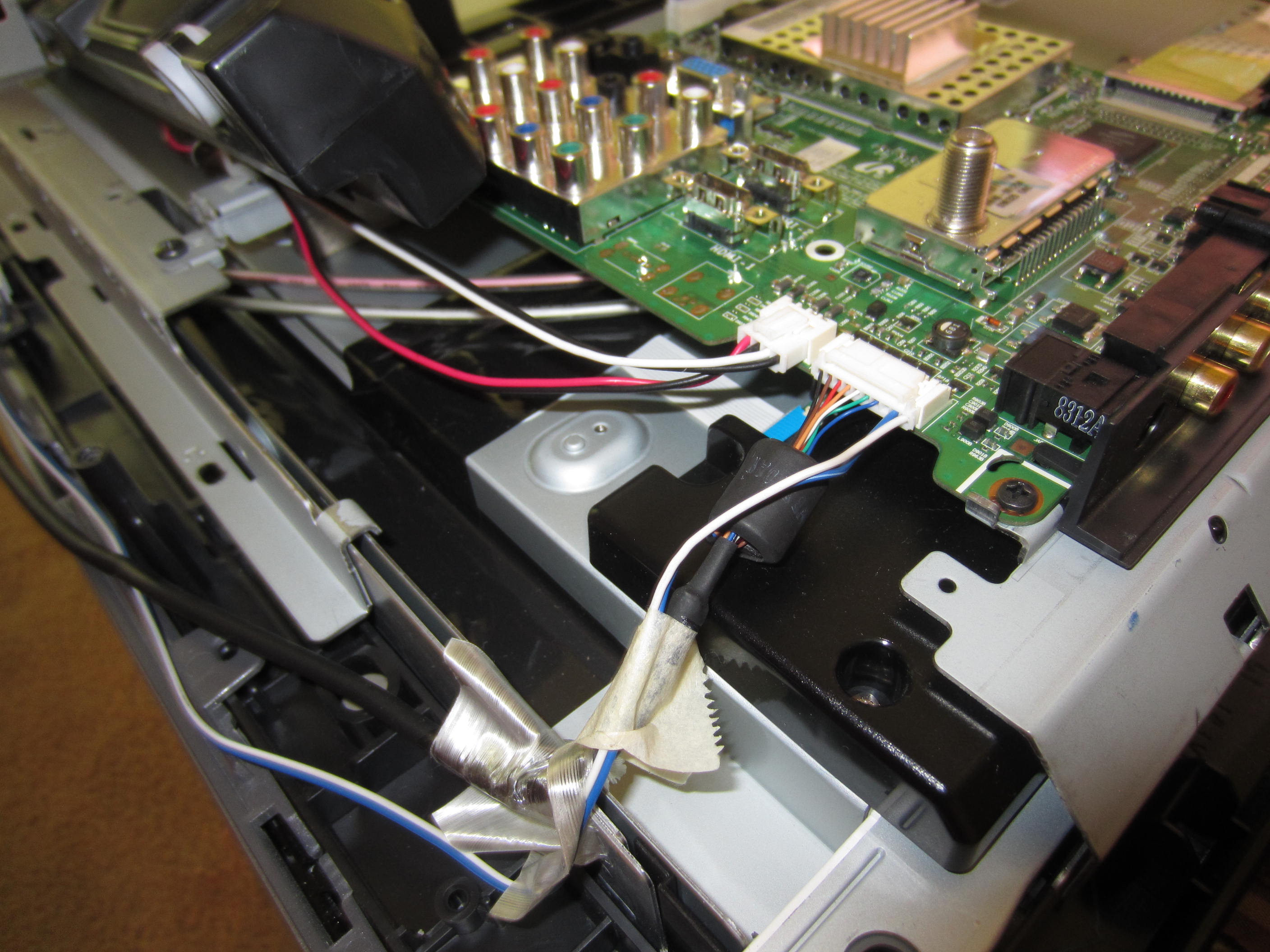

                          Hi again. I'm almost done removing the bezel but i'm stuck with these wires. they are connected to this board and i can't remove them.
                          Also, once i remove the bezel should i turn the tv over to work on the tab bonds and also be able to see the picture better?
                          Thanks again and again. lol
                            Re: Samsung LN52A550 Vertical Lines on 1/3 of Screen
                            Press clip down, pull cable out -- don't apply too much force and don't tug on the wires.
                            You should work on the tab bonds from the top, looking at the display panel.
                                    Can we see a picture of the issue?
                                    • skienstein
                                      • Jul 2013
                                      • 16
                                      thanks for the help tom66!!!!
                                        I'd try reseating the bonds but it might not be possible to get rid of that line if damage has been done to the bond :/. You can see in one of deborn3's pictures that they had an issue with stuck vertical lines, and reseating the bonds further fixed it. Just be very careful not to damage the bonds or screen.
