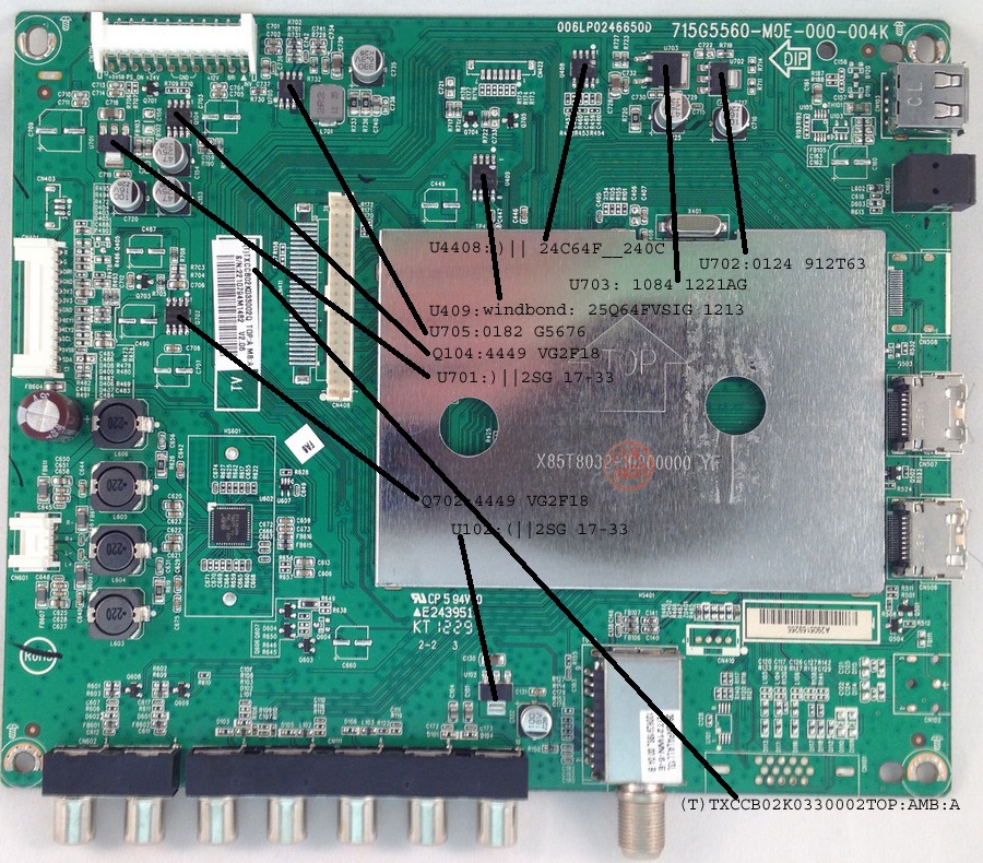

                          TEST RESULTS
                          All readings are DC vs except where noted. All eeproms ON THE BOARD are upside down. So I flipped them over on paper and started the readings from the pin at the top left. The pins with white dots are all, therefore, bottom row left end.
                          I'm listing the ics starting at the ic at the top right, going counter clockwise ending at the ic at bottom center of the main board. See photo for more info.
                          U702
                          TAB: 1.2
                          L: 0
                          M: 1.2
                          R: 3.27
                          U703
                          TAB: 3.27
                          L: 2.03
                          M: 3.27
                          R: 5.27
                          U408
                          3.27
                          3.26
                          3.26
                          3.26
                          WD: 3.26 (WD = white dot)
                          2.51
                          3.27
                          0
                          U409
                          3.27
                          3.27
                          2.5
                          2.5
                          WD: 3.27
                          2.52
                          3.27
                          0
                          U705
                          4.65
                          .57
                          1.2
                          1.2
                          WD: 12.2
                          12.3
                          12.3
                          12.3
                          Q104
                          12.23
                          12.36
                          12.36
                          12.36
                          WD: 0
                          0
                          0
                          0
                          U701
                          TAB: 3.28
                          0
                          3.28
                          5.21
                          Q702
                          5.22
                          5.22
                          5.22
                          5.22
                          WD: 5.22
                          5.22
                          5.22
                          28.0mV
                          U102
                          TAB: 3.28
                          0
                          3.28
                          5.21

                              Re: vizio E320-A1 not working
                              Post 89 #5 "5) Or get EEPROM (u409? or U403? due to more than one version of the main board) from shopjimmy or main board repair kit."
                              Go to shopjimmy .com and type in your TV model number and then which main board you have, shopjimmy shows you how to get the correct main board P/N thewn look at all the EEPROM replacement for you board number so you can locate the EEPROM part designator it may be U403 or U409, once you know which U that is then look at the printing on top of the IC and search for the spec sheet for that EEPROM so you can see which is what so we can probe the correct pins of the EEPROM. Without know the EEPROM number to get the spec sheet then you will not know which pins to test..
                              So get the correct P/N of your main board first.
                                #95
                                BTW, if it turns out to be bad EEPROM or bad regulator, what are you going to do next since you do not have the tools to do SMD repair or any experience doing SMD works?
                                  #96
                                          Is this your board, Vizio 756TXCCB02K033 Main Board for E320-A1?
                                          http://www.shopjimmy.com/vizio-756tx...r-e320-a1.htm#
                                          If it is, then I suggest you to buy the repair kit:
                                          http://www.shopjimmy.com/vizio-756tx...or-e320-a1.htm
                                          The kit is for fixing the following symptoms:
                                          SKU: sj-756TXCCB02K033 Repair Kit
                                          Part Number: 756TXCCB02K033 Repair Kit
                                          Warranty: No Warranty
                                          TV Brands: Vizio
                                          Specifications: Kit Includes
                                          Part 1
                                          Symptoms:
                                          -TV turns on (White LED is on) but there is no backlight.
                                          - TV will not turn off once it’s on.
                                          Description Quantity Board Location
                                          Integrated Circuits 1 Included With Kit
                                          Part 2
                                          Symptoms:
                                          - TV will not turn on (power indicator LED is off)
                                          Integrated Circuits 3 Included With Kit
                                          So if it is matched your problem then this should fix it.
