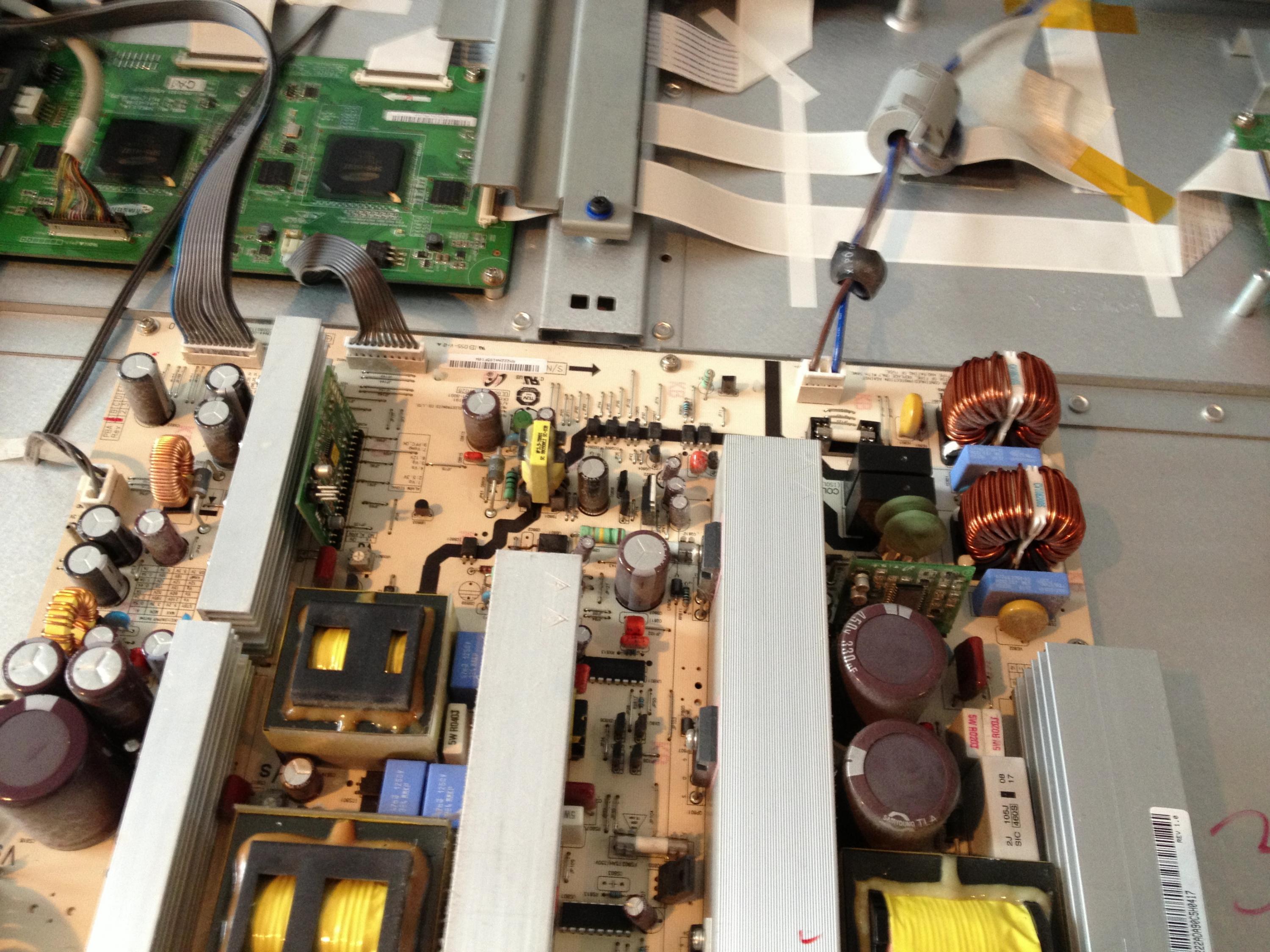

                    Re: Samsung model PS50A556S2FXXU TAKES LONG TO TURN ON
                    Originally posted by digge
                    As you say it sure could be a bad cap, but might be a bad solderjoint or something else as well. I would recommend taking as detailed pictures as possible of the psu board and post here for people to be able to assist you better.
                    Hi sir, just trying to post the picture of psu:

                          Hi sir, can you take a look at the picture of the psu:
                            Looks like mostly or completely Samyoung. Samyoung are "OK" caps, they rarely fail. Not the best, but far from the worst.
                              OK, so lets say its not the caps, what could it be?
                                Main board in my opinion.
