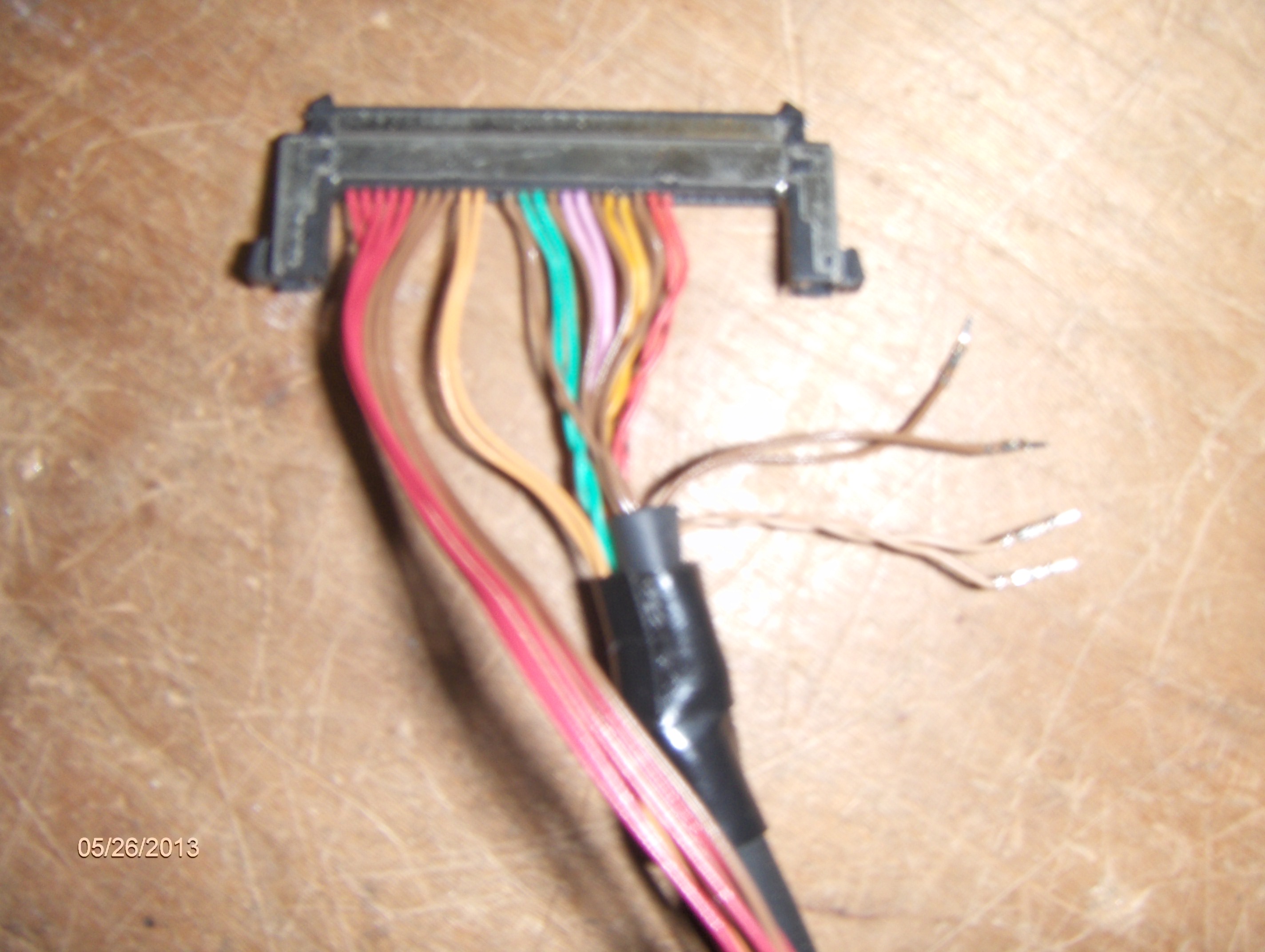

    I was given a Sanyo DP32746, when I opened it up I found the connector at the T-CON had 4 wires pulled out. Does anyone know how these go back or have a good photo where I can see how the wires go?
    Re: T-CON Wire
    The two matching shades will go together, it's just a matter of looking at the other end as the pin out will probably be the same. And + and - polarity must be preserved. If they do not provide power (probably the five red and three brown do) then you can try any combination until it works.

      Re: T-CON Wire
      Thanks tom66
