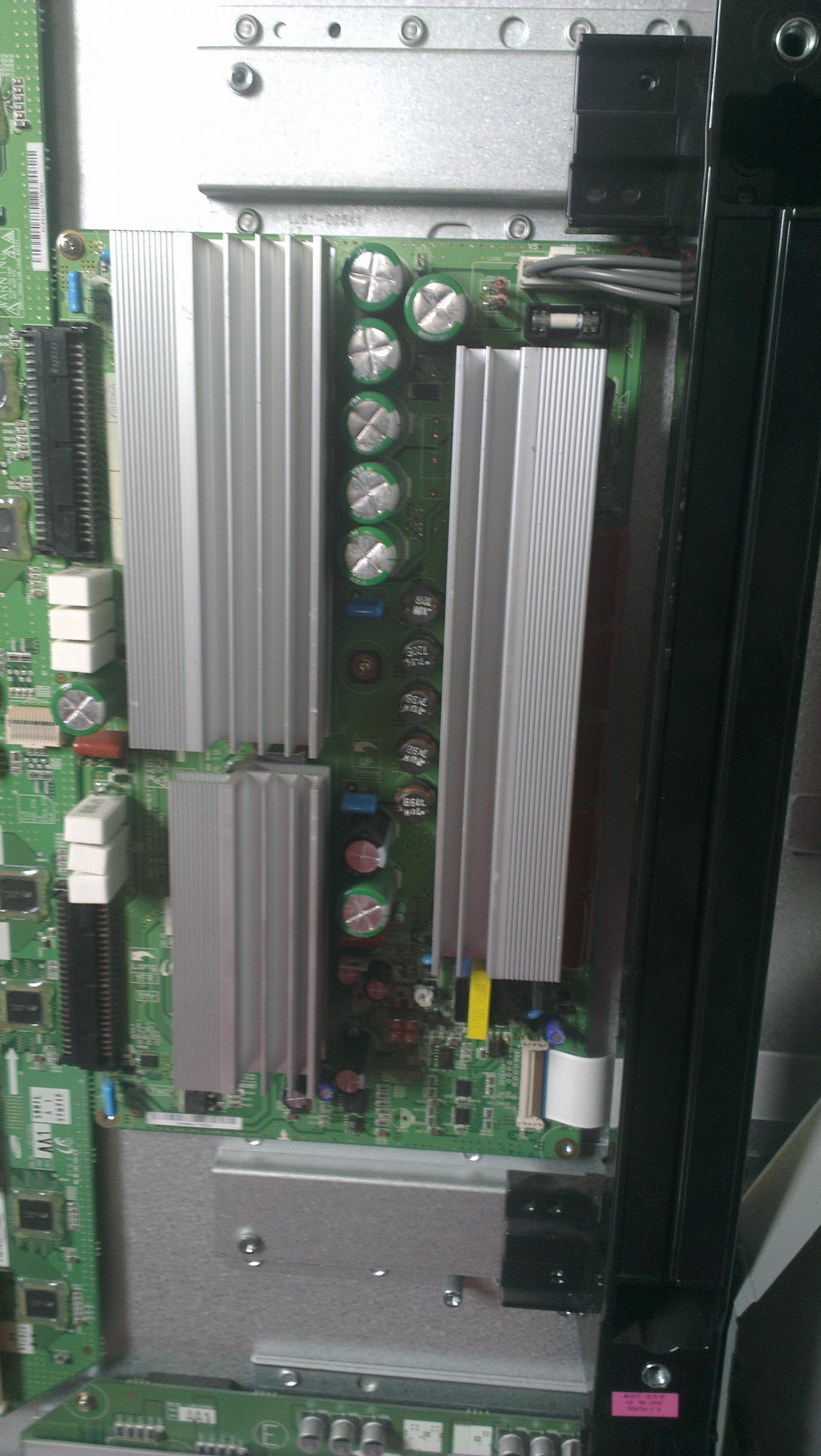

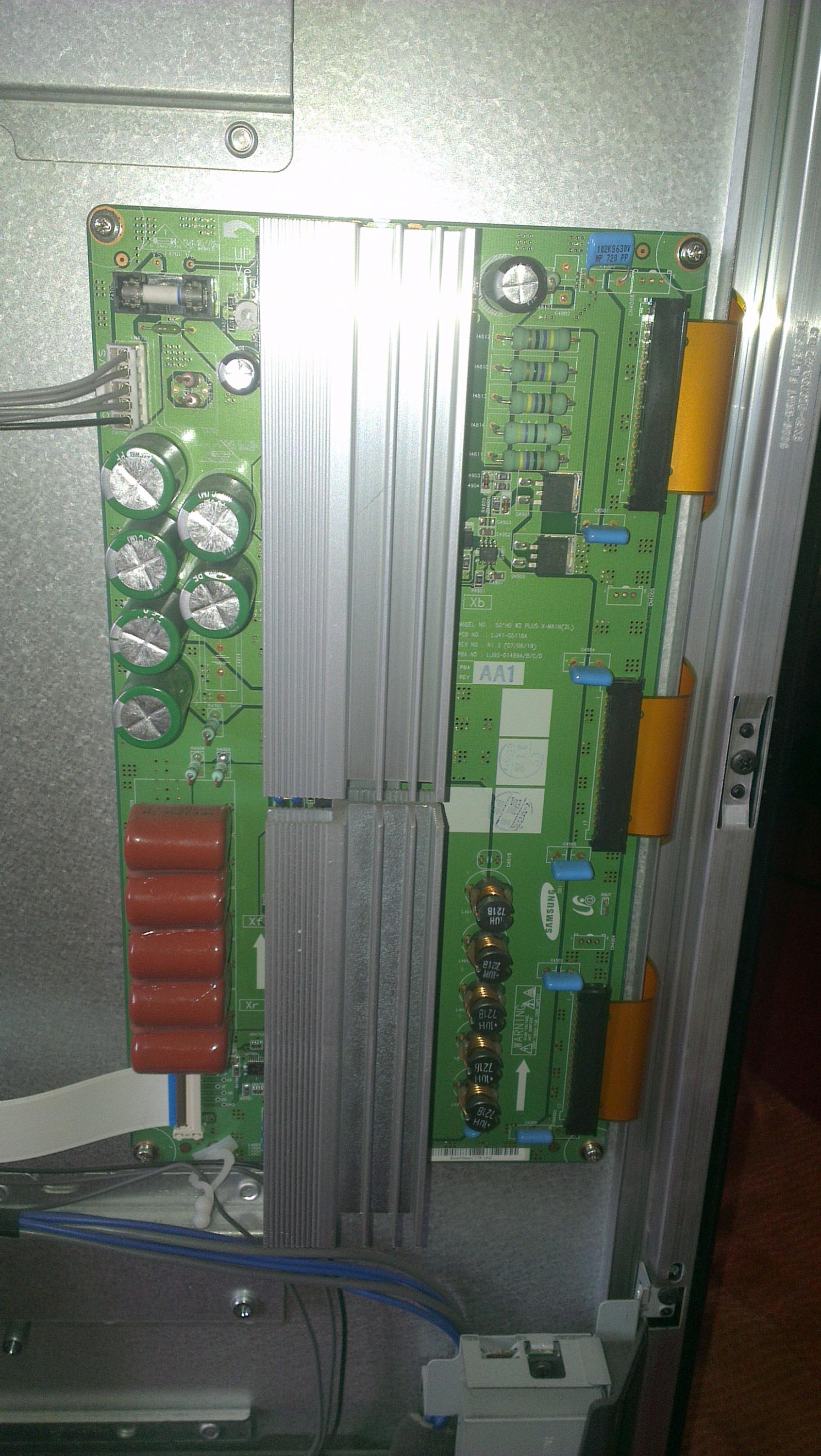

    Can we have a picture of the Y-main and X-main boards?

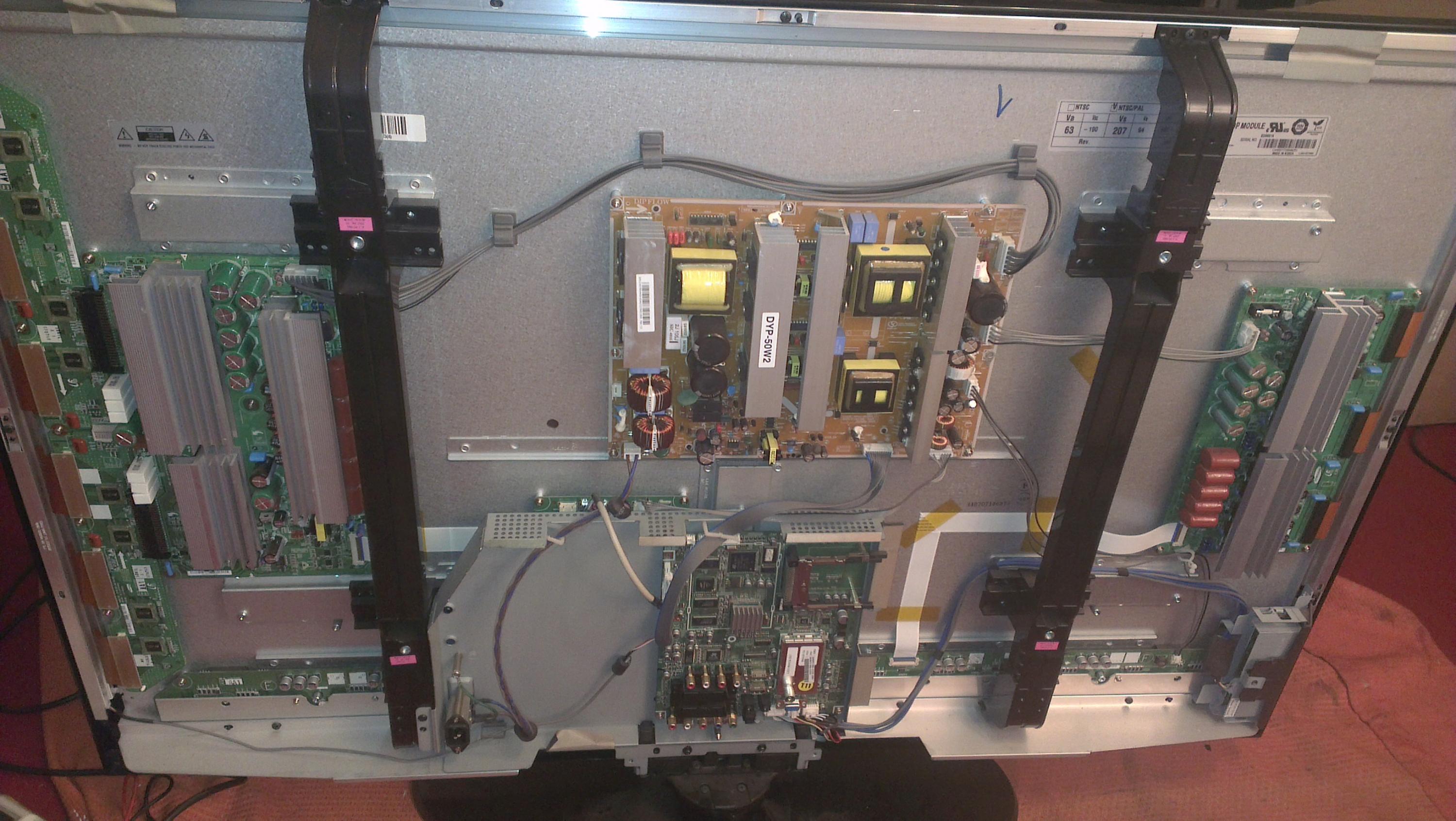

      Re: samsung 50" plasma, no picture, no obvious short or blown fuse.
      Board Info and Pictures
      Overview of whole TV
      PSU Board
      Y-Main Board (LJ41-05120A)
      X-Main Board (LJ41-05118A)

        I have just made some progress!
        It appears that that the iCoupler (digital opto-coupler) U5704 on the Y-Main board does not have any power on its secondary side.
        I assume that this is the link from the logic board control signals to the power electronics, so no control = no drive = no picture.
        It looks like it is powered by a 7805 reg - which also has no power, but the +15V Vcc is being supplied to the board.
        So hopefully it is just a case of tracing the route from supply to regulator.
