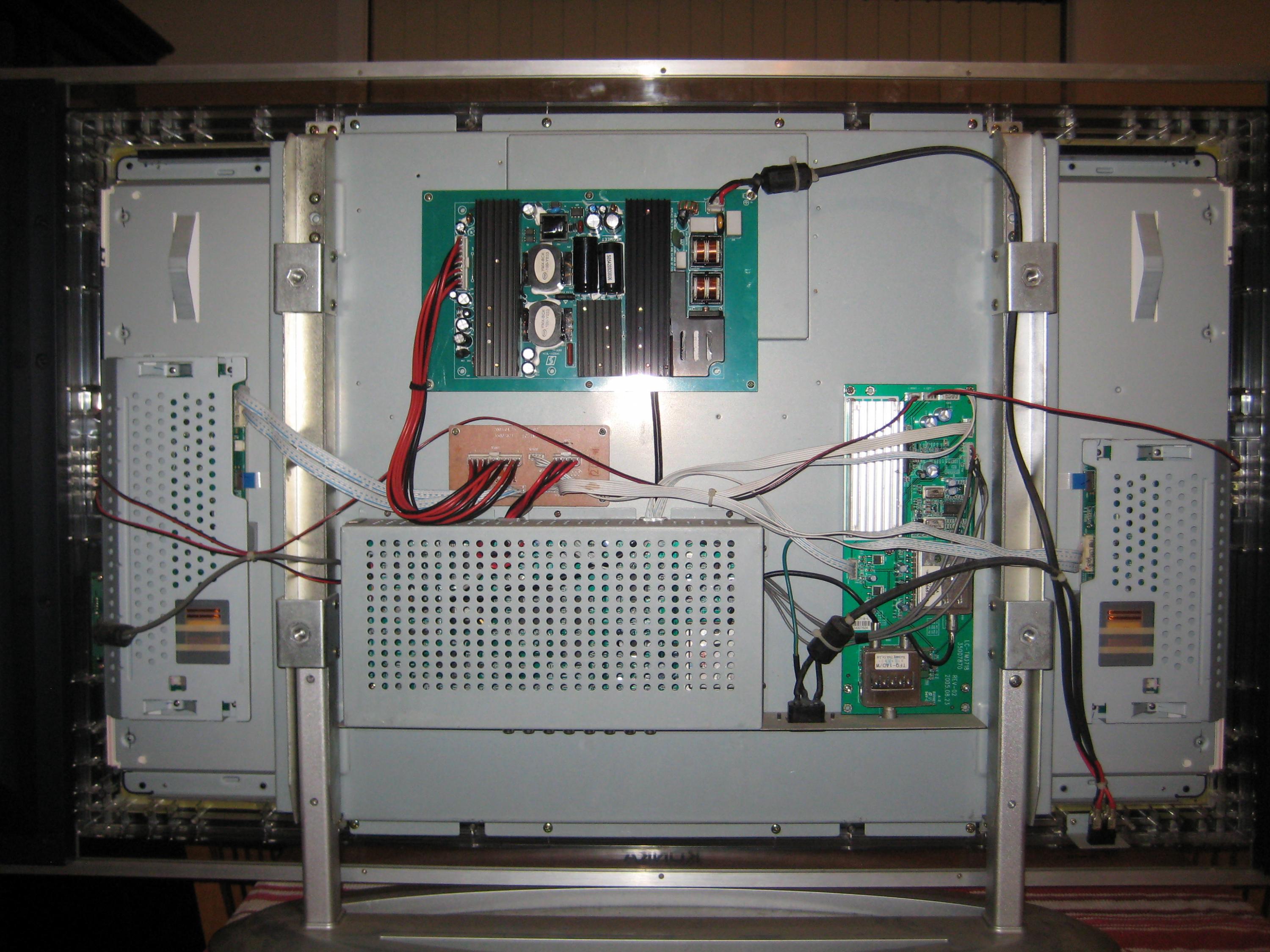

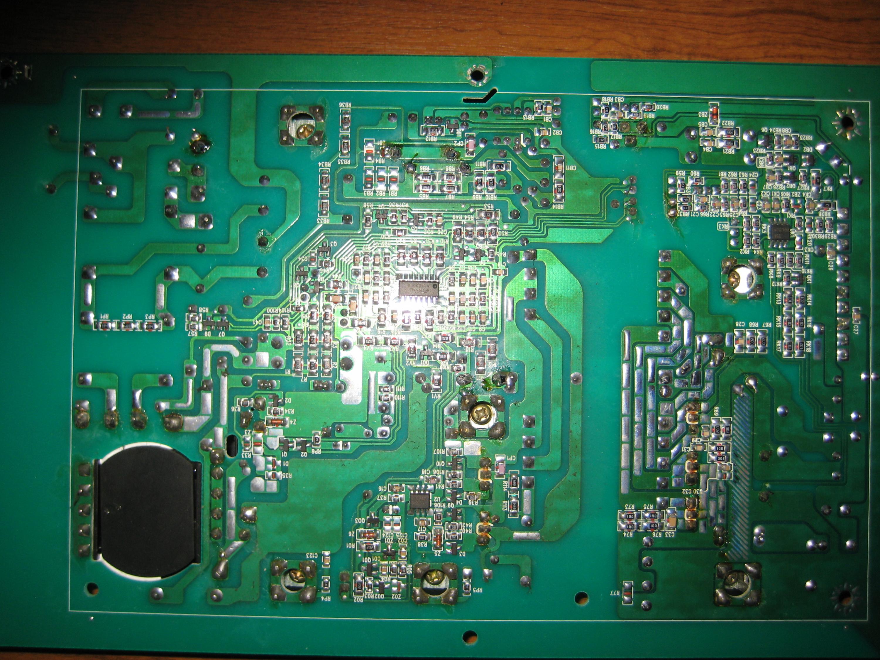

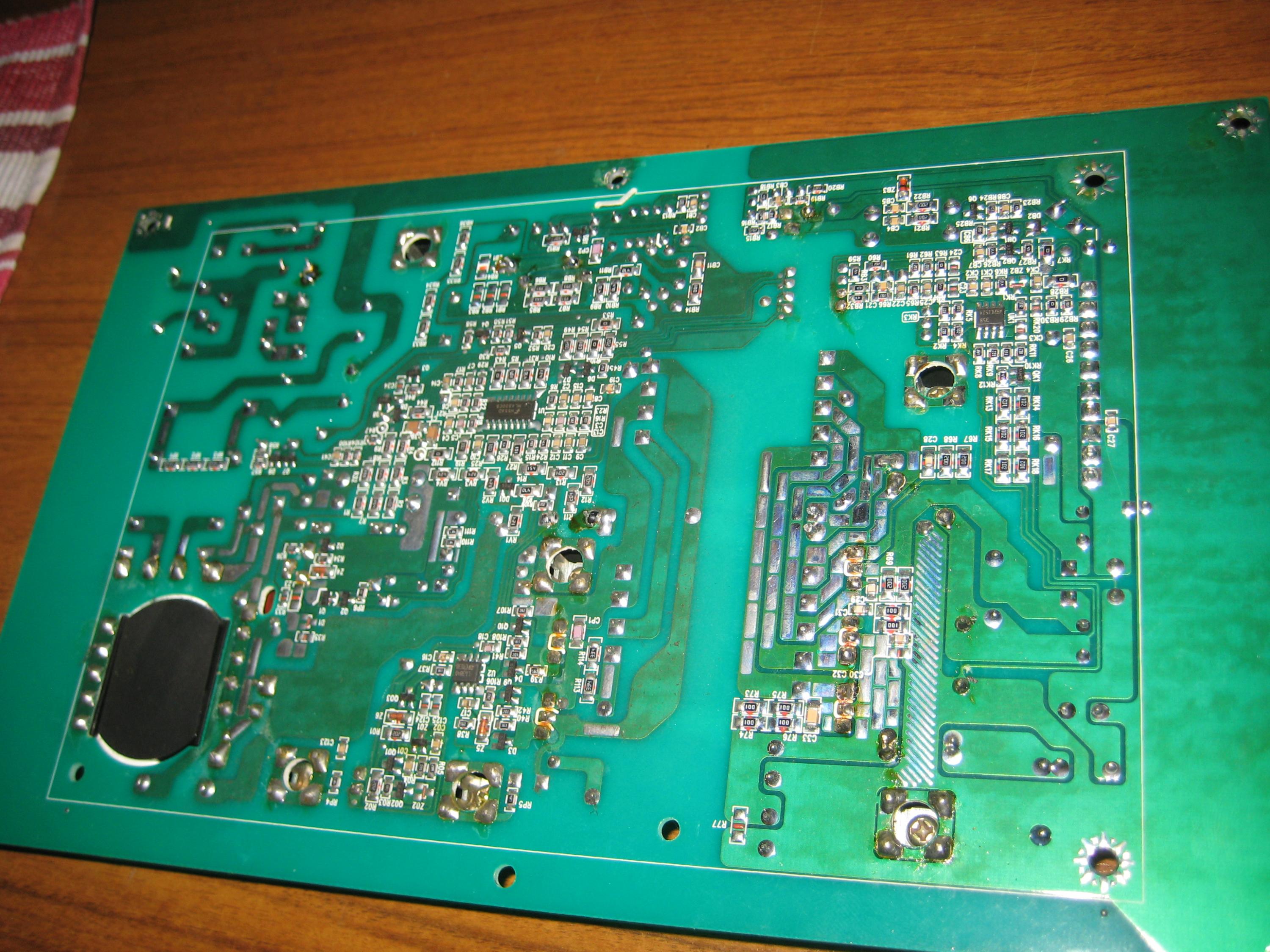

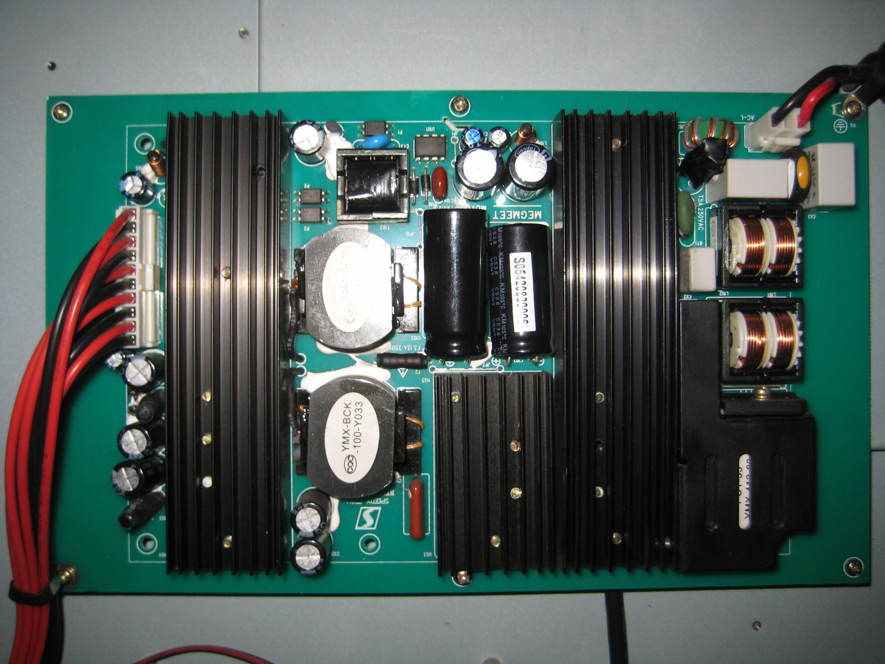

    Hi there,
    I picked up this television today (driven past it left on the footpath for a few days & finally decided to pick it up ), and immediately found three bad caps (CapXon, what a surprise).
    I have now replaced all the visibly bad capacitors and checked that the remaining ones aren't shorted (unfortunately I don't have an ESR or even a capacitance meter yet). I also found the main fuse at the 2-pin ac input header blown, which I have replaced with the same rating.
    I have tested all the various diodes I could find, including the rectifier. I have also checked for bad solder joints and found none.
    The problem is that after all that, the power supply board is outputting -no- voltage. I expected at least a +5v, but there was none. The fuse is fine and hasn't blown.
    I cannot (or will not) yet test the hot side while it's powered as I don't have my lovely cat IV meter at hand, only a cheapy low-voltage DMM. That said, I touched the top of the big caps and had I think about 120VDC (we have a ~240VAC 50hz supply here, but there is a transformer in front of it that I assume drops it down), so the circuit seems okay to here, correct?
    From these caps it should go straight to the primary side on the transformers the their left? Also, whenever there is AC in there should be 5v present at the secondary of the smallest transformer (above the two big ones to the left), shouldn't there?
    I cannot easily get to the FETs, what would you suggest I try? Can I test them in circuit? Unfortunately I cannot see the model on them either due to the way they're mounted to the heatsink.
    Can anyone please suggest where I should go from here?
    Until I can verify that the LCD panel is good I don't want to spend any more money just replacing caps. I will replace the remaining CapXon ones if I can get any voltage at the output of the board, but even if they're dodgey I should still be able to get some sort of voltage out, right?
    Here are some photographs (please don't laugh at my soldering, I didn't have my things and only had a cheap conical-tip iron, no flux and 1.5mm solder... excuses, I know... ):

    If you get no 5VSB, the output diode may have failed, or, more likely, since the fuse was blown, the controller IC for the 5VSB may be bad. As far as testing the LCD panel, you can power up the inverters with a 24V, ~150W power supply (minimum.)

      Could the 5VSB controller IC be U101 (near the two big caps)? How would you suggest testing it (if possible)?
      The printing on U101 is "DM311 VE51", I couldn't find a sheet for it. The output diodes seem to test okay, I'm not certain though.

        Is there an "MLTxxx" number on this power supply? I have more than 1,500 schematics for LCD power supplies. There may be a match.

          The board has PFC voltage booster, so at standby you should have about 230Vac (or what ever your line voltage is) x 1.414 = DC voltage on the two legs of that large filter cap. Also when you are working in the Primary (hot side) of the circuit, the negative leg of the large cap will be the ground ref. point when you are making any DC voltage reading in the primary side. The chassis ground is the ground ref. point for the isolated secondary side (cold side of the circuit).
          So please verify the voltage you have on that large cap.
          That is Megmeet power supply, so I hope you have the diagram for it Tom.

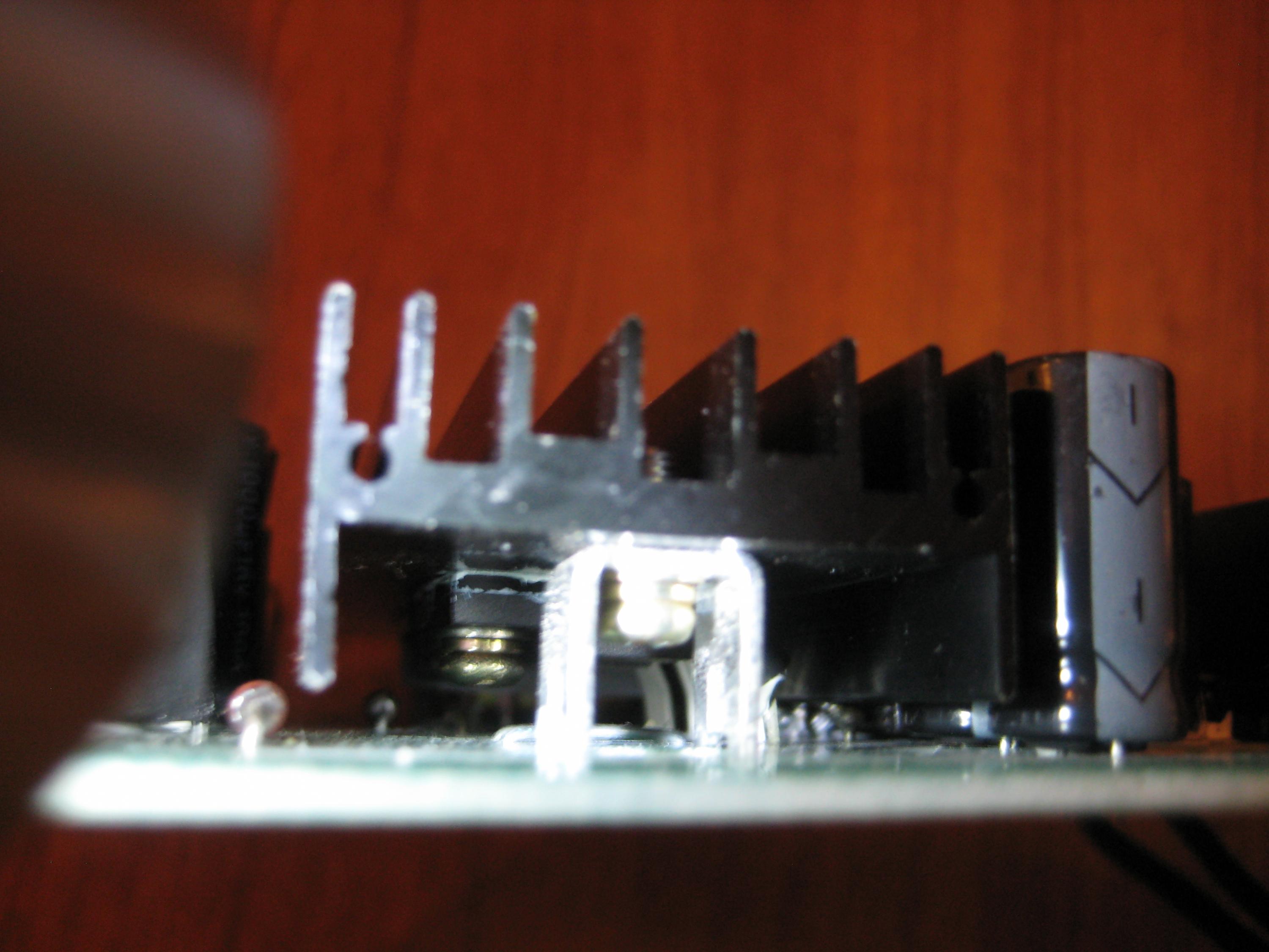

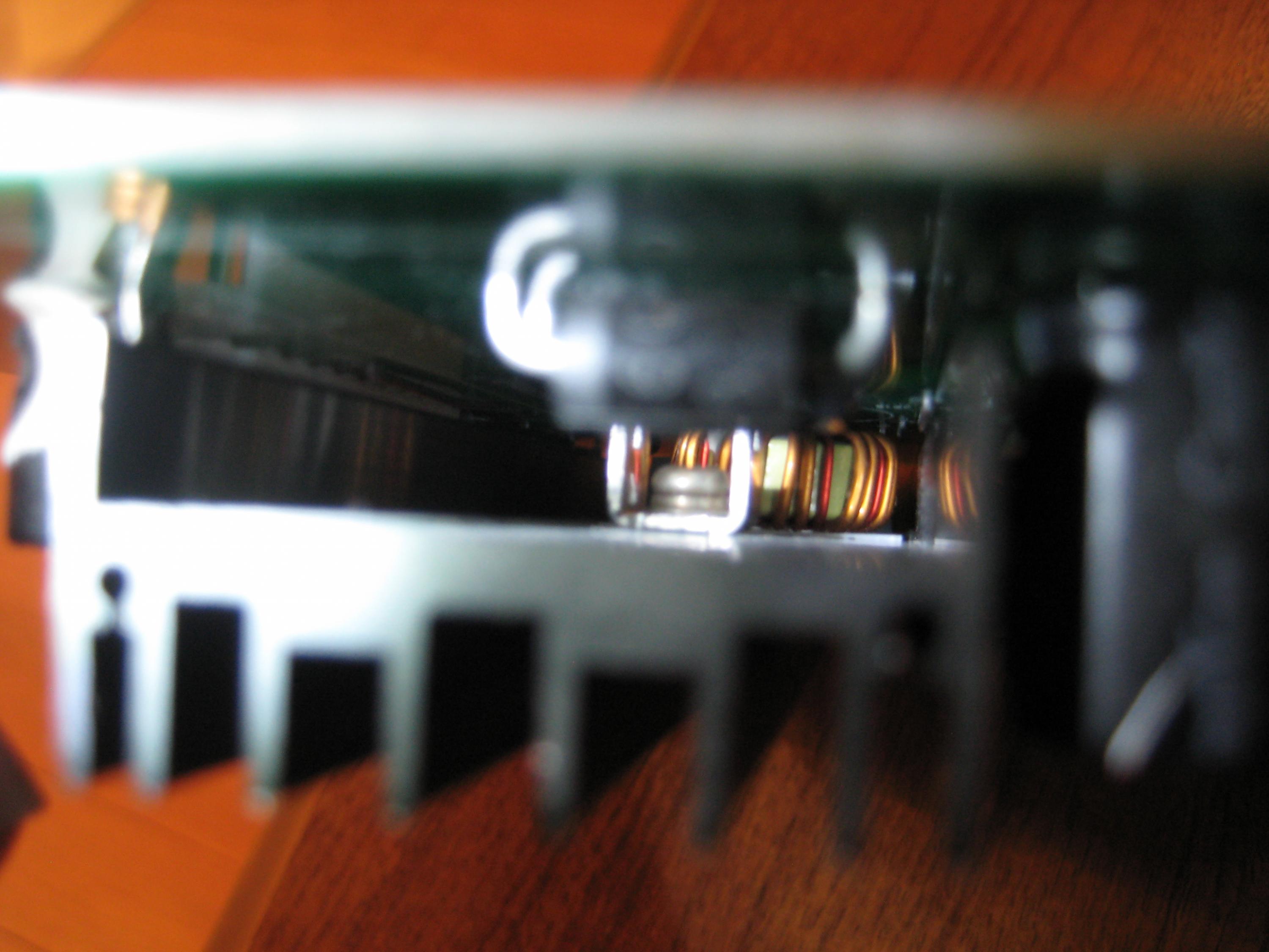

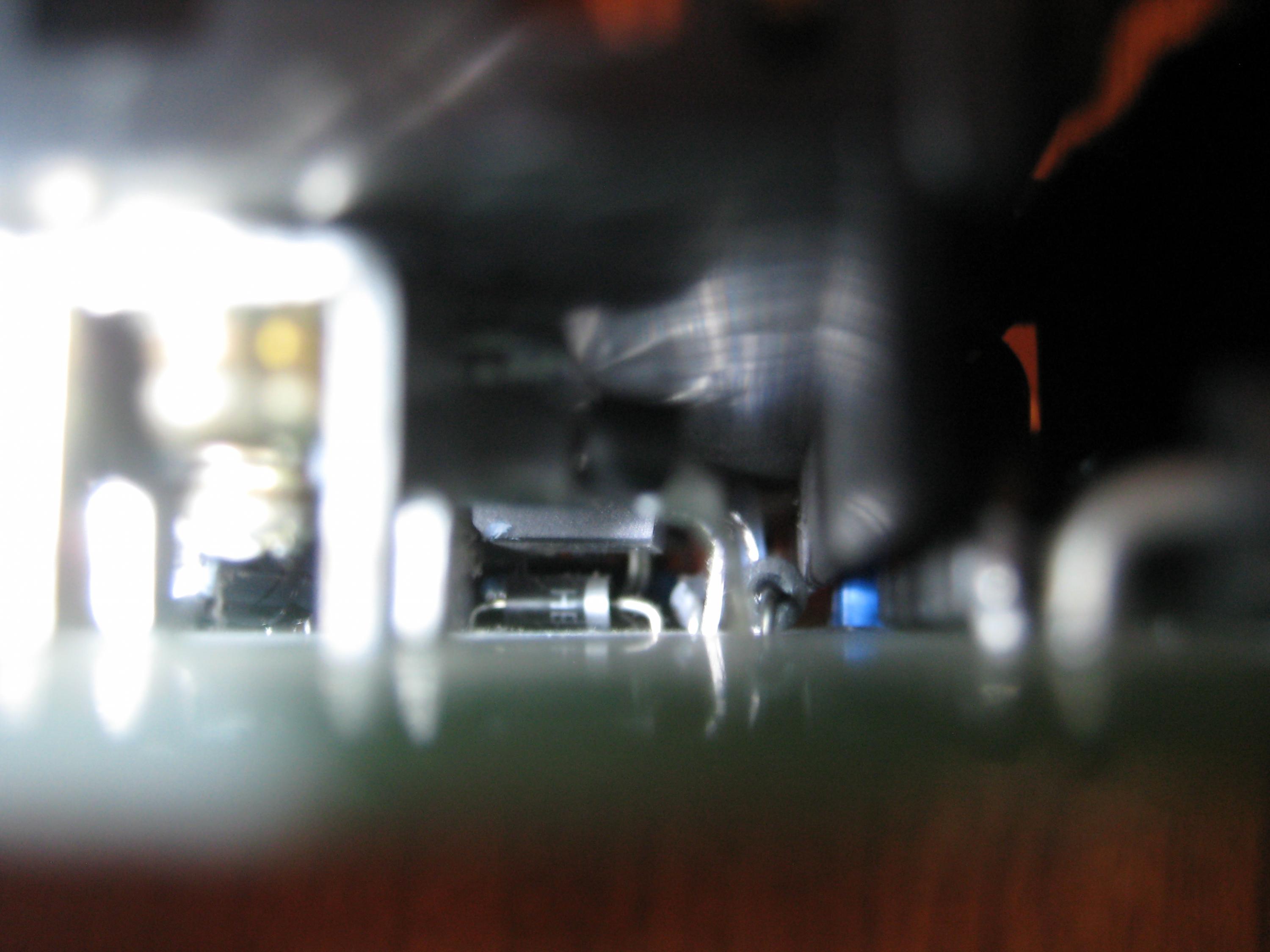

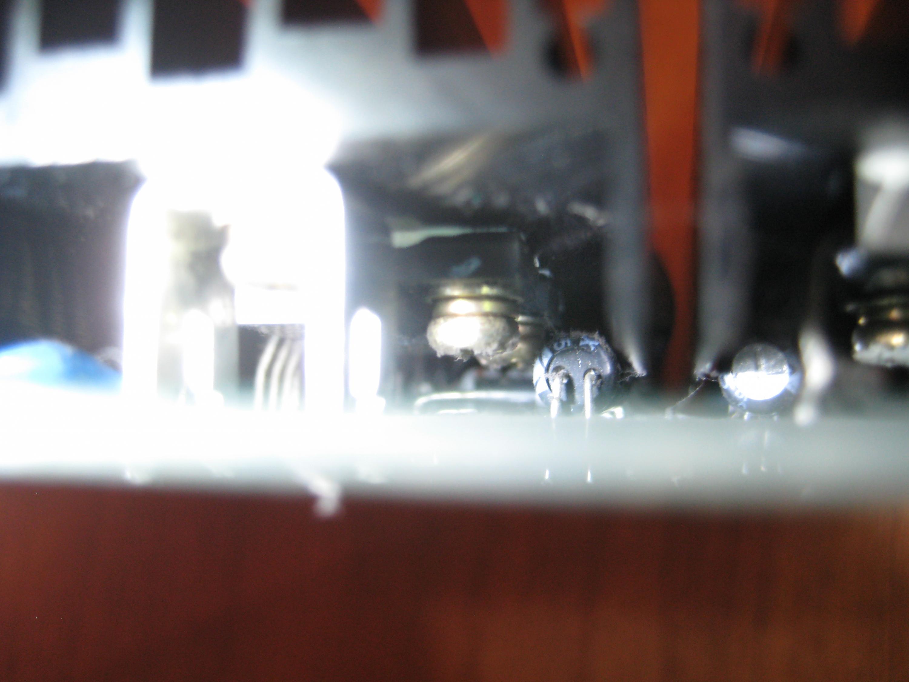

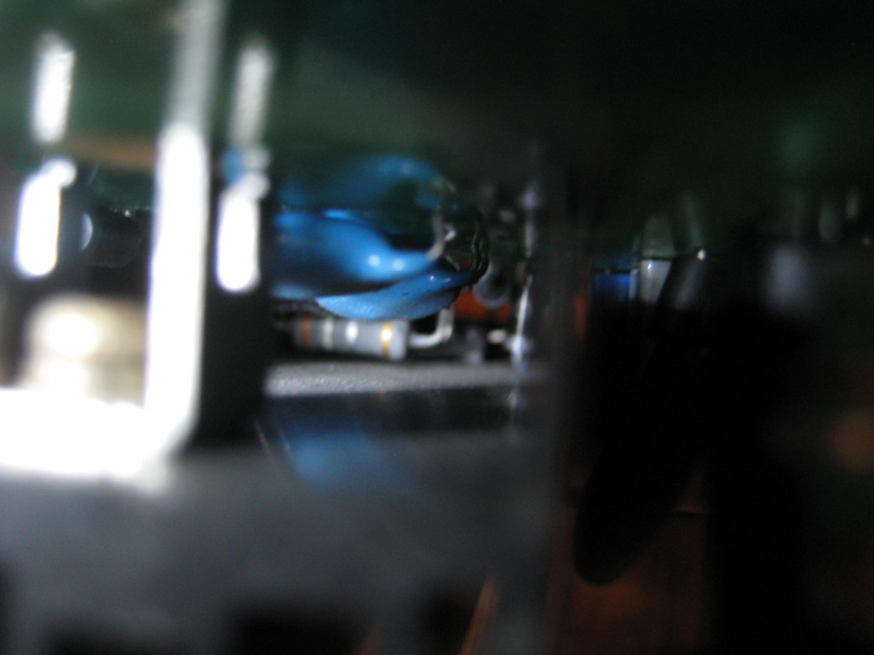

            Alas, I had a bit of an 'issue' with it. I replaced the second large cap for the fun of it (the one that looked fine) and fed the board some AC and an entire trace vaporised along with several SMD resistors in it's path. A lovely light show that knocked out the AC circuit's breaker (10a) but not the slow-blow on the board .
            I can fix the trace and replace the resistors, but then I'm stuck looking for the cause and then the likely possibility that I've fried other components.
            I decided I'd take the risk that the TV was only thrown out because of the power board failure, so I have bought a new board from a dodgy-looking Taobao site for ~$30. Probably take about a month to arrive from China... Could I have bought it cheaper elsewhere?
            Yes, it is indeed a Megmeet MLT083. I would still very much appreciate a copy of the schematics if you have this one, Tom. Thank you.
            I might play with bench powering it in the meantime, if I can hunt down a 24v power supply with >6a. I only have a temperamental power supply that only goes up to 12v. The panel and controller would only be <12v, wouldn't it?

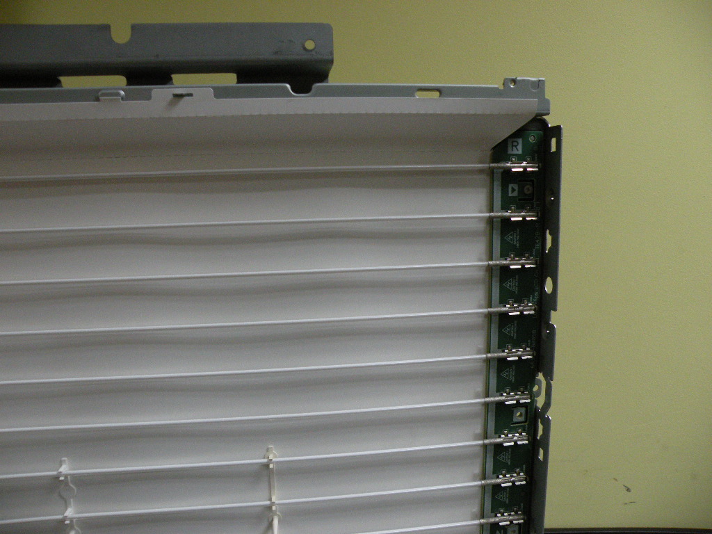

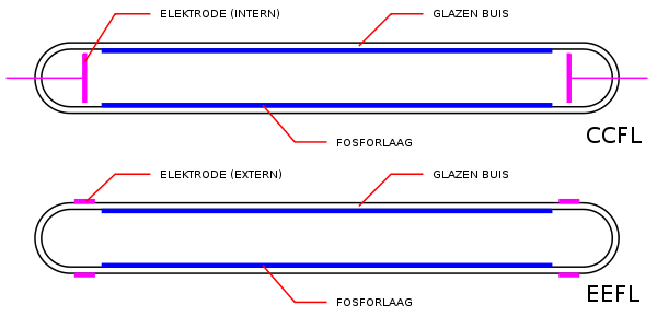

            EDIT 2: Haha, I only just realised this has EEFLs not CCFLs, hence the single wire on each side (this was a concern on my old thread). That's a relief, I'm fairly hopeful a new power board will get this running. The actual LCD panel might still be bad, though...

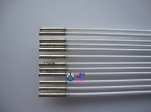

              EEFL, are you sure? Never heard of an LCD using electroluminscent backlight, other than a small 2" one in an old camcorder I took apart.

                Re: Konka KLC-TM3718 - AC in, no DC out - all caps, fuses, diodes, rectifier fine
                Originally posted by tom66
                No schematic yet, sorry...
                Hi Tom, you're thinking of EL backlighting. EEFL is similar to CCFL, but has external electrodes.
                See my attached pictures. The EEFL tubes run the length of the screen and are all tied to a single row per side (in parallel). Hence one wire per side. They apparently run cooler than CCFL as well.
                Also, see:
                http://www.youtube.com/watch?v=UjkqmHte_Qo
                http://www.youtube.com/watch?v=qQ9H3lClcdo
                  Learning something everyday, I myself never run into LCD TV using this kind of lamp yet.
                  http://www.j-right.com/html/eefl_lamp.htm
                    It's interesting, isn't it? This isn't particularly new technology, but I hadn't come across it in person before either. Apparently most larger LG.Philips panels use EEFLs.
                    I love CCFLs, I use them for all manner of things. I might see if I can find a spare set of EEFLs to play with them.

                      I have seen older LG.Philips LCD with one transformer for every two bulbs, so I think those were using CCFLs. I've had those have 2 seconds to black, but only failed transformers being the cause. Otherwise I have "never" seen an LG.Philips LCD with 2 seconds to black in the models with a single wire going into the panel, since all the bulbs are in parallel, it would be difficult to detect a faulty one, and EEFL tends to last longer than CCFL. The more you know...

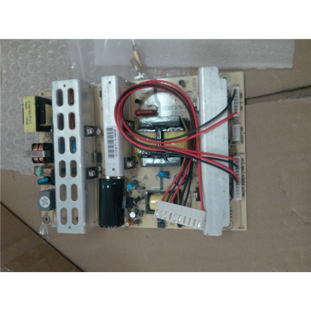

                        Hi again,
                        The Chinese seller I'm dealing with is now claiming he doesn't actually have the exact replacement, and he's trying to tell me that the one in the picture attached will work fine and has exactly the same 10-pin header output.
                        I'm finding this incredibly difficult to believe as I have no confidence in the word of a Chinese seller who may or may not have any understanding of electronics.

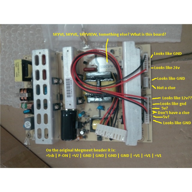

                        Does anyone here recognise this power supply? I can see something that looks like a manufacturer name, but I cannot find anything about it. Can anyone at least recognise the manufacturer logo?
                        On my power supply (Megmeet MLT083), I simply have this on the 10-pin header in order:
                        +5vsb, P-On, +V2, GND, GND, GND, GND, +V1, +V1, +V1
                        All grounds are tied, all +V1 are tied
                        Does anyone know what voltages +v1 and +v2 are? I presume +V1 is 24vdc and +V2 is 12vdc. Does that sound right? If so, the blurry photo of this supposed "good substitute" looks like it may line up but even so, what is the likelihood of it not being able to supply enough current?
                        If it cannot supply enough current the set should only either shut down randomly or not be able to even start, correct? No damage should occur?
                        Alternatively, if it is rated for a higher current it should only supply what the equipment pulls shouldn't it? So again it shouldn't damage anything?
                        I need to give this seller a very prompt reply (I am hoping that there is a possibility it will work as I don't like my chances of seeing a cent returned), and so I would really appreciate anyone's words on this (I'm happy with just opinions, I'm not going to hold you responsible if it doesn't work )
                        Yes, I know I should get what I bought, but I really don't like negotiating with Chinese online sellers, they can be ruthless. I've done that before and ended up with no money, no item. I'll either try the supply or go all-out to get my money back, but I don't want to change my demand part-way though so I'd love any opinions on the power supply. It was cheap, only about $32.
                        Thanks again!
                        EDIT: This is the actual item I bought - http://item.taobao.com/item.htm?id=18209339674
                        Of course I only machine translated it, I know Japanese not Chinese haha, and I missed the part where it says "alternative"...
                        Have a look here. I don't think this is exactly the same, but it looks like this is common in China to replace with "universal" power supplies. Do repair centres use these elsewhere?

                            Yes, I didn't like that, either. I figured if the pins on the male header are connected I could possibly add extra wires. It's claiming it's 6a on the 24v.
                            I think I found it. The manufacturer is "Skyvin".
                            Can I possibly use this? I'm sorry, I still am not sure on the specs for the original power supply. No amount of 'googling' has found it yet unless I'm trying the wrong things/places.
                            The TV uses an LG.Philips 37" LCD panel with EEFLs. It has a very cheap-looking mainboard which I doubt has a high power consumption. I don't have the entire television's wattage rating on hand, I can update later. I think it was about 130w at 240vac.
                            This is the "universal" replacement:
                            http://www.aliexpress.com/store/prod...628242293.html
                            EDIT: I don't get the wiring bundle shown in that link's photograph. I get the tiny harness you see in the first attached picture.
                              Arg! Just to make it worse I have found other ones that look -very- similar from Skyvin but have different ratings!
                              So far, they have all claimed higher amperage though (different models, same layout).
                              EDIT: More information here:
                              http://hslcd.com/Article_Show.asp?ArticleID=334

                                Any chance of some close-up photo's of the vaporised trace etc?
                                • Daize
                                  Dodgy Newbie
                                  • May 2013
                                  • 37
                                  Certainly, I'll pop some up tomorrow when I get home. I may be able to a bit later. It wasn't as dramatic as I made it sound, but at the moment I don't really want to fix it. I may try to fix it when I have more time, but I'm guessing I've damaged even more components on it now.
                                  I really need some more suggestions or opinions on this possible replacement Skyvin board, though.
                                    I wouldn't trust a Skyvin board; I've never seen them in TVs. Whilst Megmeet et al are not good power supplies they are at least capable of putting out their rated power (until a cap bloats or a FET fries.)
                                    • Daize
                                      Dodgy Newbie
                                      • May 2013
                                      • 37
                                      Also, allegedly EEFL backlights use less power than CCFL. Perhaps 6a may be enough? Thoughts?
                                      Should the 5v and 12v amperage be enough perhaps?
                                        24V @ 6A = 144W
                                        Mainboard plus audio is usually 5W continuous, 15W peak (loud sound etc.)
                                        T-con/Panel pulls around 10~15W.
                                        So it may be capable, but I would be skeptical.
