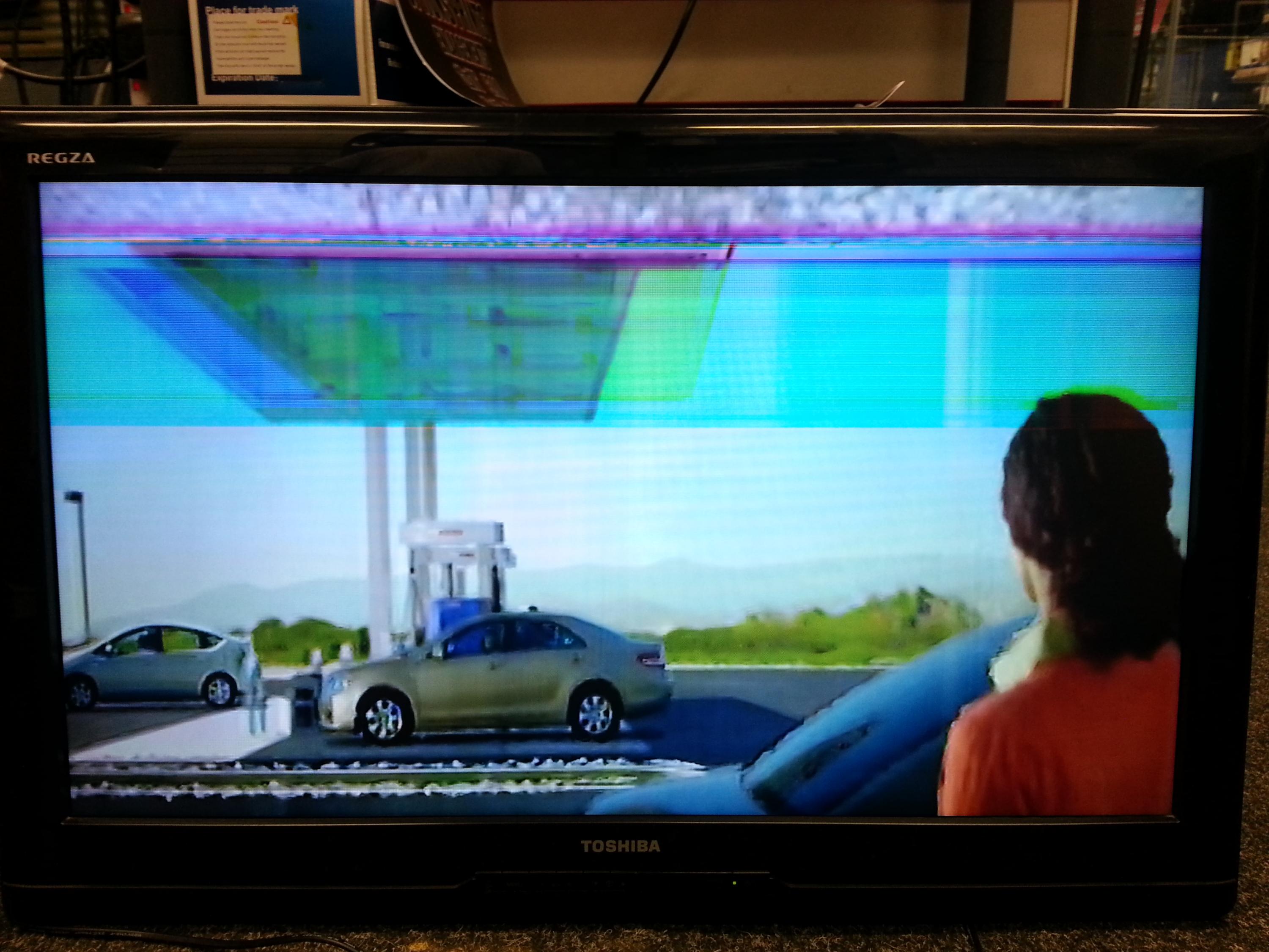

    Hi all
    We have a toshiba regza 32av555d with many lines; some thick when the tv is switched on at first. If left on for 15mins+ the screen will display 100% ok as in no lines at all. TV is ok if hot
    We really don't know where to start. Can someone point us in the right path?

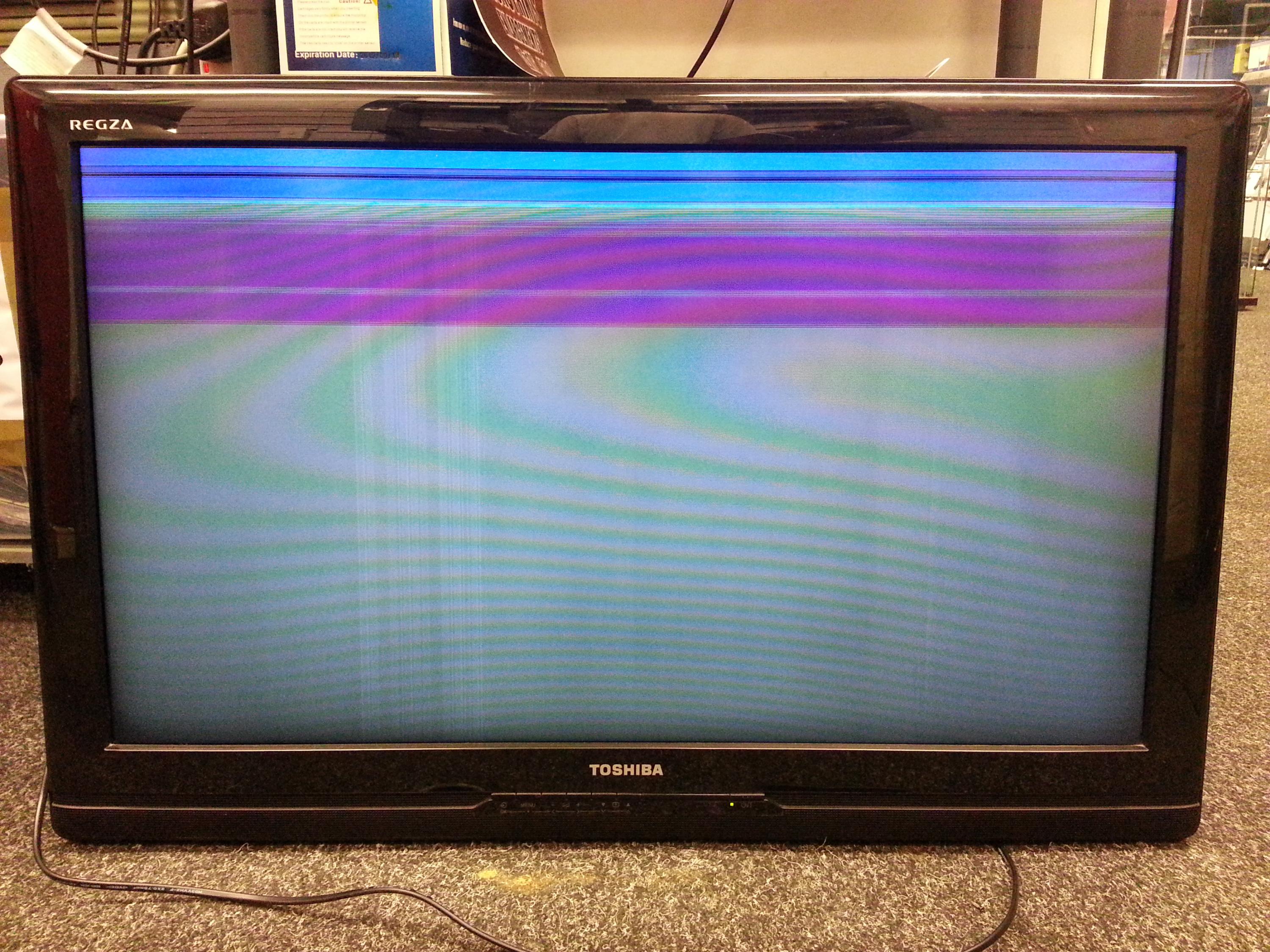

            Re: Toshiba 32AV555D - Screen with Lines
            Ok. This picture show when first connected:
            And after few minutes, around 10mins+, this:
            Then it shows clear and 100% ok.
            Im lost.

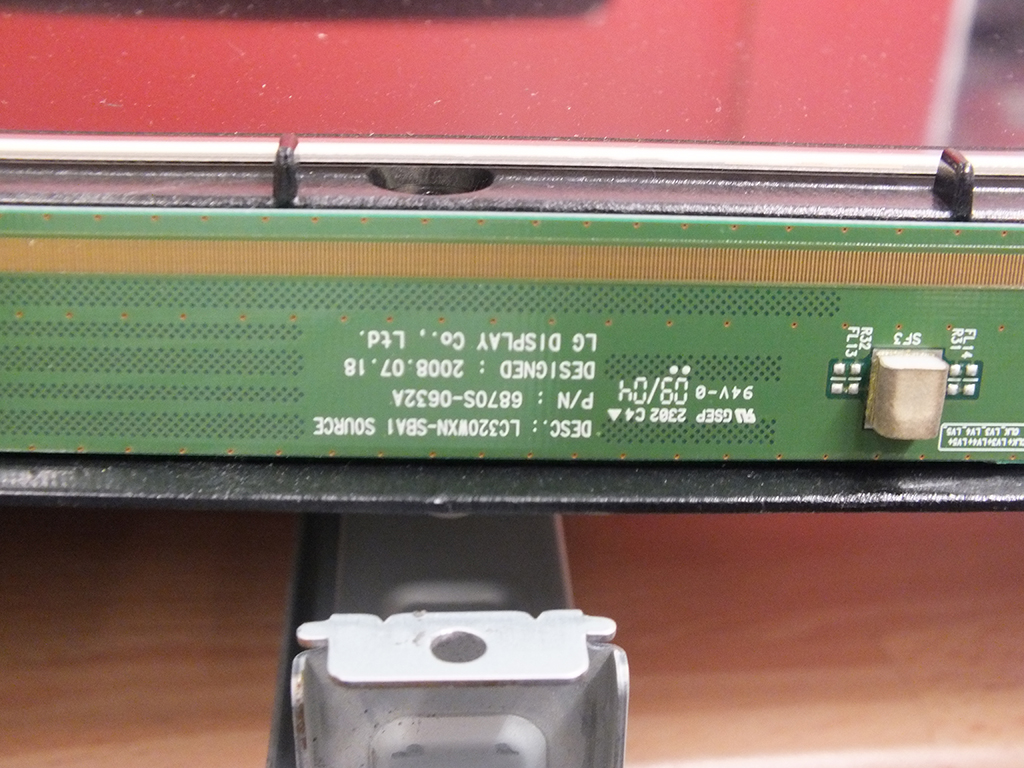

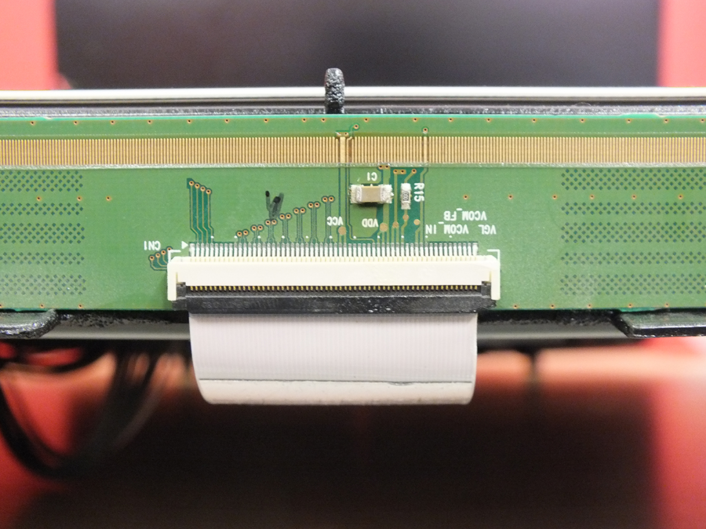

                  Ok I have found the issue! There is a pcb that attaches to the display. See pictures:
                  and
                  C1 is damaged. Whenever I put heat over it, the lines on the display are gone. Any schematics for that part?
                    Measure the voltage across it when working properly. From that info you can estimate the capacitance based on size. e.g. 15V across, typically cap will be 25V rated so likely 10uF if 0.12x0.06" dimension (1206.)
                    • speedypro
                      • Feb 2013
                      • 561
                      • United Kingdom
                      Spot on. voltge is 14.99v (15v) so I take it the capacitance would be 10uf.
                      Edit:
                      We've found another cap with voltage across is 15v. We used it but same display issue. When this area is heated, as in pic below, the display is perfect:
                      Could it be the resistor the culprit? Nothing is behind the pcb.
