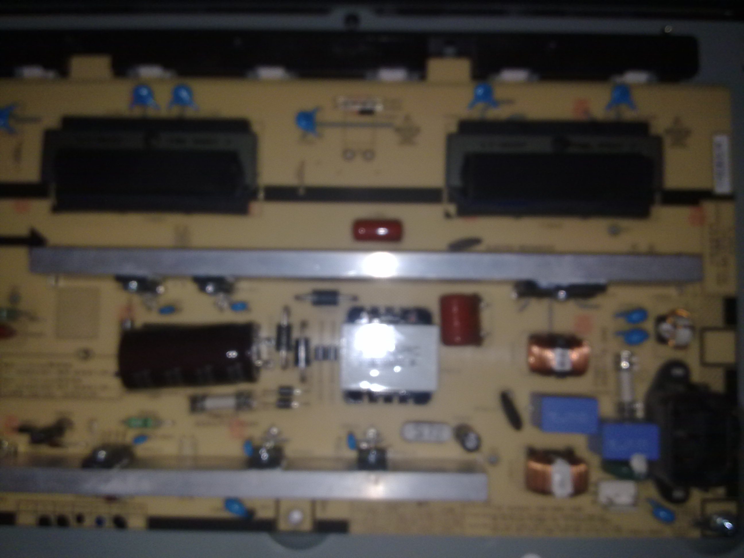

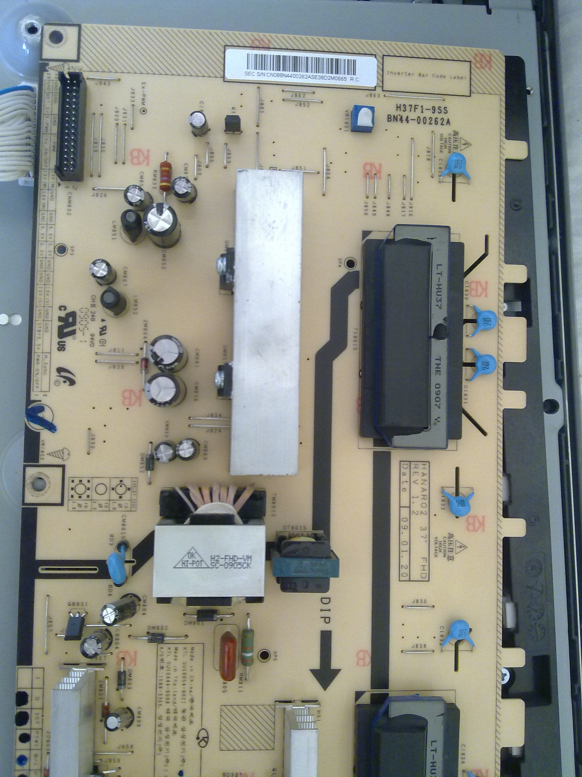

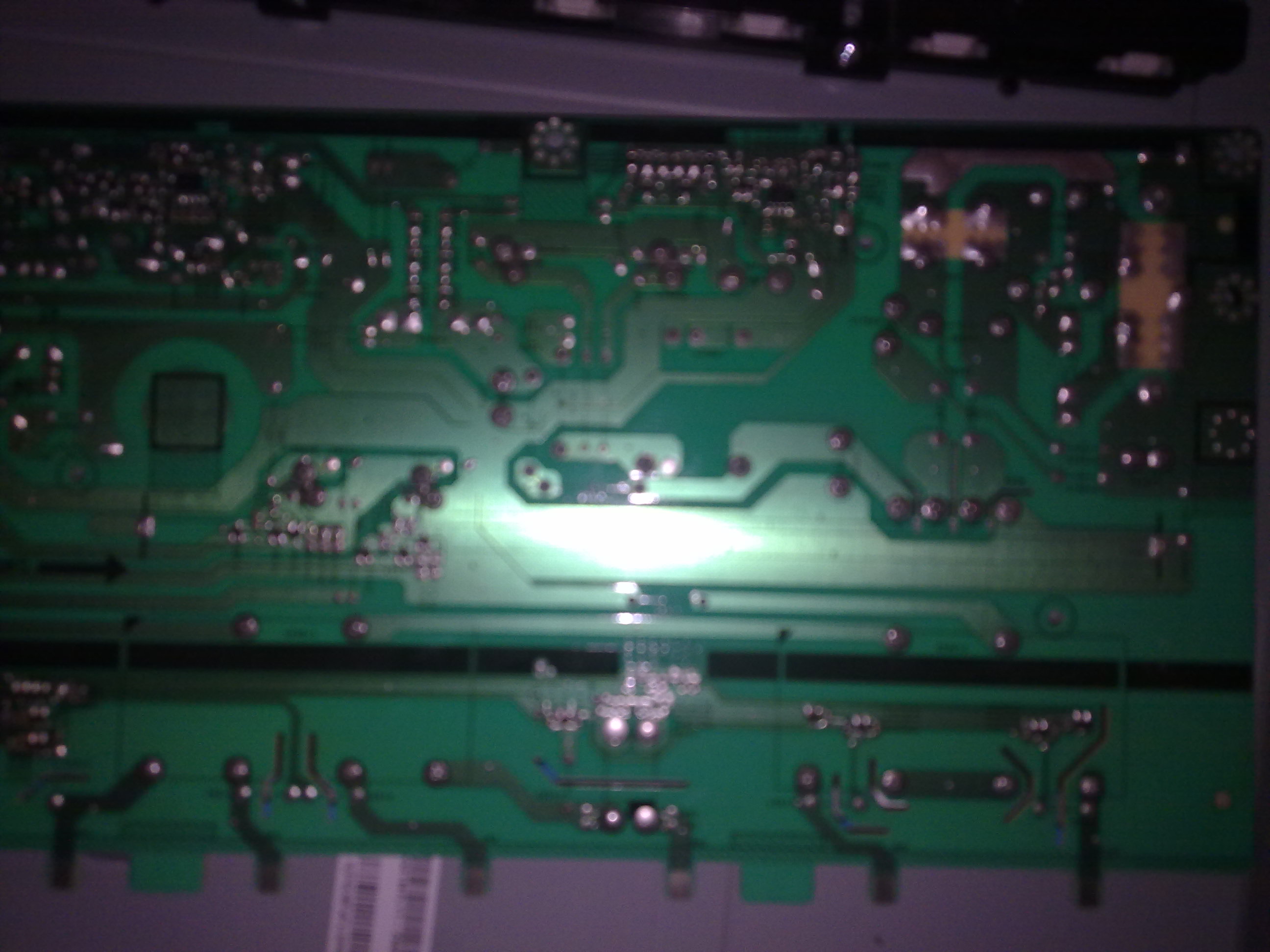

    Hi All
    I have a Sammy that is dead, I am getting no voltage on the 30pin connector..more importantly no 5v from pin 27, I am getting 330v at smoothing cap, all usual suspects all ok, both internal fuses are ok, fets are ok, solder joints seem fine.
    No backlight flash with main disconnected
    It wont let me attach pics..maybe because I am a noob (managed to sort it)..if you need me to uplad better pics lt me know
    Anyone give us any pointers please

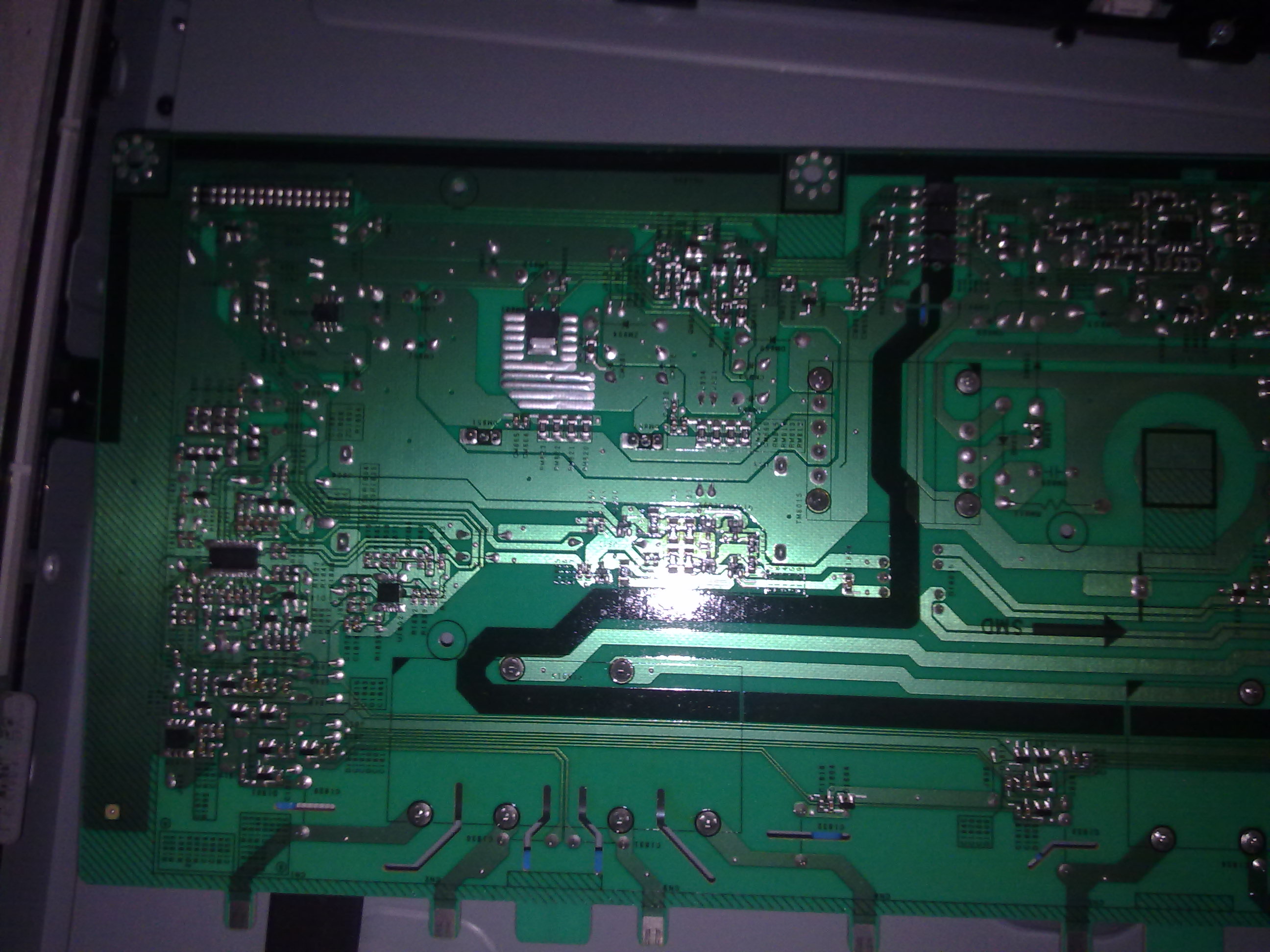

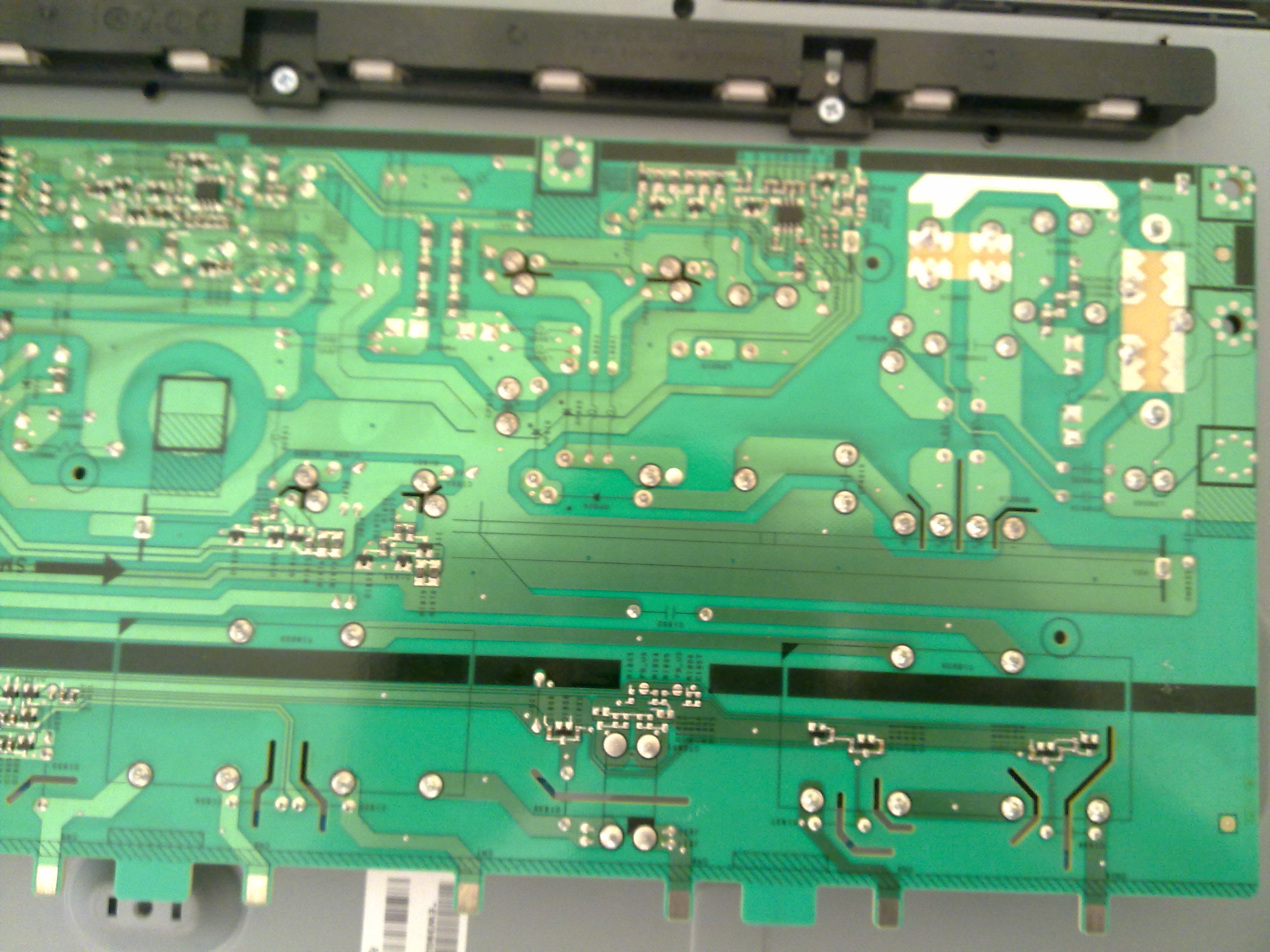

    Can you please post good clear pictures of the board? I cannot read the P/N on that power supply board. Is it BN44-XXXXX?
    It is hard for us the troubleshoot the board whe we cannot clearly see the components and traces of the boards.

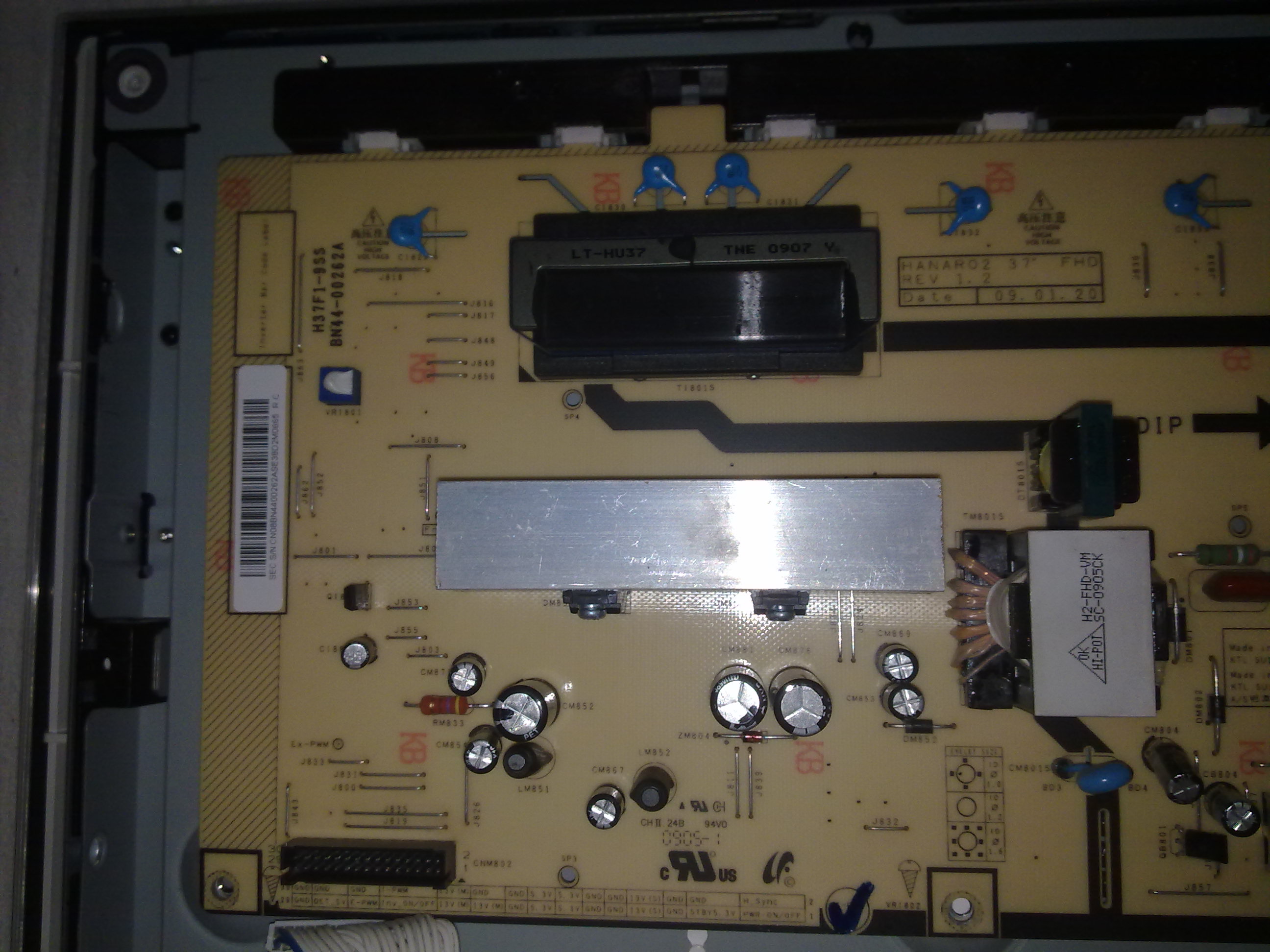

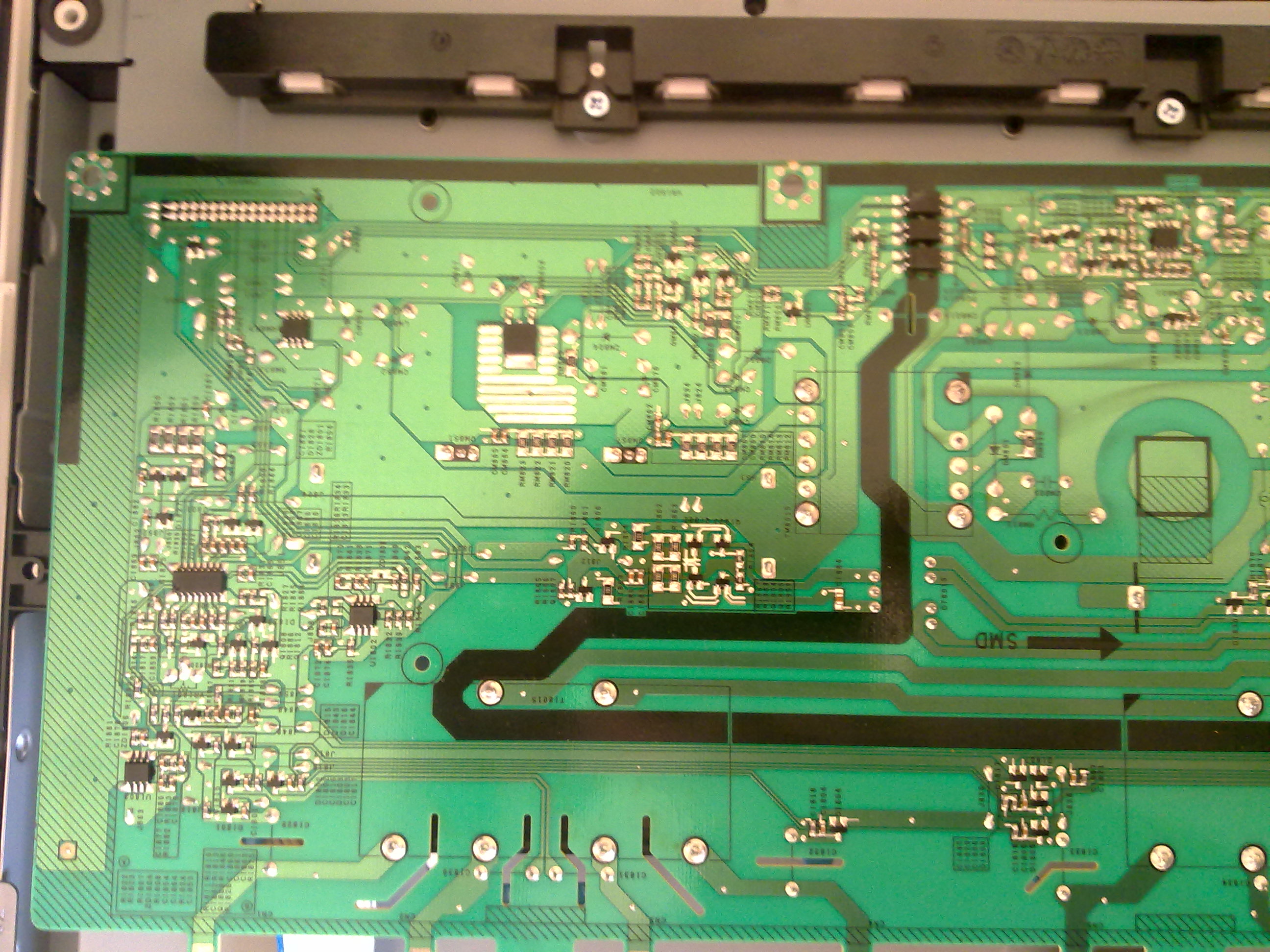

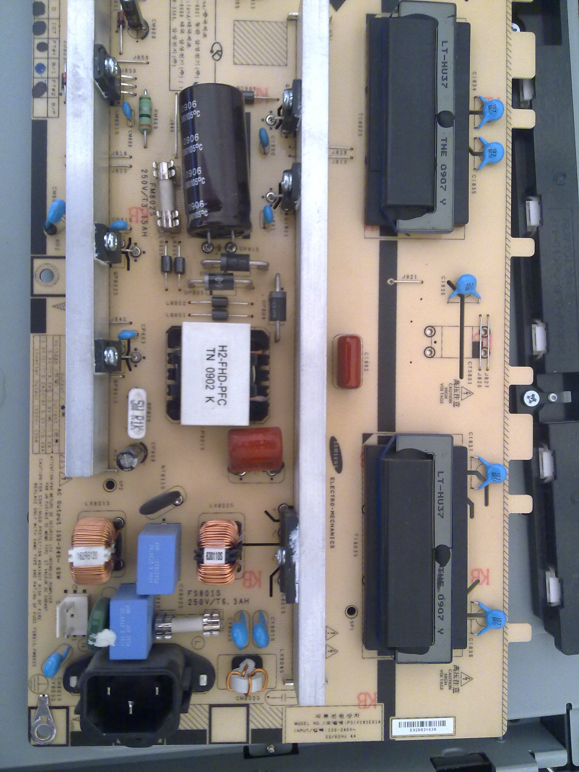

        Sorry crap camera...these might be better, pn bn44-00262a

            Here is the bulletin for the BN44-00262A and the diagram from TOM66 web site.

                Re: Samsung LE37B550A5W Dead
                Yes we need to troubleshoot the 5V section first.
                See the diagram I posted.
                Check the snubber diode, DP801.
                Check the voltage on the two legs of capacitor CM804.
                Check the resistance of the IC UM801S (STR-W6252, TV unplugged) between Ground pin5 aginst all other pins.
                    It should be close to the 5v stby transformer TM801S, the Cathode of th at DP801 is connected to RM811 and CM805 per diagram.
