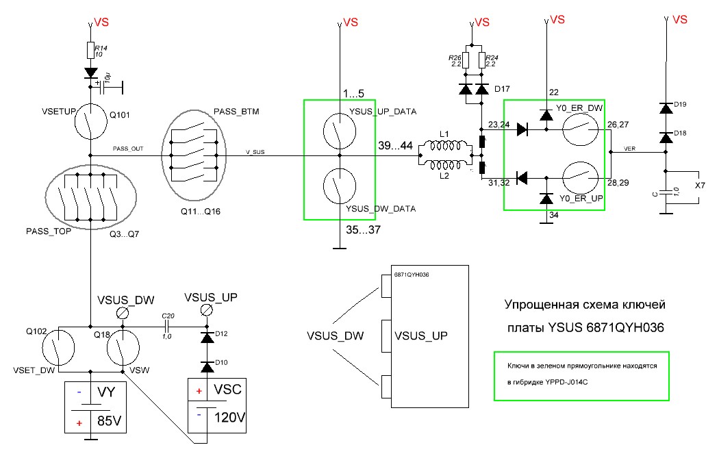

    I've never seen that diagram before I guess it must have been reverse engineered.
    Vs = Vset probably for R14, otherwise it does not make much sense.

      you right tom66
      Vs = Vset on R14 but I noticed there is no Vs voltage on R24 and R26. It seems that the Vs voltage (183 volt) coming from the power board is defective in some parts of the y sustain board.
      The vscan voltage is ok = 115 volt

                  yes I have made the following measurements and I get :
                  Vscw = 114 volt
                  -Vy = - 1 volt
                  vset = 0 volt
                  Vs = 183 volt
                  Va = 65 volt
                  there are 2 inverters. one for the Vscw and the there one is for Vy. I have change almost all components around the Vy inverter but no result

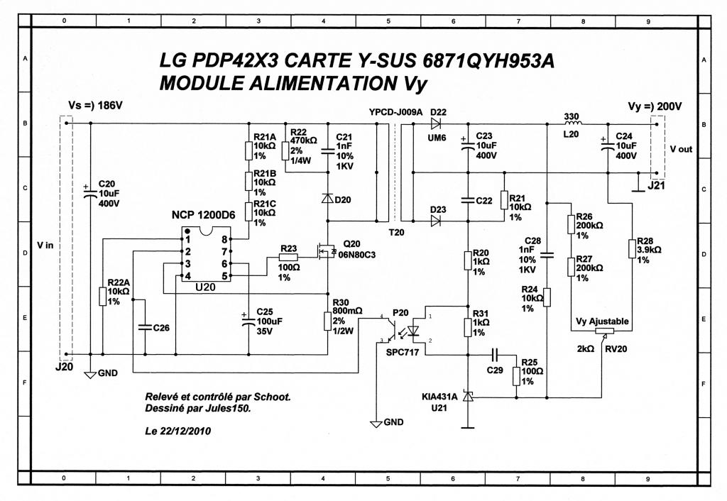

                              The -Vy and Vscan (Vsc) I believe the DC converters on this version not on separate sub pcb's but on the main Y Sus PCB. I think IPM failure is less of a problem with these as some of the others, but I only have a small sample to base experience on. I can however when I return home take some resistance readings around the -Vy and the output FET's and and semi's around there, we may get some idea if something is amiss or whether to focus directly on the DC DC section.

                                Quickly glancing at the diagram you posted I think some fusible resistor or other fusible device has opened depriving some (not all) sections of the Vs supply. Again something could be short-circuit, it can be hard to diagnose these stages in-circuit due to parallel paths, parallel FET's etc. That's an interesting diagram though, it appears to be an abstract of the basic circuitry.

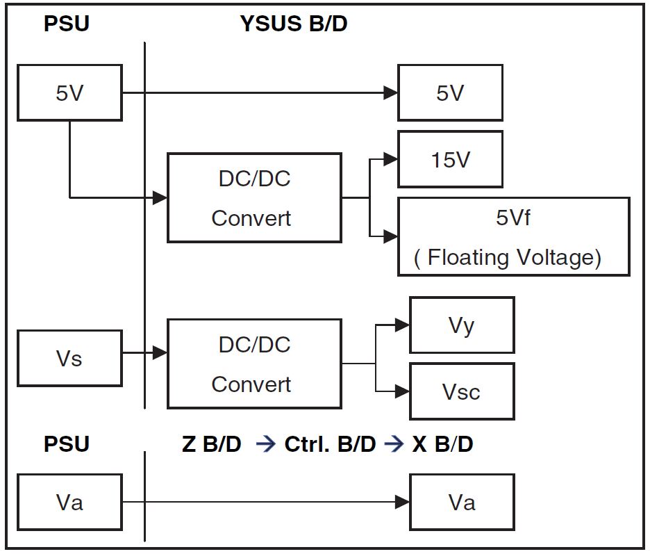

                                  the DC converters for the -Vy and Vscan (Vsc) on this version are on the main Y Sus PCB. I heard the problem is due to the IPM failure so I changed it but no result.
                                  I've found only two diagrams related to the Ysustain board but there are not a full diagram.

                                    This is always a problem that sadly is common nowadays, lack of detailed circuit diagram. I have little doubt you could get it going by fitting a Y-SUS board, however for me it is more interesting to find the exact problem, I grew up repairing CRT sets and by getting in deep to the circuit you gain very useful knowledge which you can use many times and adapt to suit different designs. If in the end you find it's cheaper to replace the whole board than try to source the component(s) then ok. I don't think your problem is IPM related since I think this only provides the basic sustain waveform and the various external circuitry builds on this to achieve the actual waveform required by the display. Can I ask do you still have a picture since replacing the IPM and the accident with the probes?

                                      Do you have the PDP42V7 LG manual? It does not have any schematics but it does show a lot of waveforms together with some general info about the pass top and bottom FET's, they suggest they are failed but the same effect would be seen if they are not receiving the correct supplies or signals. I don't want to waste your time with this manual if you already have one to hand as it doesn't tell us much, but if you don't have it maybe it's something to look over.
