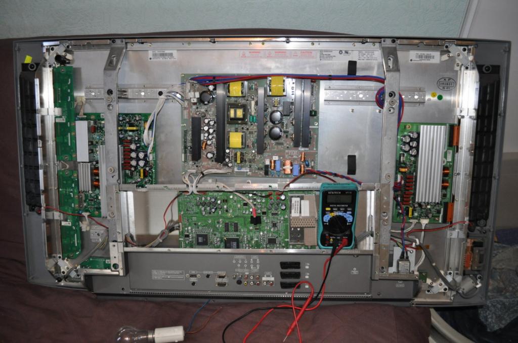

            Can we see a picture of the boards in your TV. I will highlight the buffer board.
            • takara
              • May 2013
              • 19
              • france
              Re: plasma tv out of service
              please find below the picture showing the boards of the tv.
              • takara
                • May 2013
                • 19
                • france
                I read the specifications indicated behind the screen : the -Vy voltage must be at -95 volt.
                I've made also some measurements with the vsc, va and vs which are OK.
                  On your panel the buffers are on the left of the image. It's the boards that connect to the Y-sus where you measure the -Vy etc.

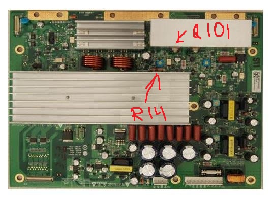

                                I also wondering if the 2 mosfets STP9NK70ZFP which are attached with screw can bring down the Vy and Vsetup voltage. I cannot test them directly on the ysus board. I have to desolder them before.
                                  Where are they, can you highlight them on a photo?
                                  • takara
                                    • May 2013
                                    • 19
                                    • france
                                    hello
                                    yes I can highlight the 2 mosfets on the attached picture. There are located on the left hand side.
                                    Yesterday I made a mistake. I wanted to test the resistor R4 but I did a short circuit. The lead of my multimeter has touch one of the leg of this standard resistor R4 and the other leg of a cms resistor. A short circuit appeared and the 2 resistors became black. The tv switch off (stand by mode) automatically as a security position .
                                    The value on these resistor is still OK but now they are black
                                    Is the Ysus board out of service now because of this short circuit ?
                                      I suspect it had a fault previously, so you have only made it a little worse -- unfortunately, due to the lack of schematics for these boards, you may be stuck with trying to find a replacement board. The cost of repair may exceed the cost of a replacement.

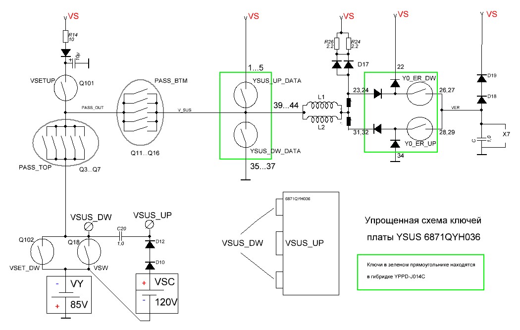

                                        hello tom66,
                                        I have replaced the ipm but the problem is still there : no Vy voltage. In addition, there is no Vs voltage on the resistor R14 (please see the diagram attached).
                                        do you have any idea ?
                                        thanks
