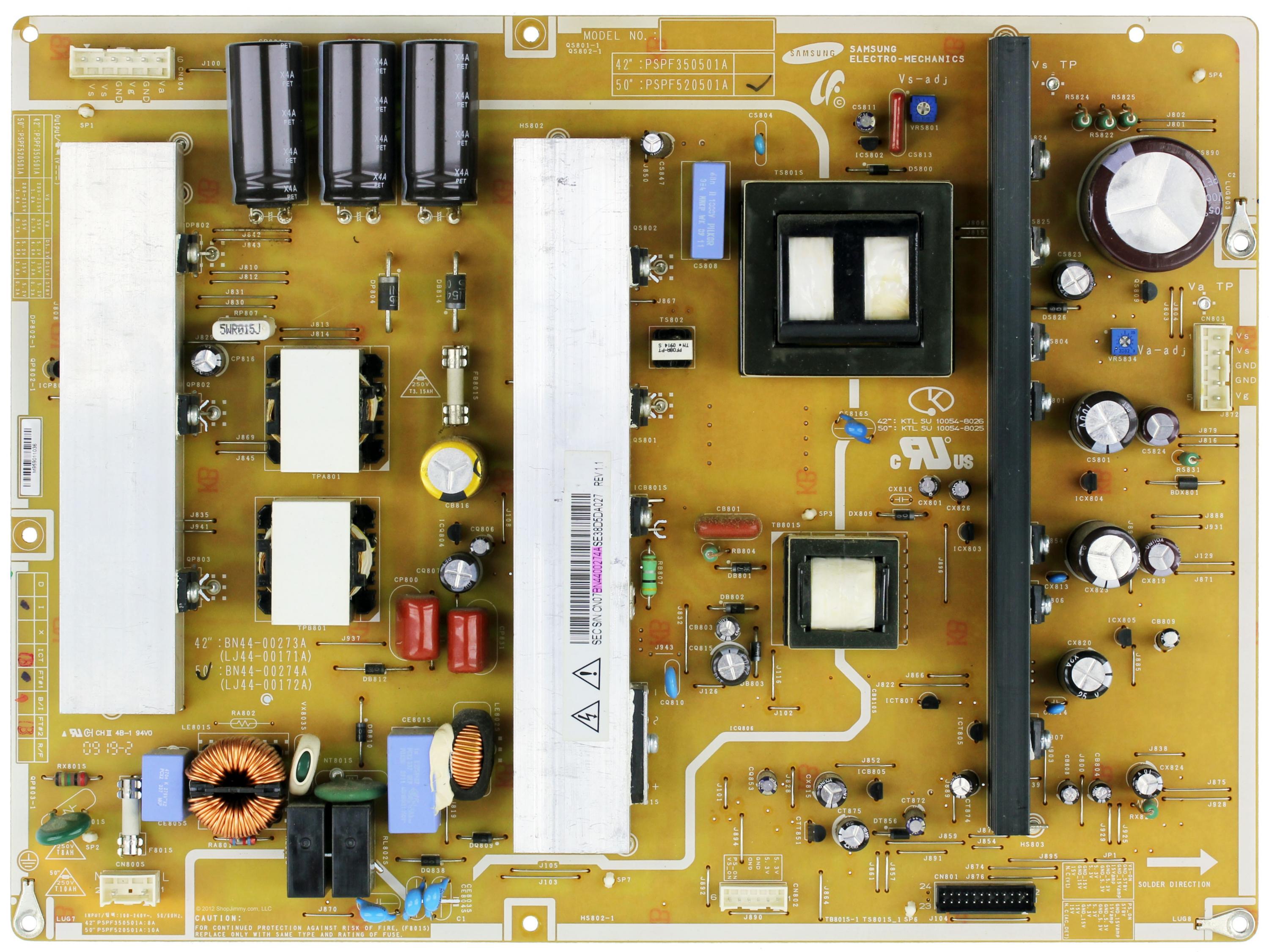

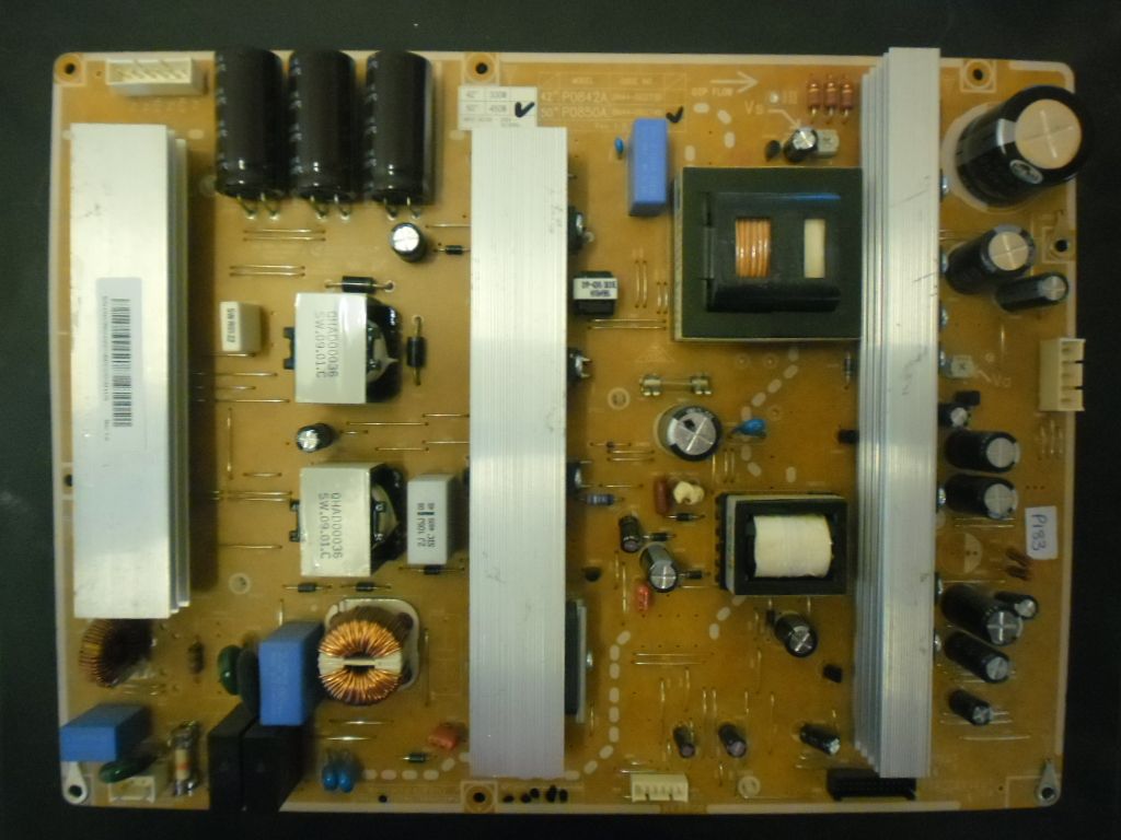

    if anyone can help, im trying to locate a part number for a samsung ps50b550t2fxxxy, power board number p0850a rev 1.2
    location number dm 806 and dm 807, underneath the relays rl801s and rl802s.
    if anyone can help or point me in the right direction for these smd diodes, i will be forever grateful!

    Not giving us much to work with. photos, part # of PSU? Are these diodes still identifiable, markings on the casing?
    I don't know what part the board is , could be BN44-00274B.
    Found this schematic for an "A" version which might be close enough or maybe grab a magnifier and look for some marking. Can't be sure the schematic is correct but may help.
    I searched the doc for diodes numbered 806,807 plus the one in the cct connected to the relays kds181. maybe you can trace what they're connected to on the schematic and work it out.
    DP805 & 806 on this board?

              "location number dm 806 and dm 807" I do not see them in the pictures of POST2. Do they tested bad? If the Diodes are in parallel with the relay coil for spike suppression, then it will read both direction due to DC relay coil resistance.
              Photo and P/N of YOUR board?
              By the way, the two relays as shown in post 2 are setup as power on/soft-start for inrush current limitter.
