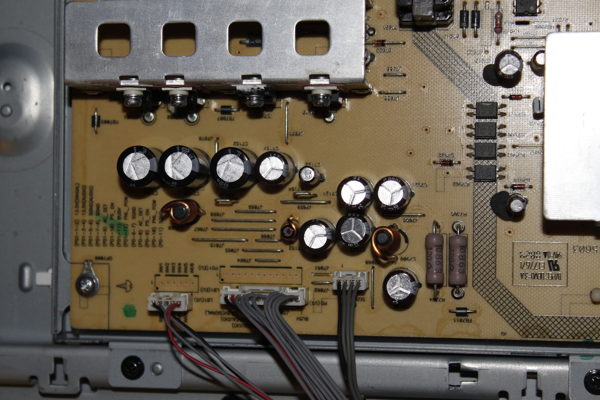

    Hey - I upgraded the firmware on my lc-52sb55u today, and I think something went wrong with that.
    I updated the firmware and the TV rebooted - and seemed to be working. I went out and came back later and found that the TV wouldn't turn on with the remote - then tried with the power button. Nothing happens with the LEDs on the front at all when the button is pressed.
    I checked all of the PD pins, but see 0V on all but 3.1V on the AC_DET pin and 4.9V on the BUSY pin. I tried to see if the PS_ON pin would get voltage for a moment when the power button is pressed, but no luck.
    Have any ideas on what to check next, or will I need to buy a new mainboard?
    This site has been awesome - I have read up a lot on all of the related issues I could find.
    Thanks for taking a look!
    Paul
  • fixmytv
    • Apr 2013
    • 4
    • US
    Re: Sharp lc-52sb55u - No power LEDs when I press power button
    I've also tried some of the tricks suggested to restore firmware - holding down the power button for 5-6 seconds while plugging in the tv. It didn't seem to do anything at all.
    • fixmytv
      • Apr 2013
      • 4
      • US
      Replacing the main board solved the problem.
