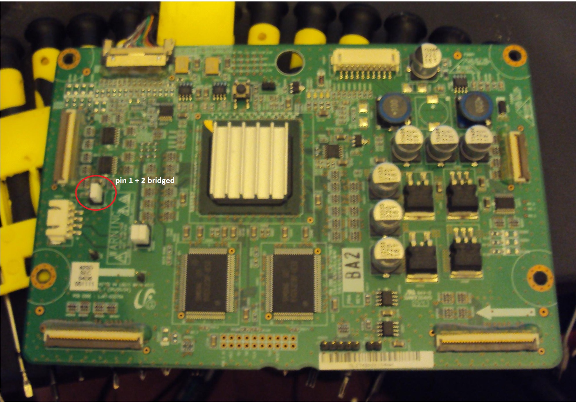

                                  Re: Samsung PS-42D5SD Blank Screen
                                  not sure if this is the correct place, just using the old board as reference rather than take it all back out right now
                                  only 4 pin connector i can see on the logic board, as shown 1+2 are bridged
                                  what am i looking for removing the lvds cable and bridging 3+4?
                                  do i still connect the main board?
                                    just tried the 3-4 jumper with lvds cable disconnected and main board connected, don't get the flash off the image now more just that the screen turns on like before not sure if thats just the tv not getting lucky enough to display the flash
                                    it still does reboot again and again too
                                    another thing to mention, been like this since i got it but it doesn't always make the samsung turning on noise sometimes it will sometimes it doesn't, more often than not it plays it when the tv reboots a few times

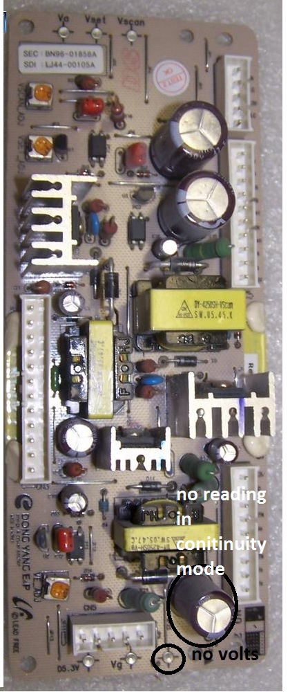

                                      not sure if i'm onto something here or just me guessing at a wild goose chase
                                      just thought i'd make sure all the voltages are correct for the vscan va vg etc (correct settings are labelled at the top)
                                      anyway they all pretty much read correct within a few volts anyway all but the VE test point which gives off no reading
                                      attatched a picture to show this, not sure if i've got this right or not but i took off the psu board (where the test points are) and just started testing the few caps that are on the board
                                      one of the caps gives no reading (again not much idea what i'm looking for) whereas all the other caps do give off a reading in continuity mode these being high voltage caps too, again not sure if i'm getting this right but to me would that indicate the cap is bad and it's not provding the volts to the VE? (sam young caps)
                                      any help or guidance is much appreciated
                                        little further i think
                                        disconnected both x and y mains from the DC SMPS and the VE still does not output any voltage at the test point
                                        so i'm either looking at a bad DC SMPS board or bad POWER Supply board correct?
                                        is it possible for the power supply board to not output a VE voltage? as looking through various service manuals i can't see a pin out for the VE voltage on the power supply board, only on the DC SMPS board, from reading is it correct that the DC SMPS board converts the voltage, another boards £10 but the cap i think is at fault is £2+ for a panny cap
