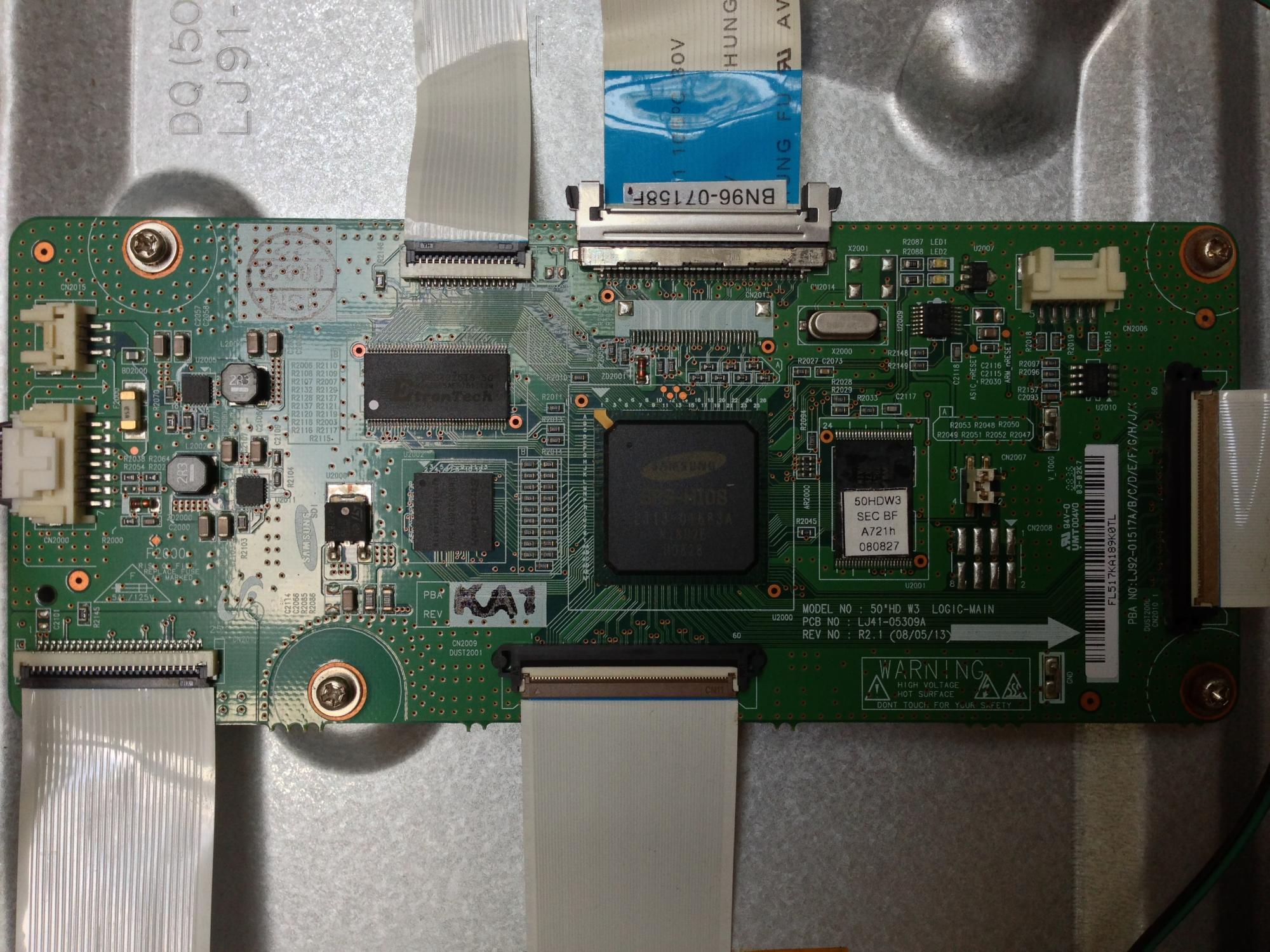

              Re: Samsung Plasma PN50A400C2DXZA
              You may have a bad control board then. Does the LED blink five times then pause for two seconds repeatedly, or is the blinking steady?

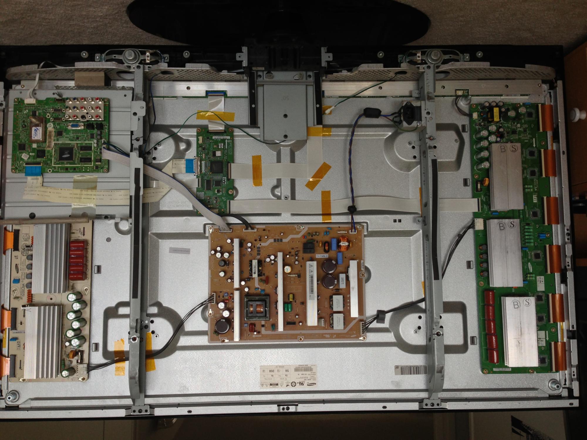

                  Here is a picture of the rear of the TV in question as well as the logic/control board.

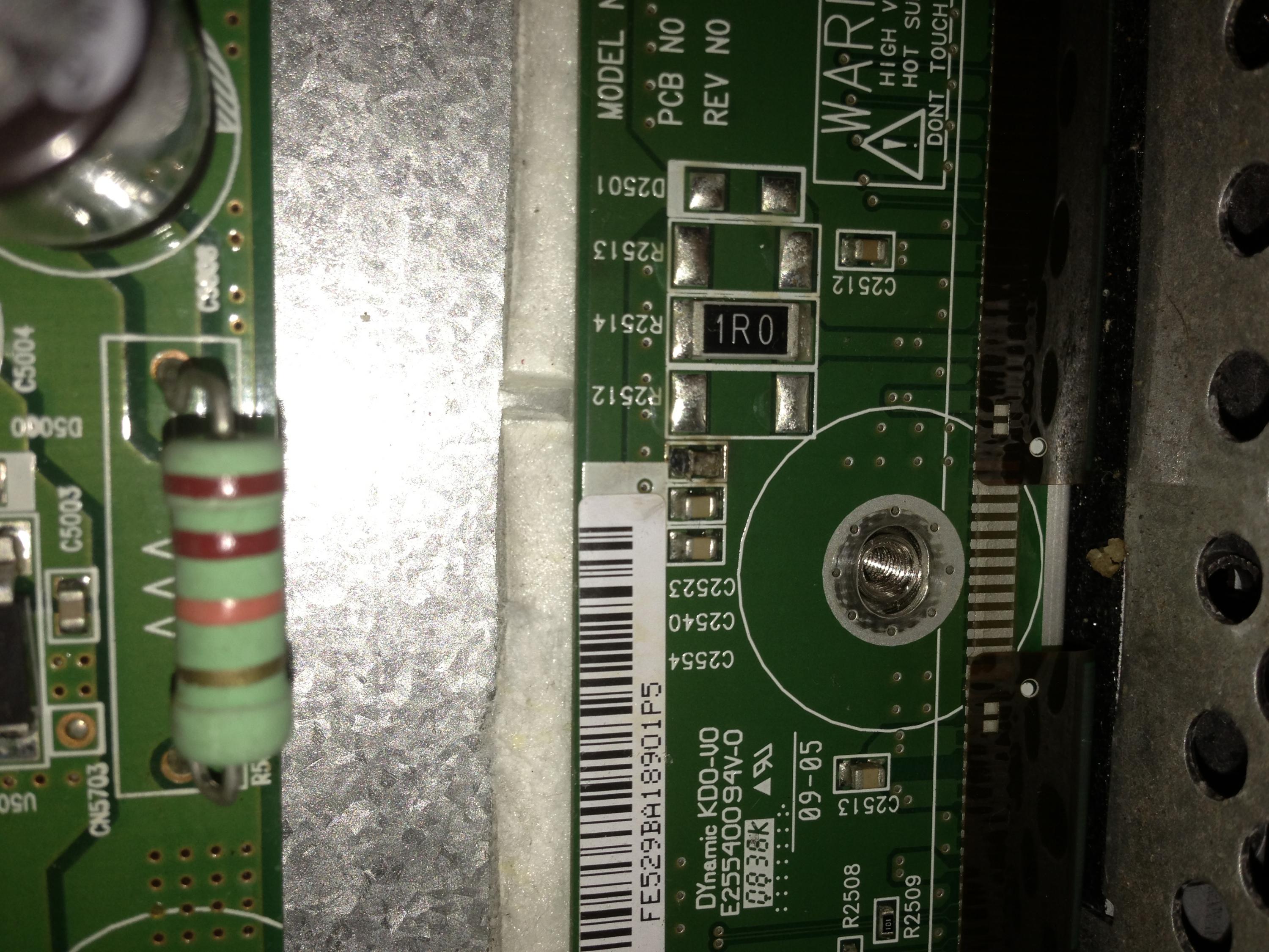

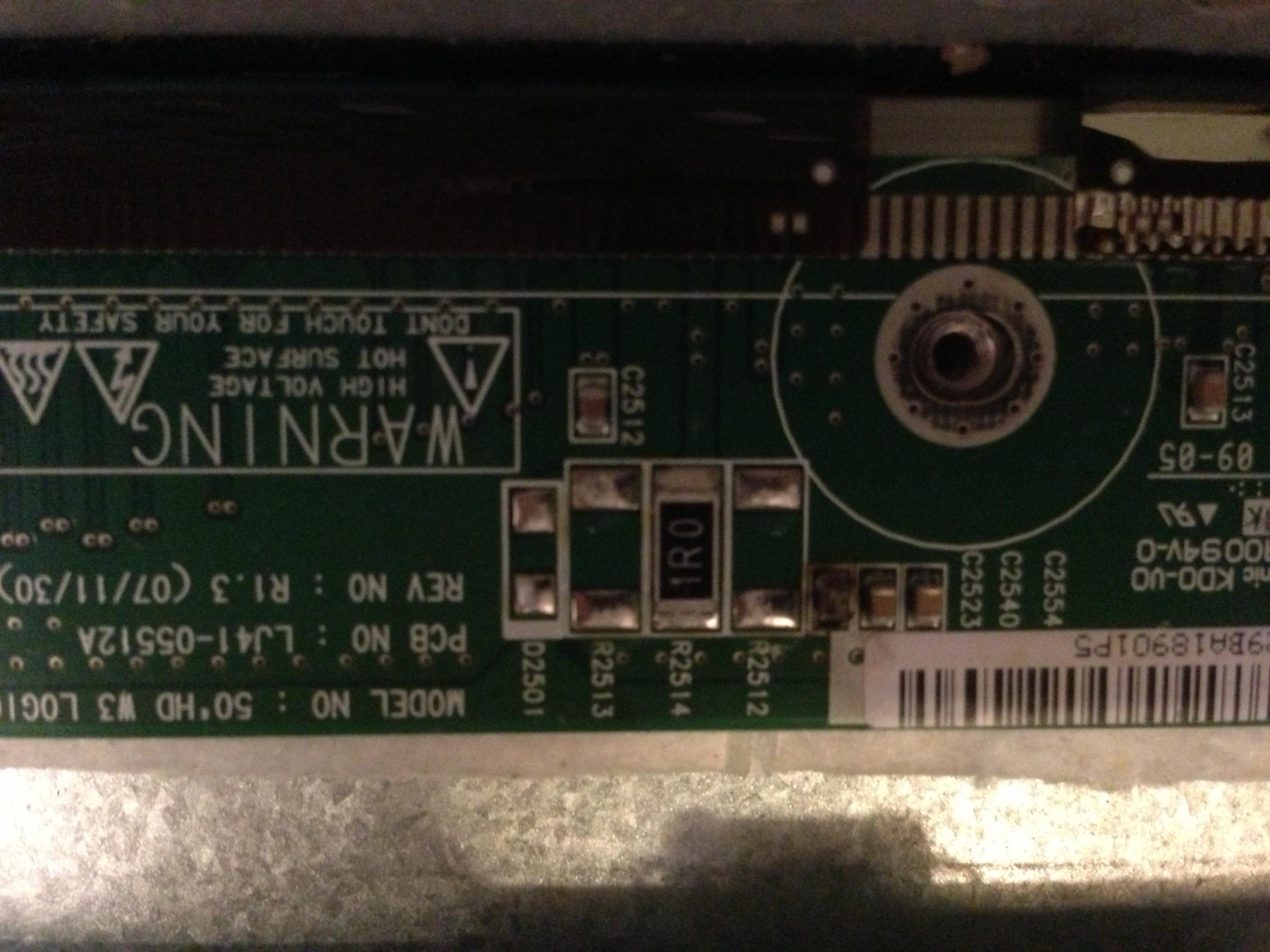

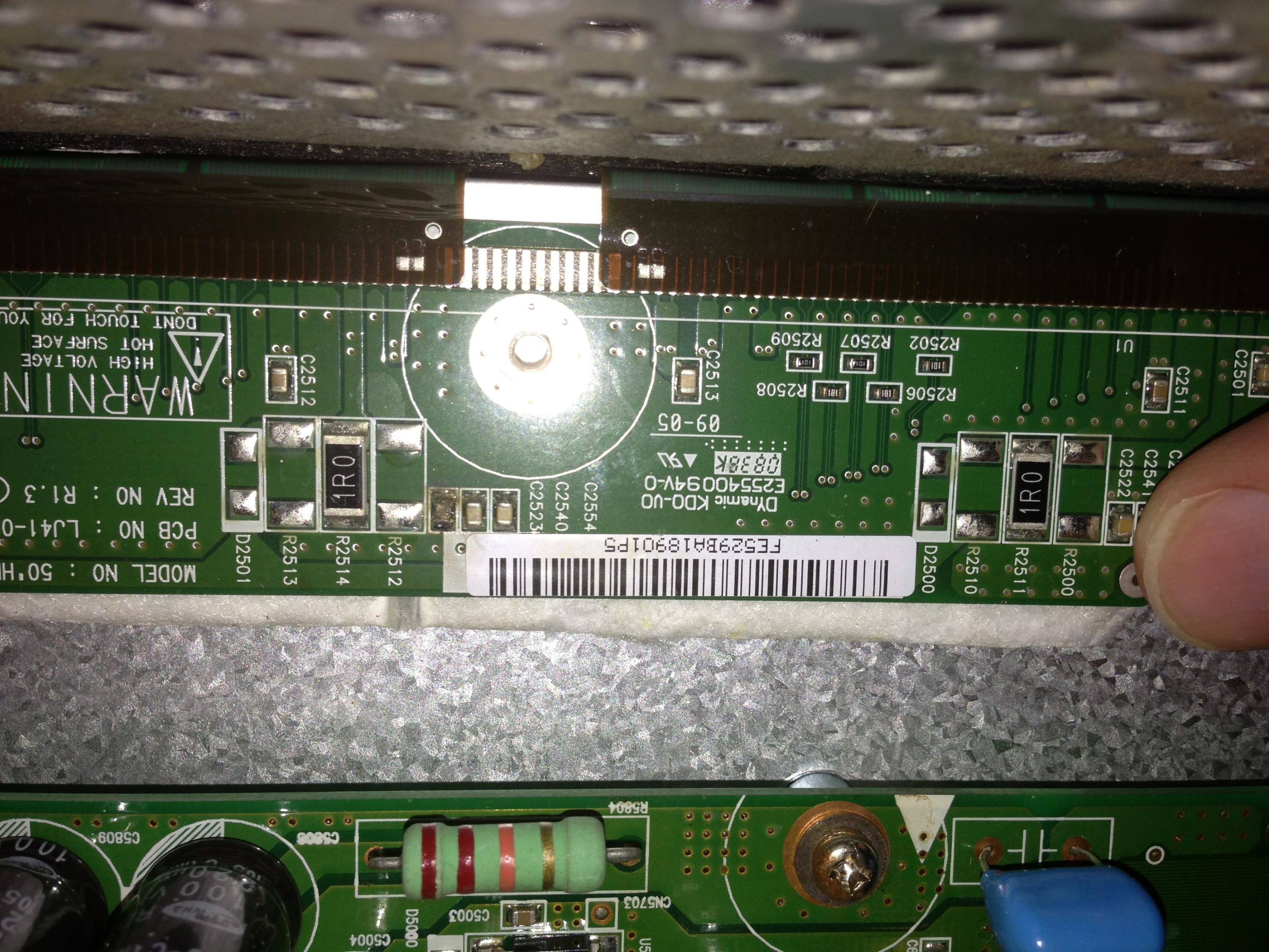

                                    So, I decided to inspect those buffer boards closer, in particular, one stood out: PCB number LJ41-05512A has something that looked as though it could be burned, it's almost as if the solder is gone. Anyway, here are some photos:
                                        It looks like the capacitor burned up. You should check the resistance of the capacitor as it may be shorted. If your fuse is before this device, it could be what caused it to blow.
