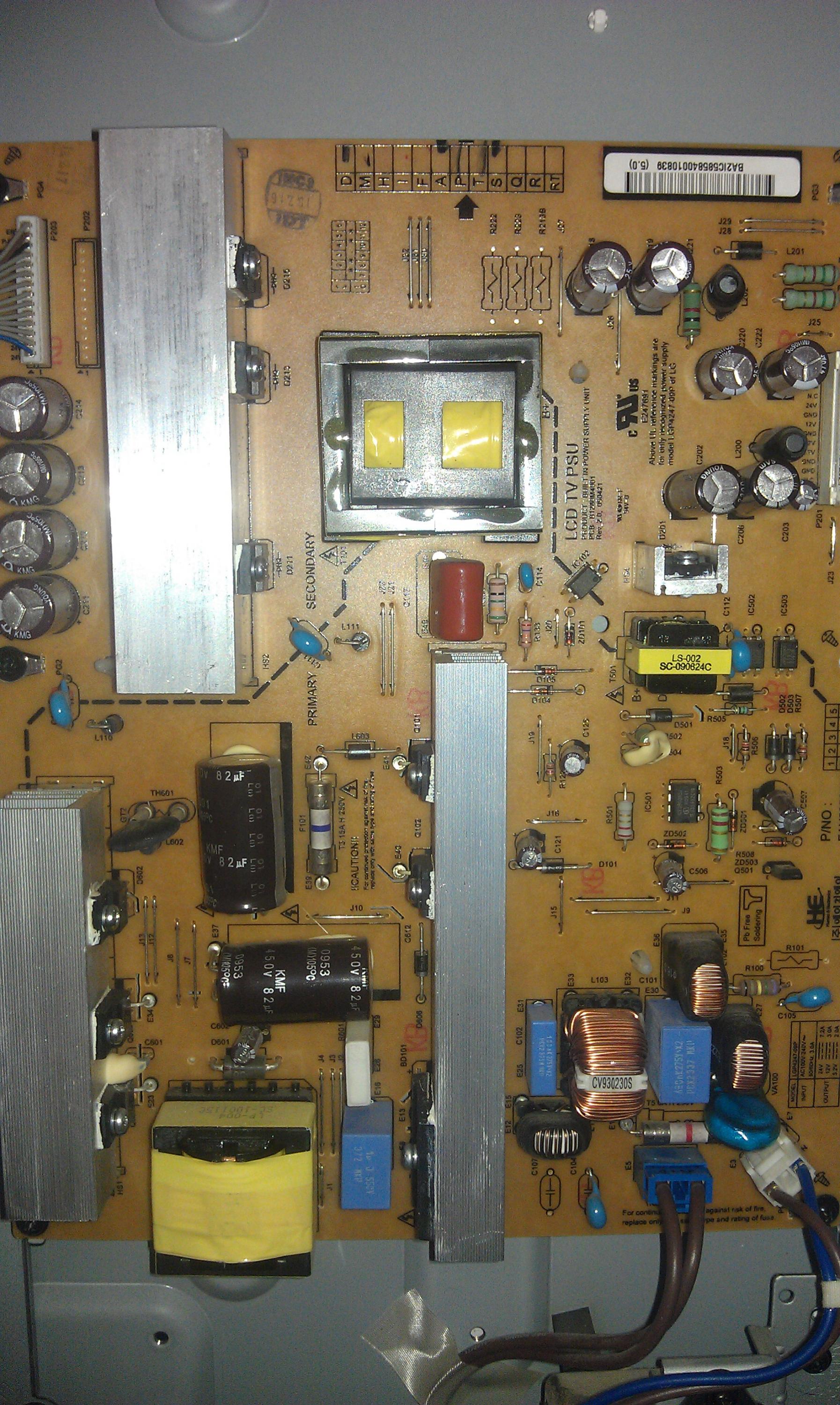

    I've searched around for awhile now and still can't find anything.. Its a LG 47lh30 with main board from a 42lh30 (replaced). I checked all the power outputs from the power supply board to the main and inverter boards and they are all correct. It starts up but after 5 seconds cuts off (dark green screen with a horizontal line)
    Did notice the power output voltage on 42lh30, to the main board, is 20V instead of the 47lh30 24V. These boards have the same part number. EAX567381, is this correct?
    Thanks in advance for any help..

      Re: Puzzeled..Do I have bad caps? Video
      I would guess the board is incompatible you should be using numbers from
      a bar code sticker? on the boards. Did the seller confirm it was compatible?
      Does the eax number not have more on the end (05)? (01)?
                  hmm so you have a board outputting 24v to the main board which is expecting
                  20v? Dont think that will be doing any good.
                  If the mainboard connectors all connect ok to the tcon did you try using
                  the 42 power supply with the 42 main. Or for that matter all the 42 boards with the 47 panel?
                  Was the 47 yours when it went faulty - did you try and find what the fault was
                    tom66 Thanks
                    I checked the output voltage on the 47's psu and got the the 24,12,5.2's readings. The pcu came from a 42 which had 20,12,5.2, could this cause the pcu to crash?
                    Anyone know for sure the correct main board barcode # required? After looking online, I noticed a few different versions that people said came out of the 47lh30.
                    -EBU60680851
                    -EBU60680865

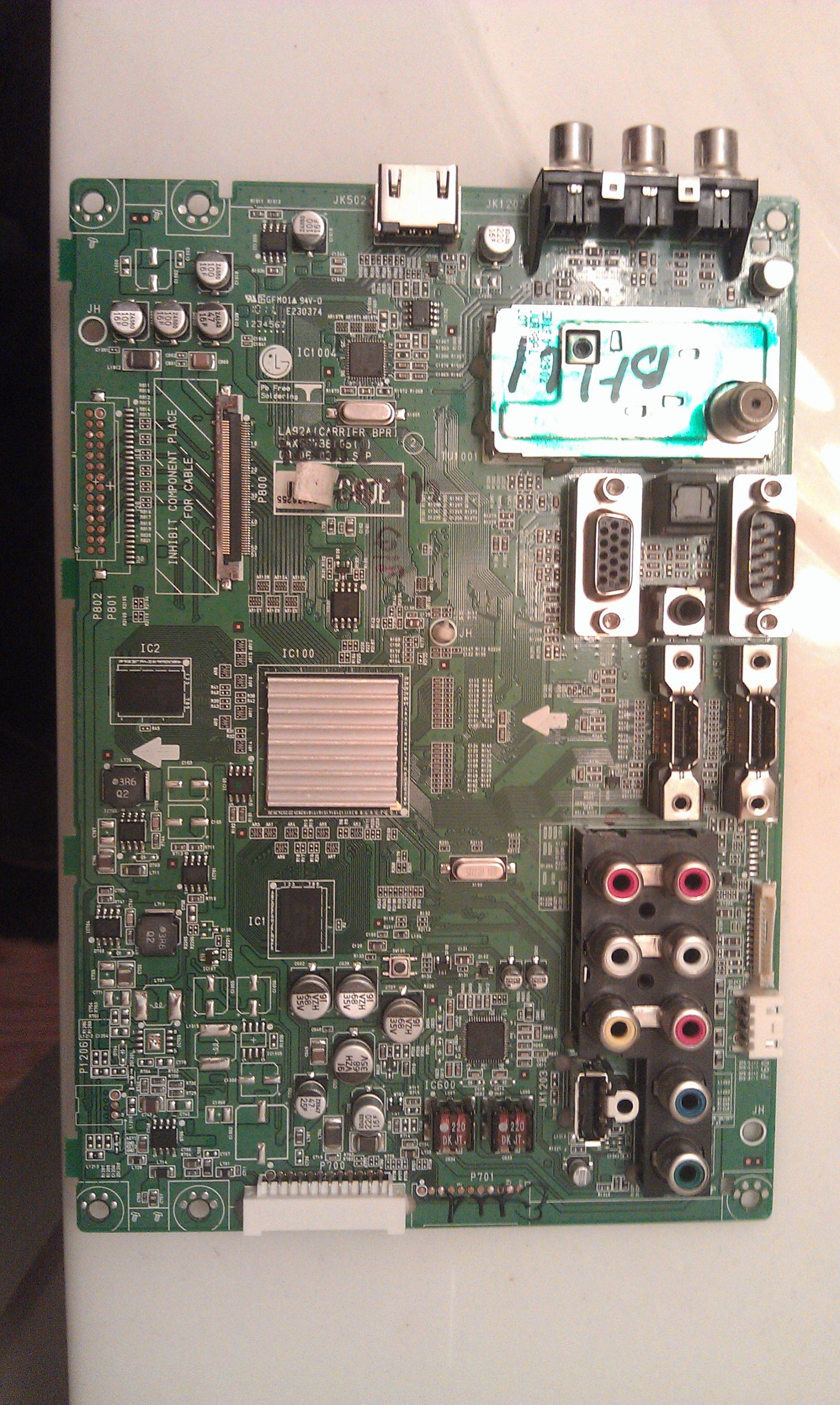

                            I think you need to tell us all the numbers on the 47 Main board you believe is faulty.
                            better still post a pic of it.
                            On the power supply there was another number which might have helped just above
                            and to the left of the eax number.
                            EDIT Sorry that is the EA number I am looking at.

                              Attached is the original board that came in the 47 that didn't power on. It did not have sticker with the EBU # on it.
                              Bought the 47 to try and fix for the house and then bought the 42 thinking the main boards were the same because the eax #'s matched.
                                  I don't follow, if you're referring to the mainboards applying that reasoning the 42 & 47 he has would be the same since he's quoting EAX5673810505 (0) for both boards.
                                  I've seen similar stuff with samsung. The pcb stencilled numbers are the same for 50Q & 50C91 plasma mainboards, however they are not the same and there was a separate white label which gave the true part numbers which were different.
                                  I believe the EBU on the white labels is what I'd chase down
                                  edit: and then I look his label and more confusion. Great! I'd still try and decypher that one unless there's a label which has come off?

                                      Do you know if that's the original or did the previous person swap it? All the pen markings are they yours or how it came? On the TV production label on the chassis can you locate the exact model version, that may help to work out what main you need.
                                      I'm expecting 47LH30-UA.AUSJLUR as that's the only 47" one I can see with a PCB EAX5673810505 (0)
                                      Just had a peak at the online parts listing here (AUS) for a 47lh35 and the main is referred to as a BPR Total Assembly EBU60723601, you can see the name CARRIER BPR above your PCB number EAX.....
                                        Im off the case for tonight - cant pull anything up on that bar code label!! although at
                                        a glance the board seems the same as the ones at SJs next clue might be to find the label on the back of the panel.
