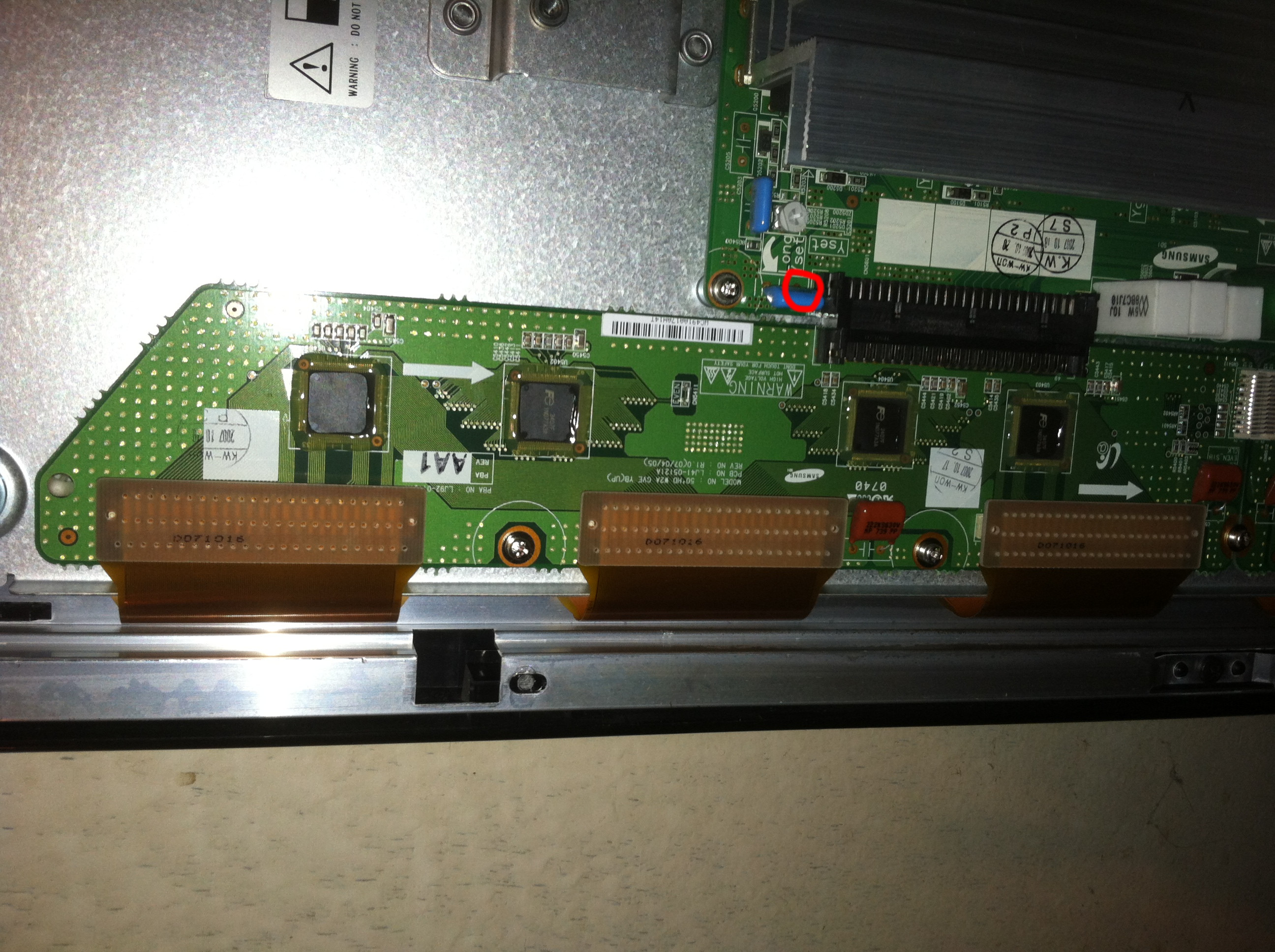

          Re: Another Samsung HP-T5064, Good Sound, No Picture
          I've got the scope. Where do I take the waveform from?
                            Here.
                              • johnboy1313
                                Ysus waveform with buffers removed

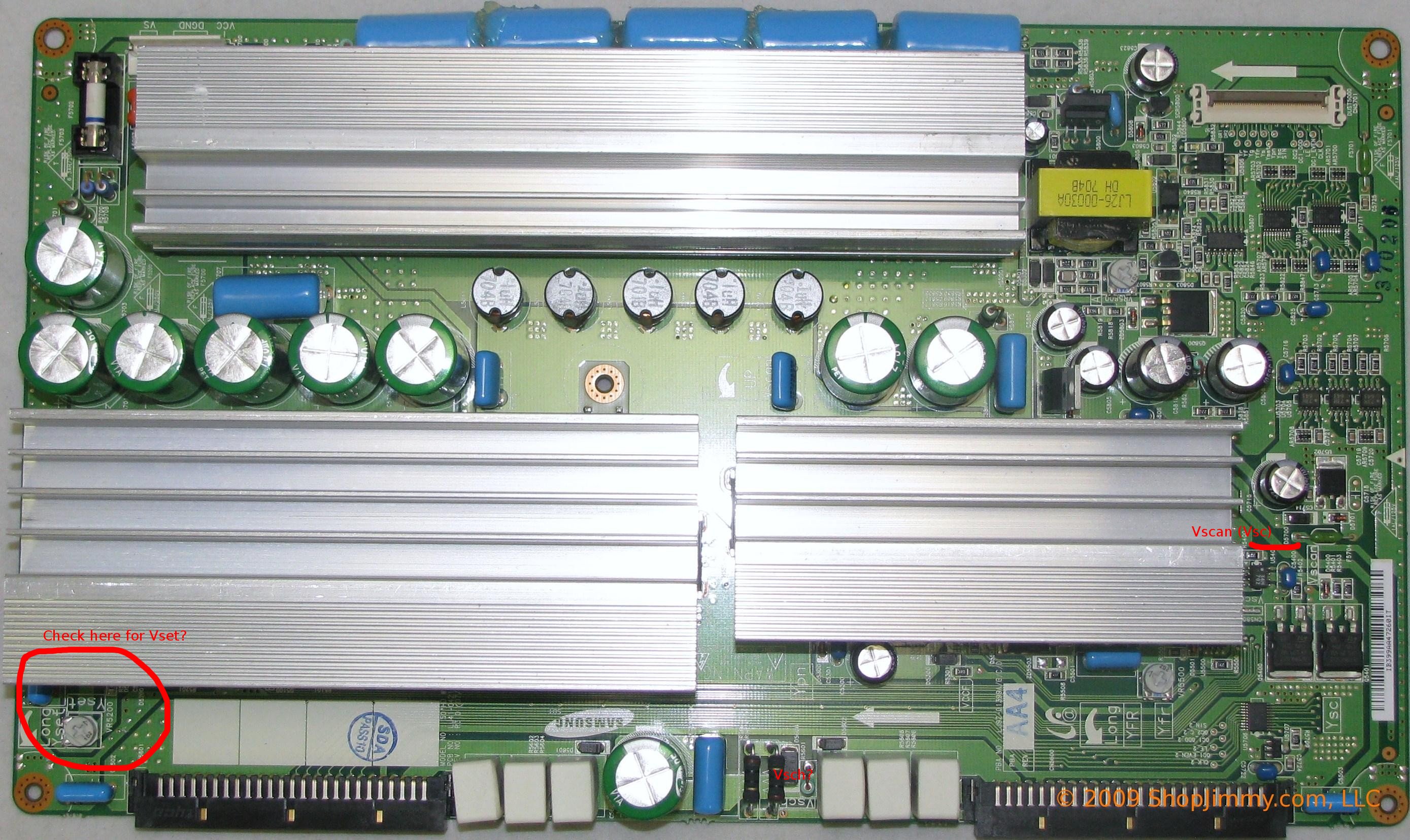

                                        I haven't been able to find any test points for Vset, Vsc, Ve, etc...
                                          #40
                                          See here for potential test points.
