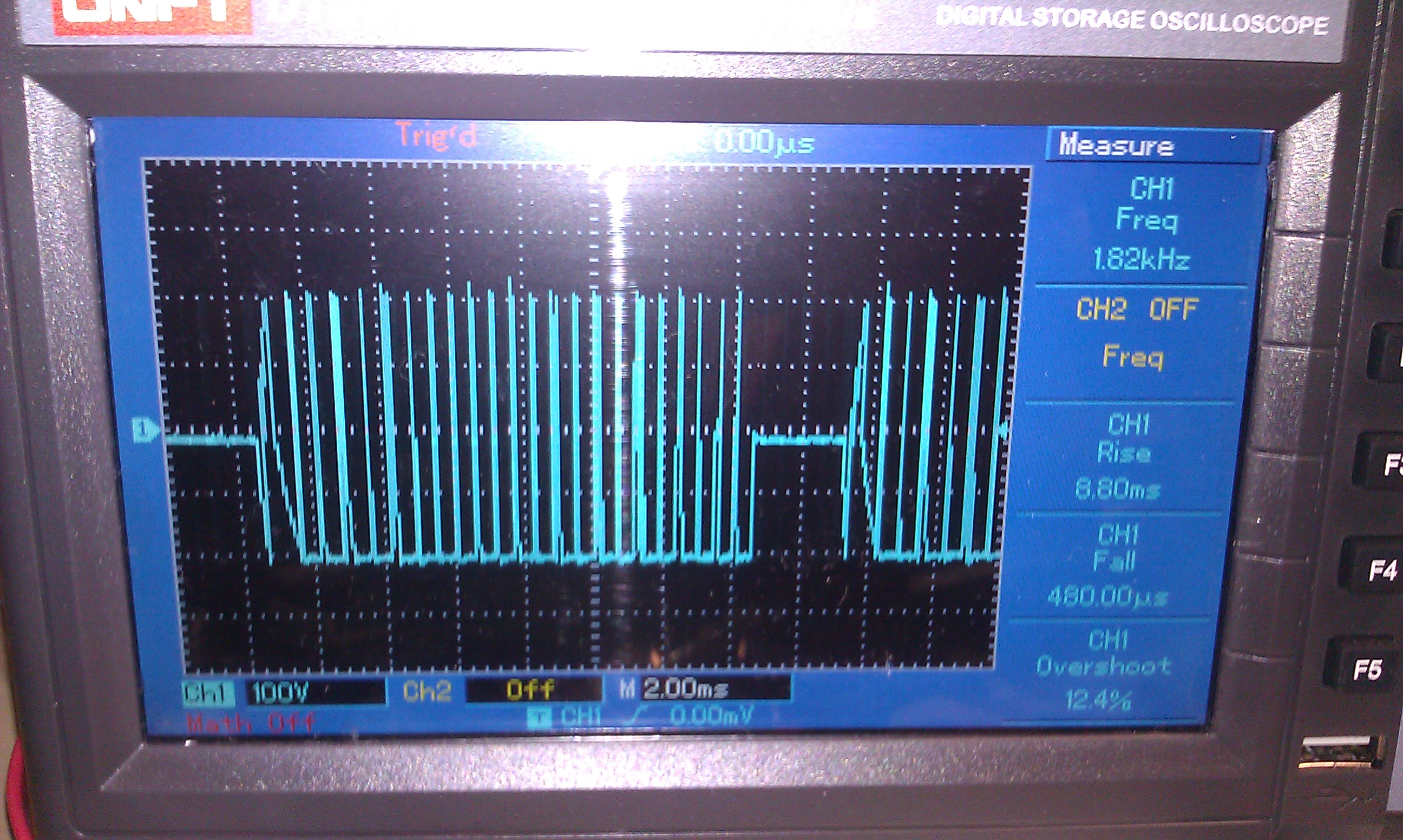

                              Set scope to 10X, 2ms/div, 5V/div (equivalent to 50V/div).
                              Take picture of waveform measured at the lead I highlighted.
                              • godzzila
                                • Mar 2013
                                • 50
                                • Česká republika
                                Re: Samsung PS42C96HD no picture/sound OK
                                ok i have pictures.. first is as you said only 100V per div (x10 set on probe and oscilloscope too so its right)
                                second is stoped and inspected a little.. looks good isnt it?
                                  Was that on AC or DC coupling?
                                  Can you try at 20ms/div.
                                  Looks a little odd to me.
                                    DC coupling i will post 20ms/div
                                      There it is.
                                        Yes, something is definitely not right with that waveform.
                                        The fields are all the same width.
                                        Here is a representation of a 5-bit waveform (yours will be 8-bit):
                                        http://w.pat.tc/WO2011111388A1fp.png
