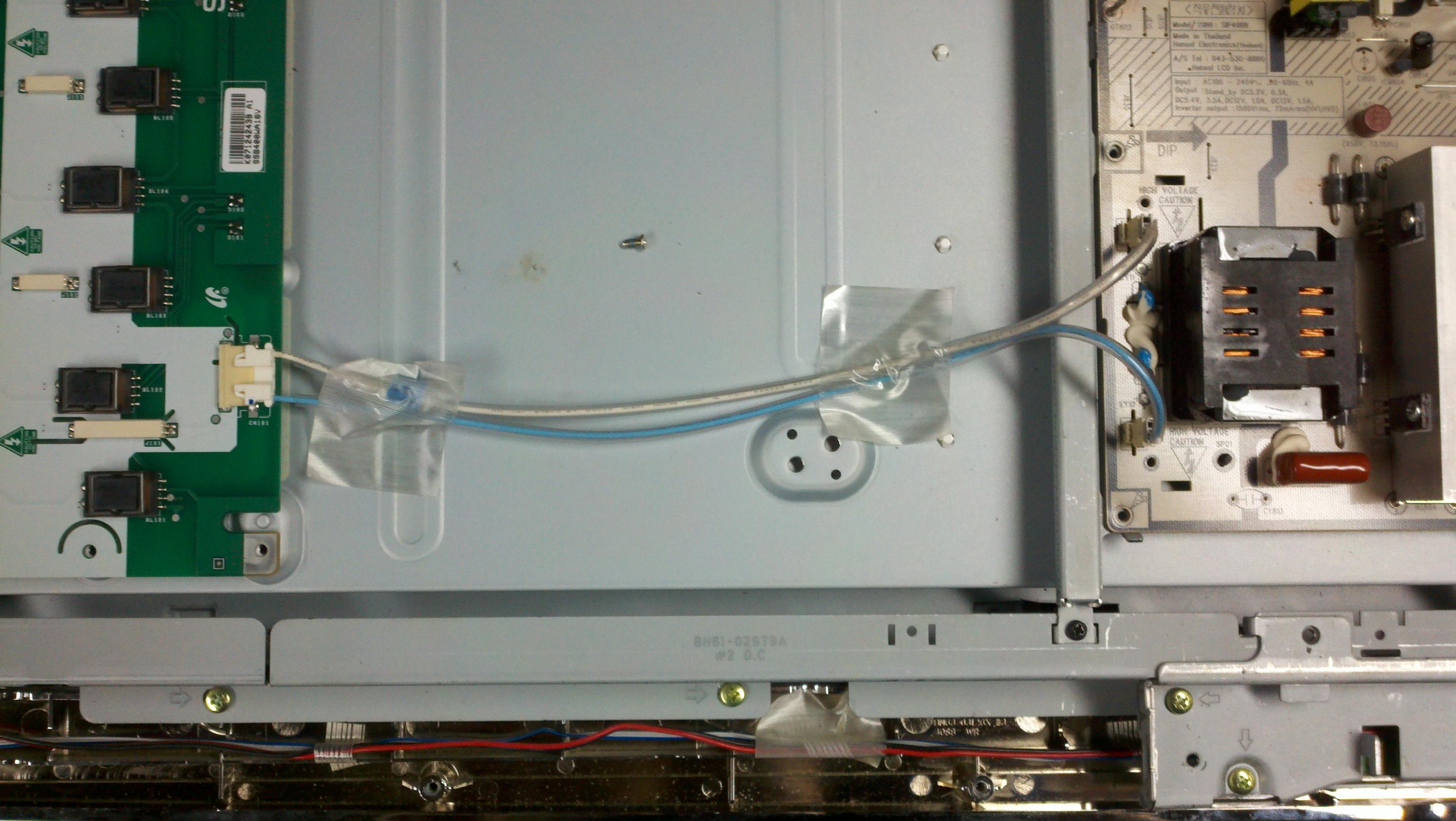

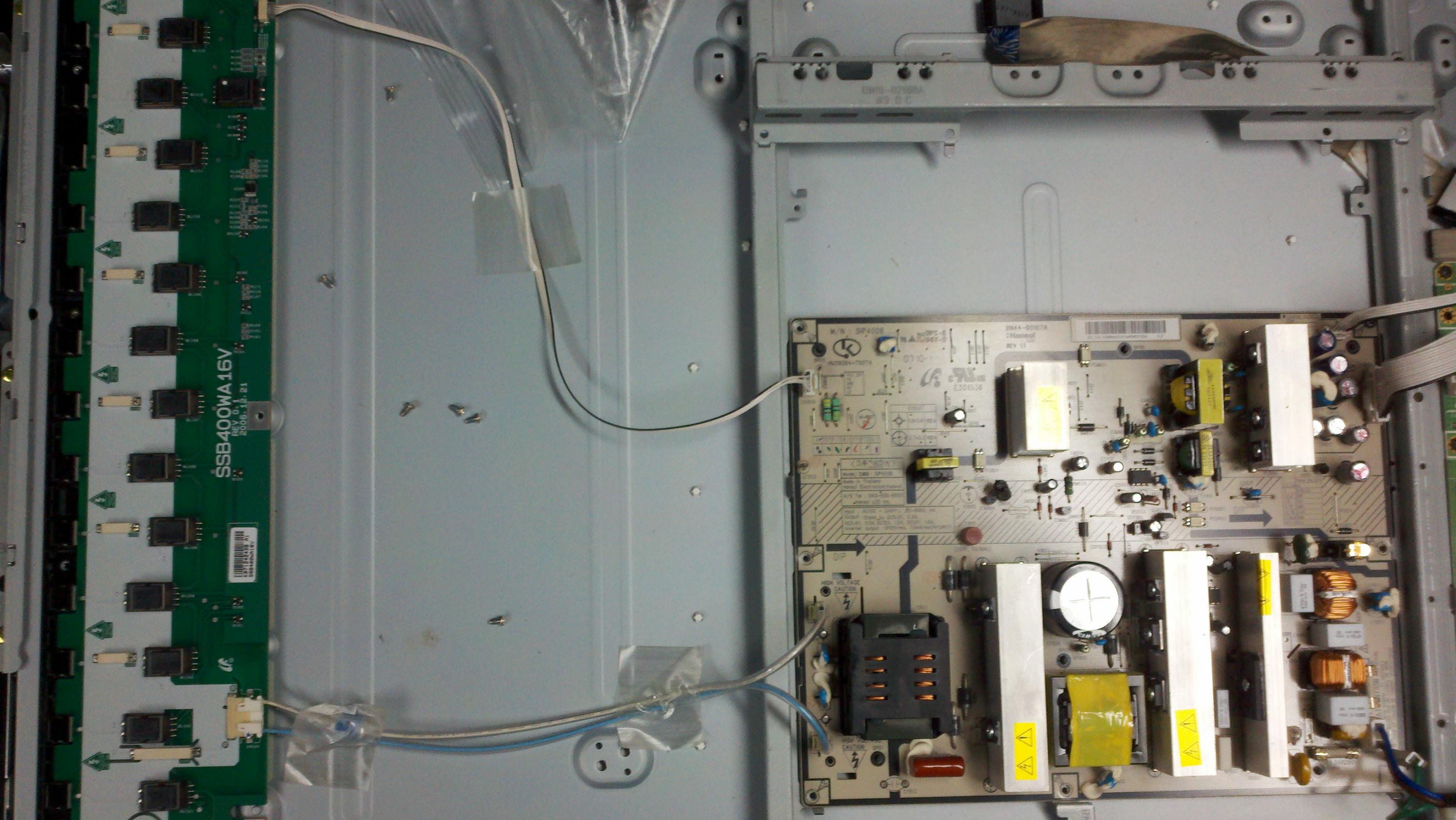

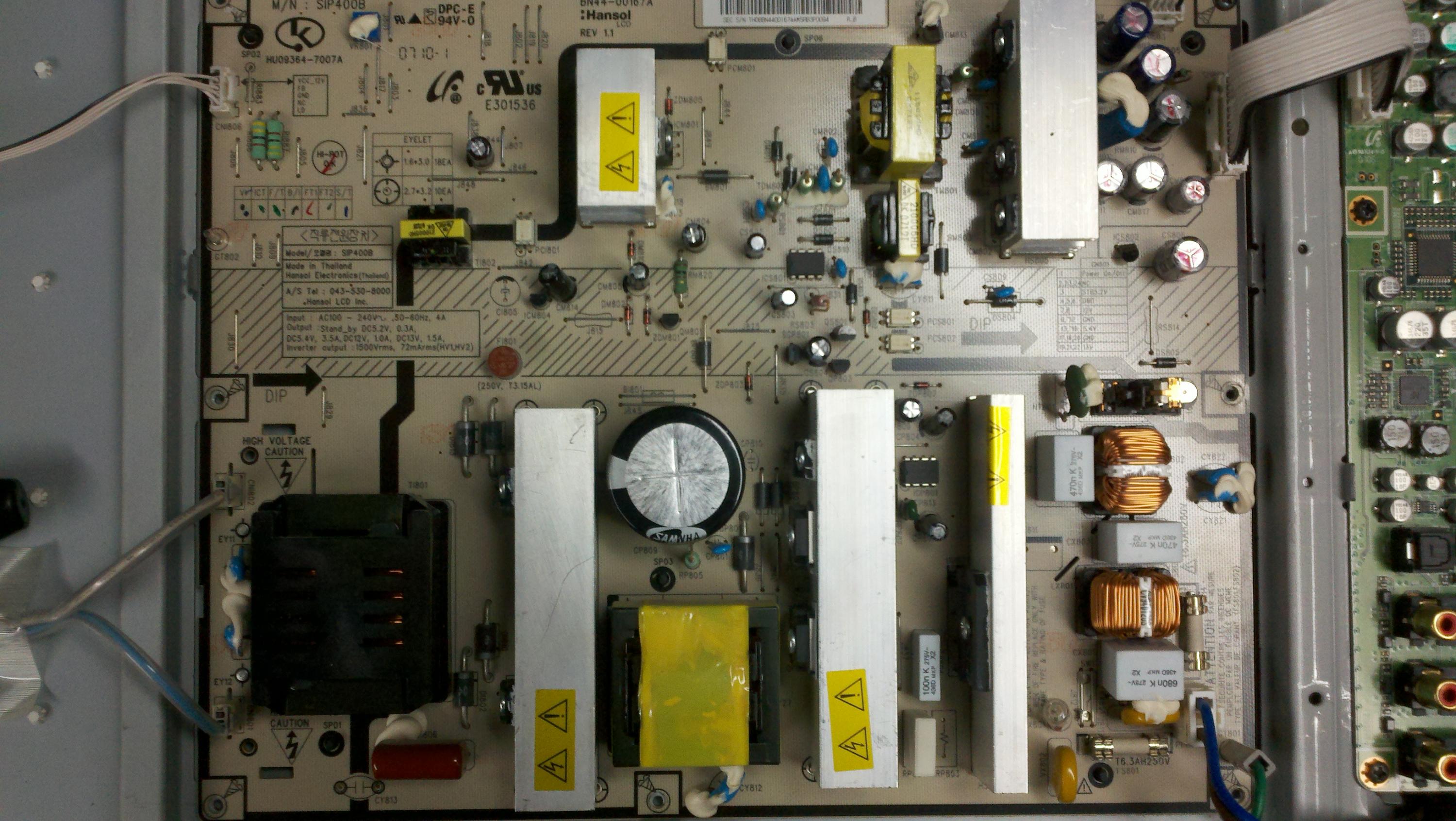

          Re: Darn need help guys samsung ln-t4042h 24v backlight problems
          some picks

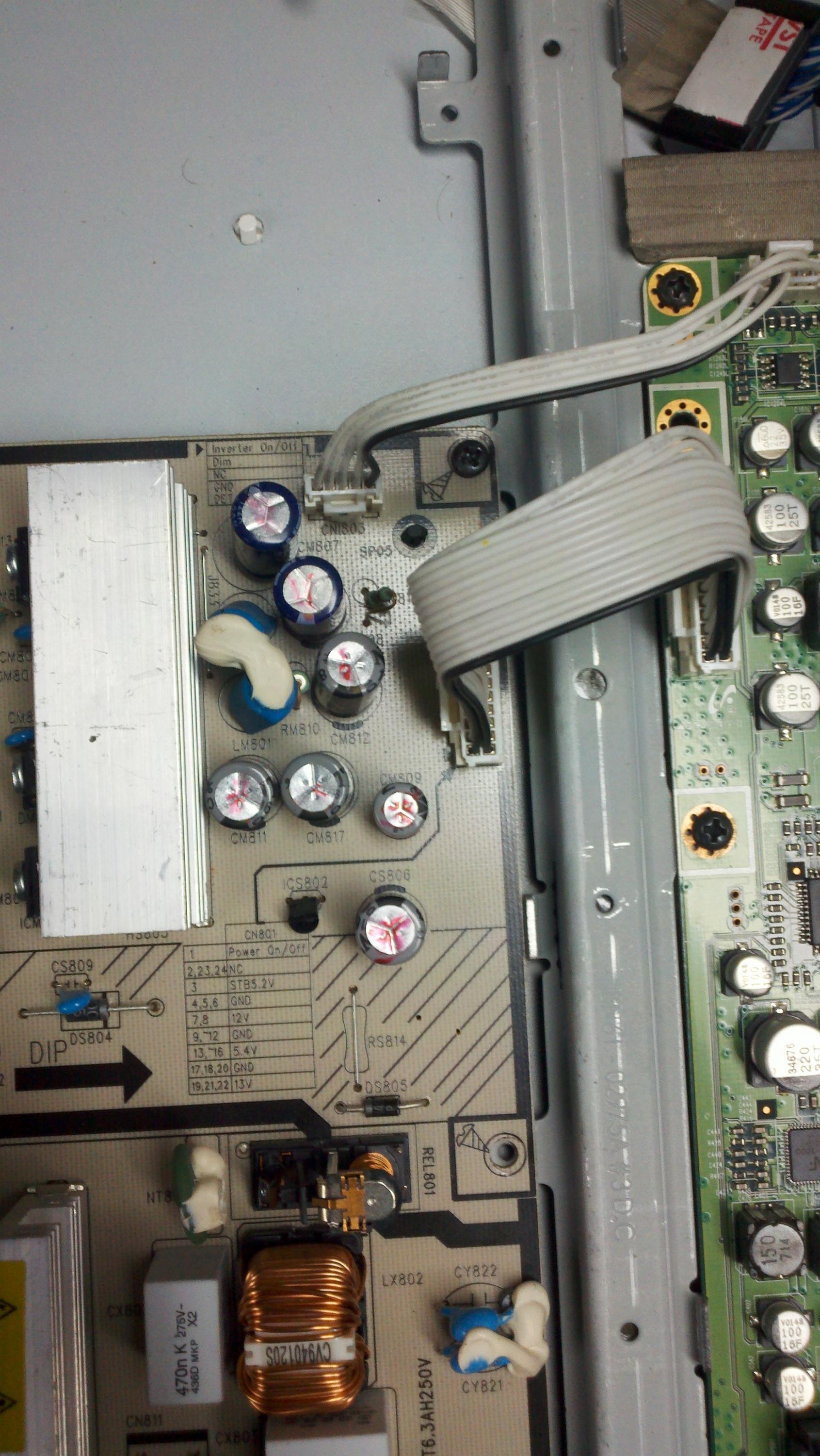

              iteresting above cn1803 it says inverter on/off above the 7 capasitors i replaced
              maybe the main board is not turning on the inverter...wonder if i could jump it..guess i could check it for volts...powered on and off ?

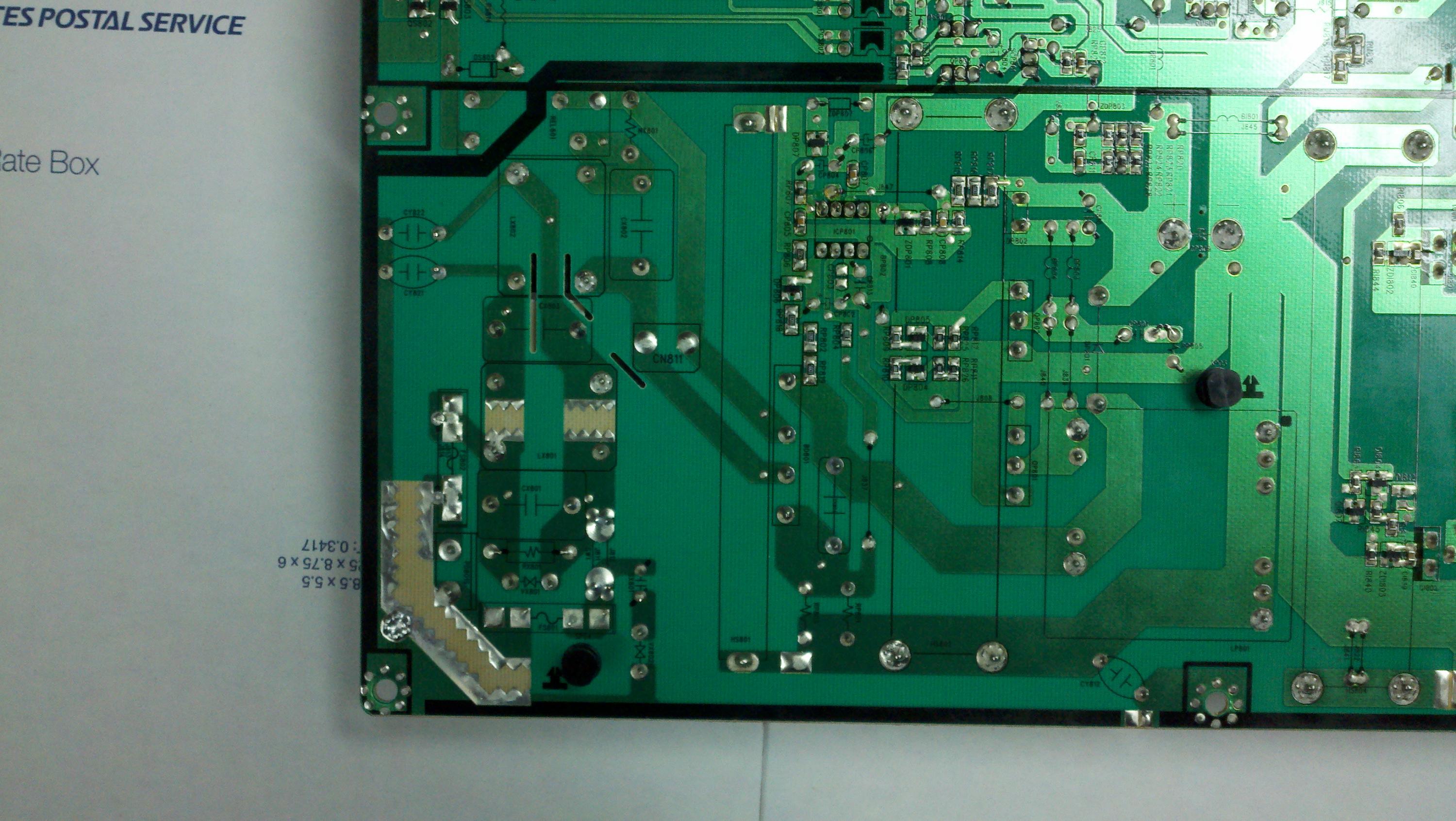

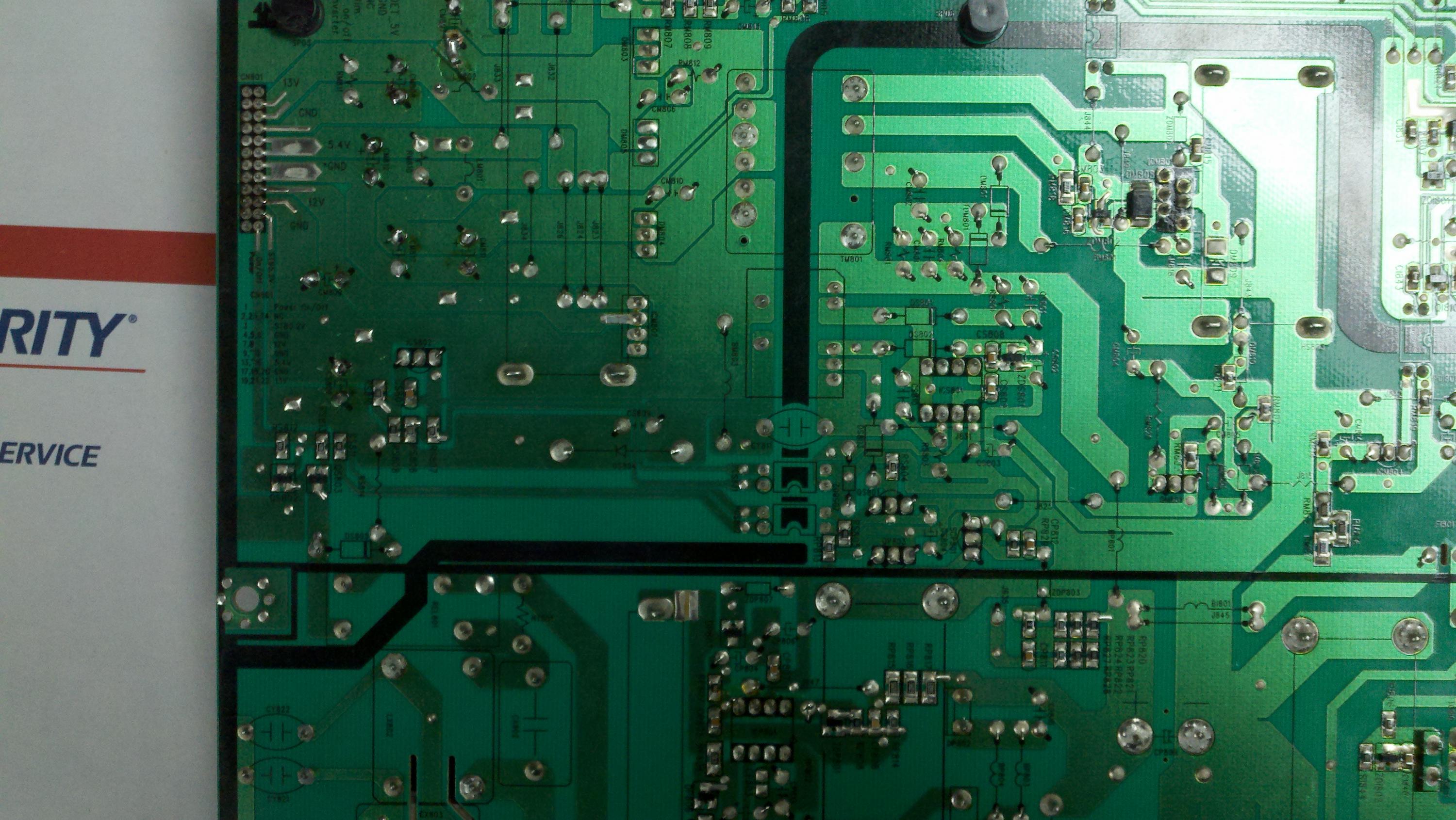

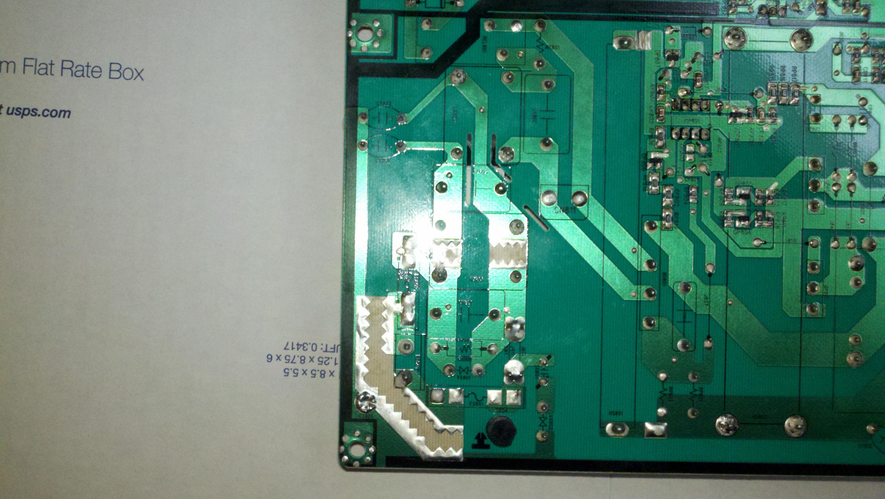

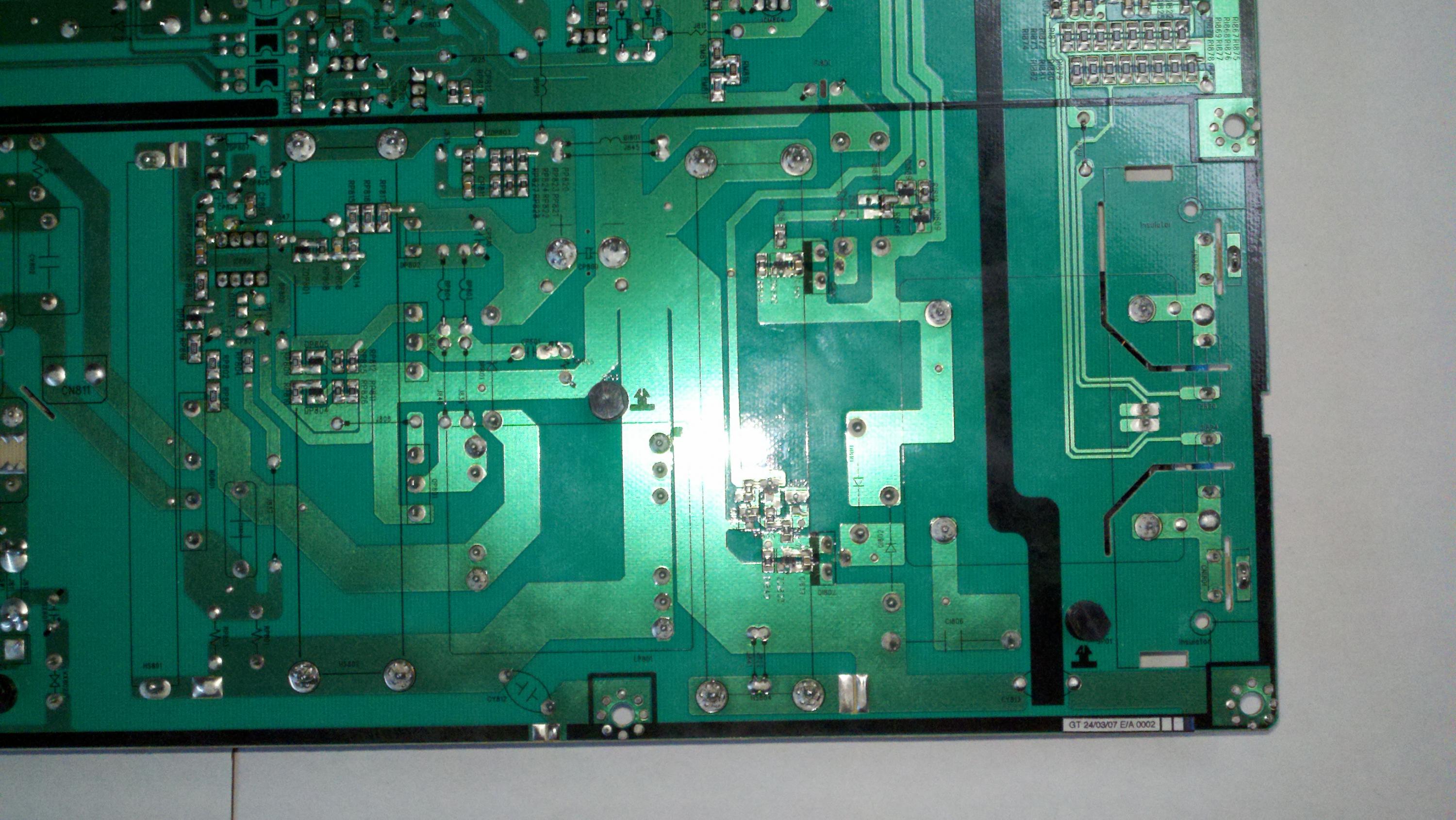

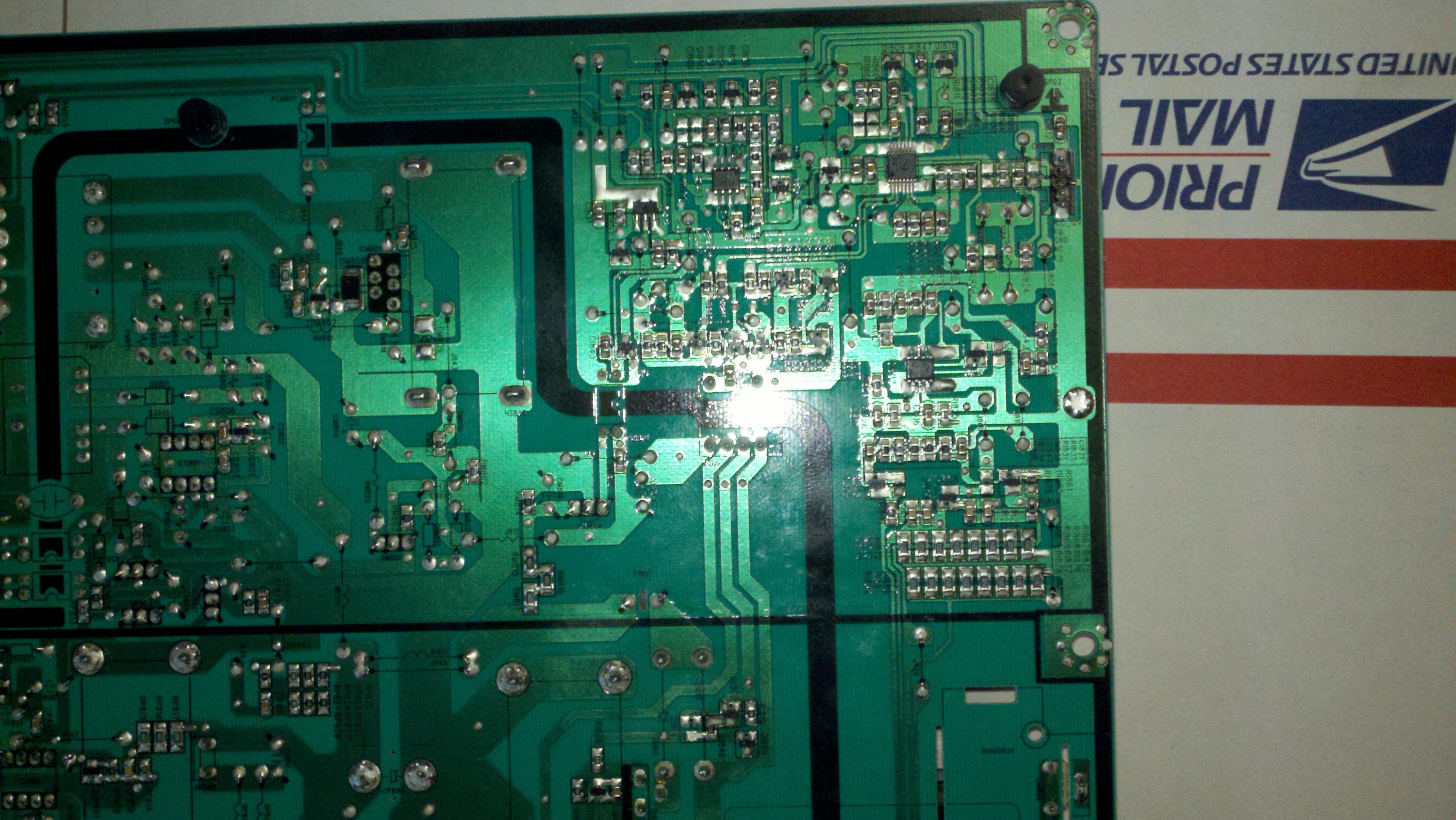

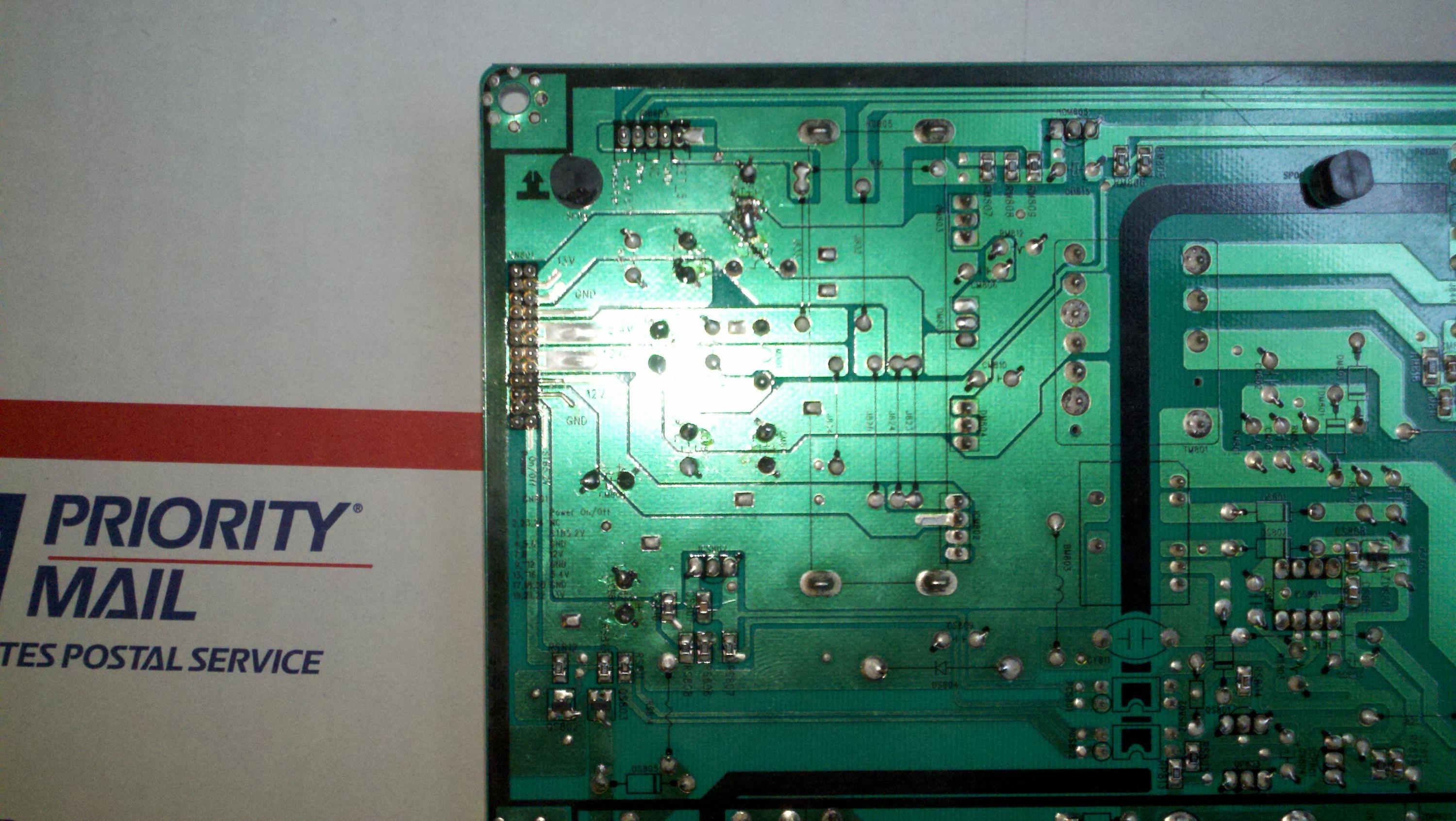

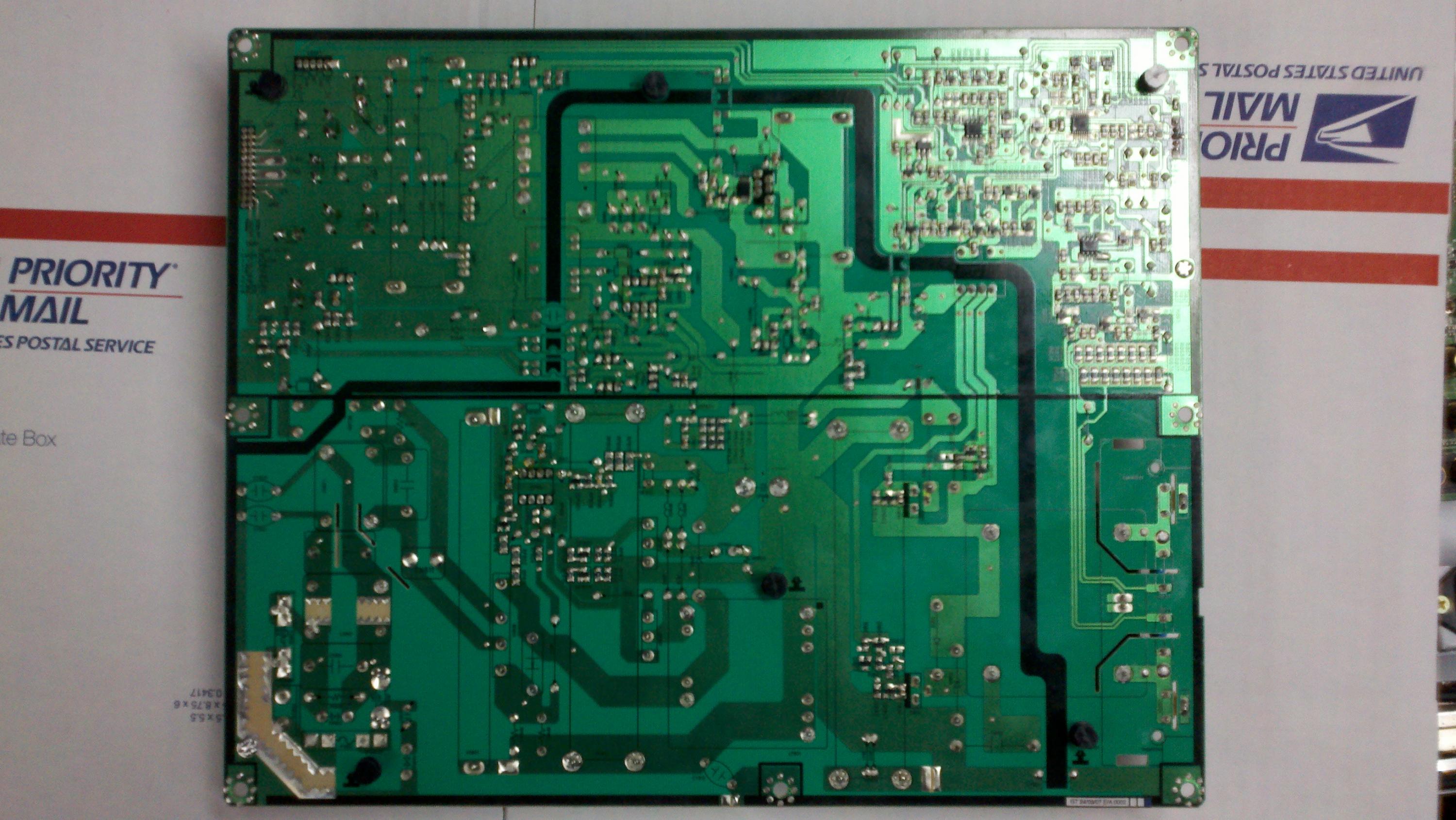

                    Get some really good close up images of both sides of the PS board.
                    Look for any dry joints on the solder side of the board too! Especially around the Transformers.
                      ok cn1803
                      1 0.02v relay goes off and on no change
                      2 3.34v
                      3 0v
                      4 0v
                      5 5.38
                        getting them close ups
                        • davewilson61
                          • Jan 2013
                          • 110
                          • usa
                          pics up...cant find anything BL
                                    cn1803 inverter on/off... its at 0.02v always add 5v? would turn on backlight no?
