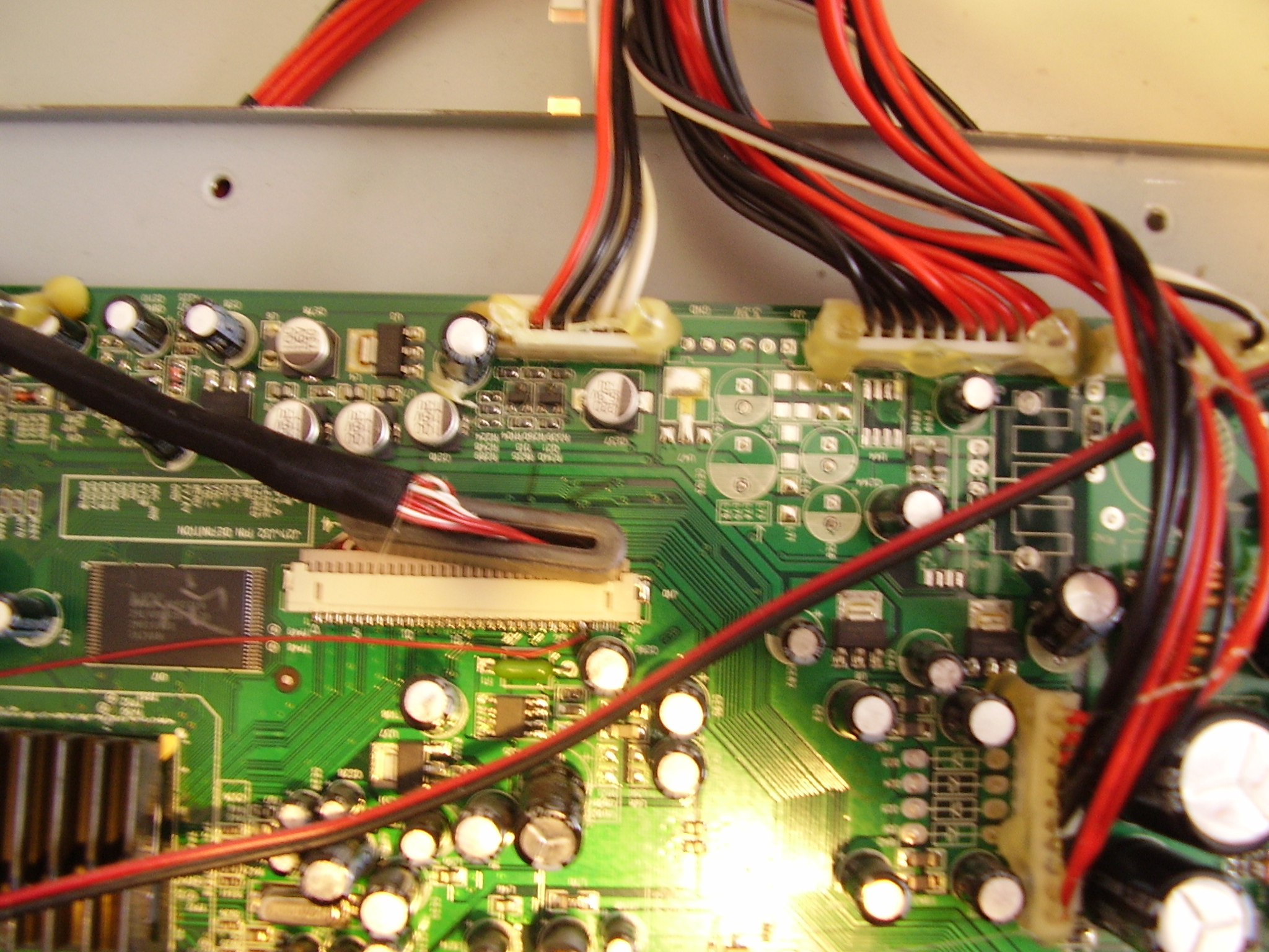

                I might have measured the voltage regulator the wrong way, i read it somewhere. but i measured it this time by grounding the black lead to a chassis screw and got the following readings. pin 1=0.00, pin 2=3.24,pin 3=5.08. When i try to measure voltage at the ps-on when i try to turn it on i get readings in motion including OL. Any ideas?

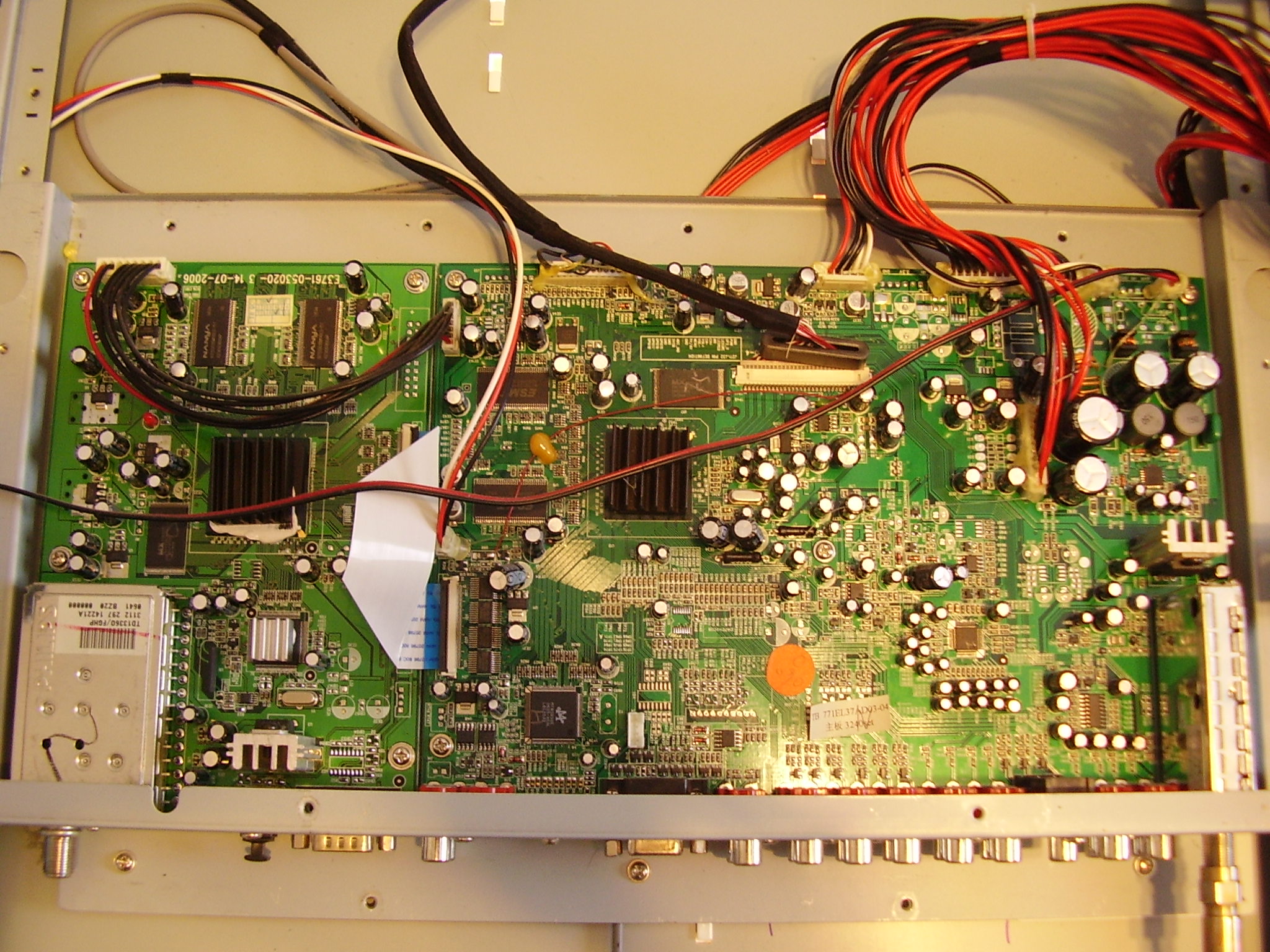

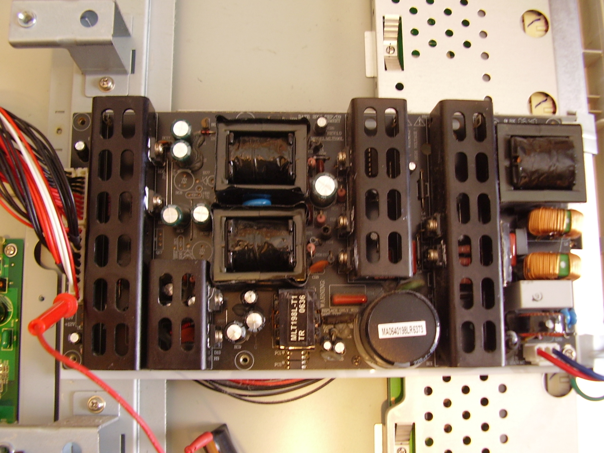

                  Hi guys, i am hoping one of you can give me direction with this ILO lct42ha3. I know its old and out dated to say the least but it was a freebie so i thought i might be able to bring it back to life cheaply.
                  I am not getting the 3.3volts to the ps-on but i do have the 5volts to standby,the tv would not come on it would just stay in standby with the red light on. i do have some bulged caps on the power supply and have them on order. I put 2 AA batteries together and jumped the ps-on and the tv came on and worked as it should,I even disconnected the batteries and it stayed on so are the batteries energizing something? if i shut the tv down it will not start back up without the batteries in place. Can these bulged caps cause this? I included a few pics of the main board and power supply
                    Re: 3.3k resistor
                    Yes, bad caps can cause intermittent or unstable power. Replace those to get a baseline before doing any further tests.
