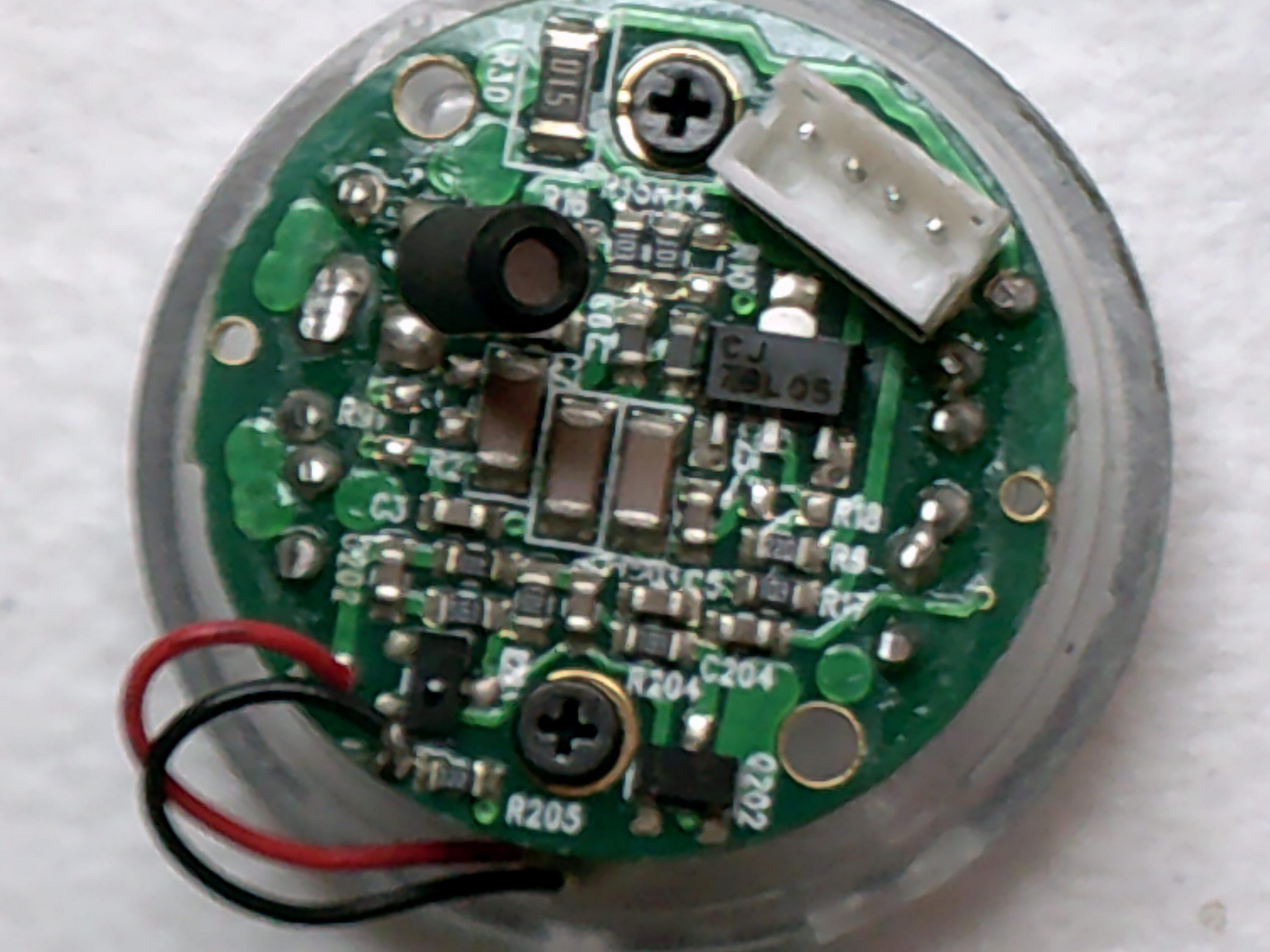

    I have a waterproof cctv cam(yellow=video, white=audio, black=power)
    I have no clue who made it but I did find a bad voltage regulator
    part# CJ78L05(datasheet below)
    The replacement comes from china for a total of $6
    http://www.ebay.com/itm/CJ78L05-Manu...item5651a3edc4
    I dont want to wait 3-4 weeks so I am looking at another replacement from digikey. I think I have narrowed it down but could use someone help.
    I need to know if I selected the right specs? I think I just need to verify physical size so it fits.
    http://www.digikey.com/scripts/dksea...7=5865&stock=1

    That's just a "jellybean" 78L05 so any of the SOT-89 package ones should work fine.

      Digikey recommended http://www.digikey.com/product-detai...18-1-ND/382184
      I went through my link above and pulled out these SOT-89
      http://www.digikey.com/product-detai...MSCT-ND/804706
      http://www.digikey.com/product-detai...XCT-ND/2053106
      http://www.digikey.com/product-detai...FCT-ND/3042635
      http://www.digikey.com/product-detai...83-1-ND/586183
      I am only a hobbiest but arent my choices(with Smason's help) better than what they recommended?

        All are suitable -- may as well pick the cheapest...
