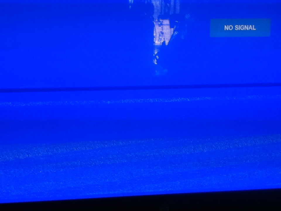

    Re: CPTOH-0603, (AKA:PDP50x3R010) Dim screen w/Retrace specs
    You were right. the replacement boards looked the same and actually introduced a horiz. dark line across the center see attached.. I'm sending them back. I'm back to hunting another main board. The best I can find is $150 with 180day guarantee but no returns if it doesn't solve the problem. I suppose they don't want to support guessing, I can't blame them. I've got an event to attend over the weekend so it will be next week before I can get something going again.
    • Texas_Bob
      • Feb 2013
      • 20
      I found a new one for $44. It should be here later this week. I'll post results.
      • Texas_Bob
        • Feb 2013
        • 20
        That was it. Never doubt Tom66's remote diagnosis. Thanks again for your advice. You can add HP 50" plasma to your list of conquered gremlins.
