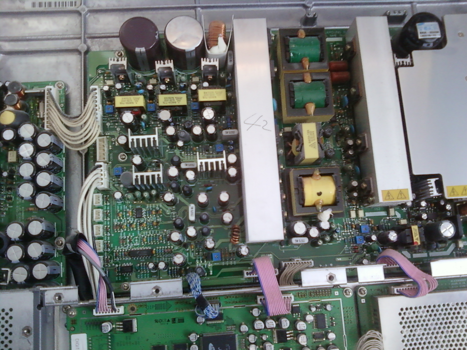

    Samsung S42SD-YD04 No picture, sound OK

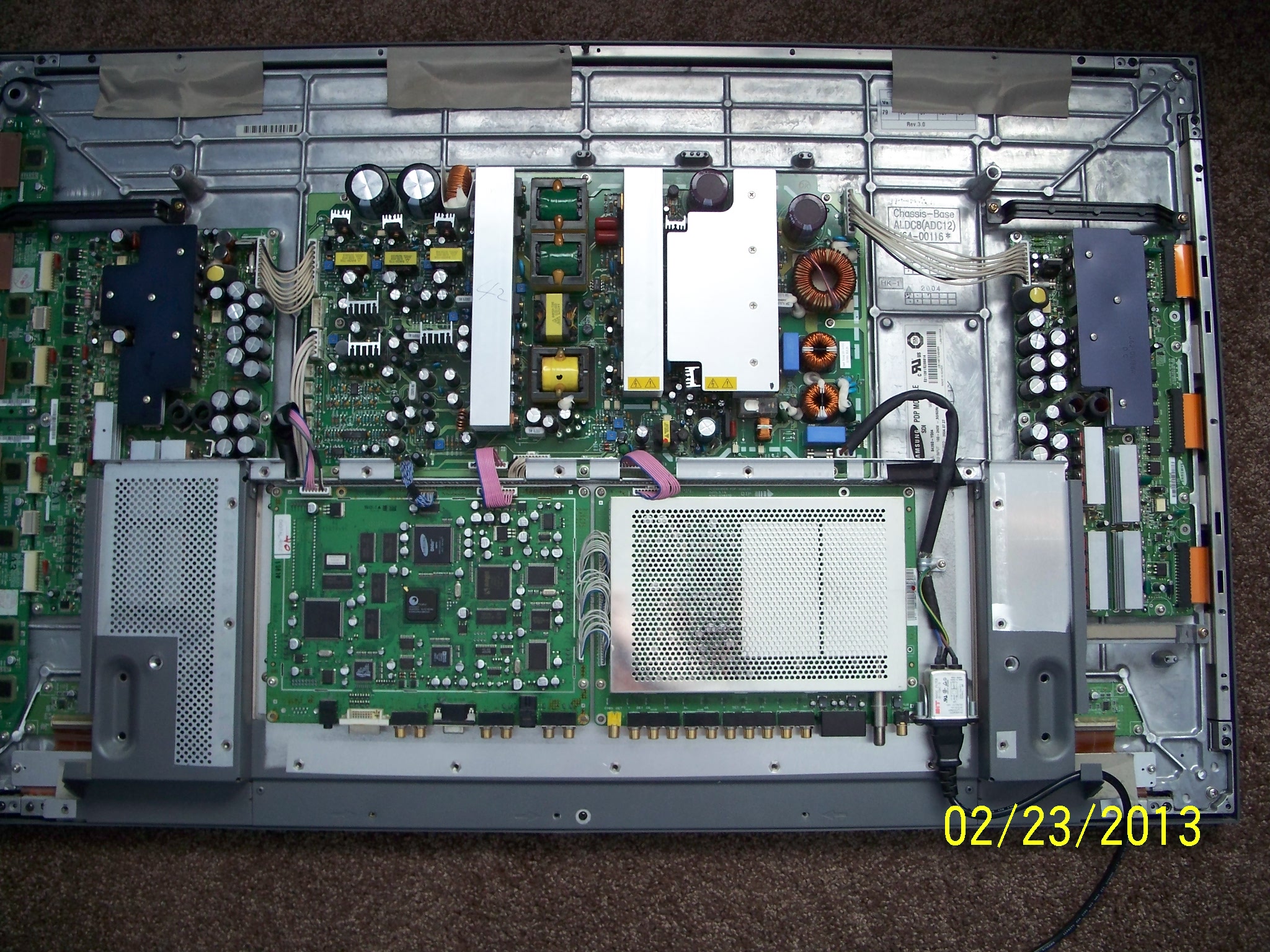

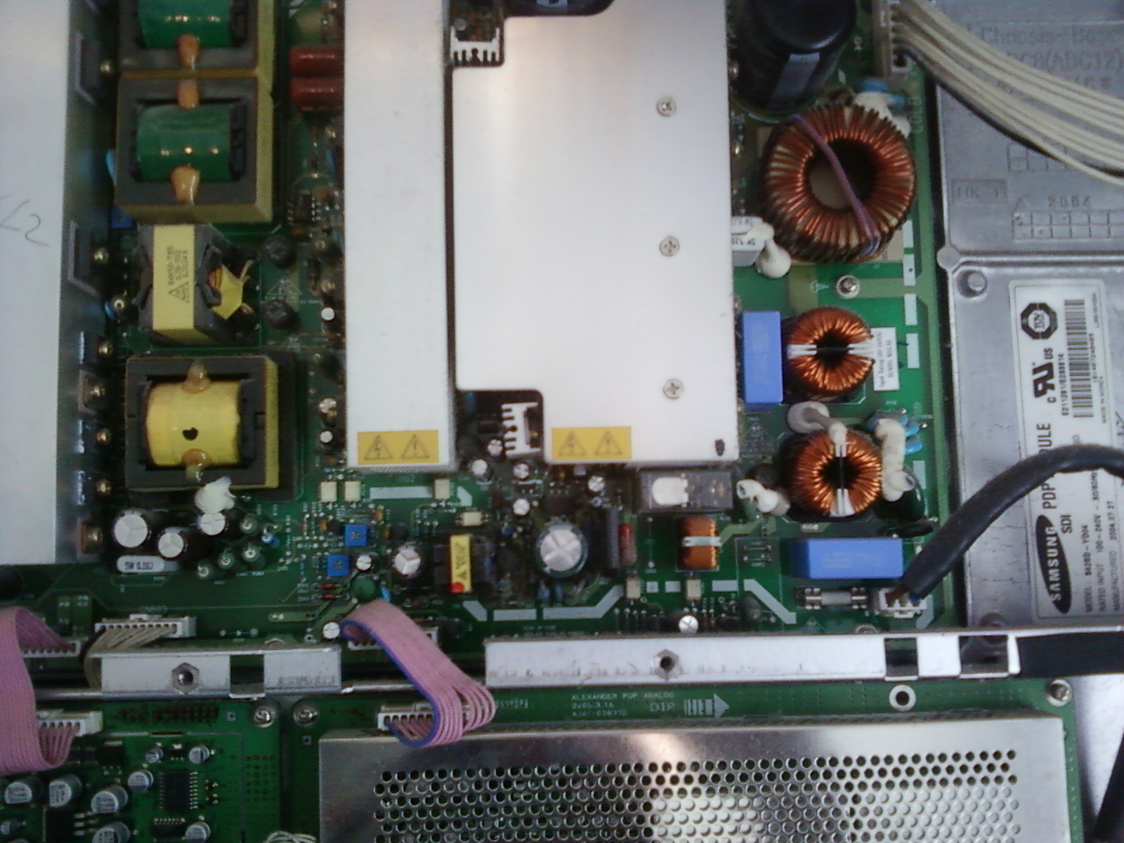

    Took the set apart and the four large capacitors looked swollen on the power board. Replaced all four, thought this would solve the problem, still no picture, Started spot checking surrounding boards all seem to have some power. One board has has a small green led. When set is turned on it is blinking. Have pictures of the power board.
    Re: Samsung S42SD-YD04 No picture, sound OK
    Can we see a picture of the whole chassis of the TV?
    • Karnak
      • Feb 2013
      • 15

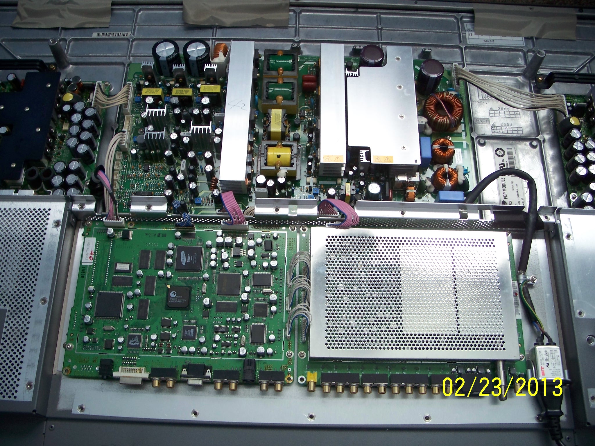

      The tv is at my nephews will get a picture soon and post it.

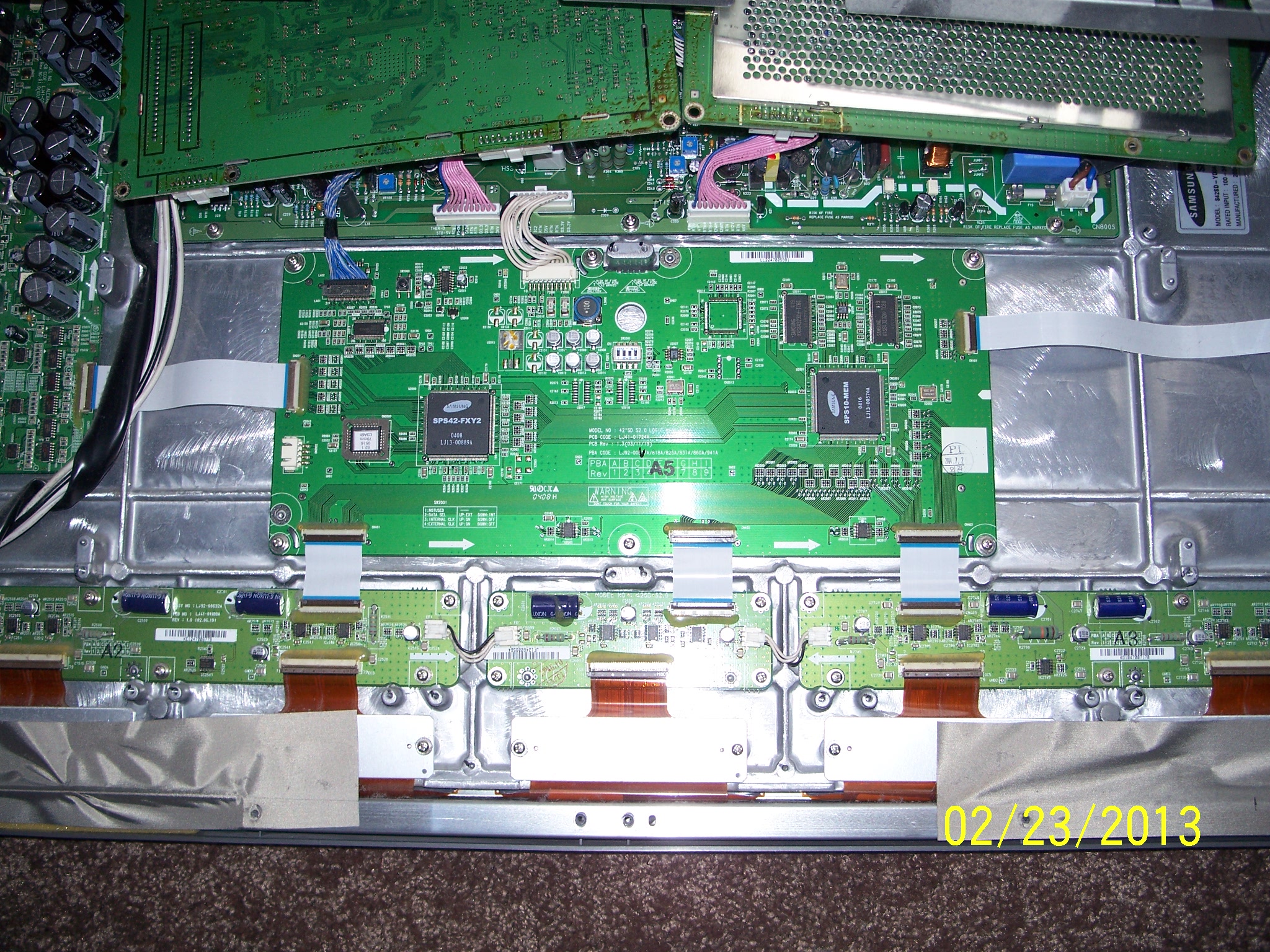

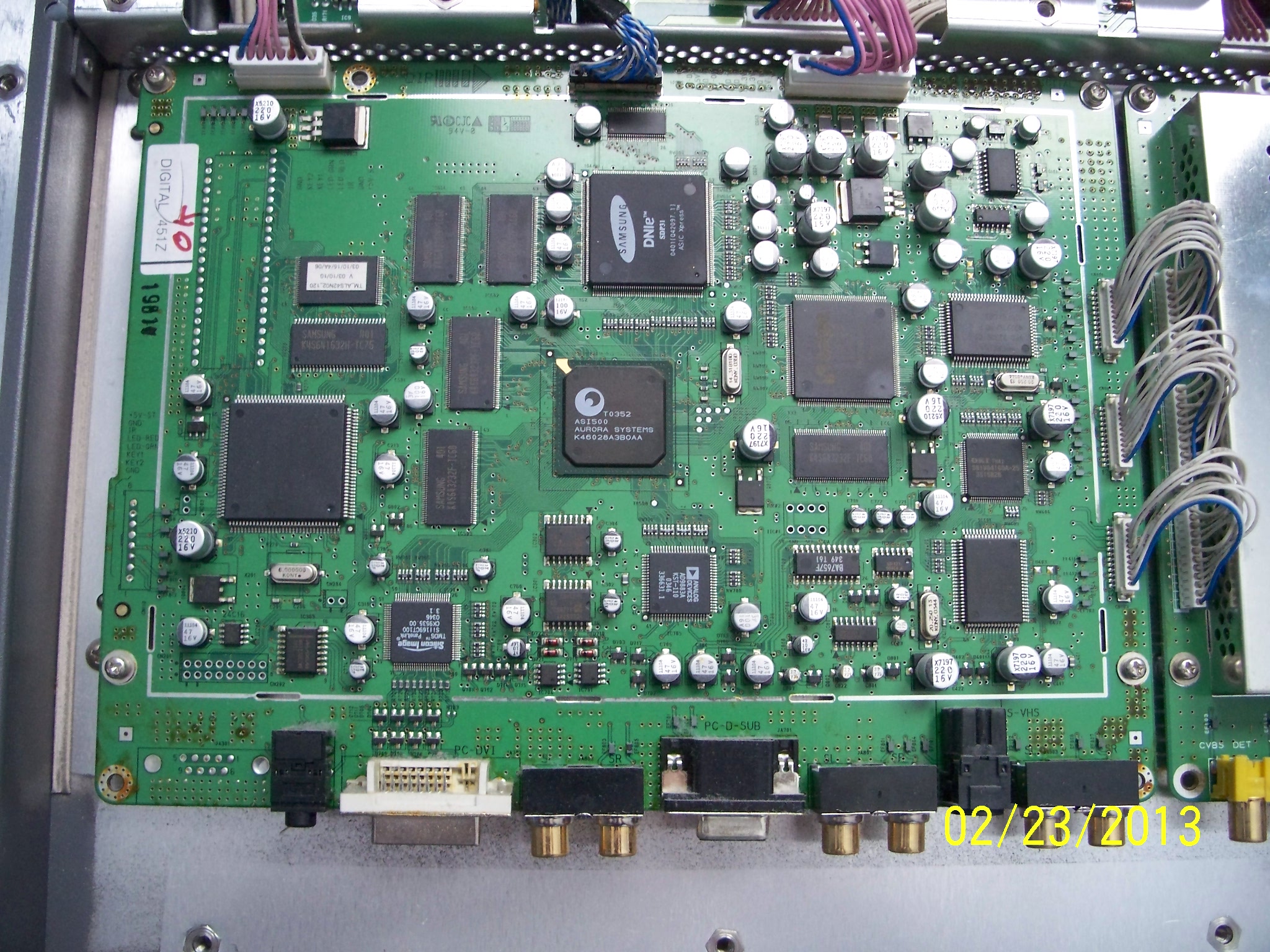

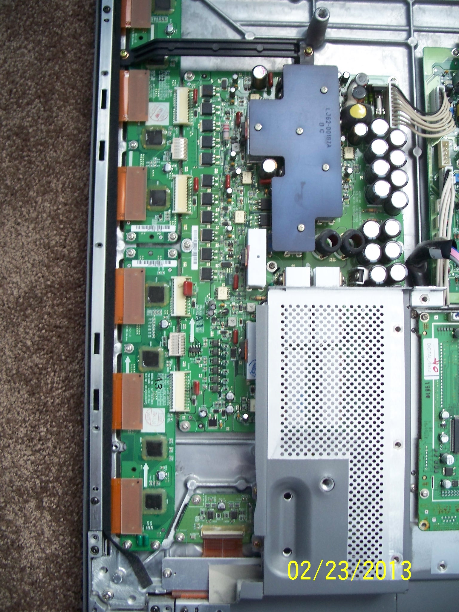

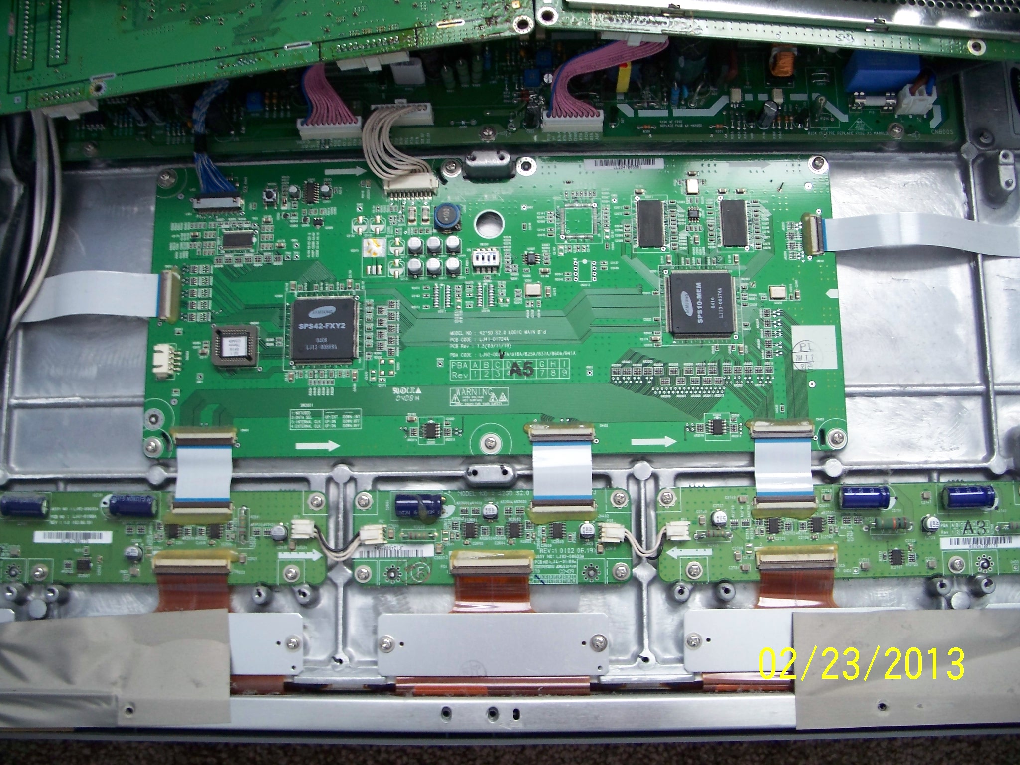

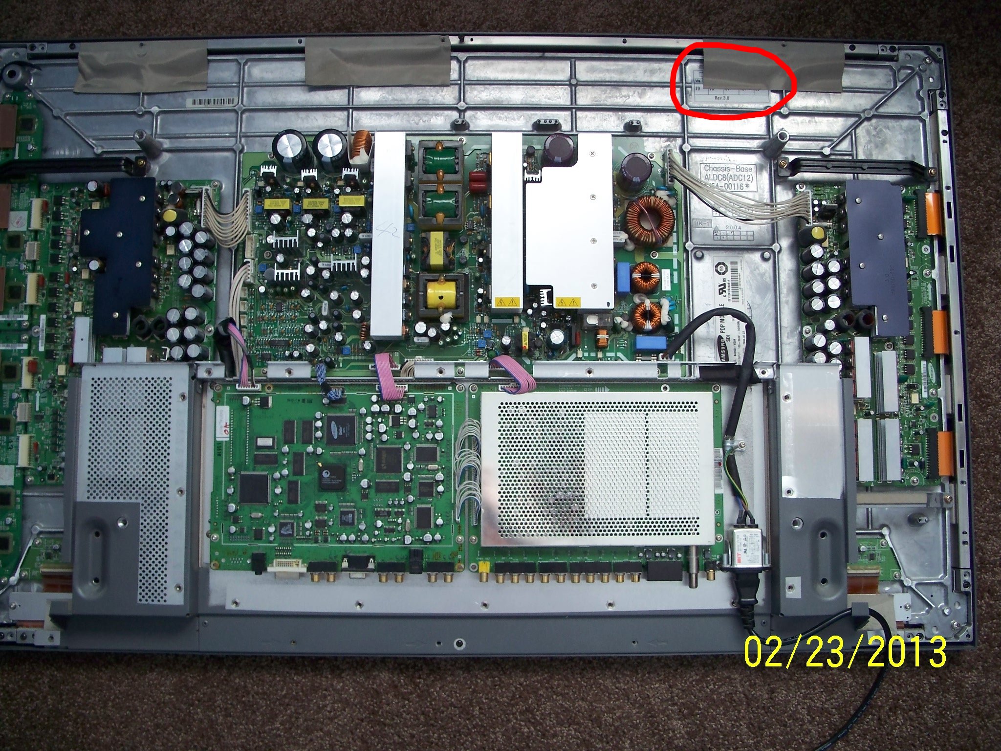

        Was able to get a service manual downloaded. Got over to nephews and got some pictures. First when plunging in the set you get a solid red led light. Press on button, relay engages on power board, red led flashes 5 times and goes out. I check voltages coming off power board all seem good. AS per reading in the manual I check the switch on the logic board. Position 1 on, 2 on, 3 off, & 4on.
        AS per the manual I set the switch Position 1 on, 2 off, 3 on, & 4 off.
        Quote from manual:
        Switch the power on and see if the screen is lit. If the screen can give a normal and
        completely white field signal, then the problem lies in our main board or video frequency
        processing board, which will be dealt with separately.
        d. If the screen is not lit, then first replace the power supply board to see if the problem is
        solved.
        e. If the problem remains after the power supply board is replaced, then the problem lies in the
        screen. Replace the entire screen for treatment.
        Screen completely black.
        Stumped at this point

          Wow, that's quite an old module. Can you read off the voltages on the sticker where it says "Va 79V" etc just above the PDP Module sticker?
              At the top of this picture:
              https://www.badcaps.net/forum/attach...2&d=1361665489
              you can see a Va: 79V, but I can't see the other voltages. What are they?
                  Not on the board. On the plasma panel itself.

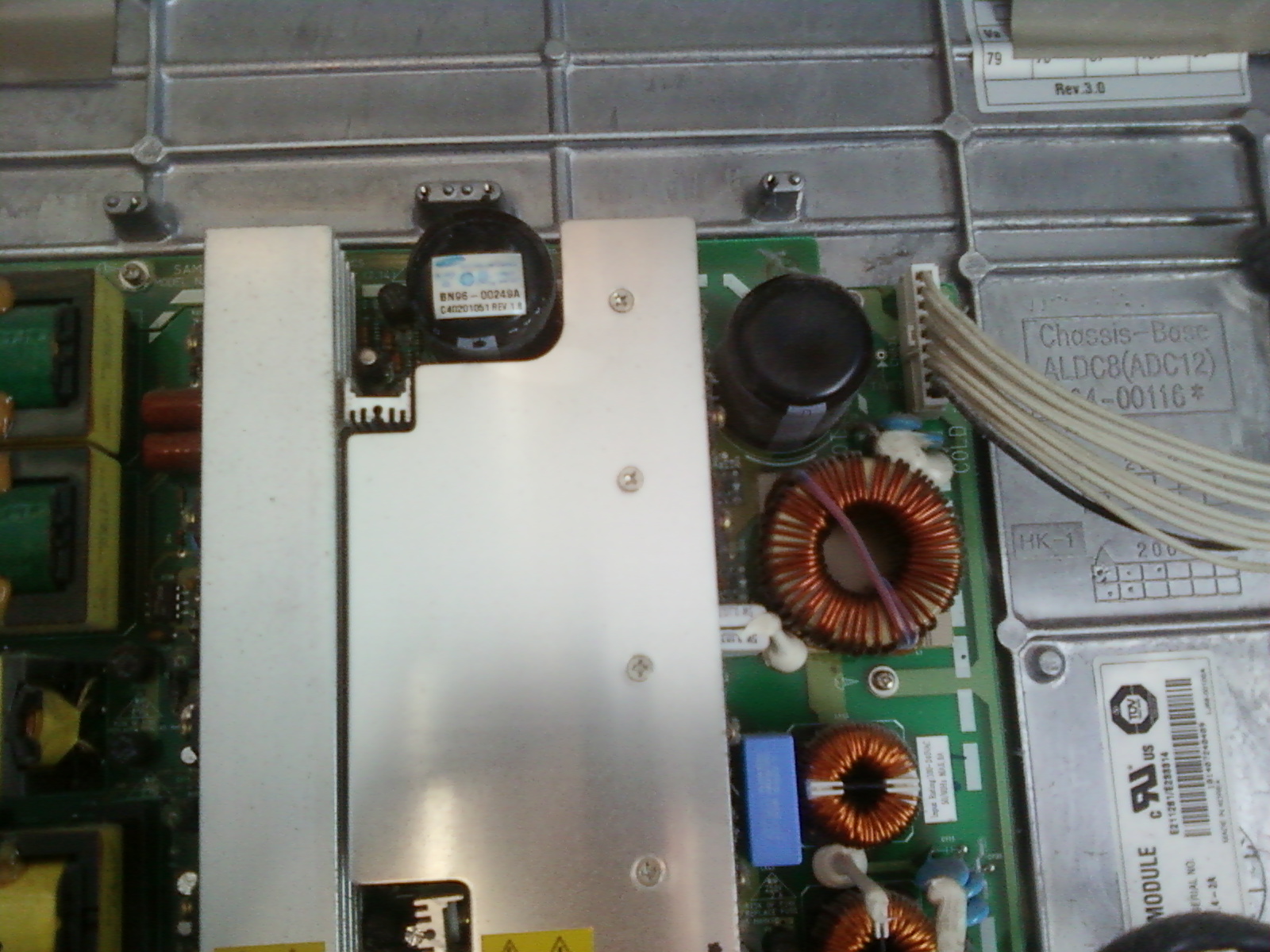

                      Ok Checked the label: listed the following: VA 79 , VSC 78 , VS 87 , VE 107 , Vset 93. Following values were measured: VA 75 dc , VSC 75 dc - 160 ac , VS 21dc , VE 0 ac or dc , Vset 0 ac or dc. At this point I assume it is the power board. These were test points identified on the power board.

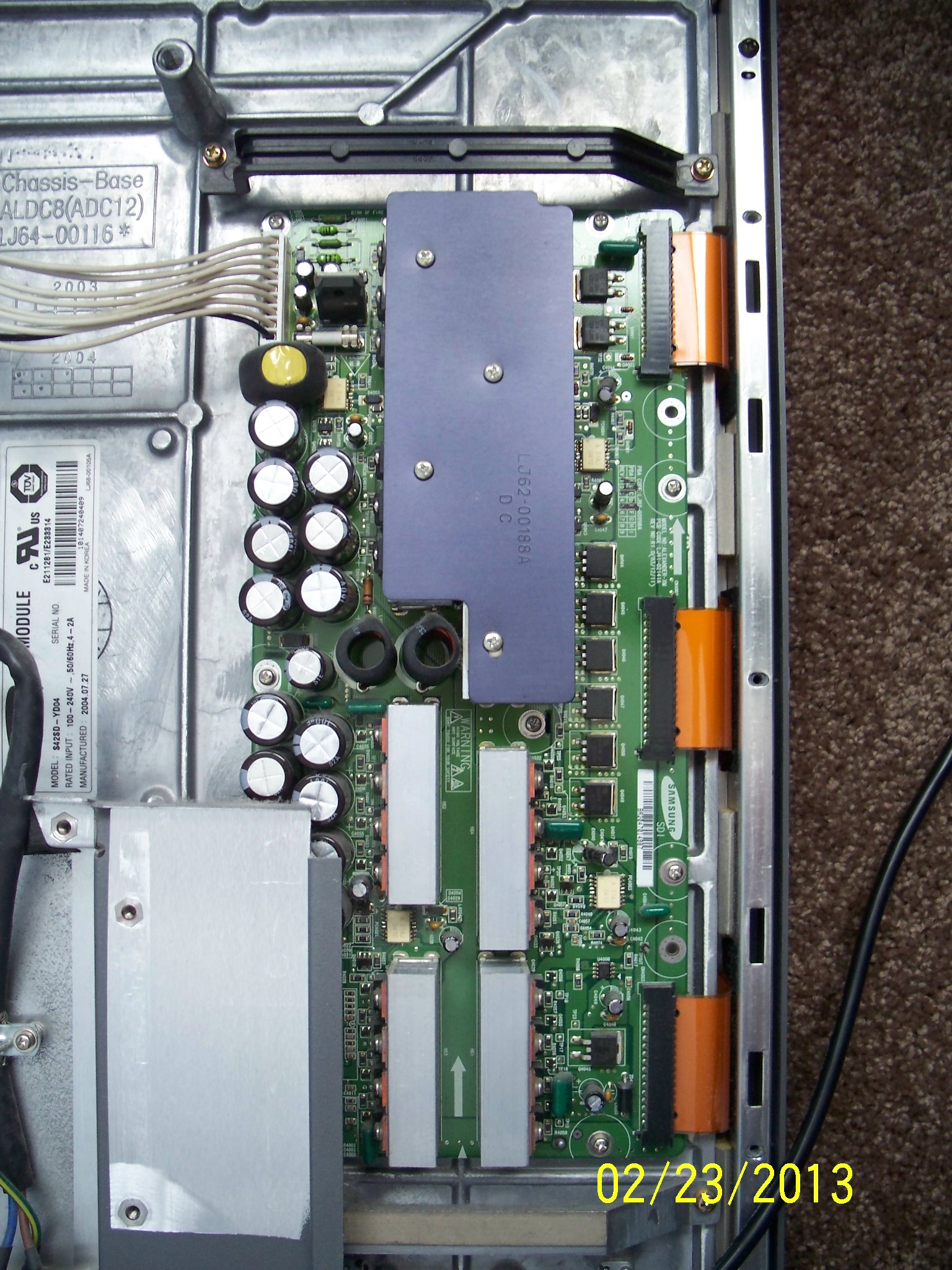

                            That is extremely low for a plasma panel. I am wondering if this is TERES design like Hitachi used (Y-main/X-main form voltage doubler.) It's a pretty old panel, looks like one of Samsung's earliest modules.
                            Regardless, since the voltages are low, you should first try unplugging the Y-main and X-main, and seeing then if the voltages rise.
                                    Disconnected the Y driver board and the X driver board. All voltages where were they should be. Connected the Y driver board the Ve voltage 0 Vs voltage 19.8 all other voltages ok. Disconnected Y driver board, connected X driver board, Ve voltage moving back forth 31-107 volts, Vs voltage moving 17-36, all others normal. Both boards connected-- Ve 0, Vs 22, all others normal. Seems strange that both X and Y boards bad together.
                                      It could be a power supply that's struggling under load.
                                      • Karnak
                                        • Feb 2013
                                        • 15
                                        Thanks very much for the input, think it is time to retire this set due to the age.
