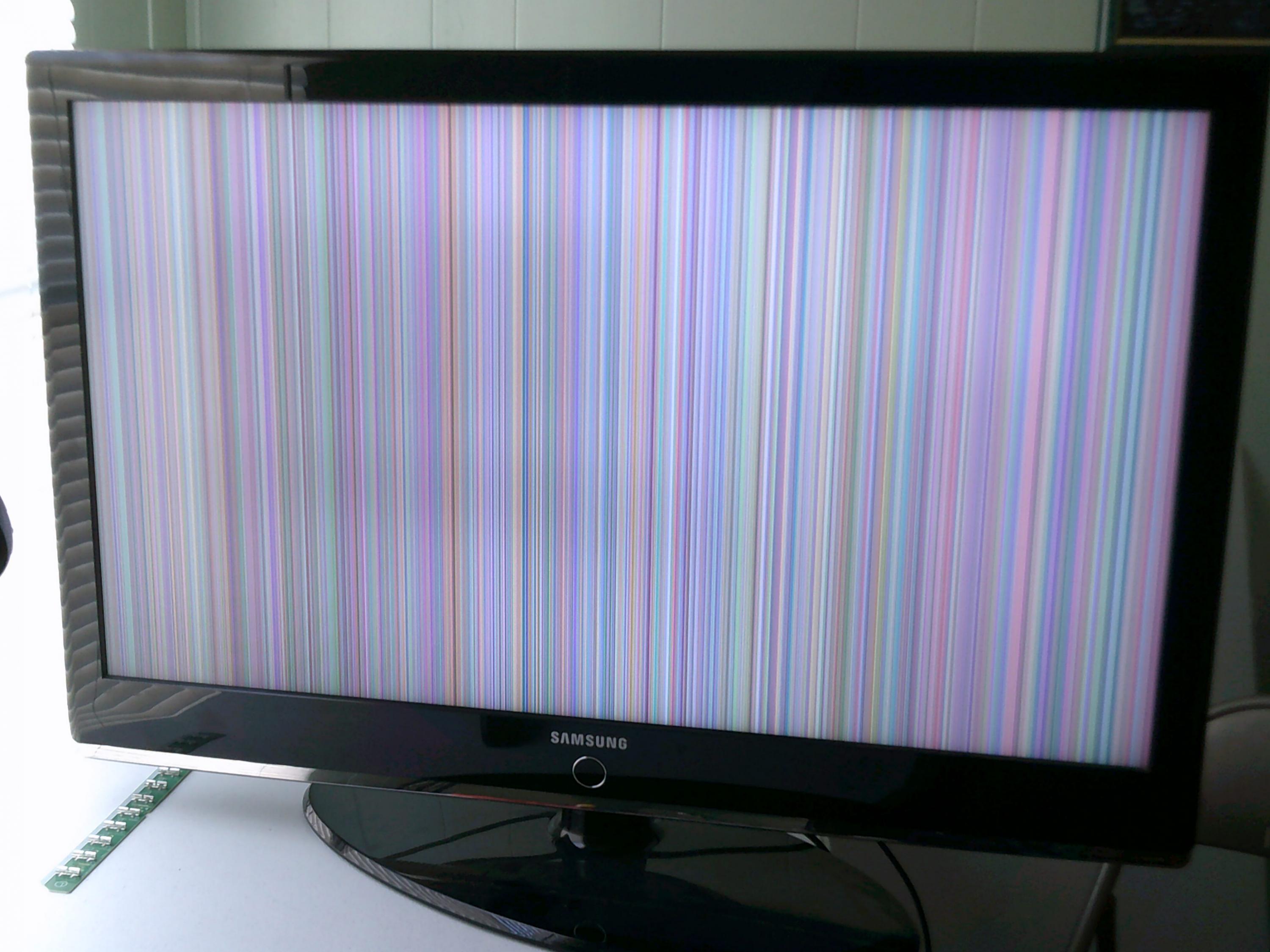

    This Samsung lcd has power issue. It doesnt always turn on and when it did I got lines on screen like in pic1.

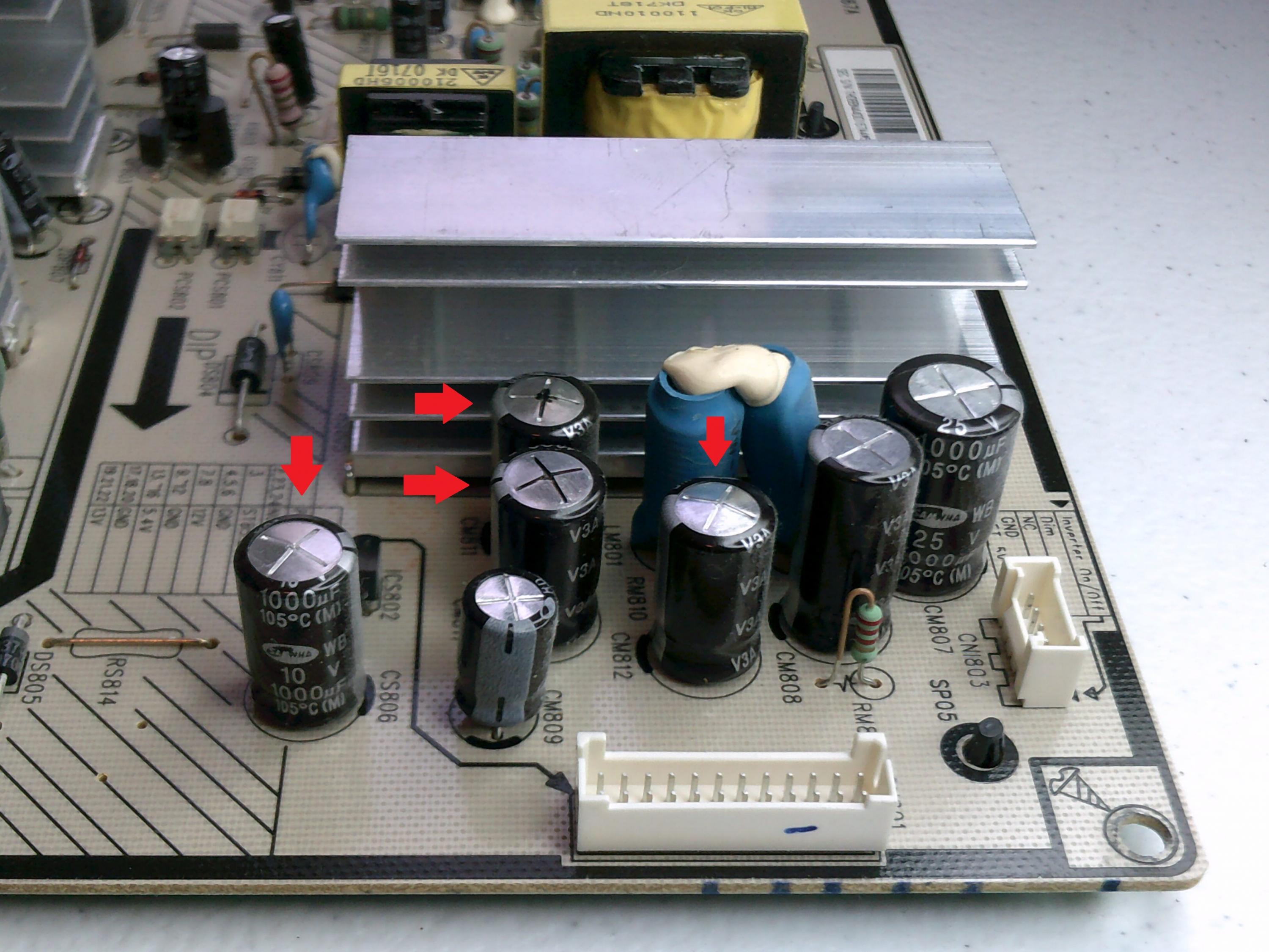

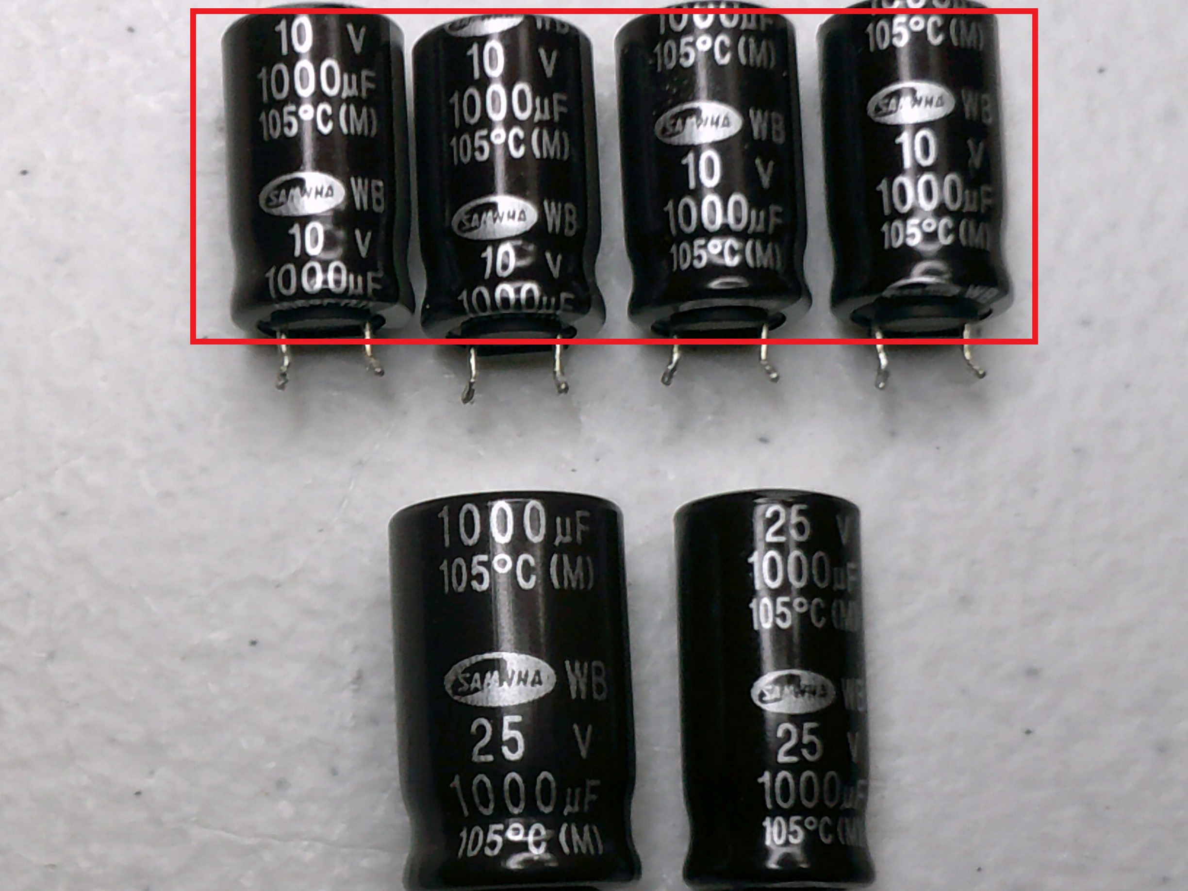

    I opened it up and saw 4 visible bad caps that are Samwha WB 10v 1000uf in pic2.
    I plan on replaceing all 7 caps in pic 2 with panasonic FM or FR unless someone thinks I should replace more or use something else. These 7 seem to have a high failure rate.
    Ebay kit is $12 otherwise it cost me about $10 for panasonic FM/FR from digikey.
    Will a 16v 1000uf panasonic cap be fine? Or is that too high voltage rating?

    Nice easy fix. I would use Panasonic from Digikey. No telling what crap eBay sellers may dish out.
    Voltage rating is a higher or same spec.

      I agree. I have used a few kits before and sometimes the dimensions of the caps they send arent the same. I had to leave 1 cap almost a half inch off board crammed inbetween other caps.
      original-Samwha WB 10v 1000uf
      I have 2 16v 1000uf panasonic I thought of useing but since I have to order I will look for 10v 1000uf.

        You can always increase the voltage on caps, you should generally increase the voltage whenever you order new caps, because that is the maximum voltage before they pop, and cheap board makers in china often pick ones that are way under what they should be.
        Those 10v caps might be filtering a 12v line, so they are always going to be over their max safe range (up to 10v), if you replace them with 16v caps they will generally be within the safe range (anything under 16v)
        The capacitance you dont want to alter significantly (more then 5% ?) unless you are very knowledgeable on electronics and know how the capacitor is being used. But the voltage rating is always safe to increase.
        I think FM, FC are the caps you want to use in the secondary of a power supply, the FR arent bad, but arent usually recomended for that purpose, i wouldnt sweat it if you already used / or already have some FR's though since theyre a good quality cap.

          One thing I would say is the one thing Samsung did not do is over-volt the caps. The 10V caps filter the 5.2V line and 16/25V caps filter the 13V line.

                I picked parts I think will be good replacements.
                For the 10v 1000uf I chose.
                http://www.digikey.com/product-detai...1CT-ND/3072211
                for the 25v 220uf.
                http://www.digikey.com/product-detai...2411-ND/613772
                for the 25v 1000uf. (This one is 10mm dia.)
                http://www.digikey.com/product-detai...9CT-ND/3072229
                for the other 25v 1000uf(12.5 dia.)
                2 10mm(above) should be fine but if you want...
                http://www.digikey.com/scripts/dksea...508=55&stock=1
                Iam just a hobbyist... No guarantee my choices are the best choice.
                  Re: Samsung LN-T4061F power issue
                  Those look fine to me. I almost always use Panasonic caps as replacements. If they aren't available, I use, in order of preference, Rubycon, Nichicon and United Chemicon.
