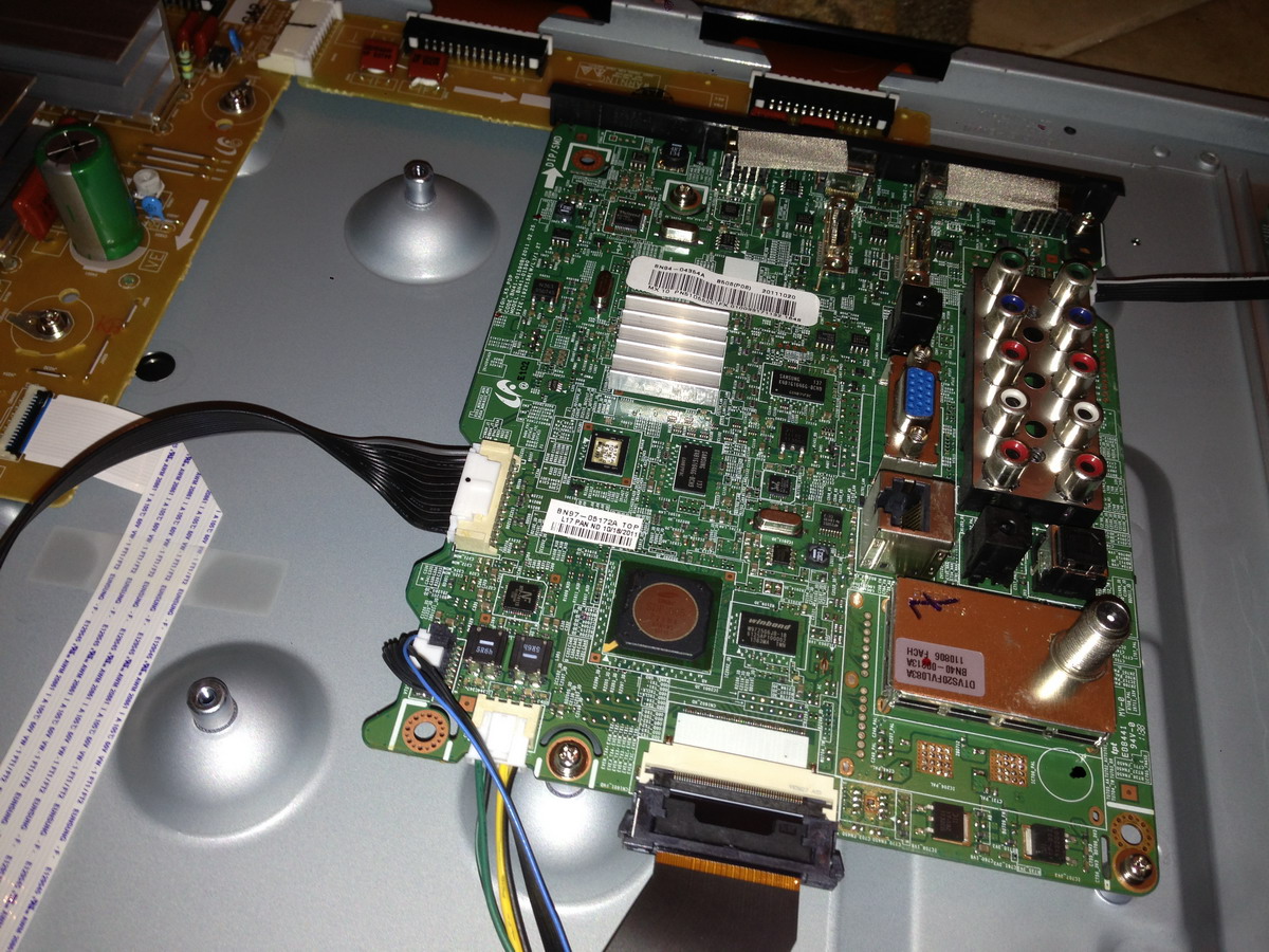

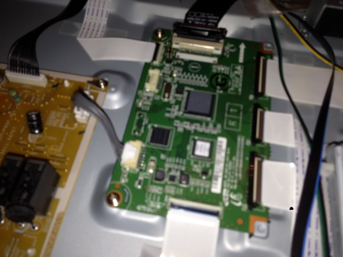

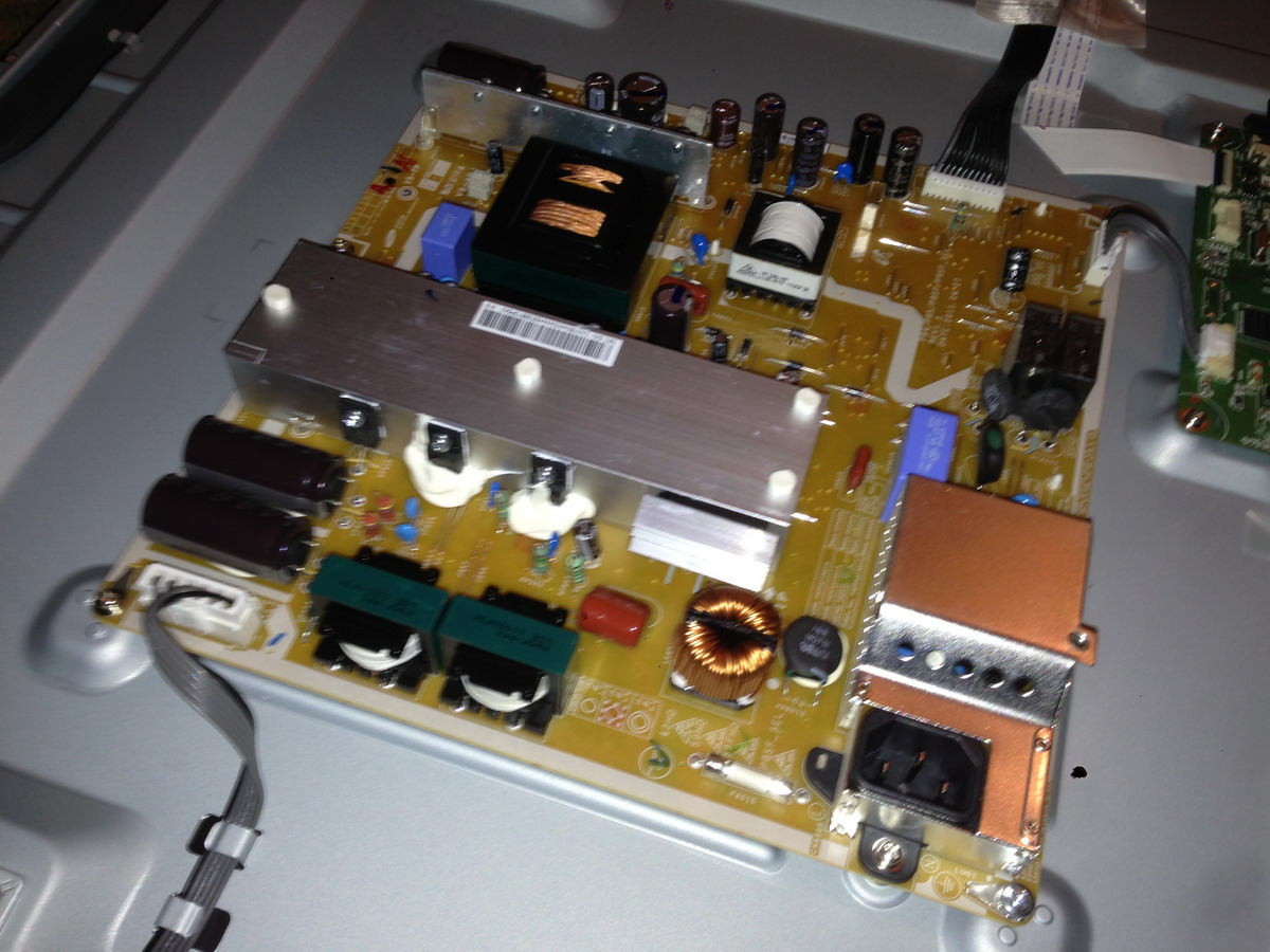

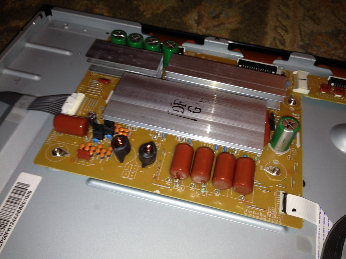

                    Can you post some pictures of inside the chassis?
                    Sometimes the X-main can damage the Y-main, and vice versa, on these chained energy recovery plasma panels.
                      #30
                      Re: Samsung PN51D550 unable to power on
                      Here are the images.
                        #31
                        Your set looks to combine X-main and Y-main energy recovery, so it's possible a bad X-main kills the Y-main.
                        Have you tried powering the set on with X-main unplugged? It will probably not power on but you might get a different code from the control board.

                                Replacement of X-main, Y-main and Y-buffer is the safest way to do it, assuming that an oscilloscope is unavailable to test any one board.
