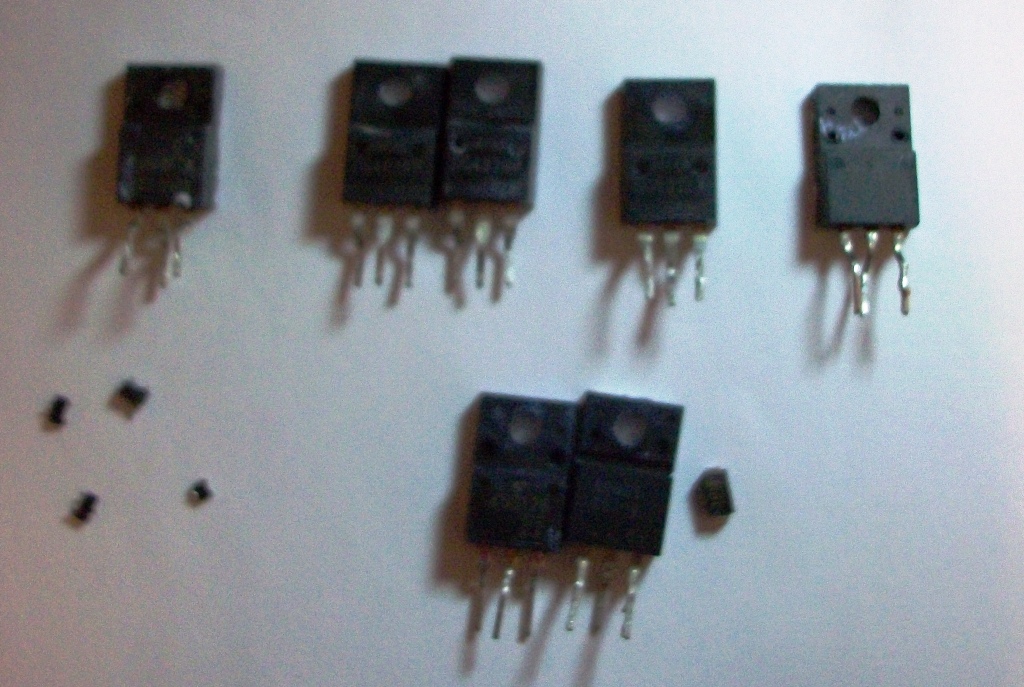

                                Just fixed another one. Had someone track me down so did one on exchange.
                                So far so good, I was not sure about doing this mainly because of the chinese parts but we'll see. Not sure how long I should run it, maybe a week or 2.
                                SC2 was not dead short but low enough to trigger a SOS4
                                IC16521 M81737FP, FET DRIVER (had an exit wound)
                                IC16773 TC7SH14F, schmitt inverter ic (can use SN74AHC1G14DBVTG4) (shorted)
                                Q702 2PD601ART NXP (C3 W), (shorted)
                                Q661 RJP63F3A (shorted)
                                Q622 GT30F125(R) (not short but low ohms got 0.190 in diode, normally around 0.9 -1.00 in cct) The other was ok. Have not seen this before but have found one survives in a pair.
                                Q402,DG502LW (shorted) other was ok.
                                Q421,422 (shorted)
                                Q452 GT45G128 (shorted)
                                D482 RFN25TM4SW (shorted)
                                D451 RF101L4S (shorted)
                                Q701 MMBTA92 seemed ok but replaced
                                Q818 2SK3018 also not shorted but replaced
                                Successful repair first go. 13 parts replaced
                                I have not had one yet that that did not need at least one 30F125 and nearly brushed over them with no short. Being suspicious I grabbed another board just to check and big discrepancy. very lucky, so easy to be complacent.
                                Love to see other repair reports here.
                                Sorry for the bad photo and missed the FET driver IC in the shot.
                                TV shot is with it running the repaired board.

                                          Plugged it in, Q661 pops again, this time along with Q621, Q622, (D642 & D641-RF2001)
                                          Replaced all those popped again, checked everything else seemed fine.
                                          PLug it in hoping it was just the RF2001 I missed. and pop again... same blown parts as above...
                                          Just lost now... Seems the problem is mainly Q661, if there was a list of parts that should just be replaced only to prevent Q661 from blowing. But then it also takes with it 30f125 and RF2001 so not sure if that's an entire different problem
