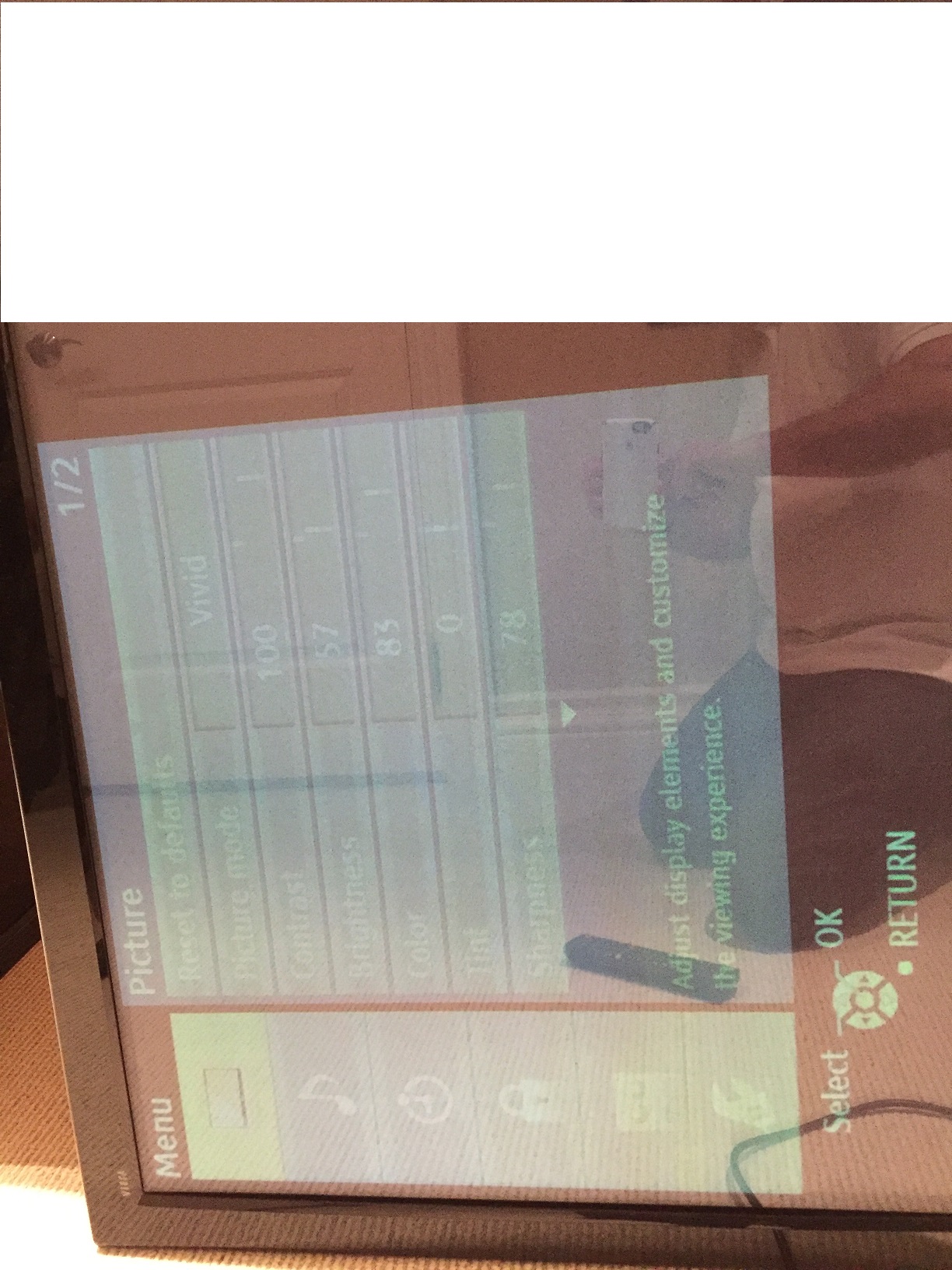

          the picture is noisy and low in brightness both when I display the menu and picture from HDMI
          I was able to get a loaner SC board and the picture is perfect using the loaner. any ideas
          attached is the bad picture. (I did cut part of the picture as it did show a reflection of me)

            well, you must be close. Did you check any of the resistors around ic521? R521,522,506. 100 ohm x 2 and a 10ohm. If ic521 was shorted and Q521 shorted fair chance the 10 ohm could be dead
              I did check resistors before and again today and thy are all good. what I am puzzled is why did Zener 871 and 872 go on this board. before I replaced them I did get a 6 blink code. I am at a lost at this problem. any other idea?
