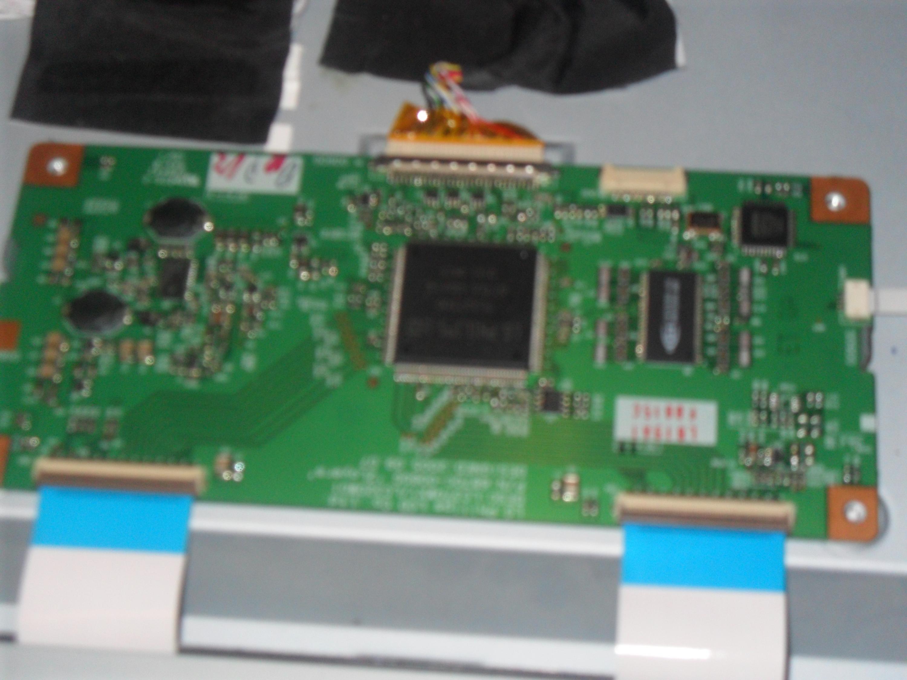

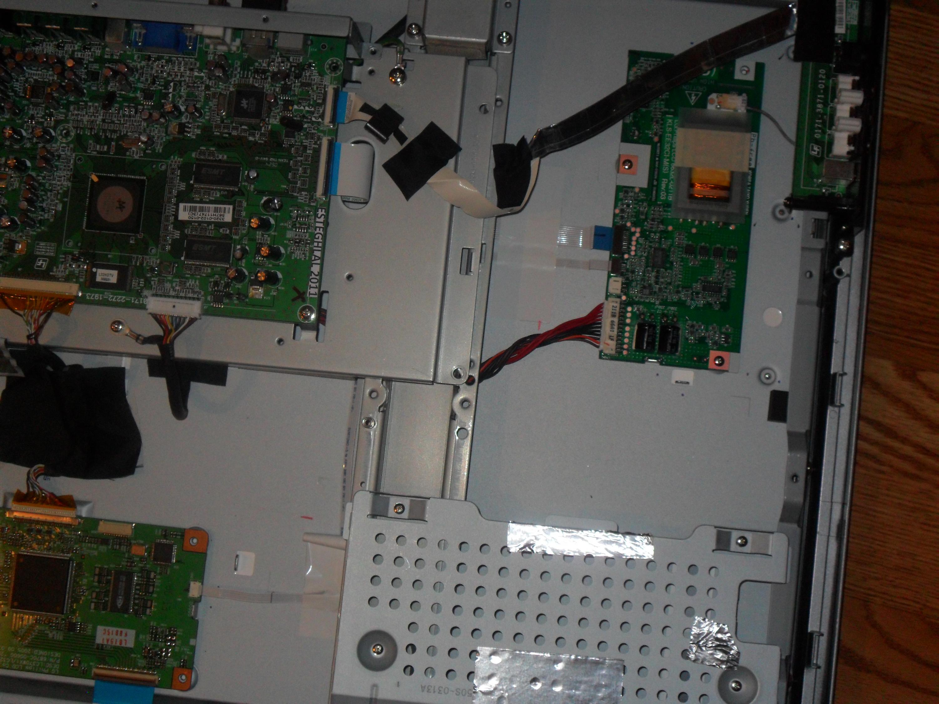

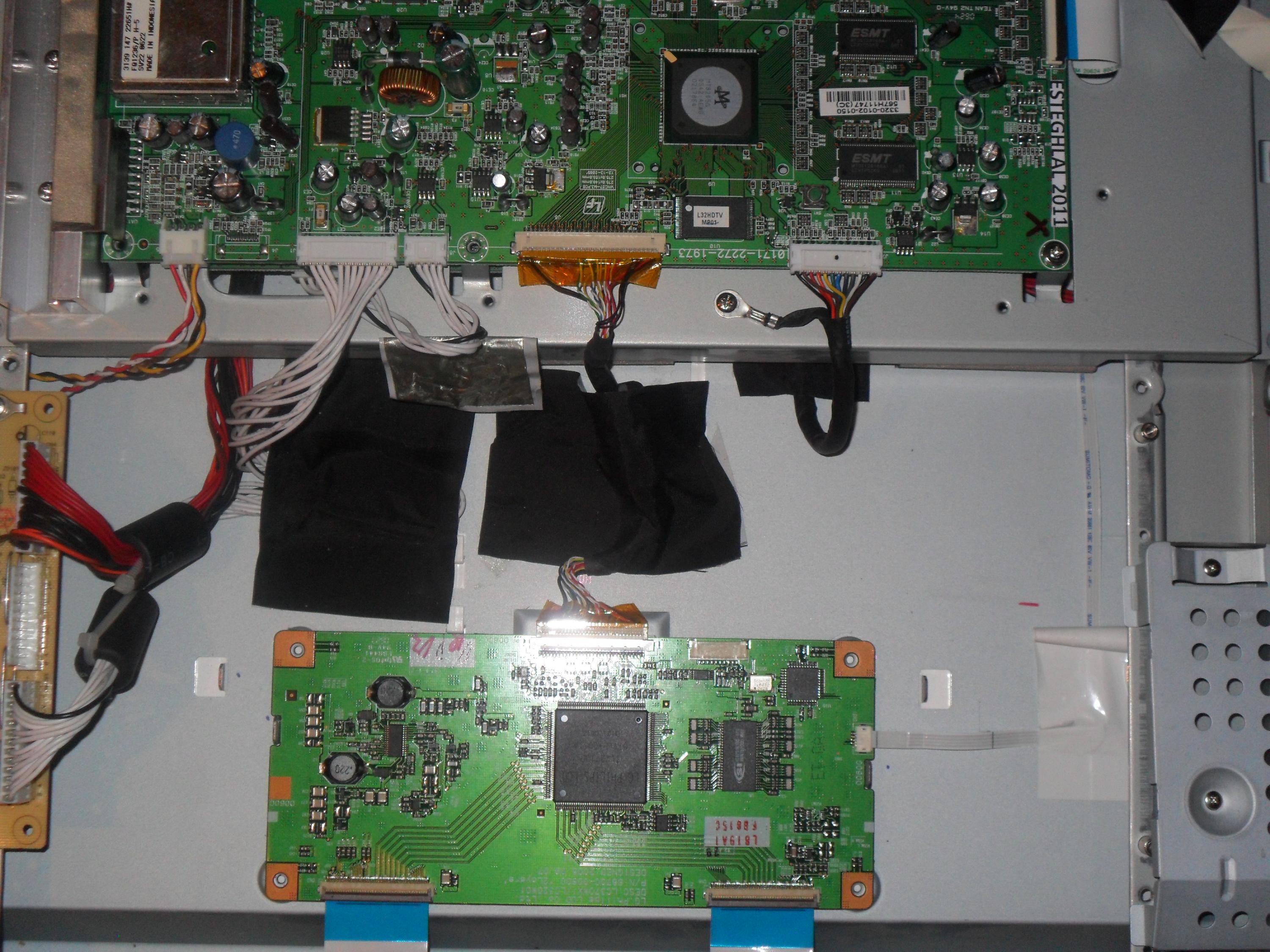

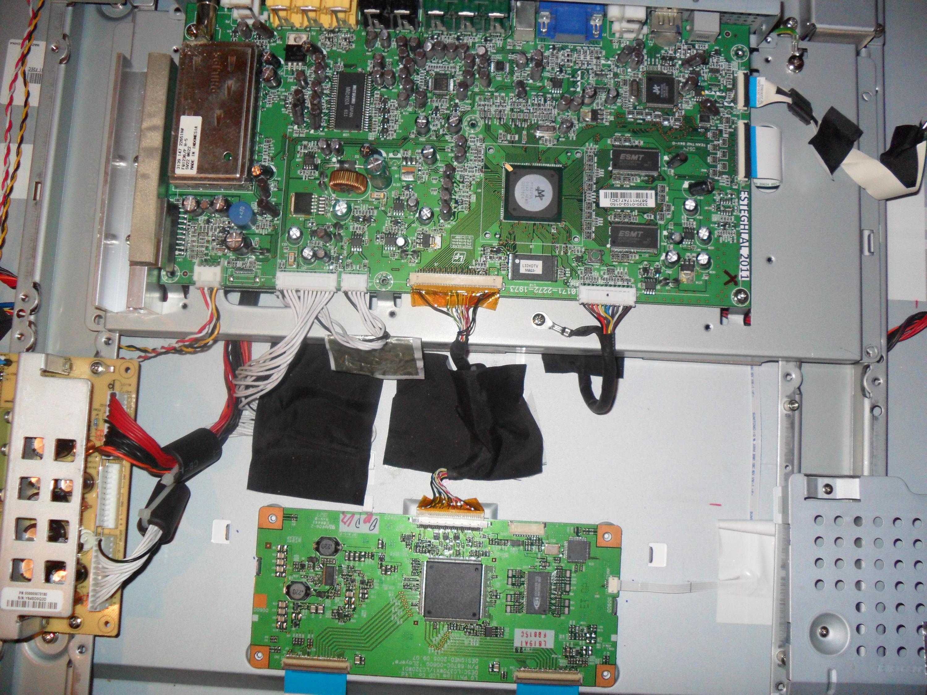

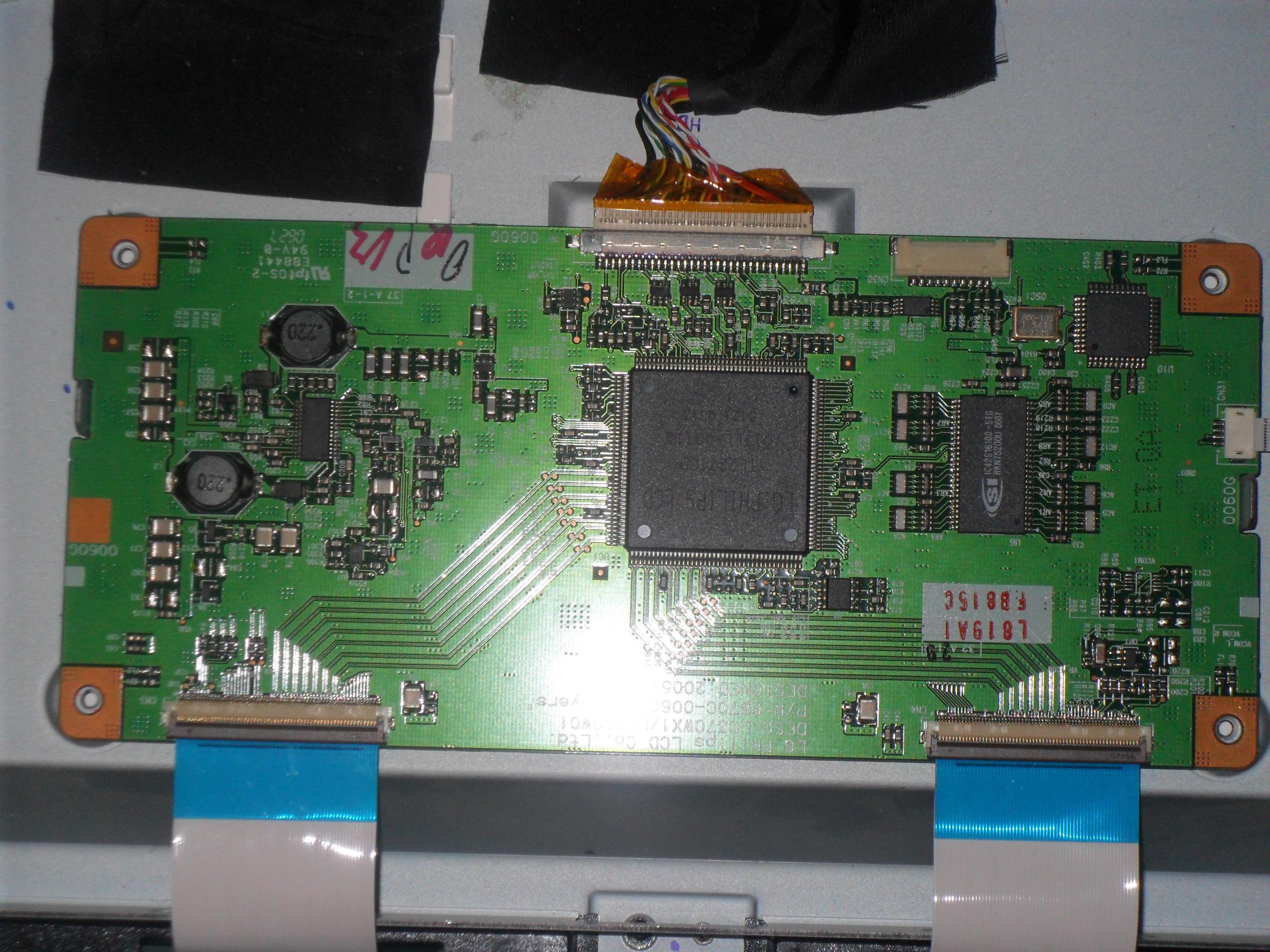

          Re: vizio LCD TV model#L32HDTV10A
          Ok here is some photos of my TV
            First picture needs to be better, I cannot see anything, remember I do not have this board in front of me that picture is my eyes.

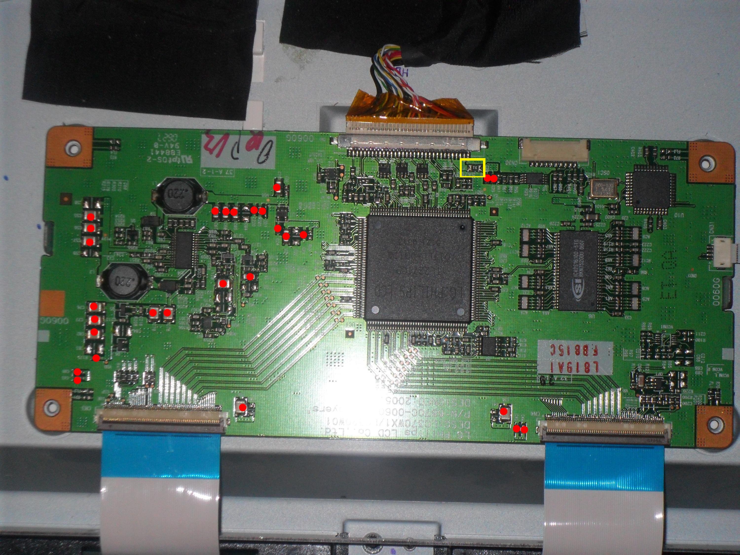

              sorry about that

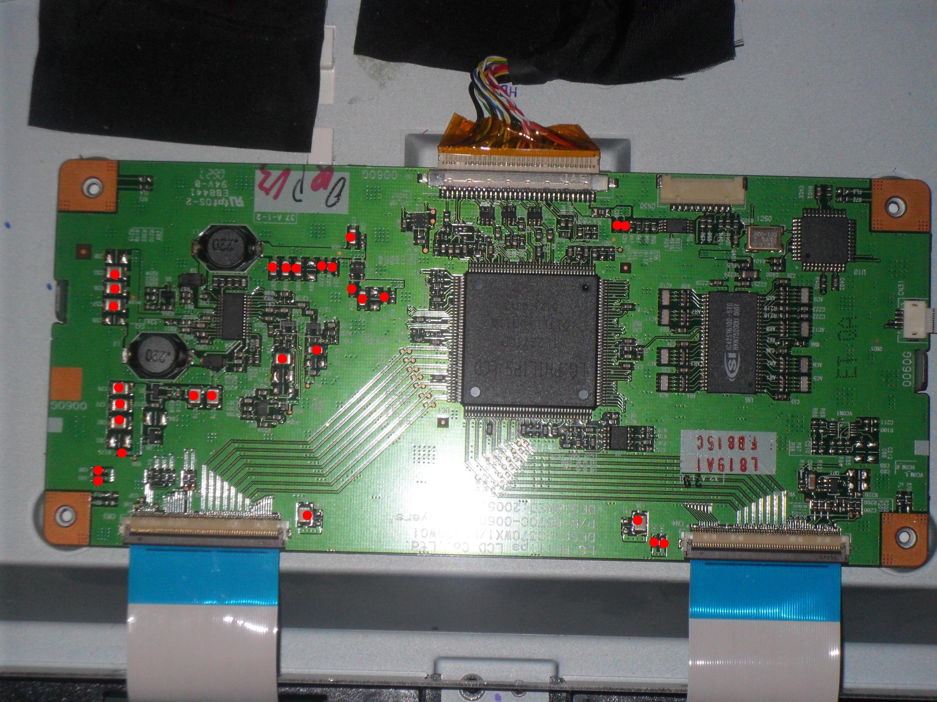

                I've highlighted some MLCCs.
                With TV off (power cord unplugged) measure the resistance on 200 ohm scale.
                Note down the numbers of any capacitor that measures less than 20. Many will measure a single "1" - consider this as different from "1.0" and meaning infinite or no reading. Do not note down capacitors that read "1". Example capacitor number: look close on board for reference designator i.e. C1385.
                  I didnt find any that measure less than 20.
                    OK, what resistance do you measure from both ends of that "TK" fuse to the chassis?
                        I put a yelow square around it.
                          With TV off and power cord unplugged 00.9
