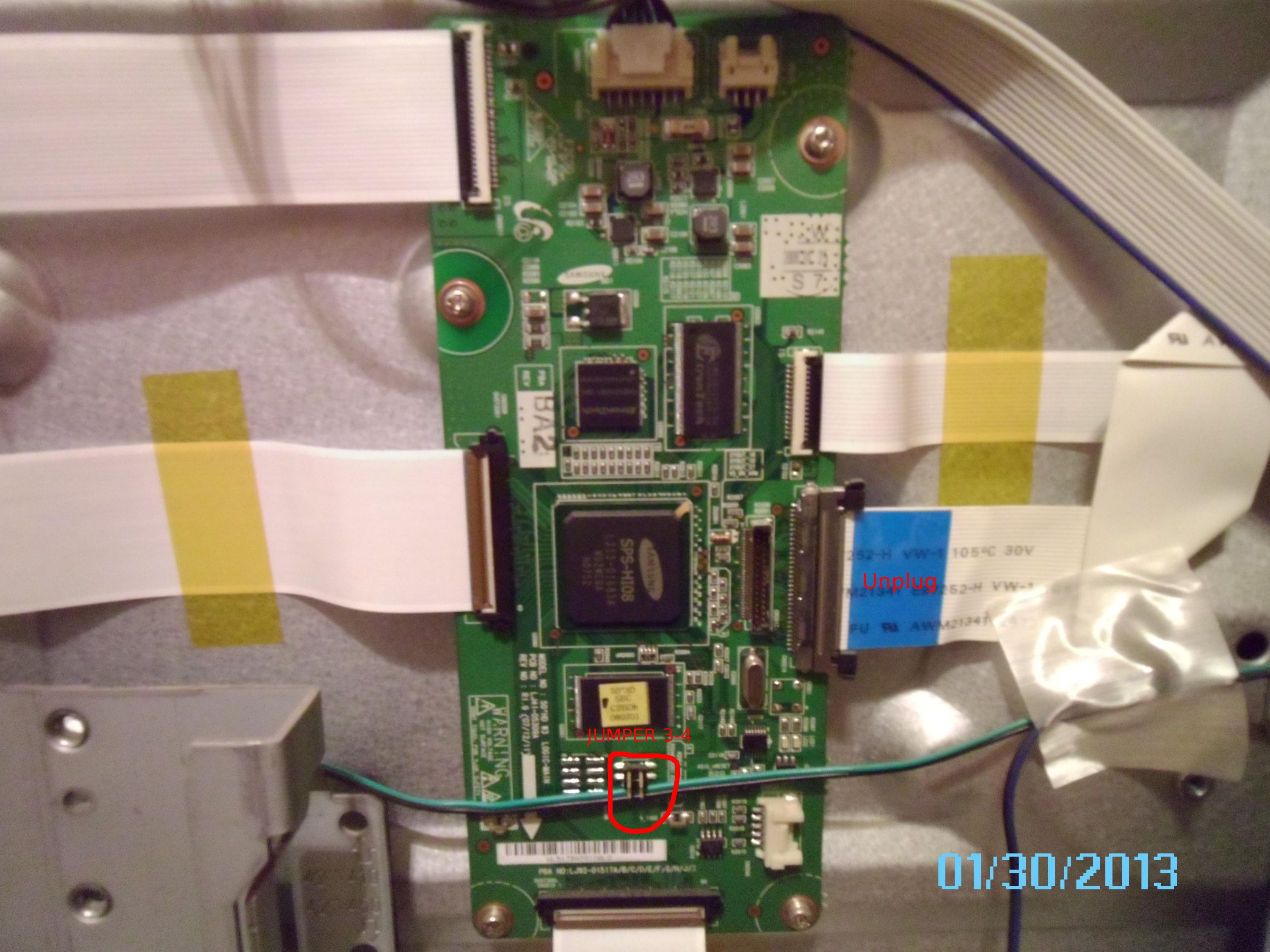

    Have a Samsung Pn50A450 plasma tv, picked it up clicking off and on. Diagnosed ymain had 3 faulty fets on heat sink. Purchased remanufactured ymain, now the tv stayson,no clicking, y main is humming like it should, panel has light glow. But I still have no picture,menu,nothing on the display.
    Re: Samsung PN50A450 No picture issue.
    OK, if you post a pic of the control board (connects to y-main through flat flex cable) I will outline procedure for making it show test patterns to prove plasma boards work. Main board is common failure on this model.

      I know,sorry for picture quality.
        Mkay, see image.
        All connection changes done with power OFF and set UNPLUGGED.
        When you power up with the jumper in place you should see test patterns:

          I have a similar model, PS-50A457P1D, with the same fault. Replaced bad caps on power supply and Y-sus, and now screen lights up, but no picture, just sound. Mine has the same control board as above, but jumping 3 &4 doesn't produce test images. I'm guessing a mainboard is my next replacement?
            If the test patterns don't work but the screen is definitely glowing, it's more likely the control board is at fault (the one in the picture above.) Make sure LVDS is definitely disconnected.

                Yea the jumper across 3 and 4, with lvds cable disconnected does no show any patterns,colors etc. The control has 2 leds on it, one is blinking the other briefly lights when powered up then goes off. I guess I will be looking for a control board also.

                  Replacing the control board, did not fix the issue, still cannot get test pattern to come up. So i guess im looking for a new main.

                        tom do you have the service manual for this model?
                          Not gonna be the main board. The test you did basically has isolated the main board. It's PSU, x-main, y-main, buffers or panel now.

                            Really? Y main with buffers built in is new, psu voltages are good. X main heat sinks are warm like should be. Panel has glow.
                              Panel has glow, but when you do the 3-4 test, is it still glowing?

                                Glow is there either way, only difference is with jumper connected it right when screen first powers up "GLOWS" it has different colored sparkles everywhere for a half second. It just a black glowing screen with lvds cable connected and no jumper.
                                  Did you disconnect LVDS during the jumper? Sounds like Y-main fault.

                                    Yes lvds disconnected during jumper, this is second y main I have tried, first board I purchased was thought to be defective so I returned it, new one same thing.

                                        Im not gonna give up on this beast. I unplugged the x main, screen gets a red tint. Only other board possibility is psu or main.
