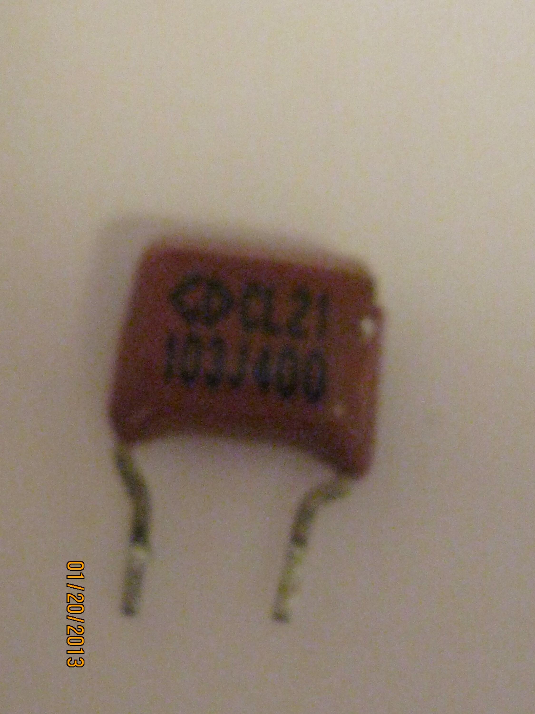

    Need help with a capacitor
    Need help to replace this Mylar capacitor.Seems to be discontinued does anybody know of a good replacement for it? number on it is 103j400
  • diodo49
    • Dec 2012
    • 17
    Re: Need help with a capacitor
    thats a 400V .01uF cap ebay or mouser
    • bobbyd40
      • Dec 2012
      • 116
      • usa
      Thanks diodo49
