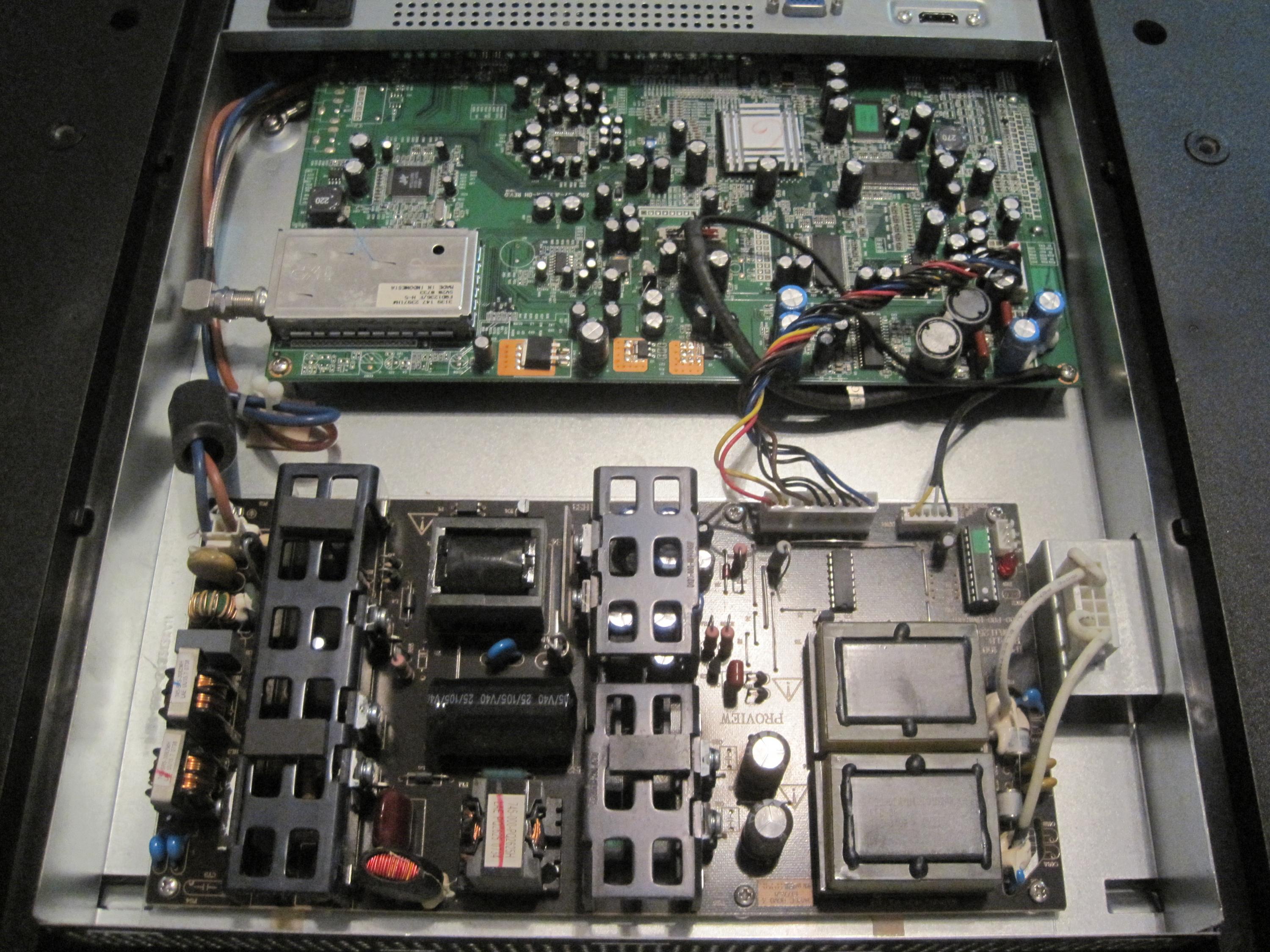

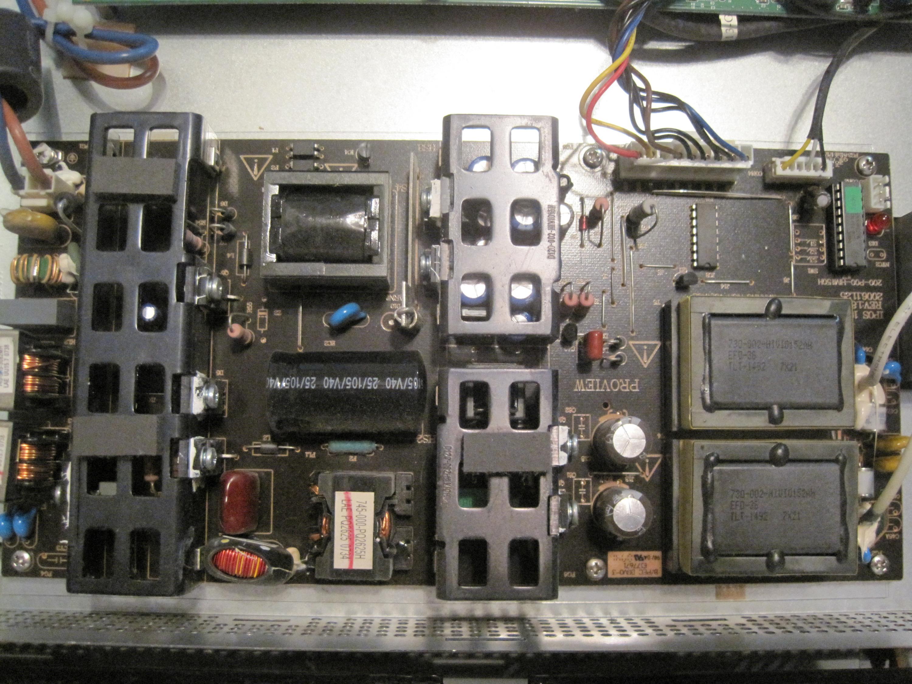

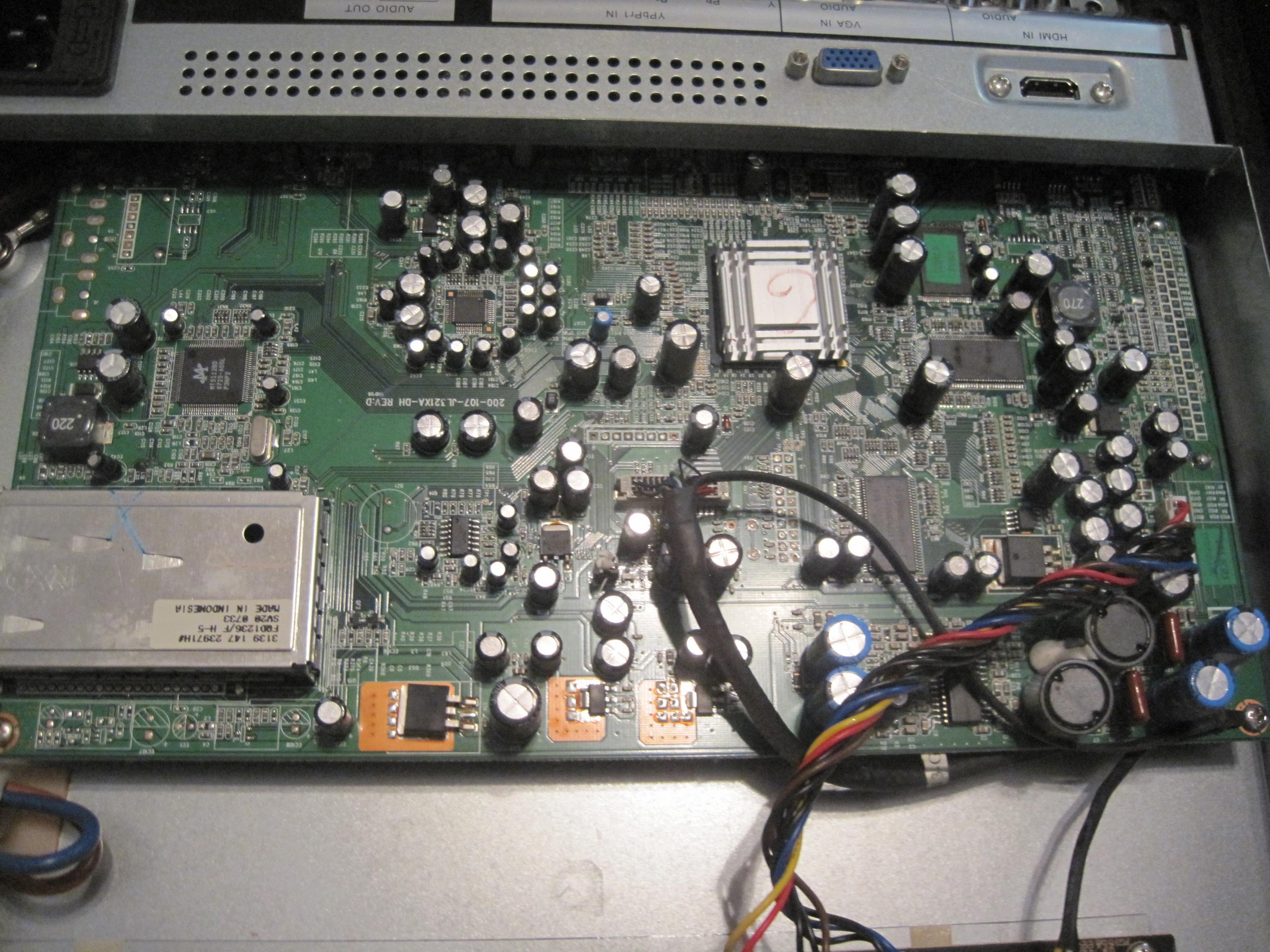

          Here's the top of the boards, it's gonna take some work getting them out to shoot the bottoms. I'm a make ready maintenance worker but I have no experience when it comes to tv/computer electronics but I've installed thermostats and light/power outlets before. At the moment I only have a screwdriver and needle nose pliers, my other tools are at work. Sorry if I didn't add the pics right, first time posting them like this.

            Re: Element FLX-3211B
            I think those 10uF/450V capacitors are bulging; just about "PROVIEW" logo.
            It's a very common issue on this chassis.
            Paul678 just fixed the same model a few days ago.
              Yes, those two are rounded. In the "cages" I can't tell but the ones I can feel don't seem to be rounded.
                  Ok If you mean the two black components in the bottom right corner next to two red/brown rectangult ones then two bright blue in the corner then
                  1, they are not capacitors
                  2, It is just Glue.
                  Turning to the other board there are two caps that look bloated.
                  Main worry is the big cap on its side that says 25/105/V40
                  on it looks very bulged at the end. It needs further investigation before you continue as it could explode.
                  The pictures are not really clear enough - probably not taken in enough light. =
                        Could the large 25/105/V40 cap be the problem? I can't touch it but the top is bulged, not sure if it's just the way it is but there isn't any resistance when I push it in with a screwdriver. Just tried replacing those 2 caps and no luck.
                        Edit:
                        Selldoor- I just realized you posted your concern about the big cap, I feel SO stupid for overlooking it after I read about the 2 smaller caps and thinking that would fix it. My head is in my hands, heh. So after replacing those two and it still not working, I guess I replace the big cap now and see?
                              If you can depress the end of the cap it is probably not bulged - it is only the plastic disk they have put in across the end.
                              You can test the fuse with a multimeter or even with battery and a bulb.
