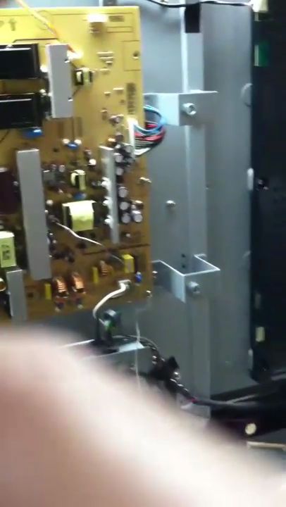

      Let's try this again.
      http://i177.photobucket.com/albums/w...D92AD461D1.mp4
        Re: Sceptre X460BV-F120 2 seconds to power off.
        Yep, those were the cathodes, there are two per diode. And we see the same pulsing on the negative portion of the wave. So check the voltage across the primary capacitor while it is working. Your meter may not be fast enough to register the pulsing, so first try replacing the startup capacitor for the PFC section, let me know if you need help locating that. Also, does the same pulsing occur (perhaps on a lesser scale) with the inverter disconnected? -- just in case the inverter is causing the fault.

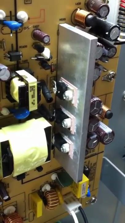

                  So, I'm not so sure that the cap is the problem. The big cap is a 270uf 450V cap. With the questionable cap out of the circuit, I connected two 150uf 450V caps in parallel and jumpered them into the PSU with the same results.
                  Is it possible for a ceramic capacitor to make the whining noise? I took a three foot section of tubing with one end up to my ear and used the other end to locate the sound. If I touch the end of the tube to the cap circled in the pic below, I hear the sound loud and clear. If I touch the transformer but not the cap, I hear it, but not like I do if I'm touching the cap. I'll see if I can get a good video.
                    #29
                    Sorry, I meant "there's your problem" as in, that's what's causing the issue with flickering backlights/buzzing etc. Not necessarily the big cap. In this case I reckon the startup cap could be the fault. I've looked at the board and can't definitively narrow down which is the startup cap. It could be any one of of those four down the bottom left of the PSU. So flip the board out and take a picture of the back side.
                    The whining can come from some capacitors (microphonic effects), but it's more likely to come from coils and transformers.

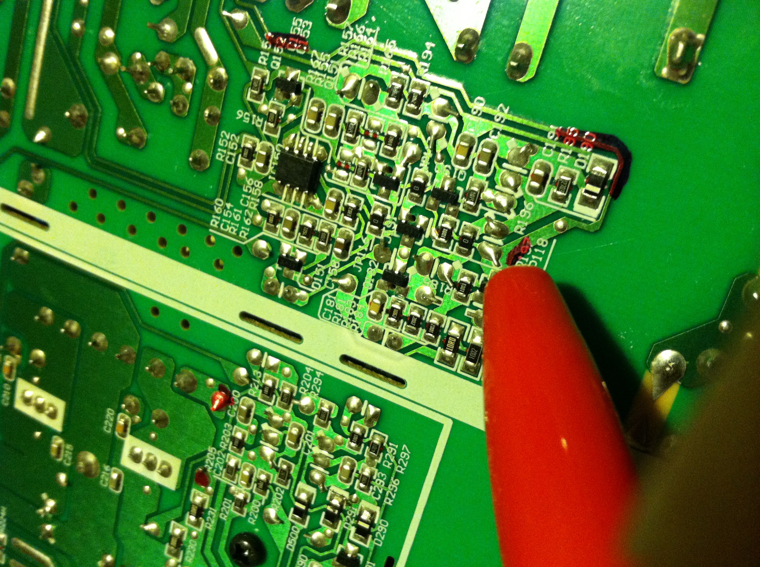

                              Part number of IC120 please -- top right of board.
                              • johnboy1313
                                • Nov 2012
                                • 1959
                                #35
                                I think it says TKAA FAN6961. That's with two pairs of reading glasses and a magnifying glass.
                                  #36
                                  I'm gonna guess you're correct as it is a PFC controller.
                                  Vcc is pin 8... follow the trace from pin 8 and it should lead to the startup capacitor.
                                  • johnboy1313
                                    • Nov 2012
                                    • 1959
                                    #37
                                    I traced pin 8 to this area. Things aren't marked so well on the back of this board. This is the first cap I come to but it's hard to follow the trace from that point.
                                    • johnboy1313
                                      • Nov 2012
                                      • 1959
                                      #38
                                      The other side. 50V 10uf. I have several 50V 22uf caps. Would they work?
                                        #39
                                        22uF would probably be fine -- value is not critical, also the maximum voltage on Vcc should be about 30V, so a 35V cap should be fine... but I'd go with the 50V to be safe.

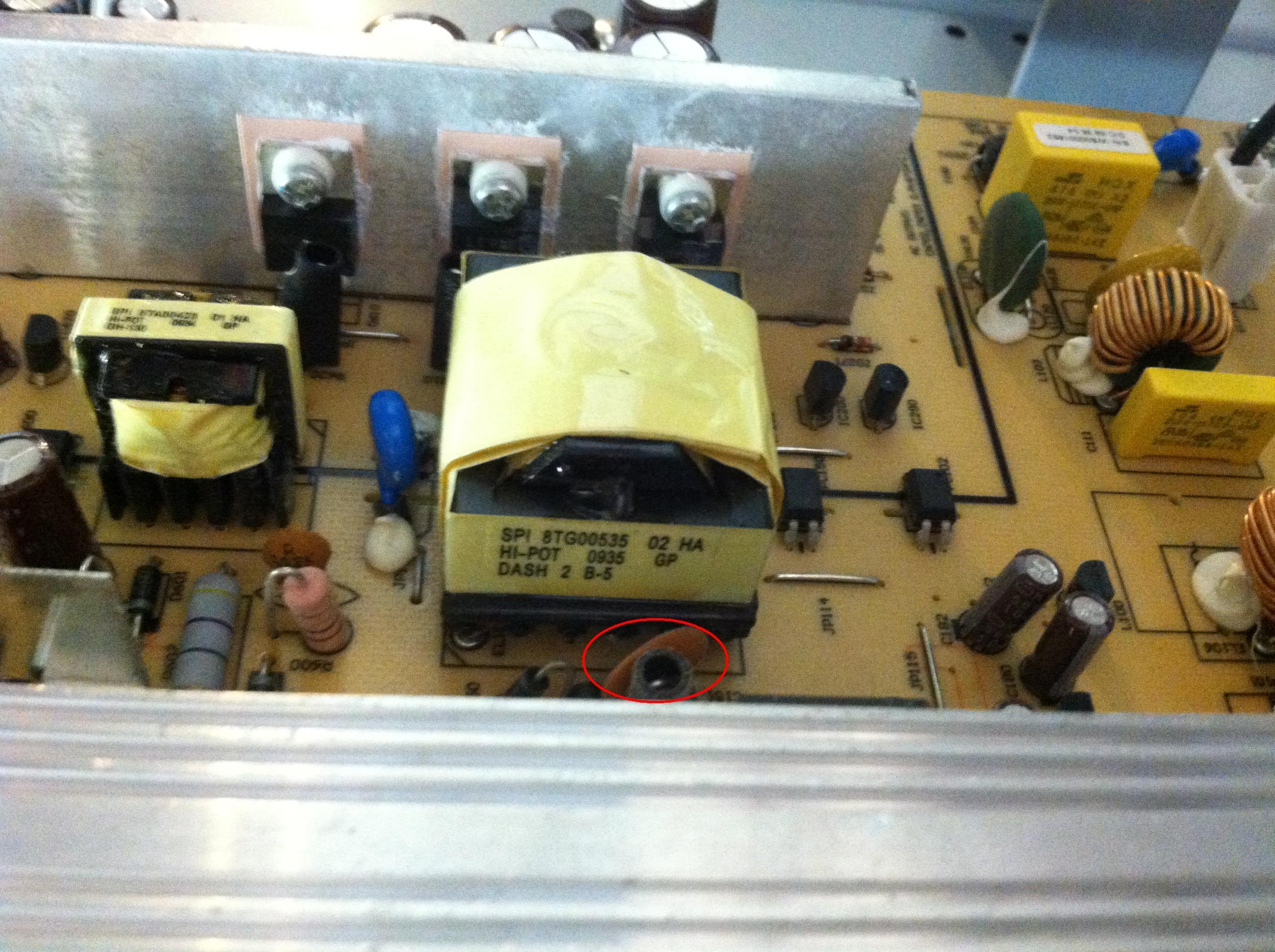

                                          I replaced all four caps with the correct caps. No luck. The big cap still fluctuates. Turned out to be three 50V 10uf caps and one 50V 22uf.
