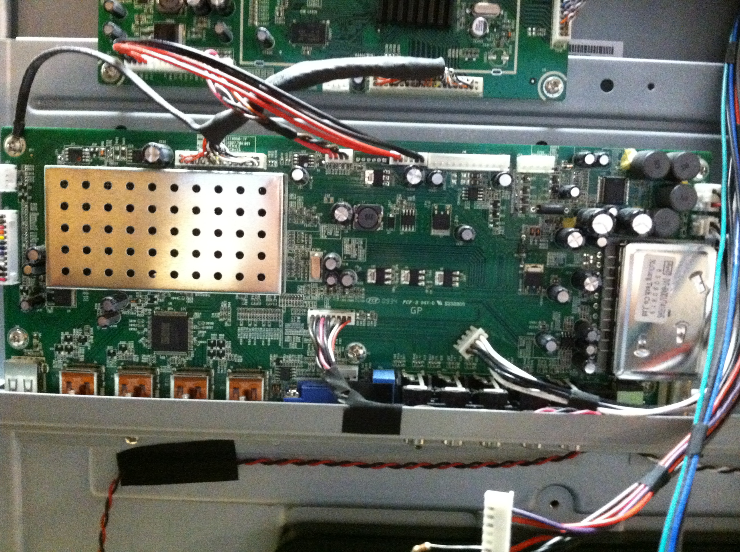

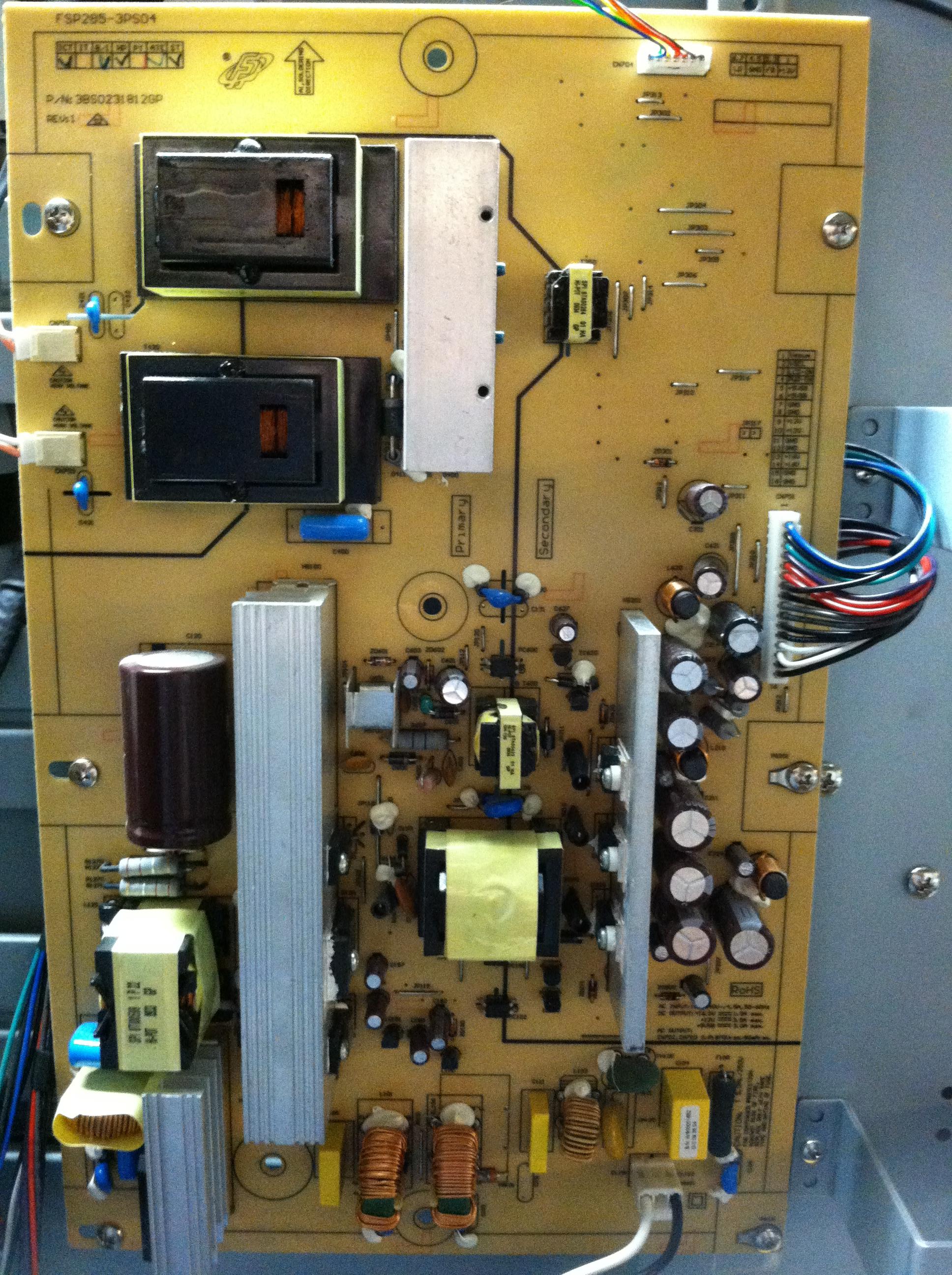

    Just picked up this 46" X460BV-F120. When plugged in, there's an odd rumble from the speakers then the Sceptre logo shows and the picture turns off with no sound. With the back off, I immediately noticed a very loud whine coming from the large transformer in the center of the power supply. The lowest transformer between the heat sinks. The whine started with a low pitch that got higher and higher after a few seconds. With the unit unplugged from the wall, the whine continues for sometime as the caps discharge. I forced the PSU on and the backlights came on but strobed rapidly. At that time the whine from the transformer kinda went crazy.

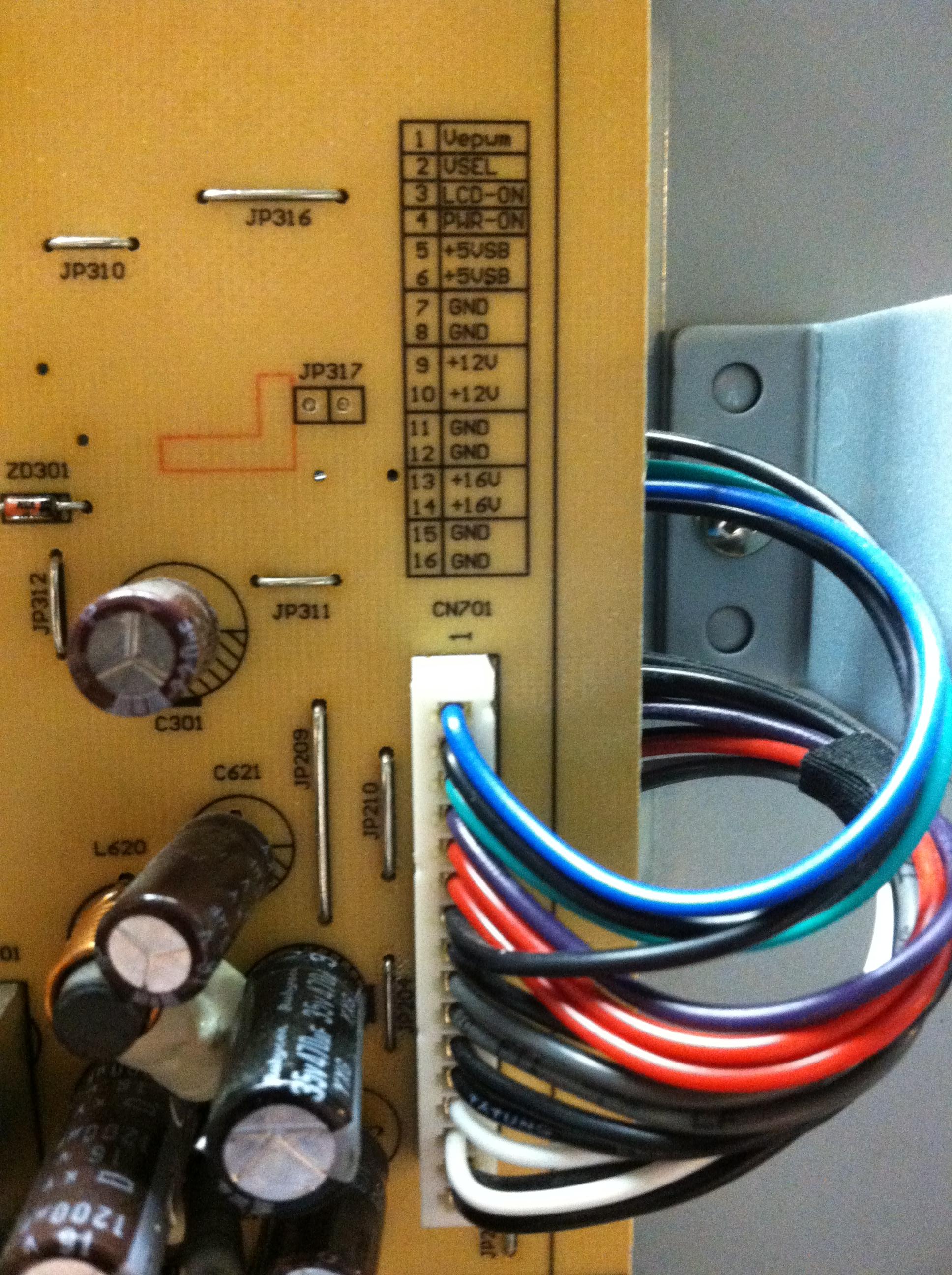

    At standby, the voltages are
    1=.72V
    2=0V
    3=0V
    4=0V
    5=5.11V
    6=5.11V
    7=0V
    8=0V
    9=0V
    10=0V
    11=0V
    12=0V
    13=0V
    14=0V
    15=0V
    16=0V
    At power on the whining stops immediately and the voltages are

      Inspect the primary capacitor, and consider replacing it. I have heard of a PSU making such a noise when that cap fails, along with strobing backlights. You can try measuring the voltage across it. Other possibility is failed PFC circuit. If you don't have ~400V across it, but instead about 160V (USA), then the PFC is not working.

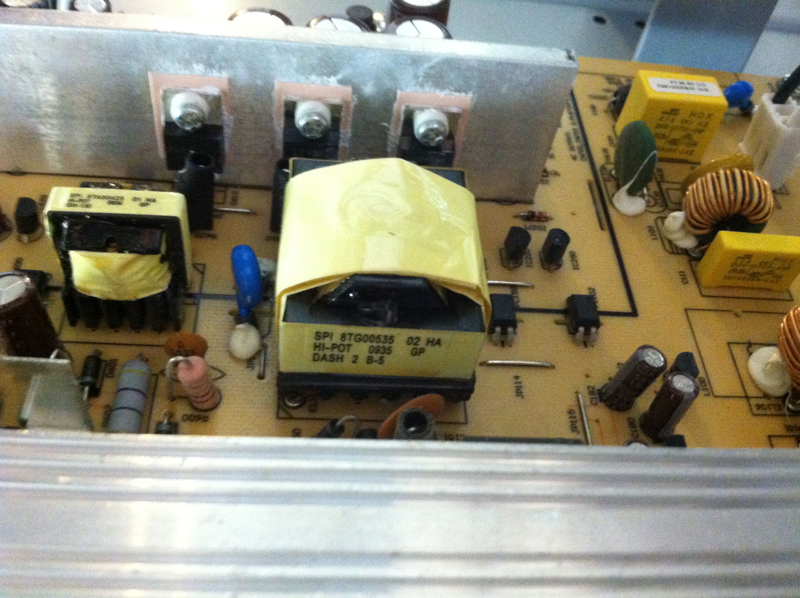

          So when it is working, do you see any drop as the PSU whines? Try to locate the PFC section. It'll have an inductor (marked Lxxx) and a MOSFET (marked Qxxx) and a diode (marked Dxxx) in the same area. The capacitor near it is probably faulty, try replacing that.

            I'm forcing the PSU on with two 220 ohm resistors from each 5V to LCD-ON and PWR-ON. When I unplug everything from the PSU and force it on, the transformer still whines, but I get steady voltages at all rails. The LCD-ON and PWR-ON rails each measure 5.11V. Is that too high? Should I try two AAA batteries?
            With the inverters connected to the PSU and the PSU forced on using the method described above, the 12V and 16V rails measure (11.8-11.9) and (15.5-15.6) respectively.

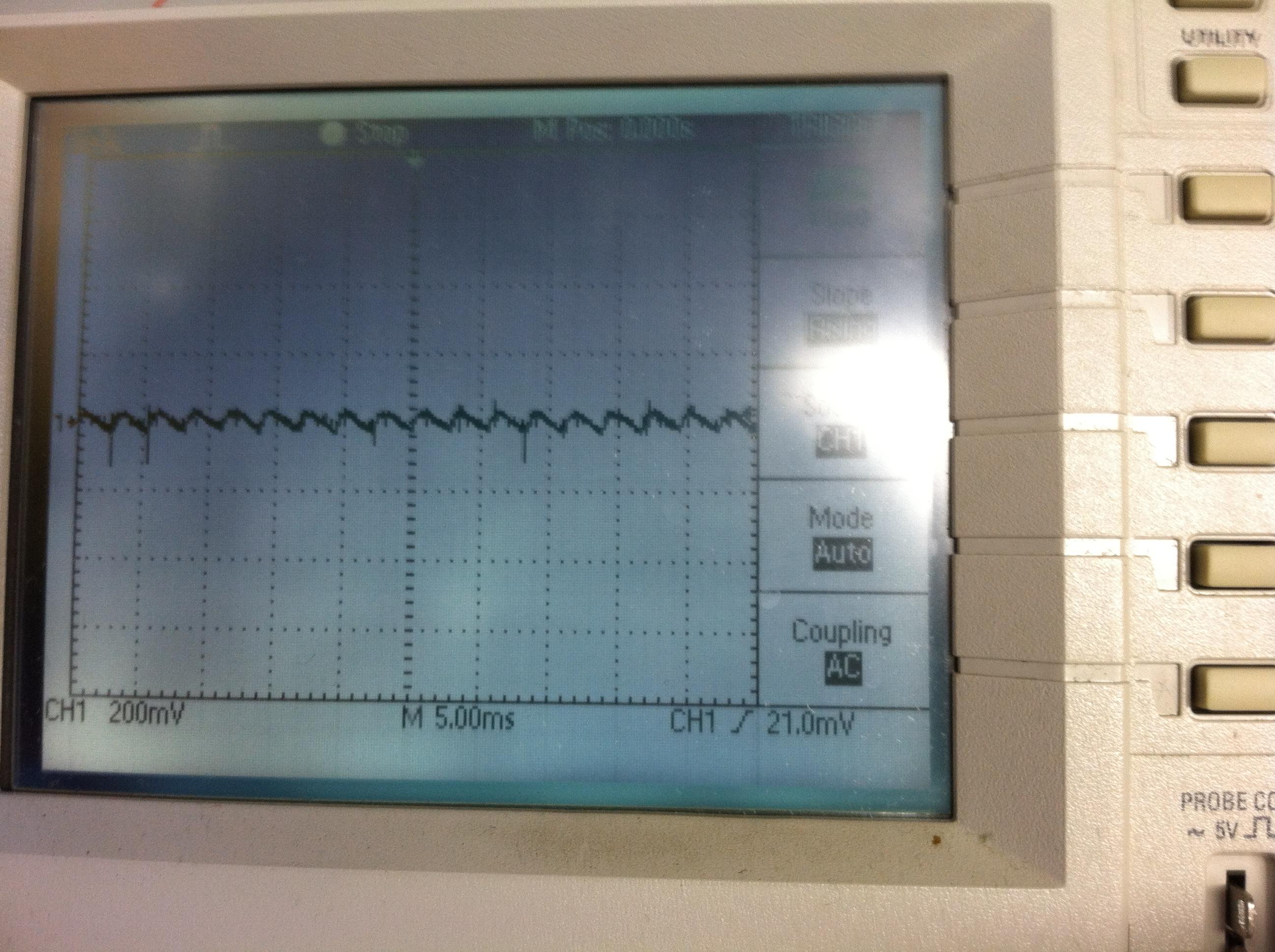

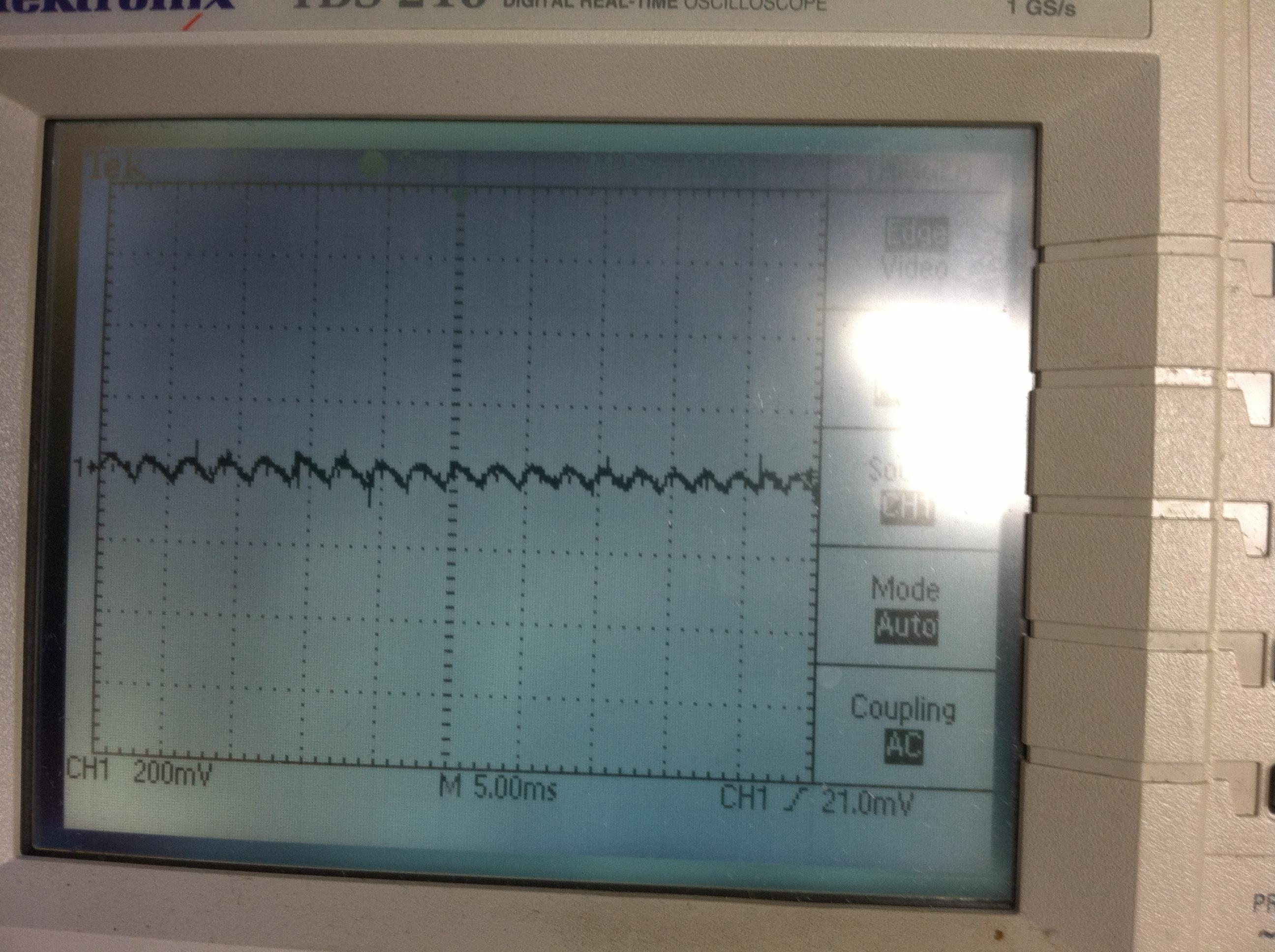

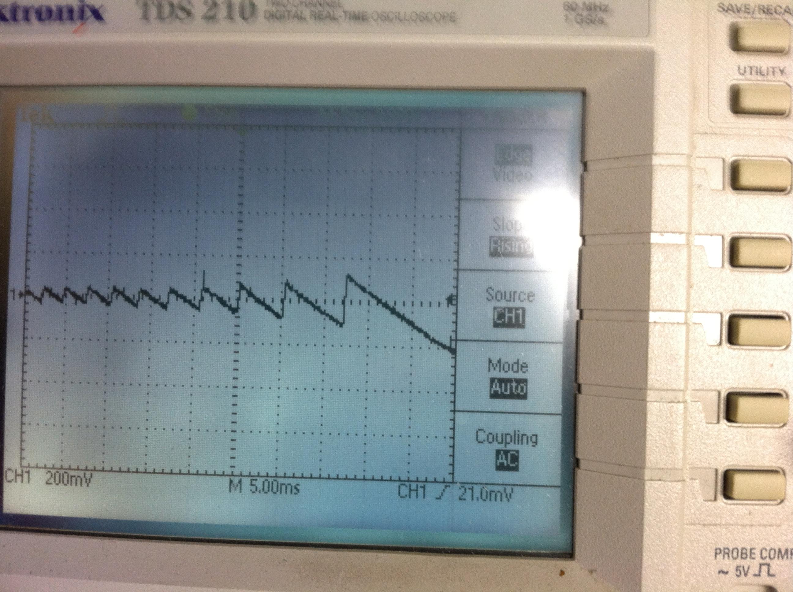

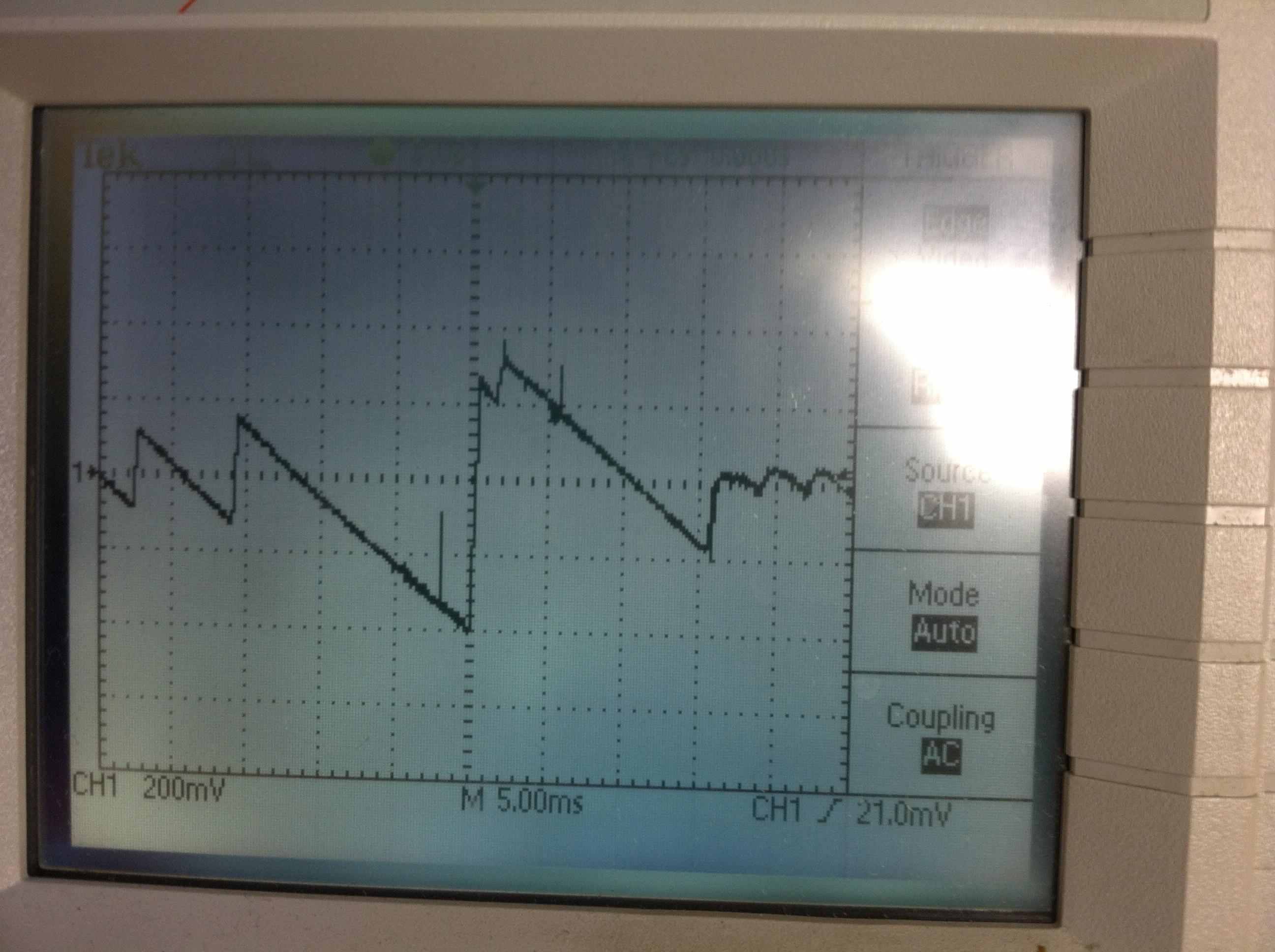

                            I'd suggest you set the scope to AC coupling, line trigger, 5ms/div and 200mV/div, and measure each of the 24V, 12V and 5V outputs.
                            I set the scope per your instructions, but I couldn't figure out how to set to line trigger. With everything disconnected from the PSU and the PSU forced on, the PSU whined like before but every ~3sec there was a brief click and then the whine. This cycle was continuous.
                            The pictures below, in order.
                            1) 16V rail while whining
                            2) 16V rail at click
                            3) 12V rail while whining
                            4) 12V rail at click
                            5) 5V rail while whining (used autoset here, the wave just looked like a thick black wavy line with the settings above)
                            Not Pictured, 5V rail at click looked nearly identical to 5V while whining but higher voltage.
                              Re: Sceptre X460BV-F120 2 seconds to power off.
                              5V is the standby line, and it's likely going to run off a separate supply.
                              We need to figure out why the rail starts becoming unstable but that's definitely your problem right there.
                              To set up line trigger on the TDS series of scopes, you need to select "Line" as the source, I think -- however, we can clearly see this isn't related to the line frequency, as it's decreasing in frequency as the problem develops. That start frequency though is way too small. I don't know why yet...
                              I'd suggest you find the cathode of the diode for one of the outputs. We're looking for the negative pulse on this. It'll probably be around twice the normal output, but it should vary with the line voltage. Try to get a capture on 1sec/div; use of the RUN/STOP button will help here. (I can't remember if this scope has a SINGLE button, but if it does, use that instead.)

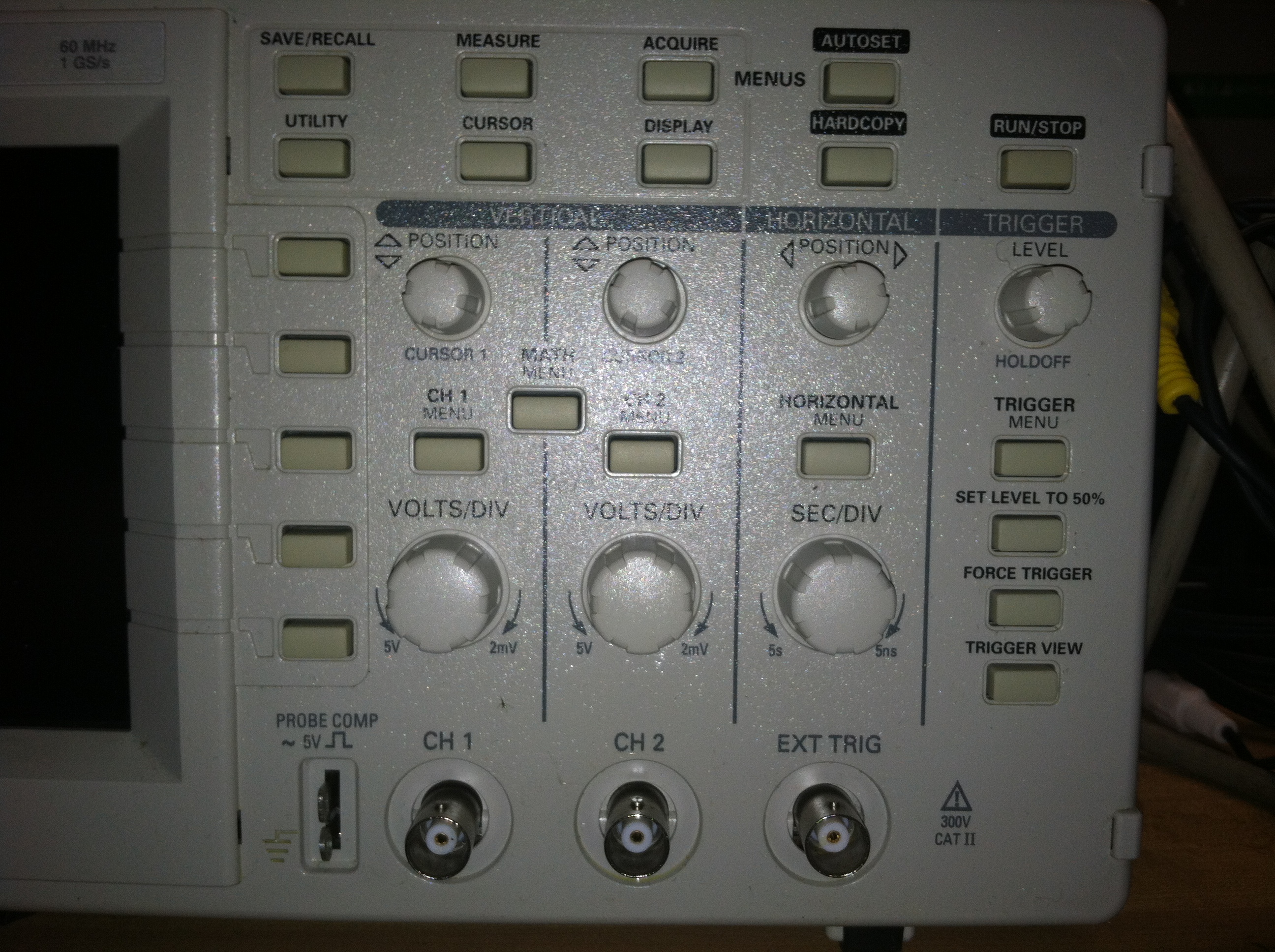

                                    Here's a pic of the buttons on the scope.
                                      OK, no SINGLE button, but you can recreate the effect with RUN/STOP. Just press RUN/STOP, then again RUN/STOP on the frame you want.

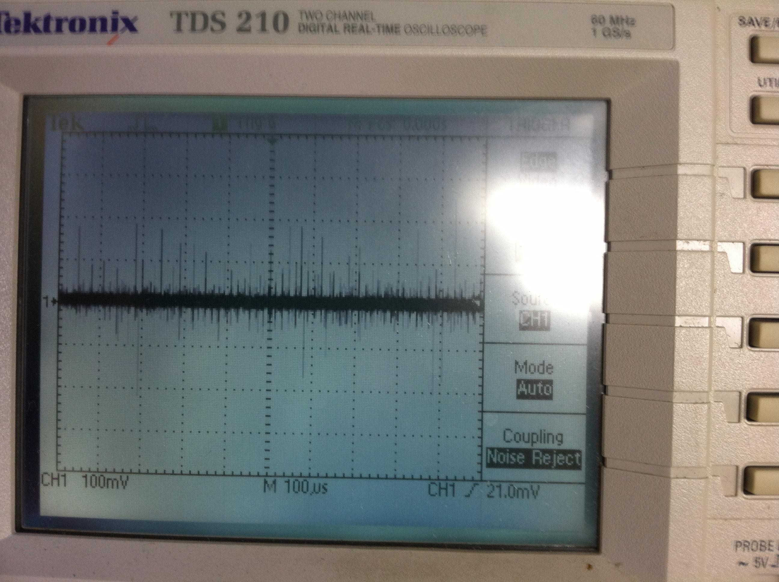

                                        Couldn't get a decent pic. Not sure if the settings I used were correct. Here's a video I made. I hope it shows you what you want to see.
