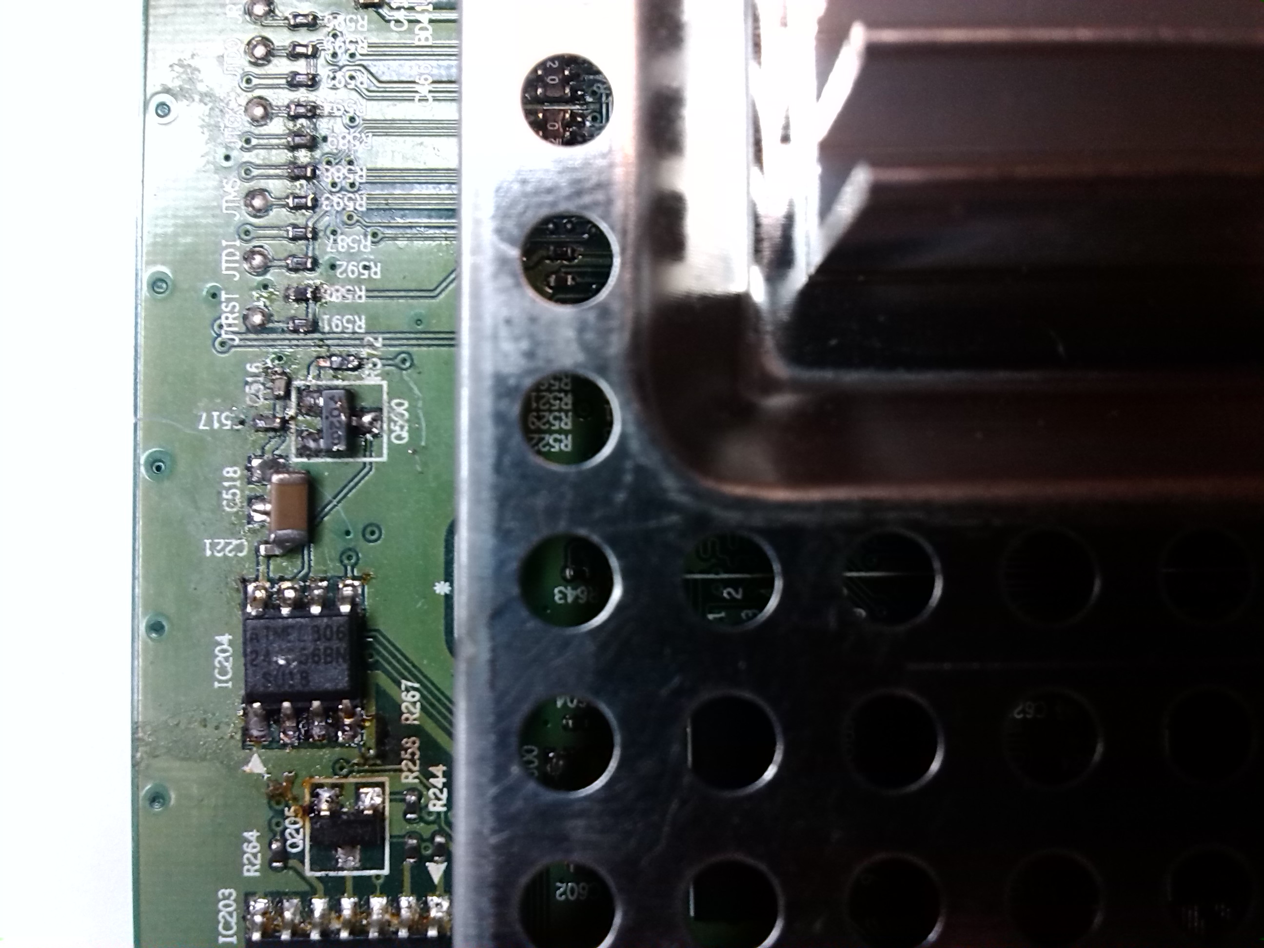

                    Changing the caps did not fix my board. When the board is cool, it won't start unless I apply heat in the area or right on Q500. Once it starts, it will restart every time, unless I let it sit and "cool" off.
                    Along with C102 and C131, I've replaced Q500 and the Caps right above it (C516-518) with no success. At this point I'm wondering if there's a break in one of the inner layer traces under Q500.
                    Still stumped!!
                      #50
                      Re: Samsung LN52A550 - clicking. Eeprom or something else?
                      Can I see the picture in the area of Q500? Also can you do spot cooling?

                        #51
                        Sorry it's rotated 90 degrees. This is along the top side of the board, to the left of the ribbon cable and just above the metal can over the CPU.
                          #52
                          It looks like it has something related to that ATMEL IC next to it, may be look up what the ATMEL IC is?
                          ATMEL 806? I cannot read the numbers.
                          BTW I use adjustable soldering Iron and set to low setting for pinpoint heating of the component.

                            #53
                            That Atmel IC is the main NVM IC204 24C256. I've swapped that with no success (and performed a factory reset after swapping the chip).
                            I do have freeze spray and that's I've been using to cool it into non-working mode. Then, as you say, using a soldering iron tip, heat the pcb around Q500.

                              #54
                              looks like atmel 306 to me on the pic.
                              Something else... did you check those through holes jet?
                              Shoot.. clicked on the wrong doc.

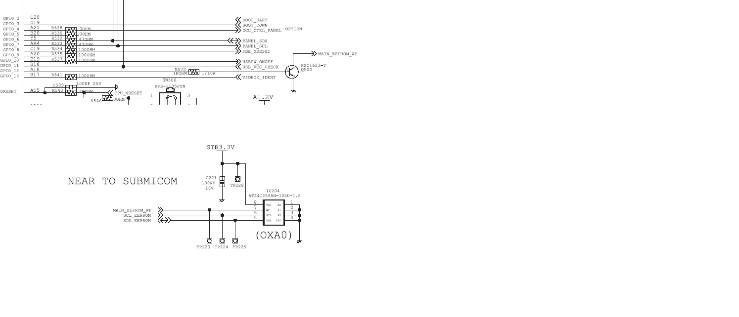

                                Lets try that again. 24C256 is an EEPROM. So usually these things work or not. Never had one fail of these yet. This is the correct file.

                                  #56
                                  Yes, the AT24C256BN is the correct part. I have a good microscope and I've checked the via's and don't see anything unusual. Is there some other way to check them?

                                    • 8352
                                    #57
                                    Yes, by taking them off and put it in an EEprom reader.
