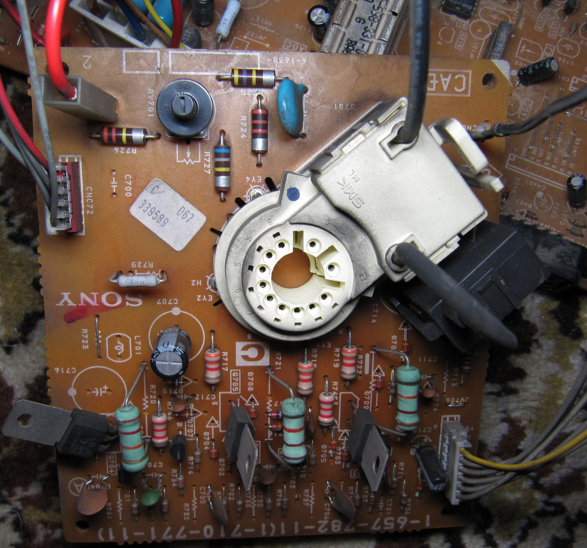

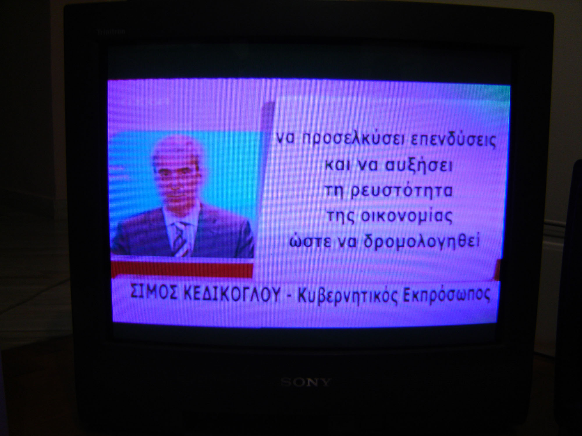

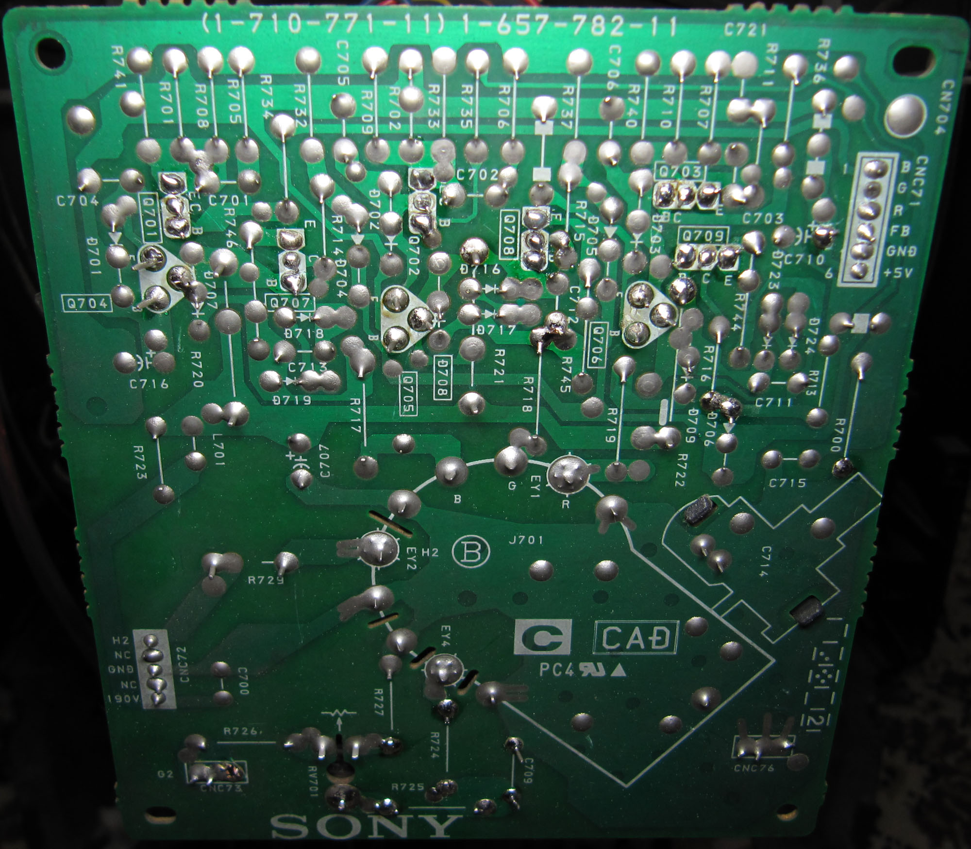

    I checked all the caps and replaced 4 that had higher esr than normal.
    I checked for cold solder joints and reflowed when necessary.
    I also checked the transistors on the board connected to the neck of the tube and found nothing shorted or open.
    Yet, the image is reddish.. I don't know what to look for and I could really use your experience guys.
    2 photos of the CRT image attached
    Re: Sony KV_21M1D (BE-4A) image reddish
    I have seen this before, I do not repair CRTs, but I believe the tube is ageing, it is repairable though by tweaking the red level down, but I can't remember where that is done.

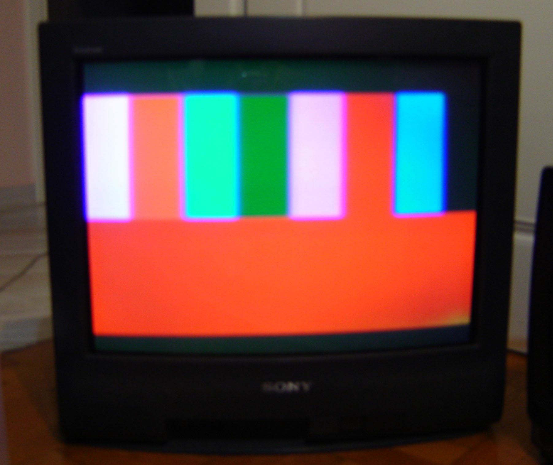

          This is the service manual. I could try to change the red levels from the service menu. Are you sure this is a tube problem?
              Turns out that the green color is dead. I think it is the tube. I tried to correct the image through the service menu, but I can't do much... It is blueish or reddish or both. And the only settings that worked gave really dark/fuzzy image. This TV is not fixable.
