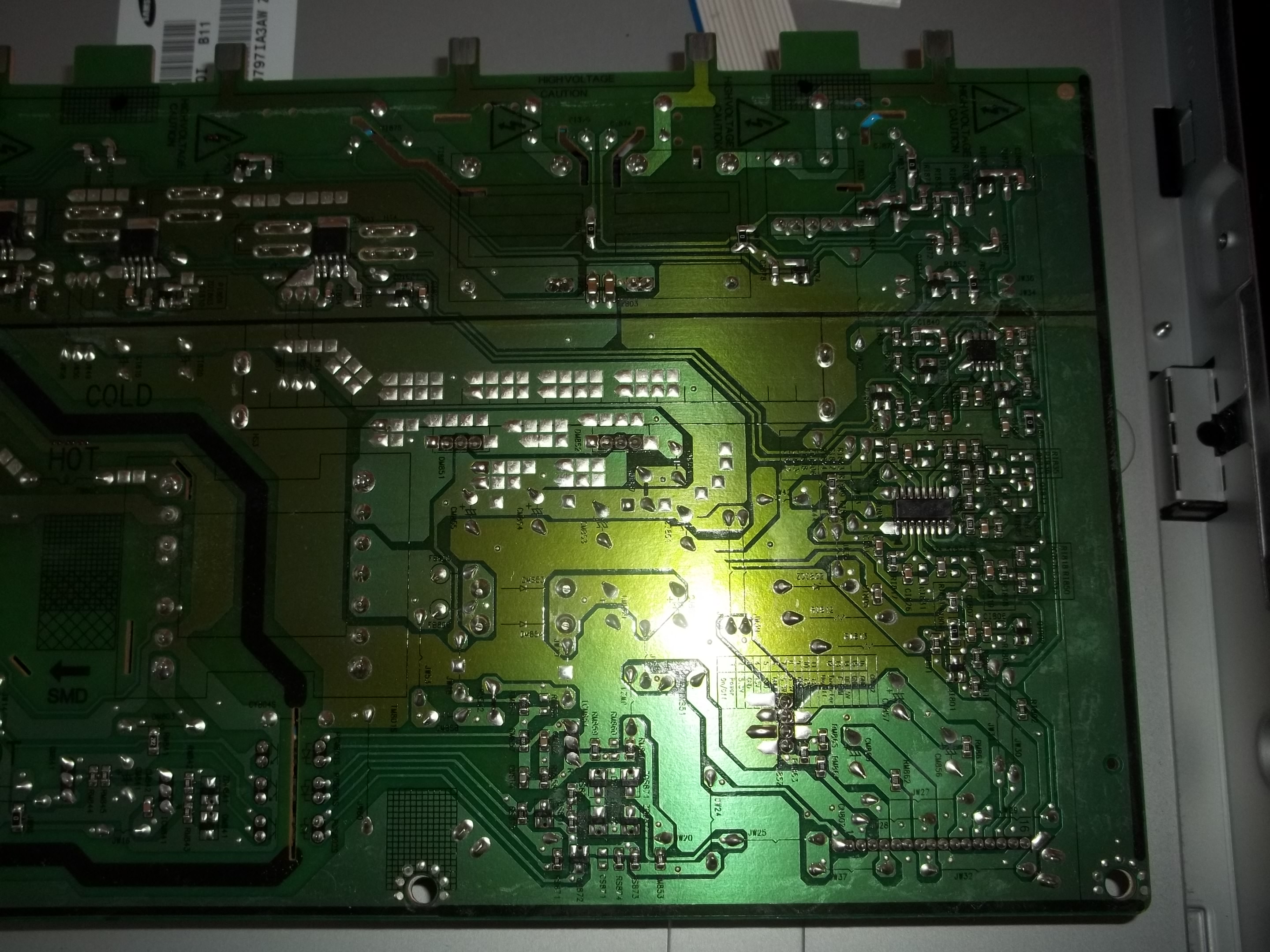

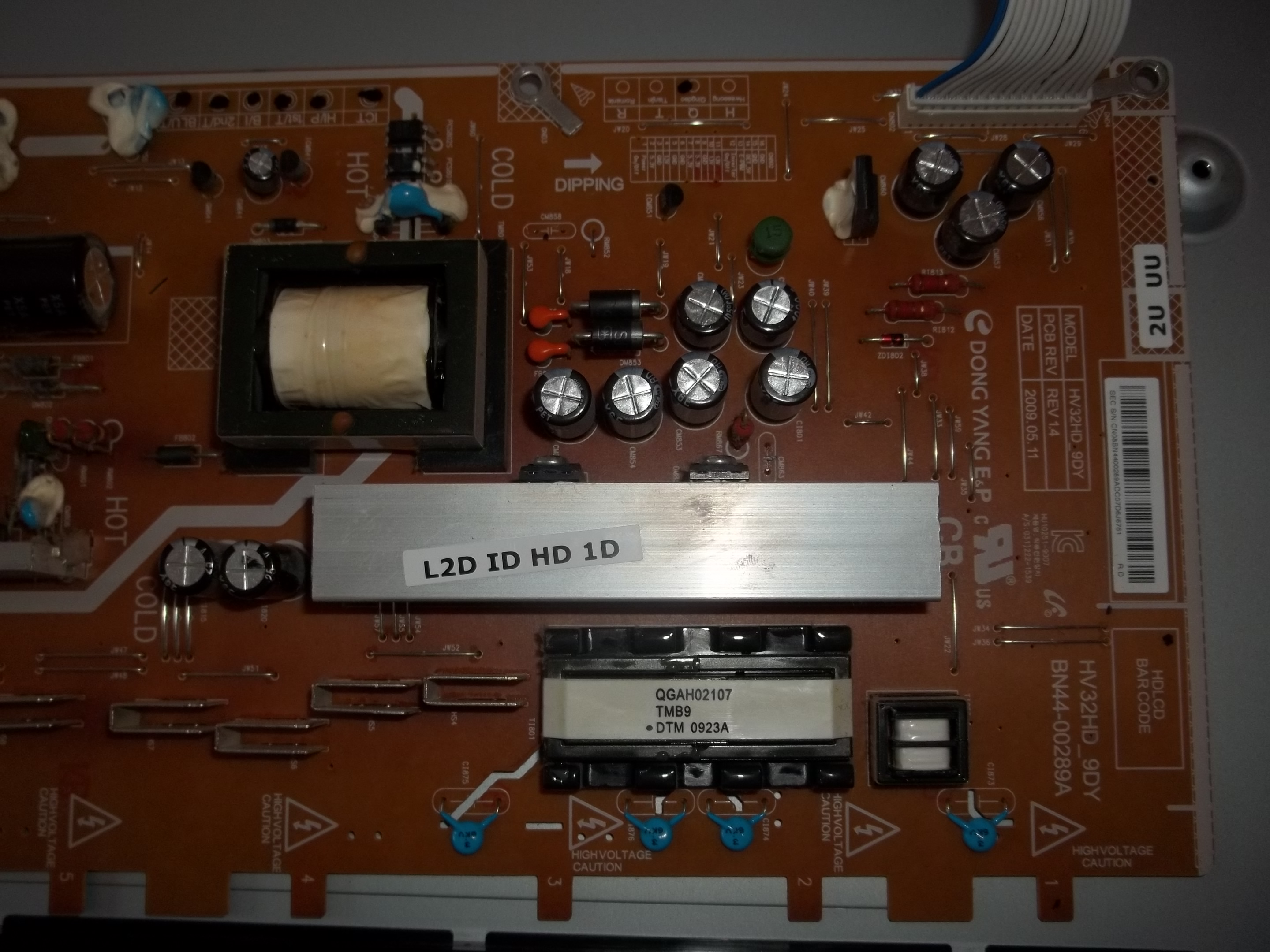

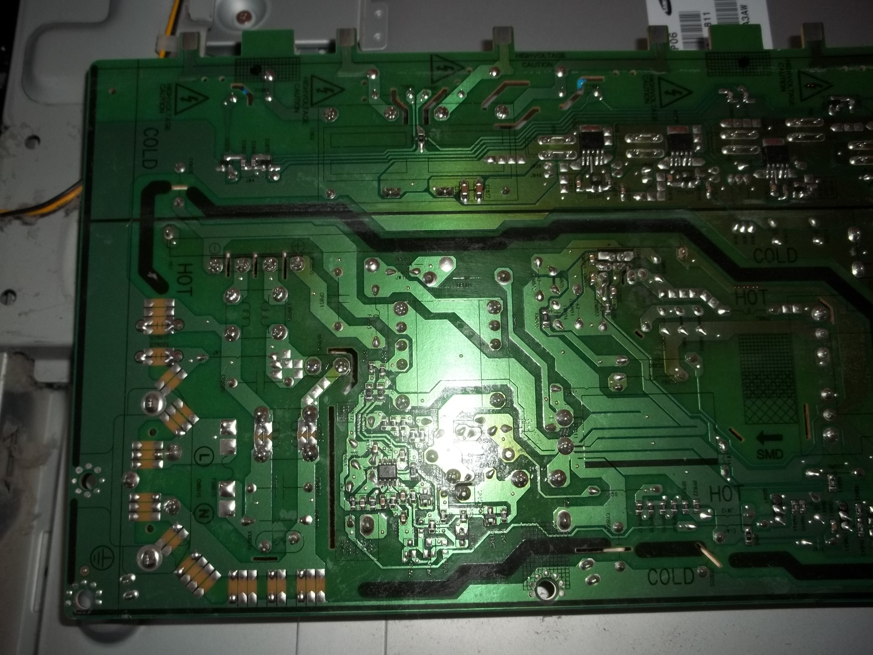

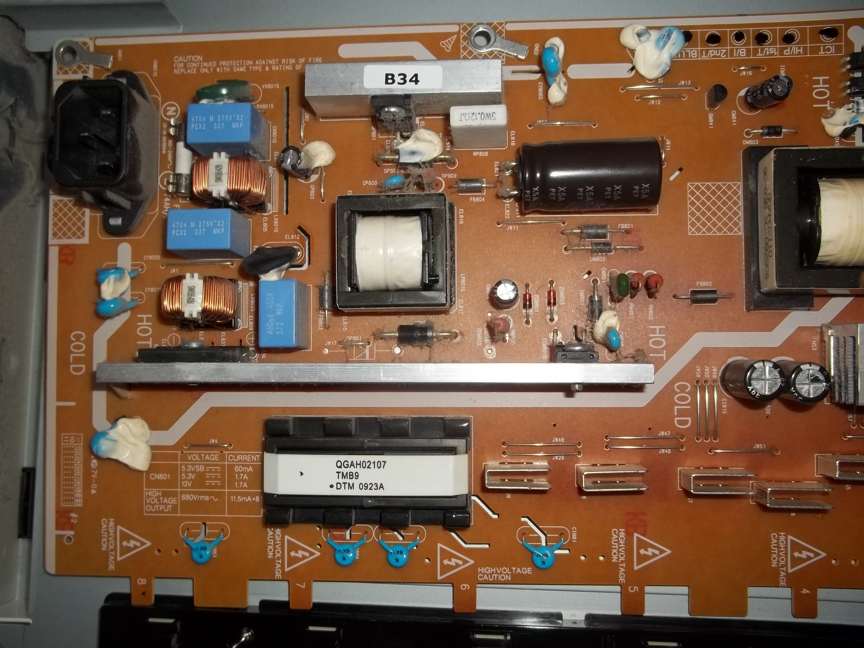

    Here are the photos. I had to take two photos of each side of the power supply, since it's so large.

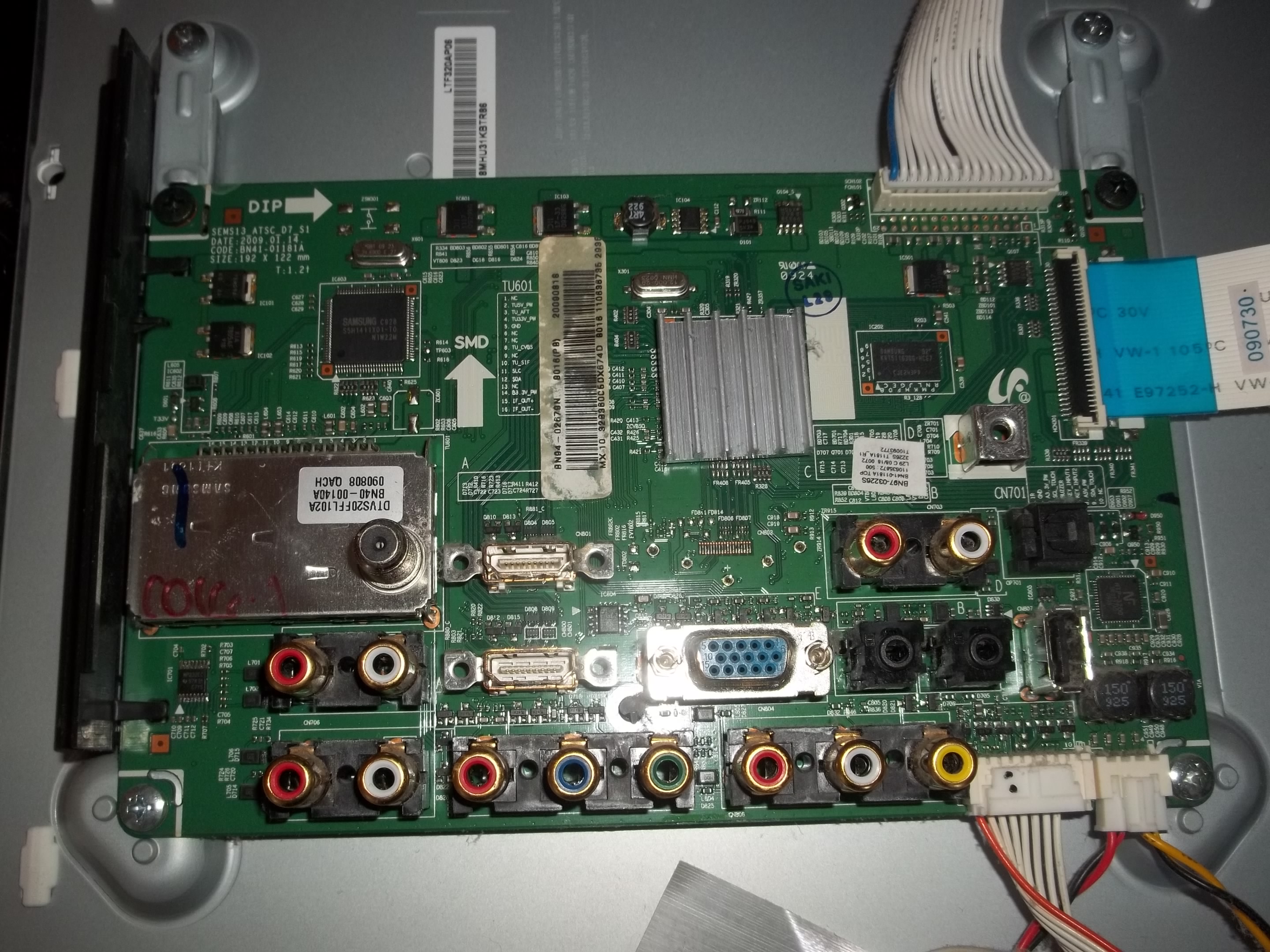

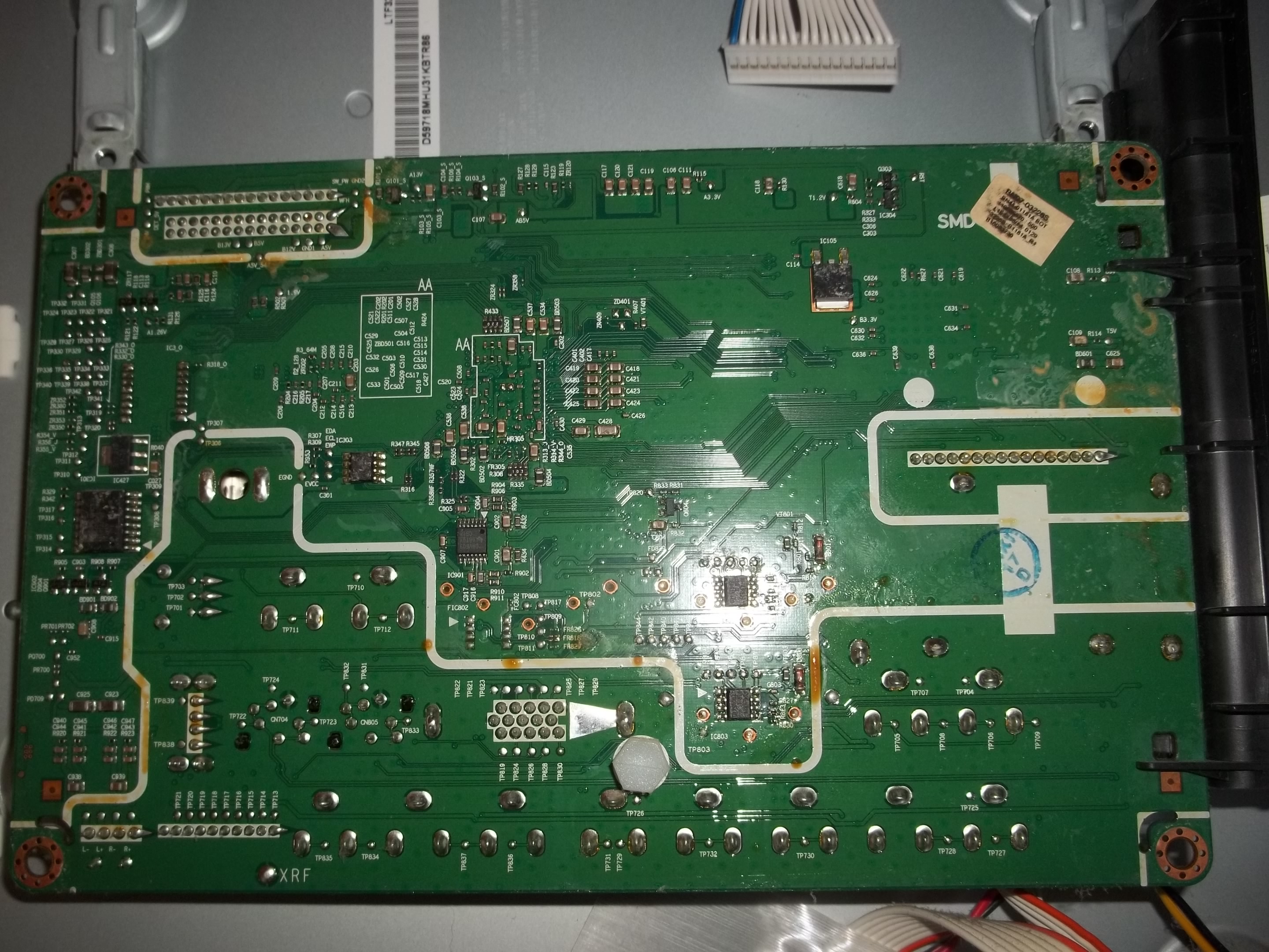

    I hadn't taken off the logic board before now, and I'm noting what appears to be something that spilled on it. I could be wrong.

          If I remember this chassis, some one in this forum found shorted diode in the power supply/inverter board, you may want to check those black diode with the silver band, set the meter to Ohm mode 200 Ohm range.
          I will search the forum to see find that thread.
          What is the P/N of this power supply/Inverter board? BN-XXXXXX, tom66 may have the diagram for it.

            It's a HV32HD_9DY, rev 1.4
            • Peale
              • Apr 2009
              • 96
              Re: Samsung 32" ln32b360c5d
              Oh, BN number - BN44-00289A

                    All of the diodes on the power supply board appear to check out.
                      OK. we should check the High voltage winding resistance of the transformers next.
                      We need to find the pin out of the inverter transformers.

                          I think I missed a diode from before - ZDI802.
                          In circuit, the diode has a junction drop of .095, both ways. I had to get out my Fluke to double check, but it seems to be reading as shorted.
                          So...now to source a replacement.
                          edit: anyone have the schematic so I can get a part number?
                          • Peale
                            • Apr 2009
                            • 96
                            It's reading fine out of circuit. I think I was getting a false bad reading from RI812 and RI813.
