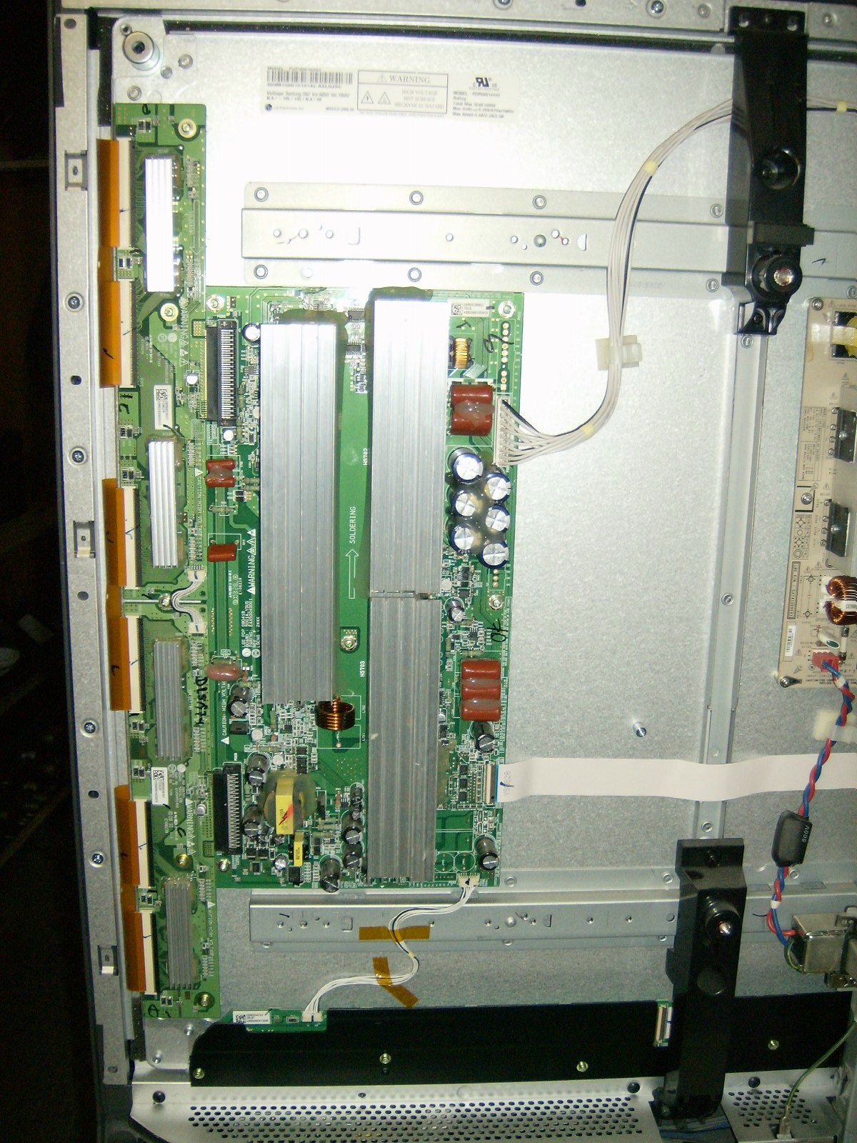

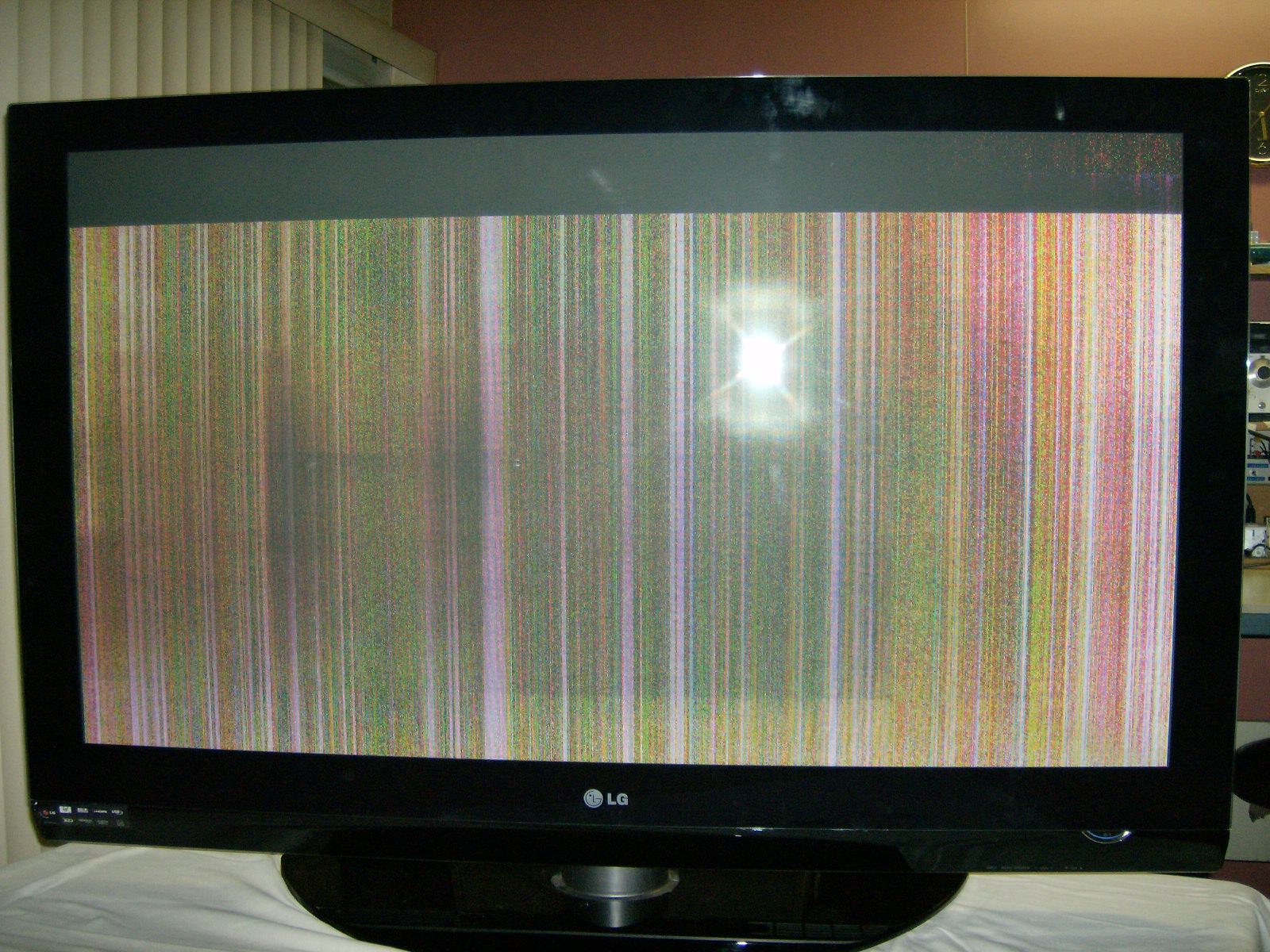

    Hi, I need your opinion. LG Plasma TV 50PG25.
    Two y-buffer in place as pictured. With no input signal, the result show on second picture. On the screen, a missing part of the top and the balance of garbage.
    If I remove the upper buffer, I get down half a screen, a raster low intensity, no missing horizontal lines. I know the upper buffer is defective, the chip on top is very warm.
    Menu on screen show also garbage.
    My question: Is the upper buffer is solely responsible for the garbage on the screen? and possibly another faulty board (y-sus, ctrl)?

    Yes, that looks entirely to me like that one upper buffer IC is causing the fault. The signal is chained from each IC so a fault with the top IC will cause all other ICs to produce garbage.

      The signal is chained from each IC . This is what I wanted to know.
