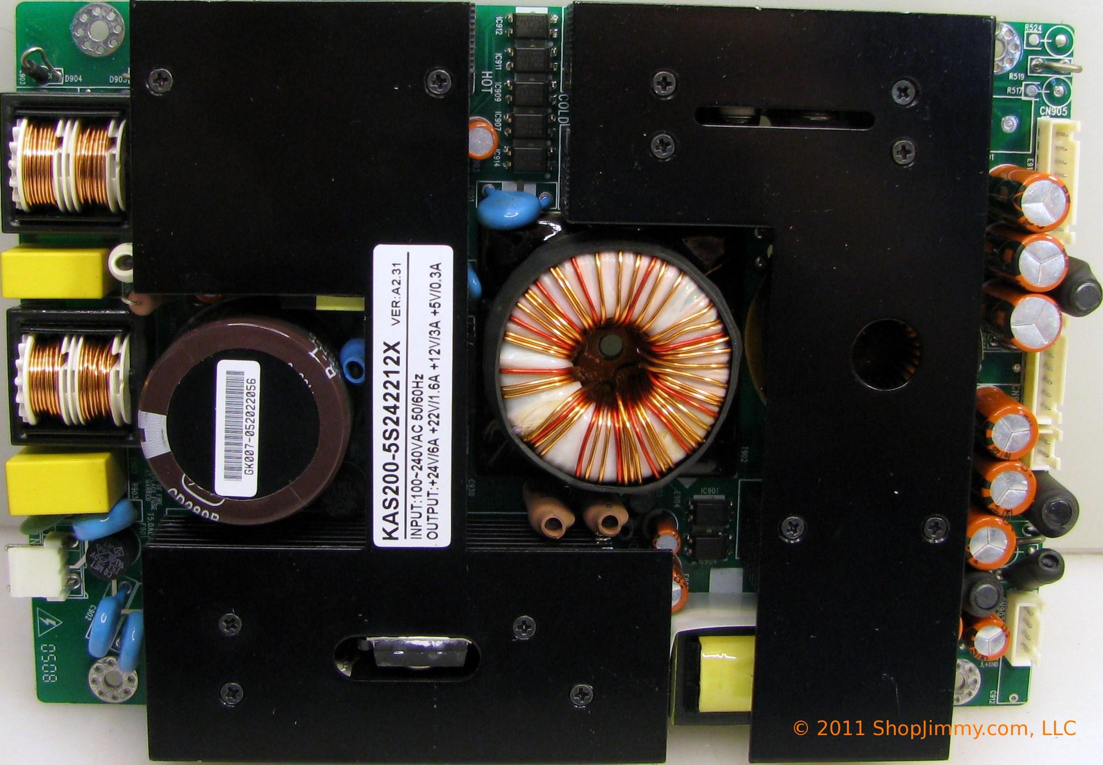

    I have a Polaroid FLM-3201 trying to save from the EWaste pile.... in standby i get a solid red light on the front, when power button is pushed, i get a solid blue light, and no picture. In reading the net, Caps are the cause. I opened it up, and sure enough several caps are mushrooming at the top. Great, I order a cap kit (as it just makes it easier), it arrives, i tell my son, hey lets fix the tv..... so here is my dilemma.... My son had started removing the caps, and before I could get into the garage he had about 8 removed already….Here is what I could come up with, but I am not sure if its right. I will give you location, voltage, and Uf rating.

    The Power Supply has KAS200-5S242212X (ver A 2.31) on the top of it

    If this is not a common set or board you will struggle to find anyone who know.
    Post a good picture of both sides of the board and close ups of the area the caps are from.
    front and back (in the same orientation) (max resolution 2000x2000 and 2MB) using the manage attachments button, which is found by clicking "go advanced" under quick reply.

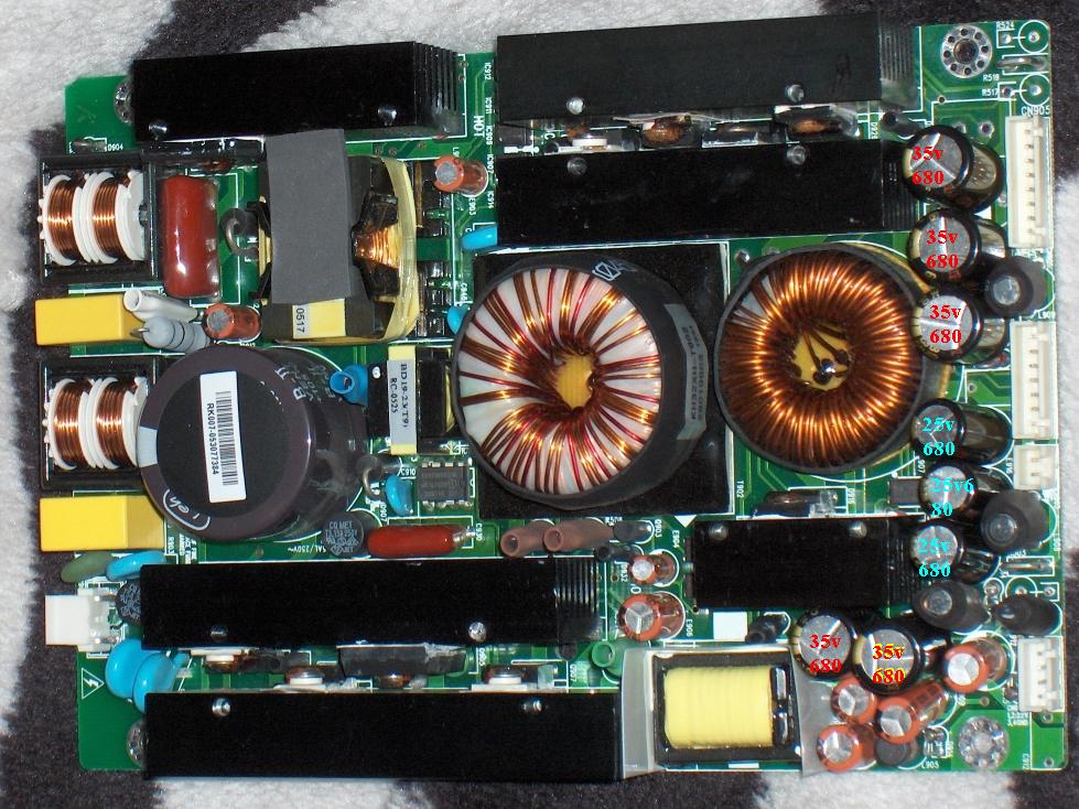

          Here are some more clues - doesnt actually say which version of the board
          but says he has replaced 5 35v680s and 3 25v680s so based on diameter
          they would go where I have indicated. You can see clearer on the original picture which 8 he has changed as he has used panasonics.
          http://www.elektroda.pl/rtvforum/topic1412619.html
          Where are you? Its always offputting when someone posts then vanishes.
          Dont know if we are wasting our time.
          IF your board is the same perhaps you can edit the picture with the values you do know

            Oh no I am here, and very much interested!!! I have been researching all over the net, to no avail. Thank you for the one picture, and the values!!! that is my PS exactly. I was checking my email, and did not expect so many replies so fast.

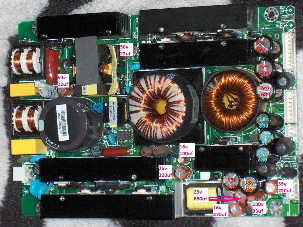

              Here is my additions to the picture.

                Good - is that it sorted then ? _ take care to put the new ones in the right way round. hopefully they are good quality replacements otherwise you may be redoing it in a few weeks.

                        Just to status the update... I had two caps in the wrong position, so i desoldered, and resoldered, and viola!! screeen came on. The I realized, i must have layed the screen down on a screw, i now have a small crack in the glass... Oh, well its not too noticible, LOL... The important things is I have power to the set.

                          Well thats good news and bad. Sorry to hear that. When you say you got two mixed up is your last picture correct? If not can you post the correct version for future viewers.
                          • Henryweston157
                            • Dec 2012
                            • 5
                            Re: Polaroid FLM-3201 Blue Light Only
                            The picture i uploaded was correct. I took that picture and went back over my caps on my board, and found the two mix matched caps.
