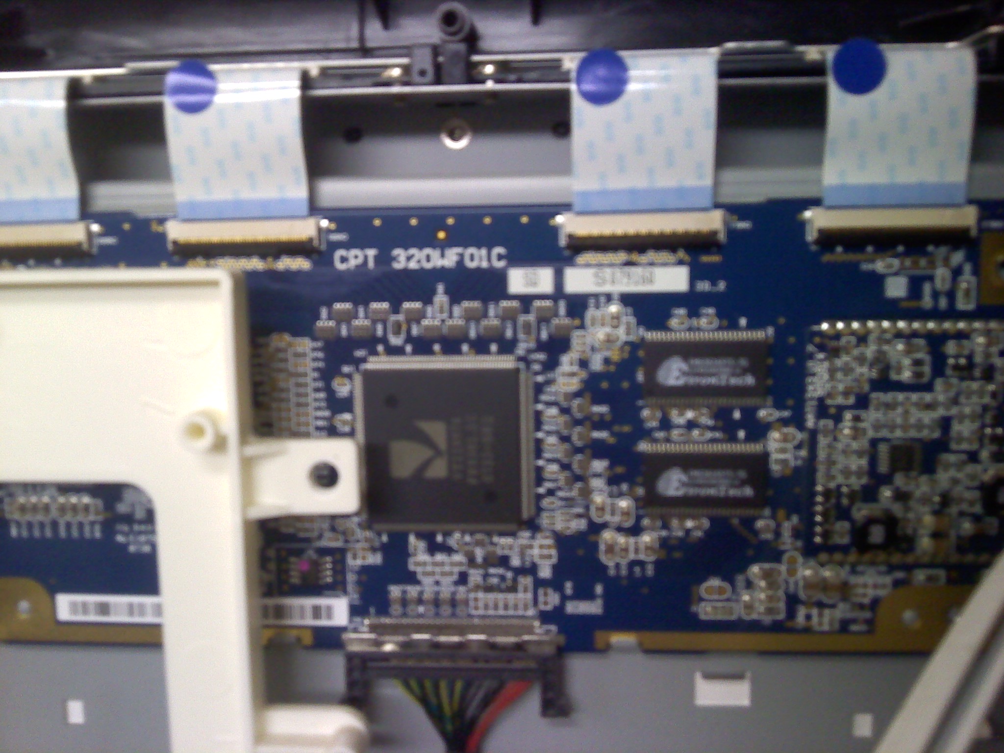

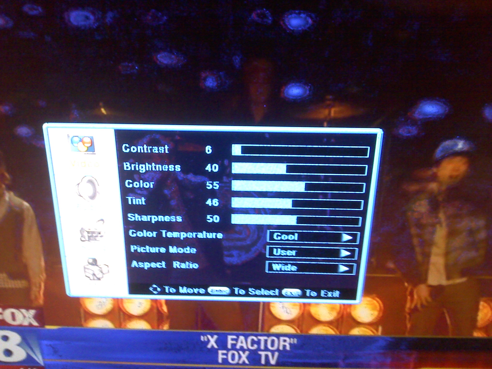

Insigina ns-lcd32 bad panel???
  • Tvbob
    tvbob
    • 204

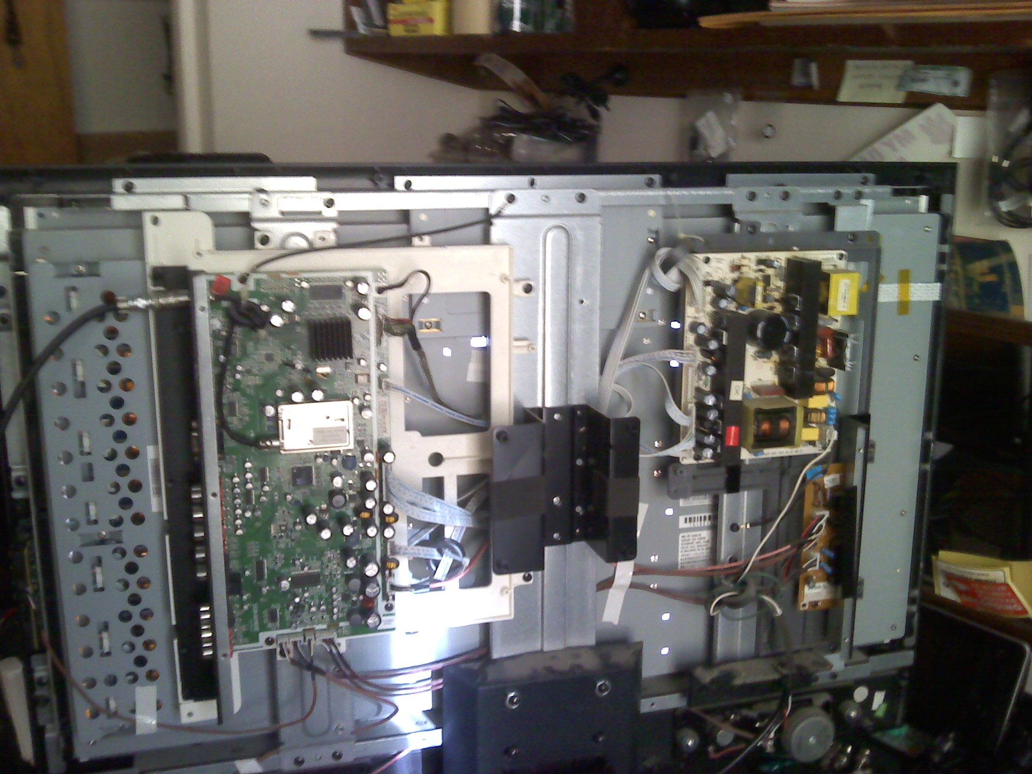

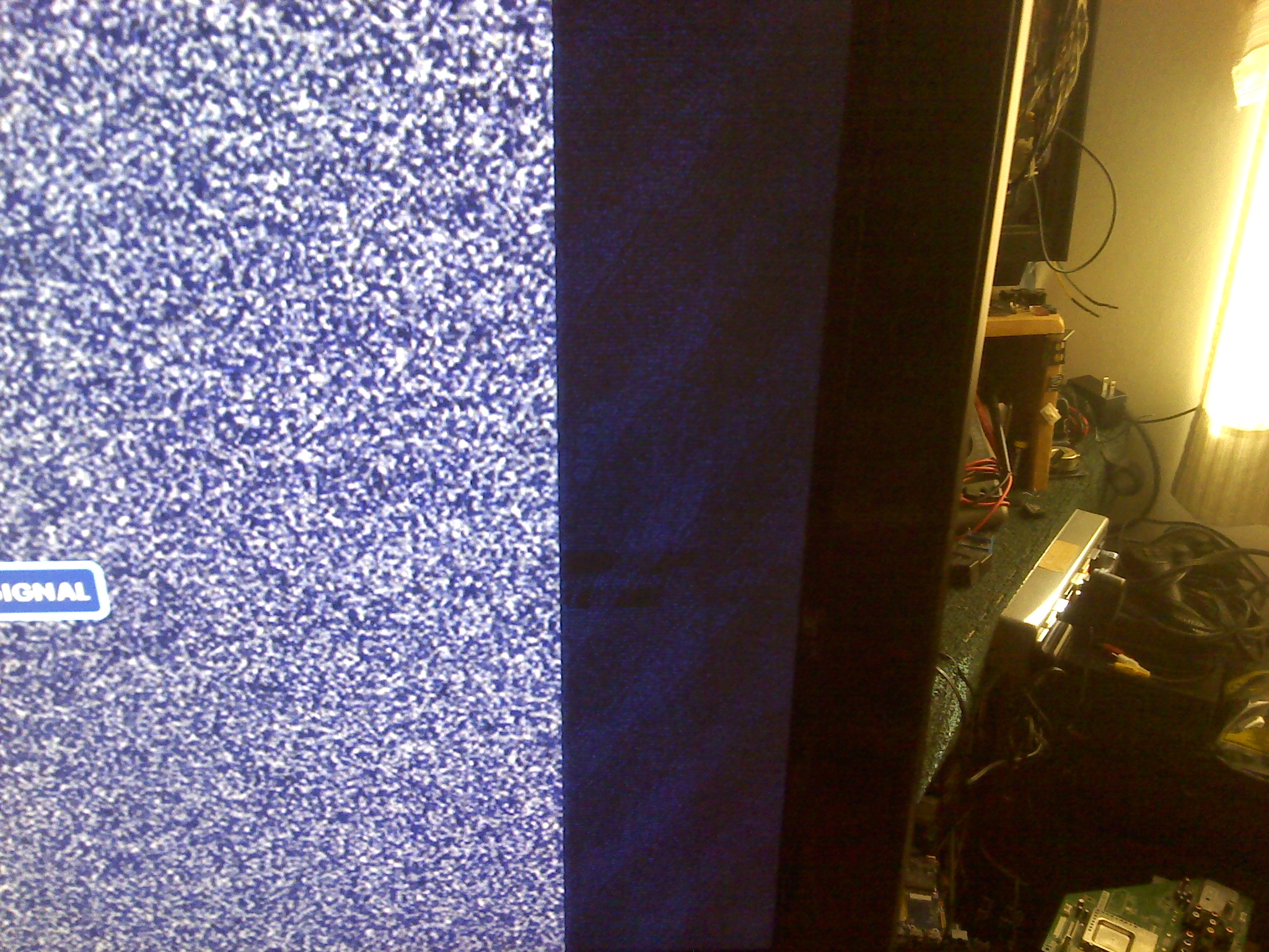

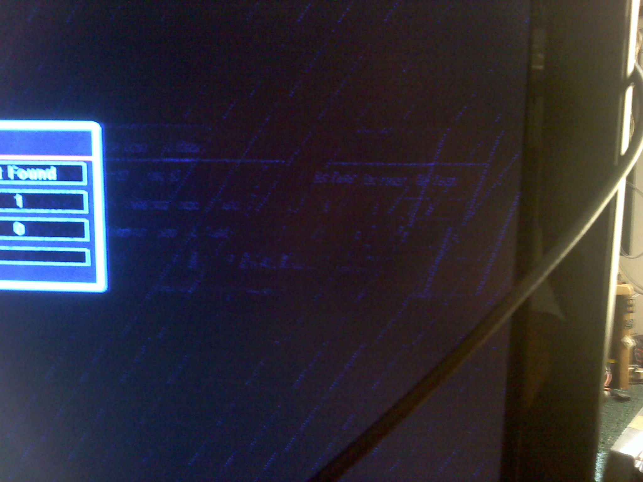

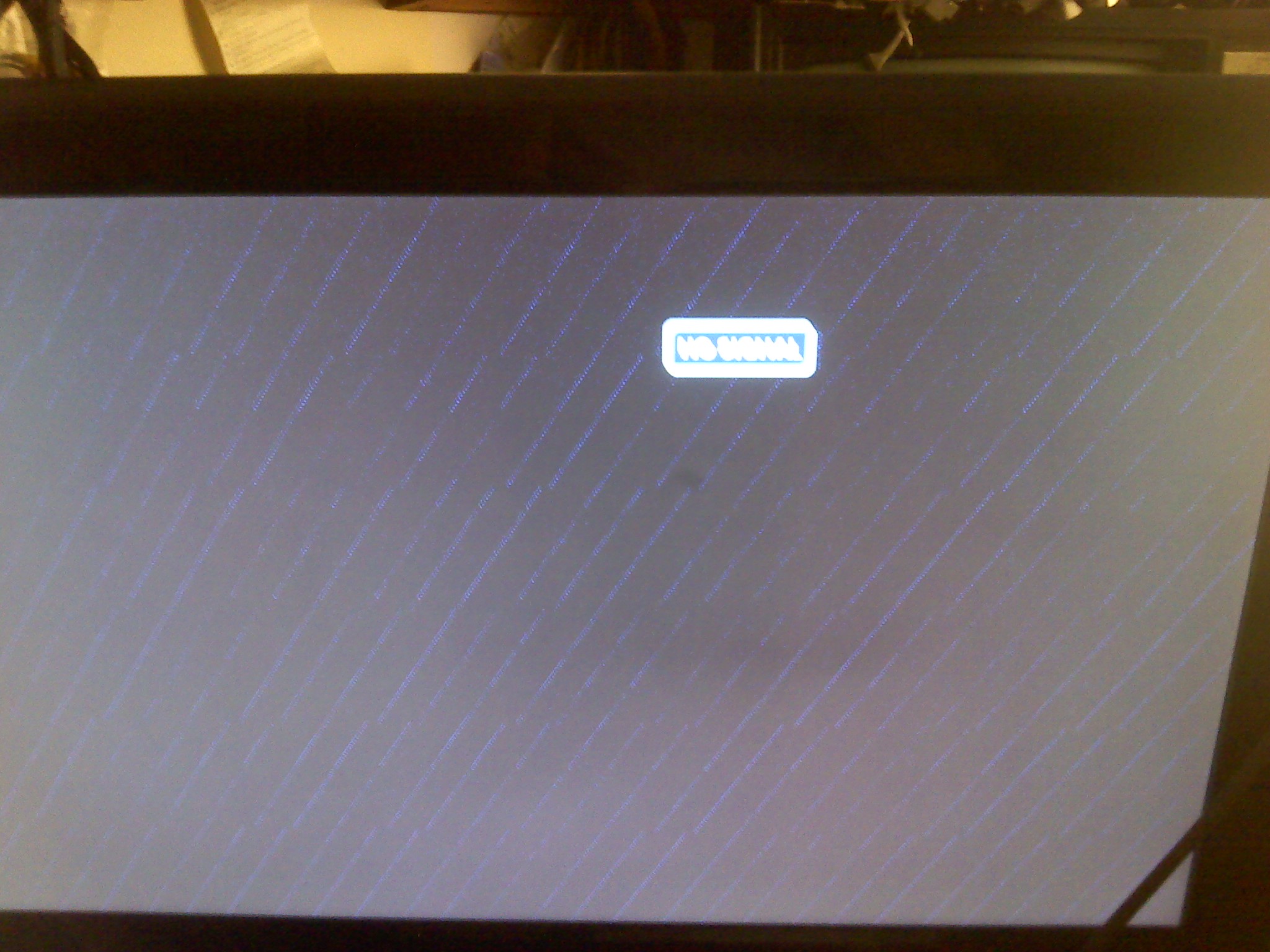

    Hello fellow enthusiasts. Should I try another T conn before I condemn the lcd panel. all voltages are good.

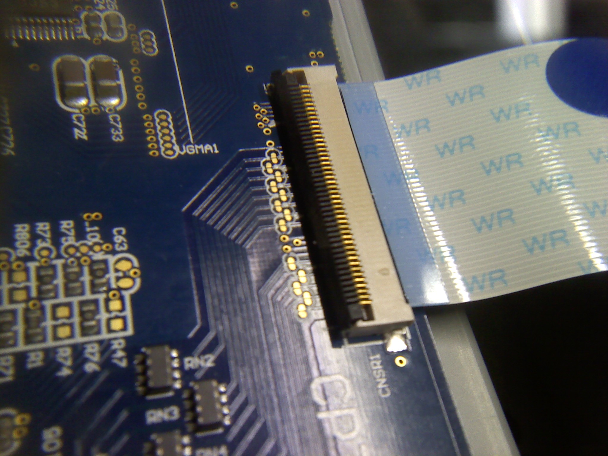

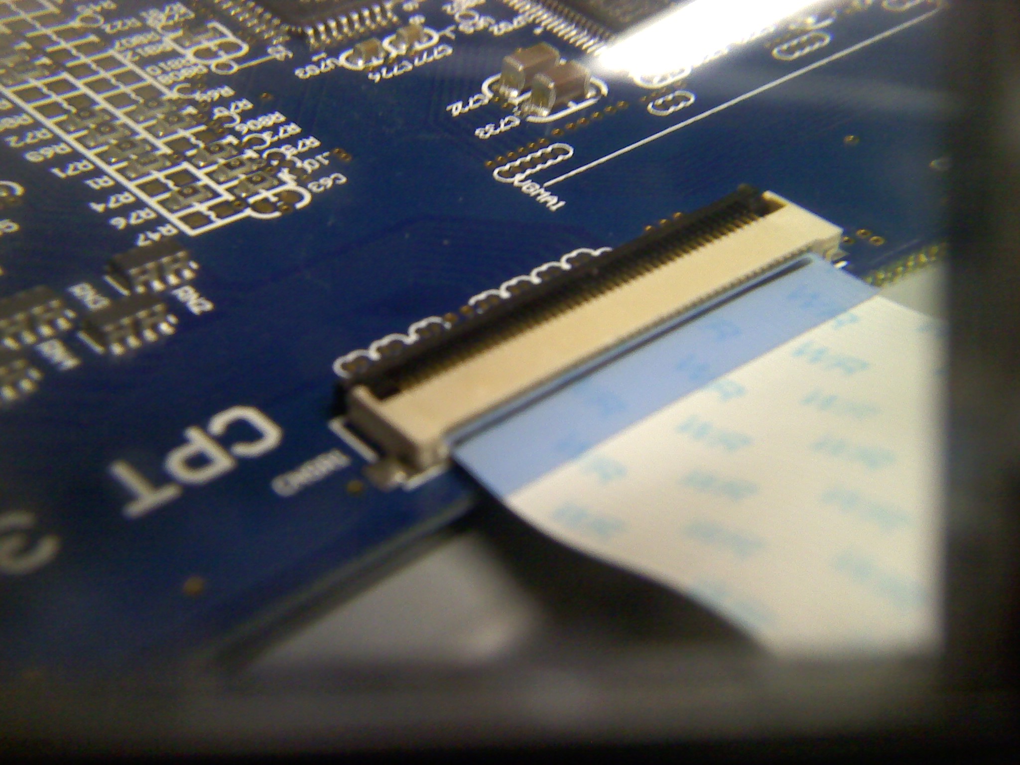

    If they are removable have you tried cleaning/resiting the ribbon cables between Tcon and panel
    • Tvbob
      tvbob
      • 204
      Re: Insigina ns-lcd32 bad panel???

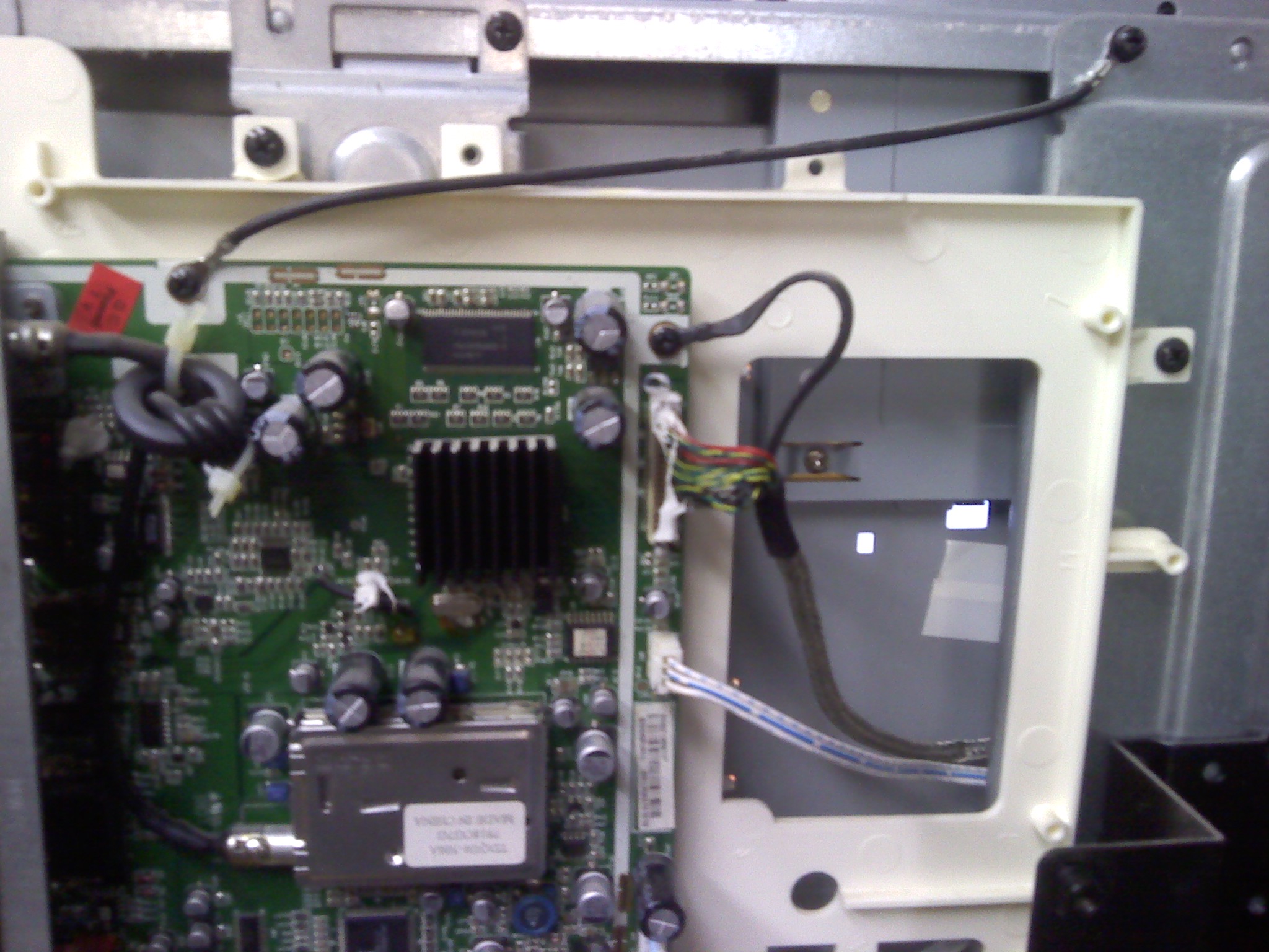

      Does the back of this connector flip up??
      • Tvbob
        tvbob
        • 204
        Its hard to see when you get old, I looked at my pix's after I uploaded and yes the back of the connector flips up. most people on here know that I am sure.
          Yes, I flips up.
            I cleaned both ends of the 4 ribbon cables no change. I don't have another chassis to plug into the t conn board at this time ( chunghwa claa320 ) my stuff is mostly ChiMei .
