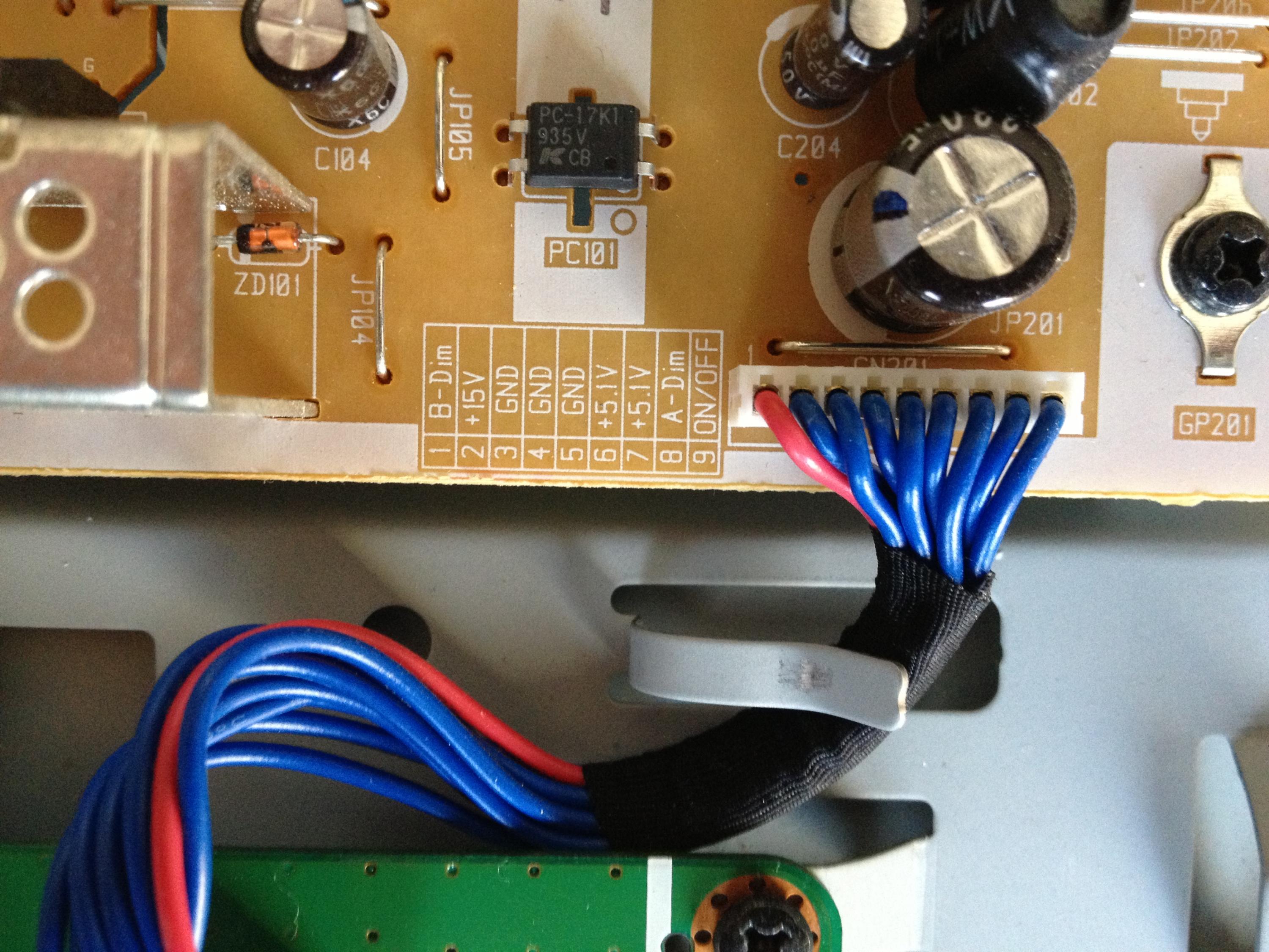

    Measured PSU output voltages:
    1 - 0v
    2 - 14v
    3-5 Grounds 0v
    6 - 5.12v
    7 - 5.12v
    8 - 0v
    9 - On/Off terminal had a steady 5v no change when pressing power button

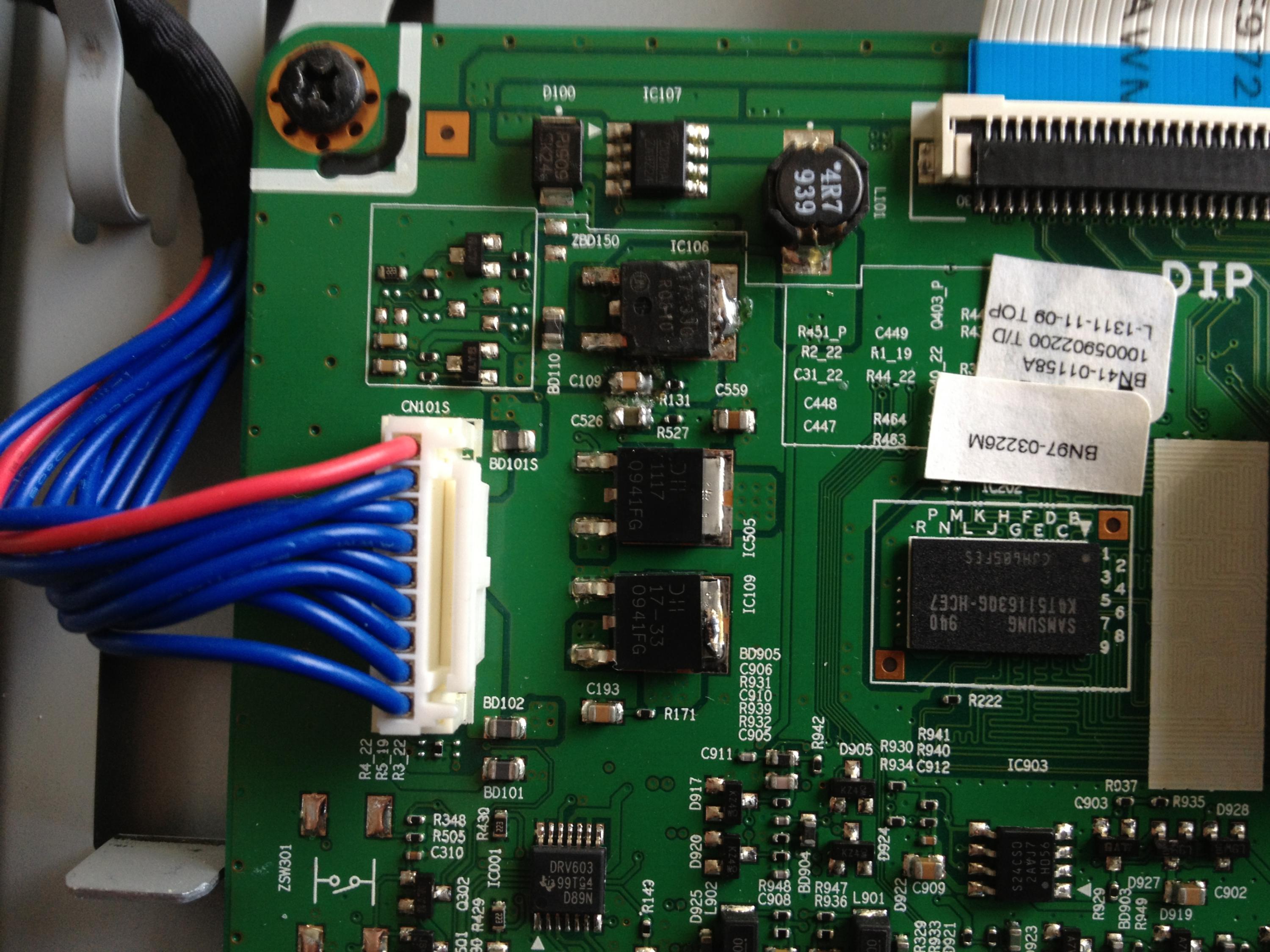

    Measured the output voltages of the 3 regulators on mainboard:
    IC109 - 5.1v In, 3.3v out, 0v ground
    IC505 - 4.95v In, 1.85 out, .60v ground (adjustable regulator)
    IC106 - This looked like it had been replaced and gave no output voltage:
    4.95v In, .06v out, 0v ground
    The part number for IC106 is a 17-33G the part number for IC109 is 17-33 which I believe was the original in place of IC106, also checked their specs and they're pretty much equivalent.
    I went ahead and ordered a 17-33 and will keep you guys posted when I replace it, I just had couple questions:
    1. Is the 14v measured where 15v should be related to the seemingly defective regulator?
    2. Would the no output of the suspected regulator cause the given problem, or would something else that's failed also cause the regulator to fail?
    2. There are smd on the main board labeled BD(numbers) what are these? They measure as short circuits when measuring ohms
    The 15V is likely unregulated. 14V might be correct when the backlights are on.
    BD is probably bead or ferrite bead (FB). See
    http://en.wikipedia.org/wiki/Electro...e_designations
    Thanks for any input, also I apologize for the blurry pics I was in a bit of a hurry, if you need clearer ones let me know.
    Remote troubleshooting is very difficult. The quality of the photos and the clarity of your problem description dictate, to some, whether to respond or hit close window.
    So yes, your photos could be clearer.

            Ok replaced the regulator, I now have 3.3v output from it but my symptom has changed to a blinking standby light.
            I re-measured input voltages to regulators and they now fluctuate from 4.40-4.65v. I back measured available voltages to the psu and only the 15v connector is also fluctuating but with the connector to main board unplugged the 15v measures a steady 17v. Any ideas?

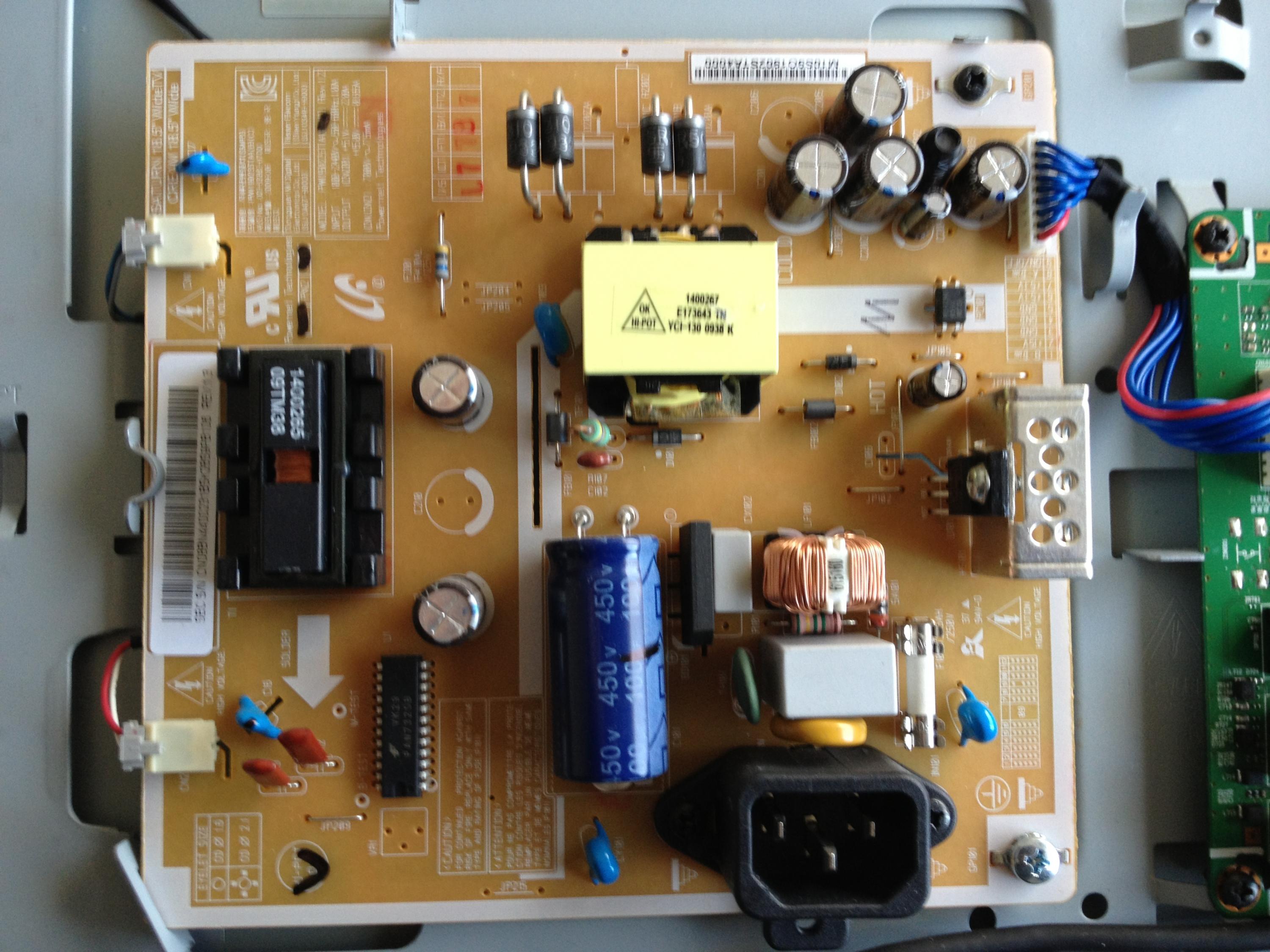

              Fluctuating voltages are never good. They should all be steady.
              I suggest measuring the large filter capacitor to make sure it is a steady DC voltage. Caution, it is high voltage. If you are in the USA, it should be around 165V DC. If PFC is involved, it might be close to 400V DC.
              Report your reading.

                It measures a fluctuation of 165-166v and with main board disconnected it measures fluctuation of 170-171v
                  Put a fresh battery in your multimeter and retest.
                  --- begin sig file ---
                  --- end sig file ---
                    Re: Samsung LN19B361C5D Backlight, No Picture/Sound
                    Those readings look fine to me -- it's quite normal for the capacitor to measure a little high under no load.
