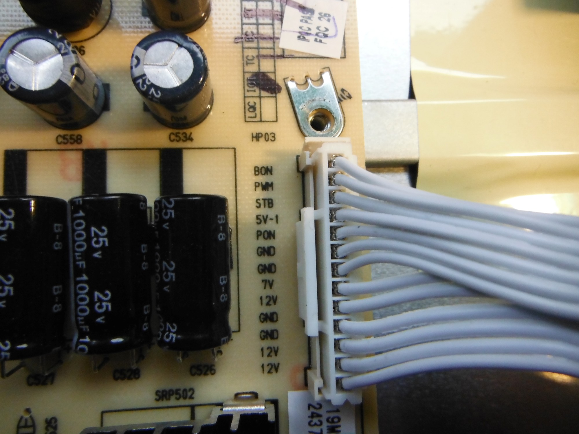

    HP03 Connector
    BON-0.0V
    PWM-0.1V
    STB-5.0V
    5V_1-5.0V
    PON-5.4V
    GND
    GND
    7V-8.6V
    12V-12.1V
    GND
    GND
    12V-12.1V
    12V-12.1V

    HP03 Connector
    BON-0.0V (this is the Backlights ON/OFF signal (from main board), >3V = Backlights ON)
    PWM-0.1V (Backlights Dimming control, from main board)
    STB-5.0V
    5V_1-5.0V
    PON-5.4V
    GND
    GND
    7V-8.6V
    12V-12.1V
    GND
    GND
    12V-12.1V
    12V-12.1V

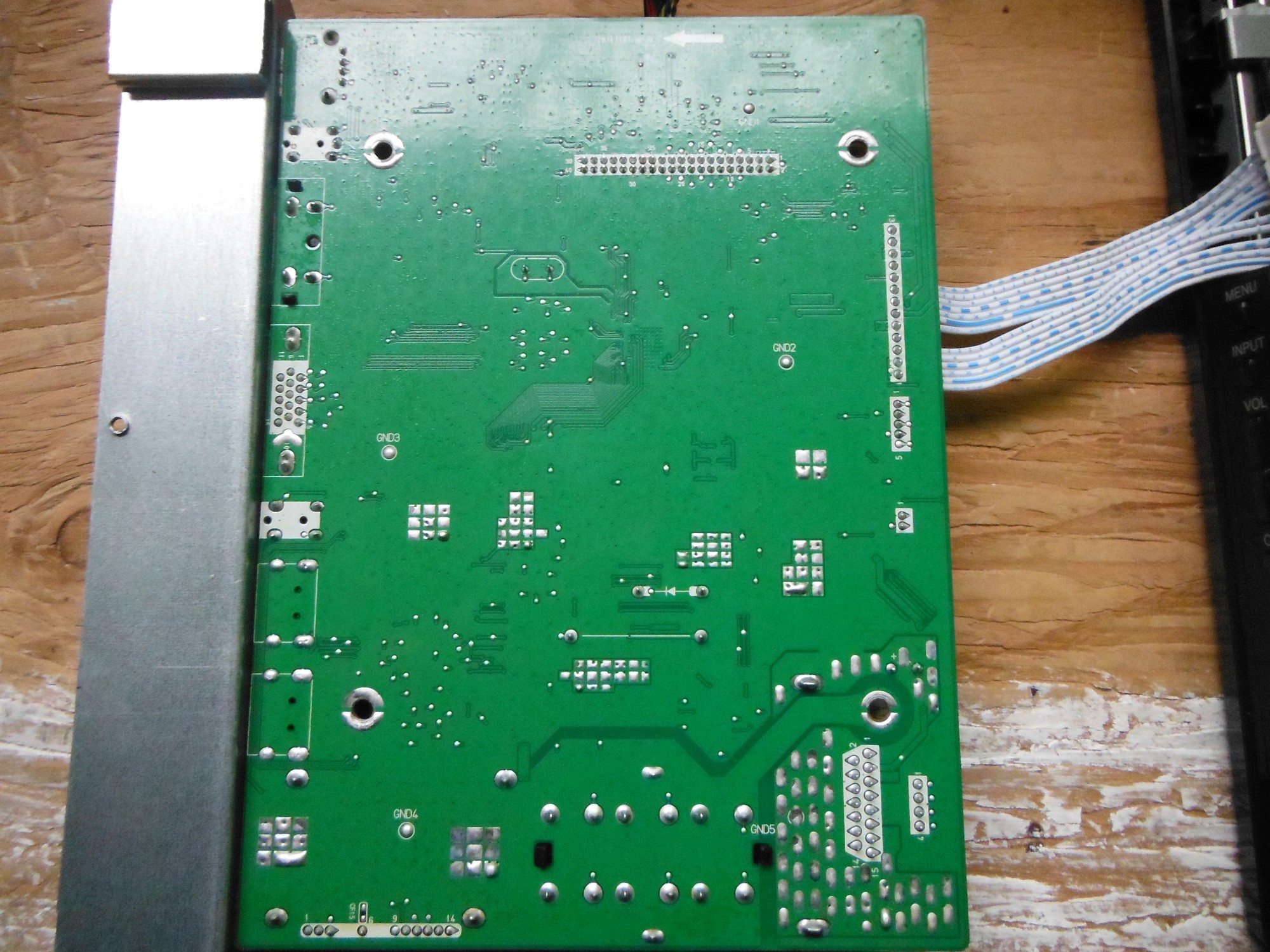

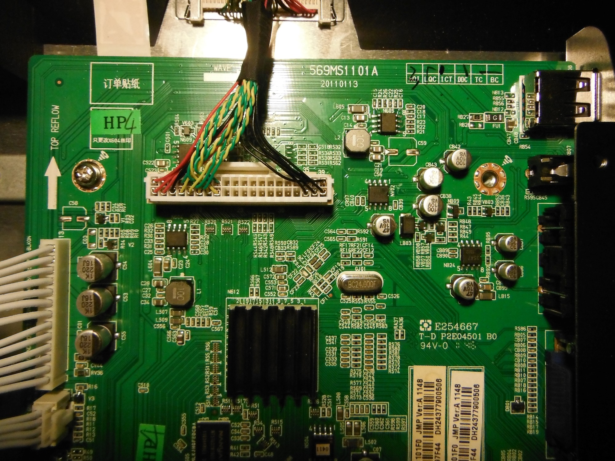

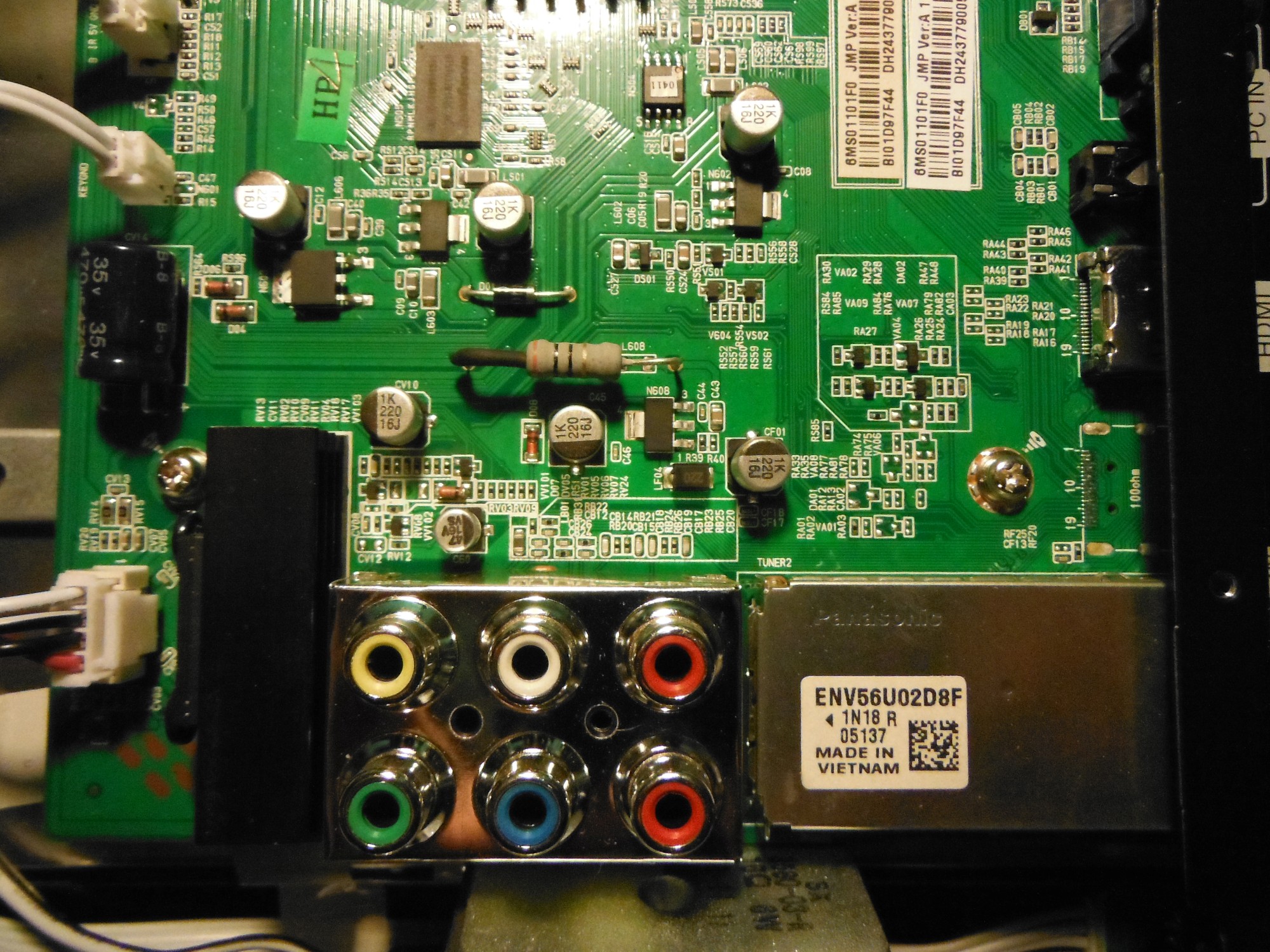

    So it looks like your main board is not working.
    We will need good clear of the WHOLE main board, the pictures looks like it get cut out. I can see some LDO regulators that need to be checked out.

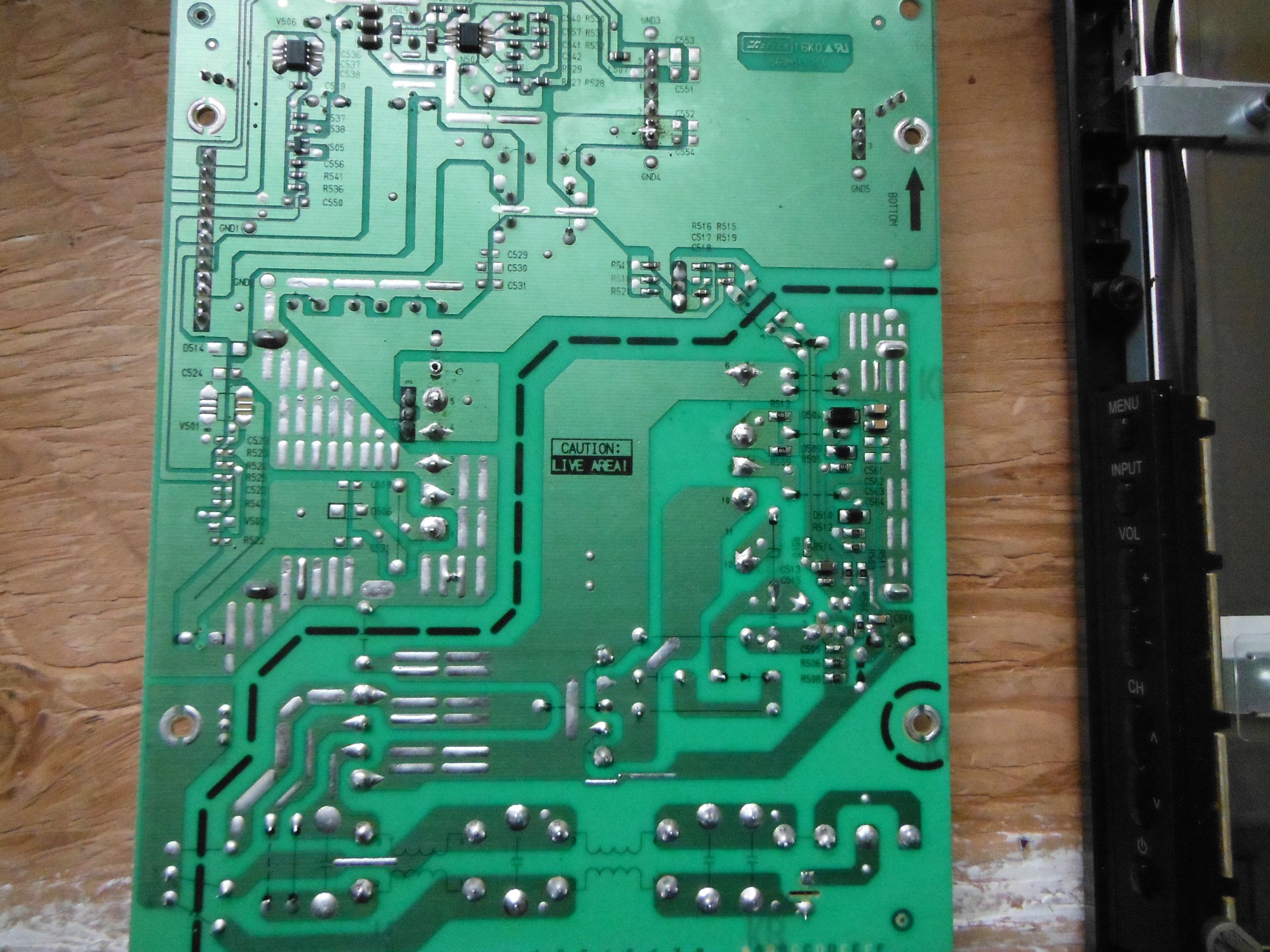

      I can confirm I am testing the cap at it's leg's. Seems to be low as sometimes when I have measured it it has only been around 96v. I am not good at taking pictures but will post these for now and hope to get some better ones with daylight tomorrow.

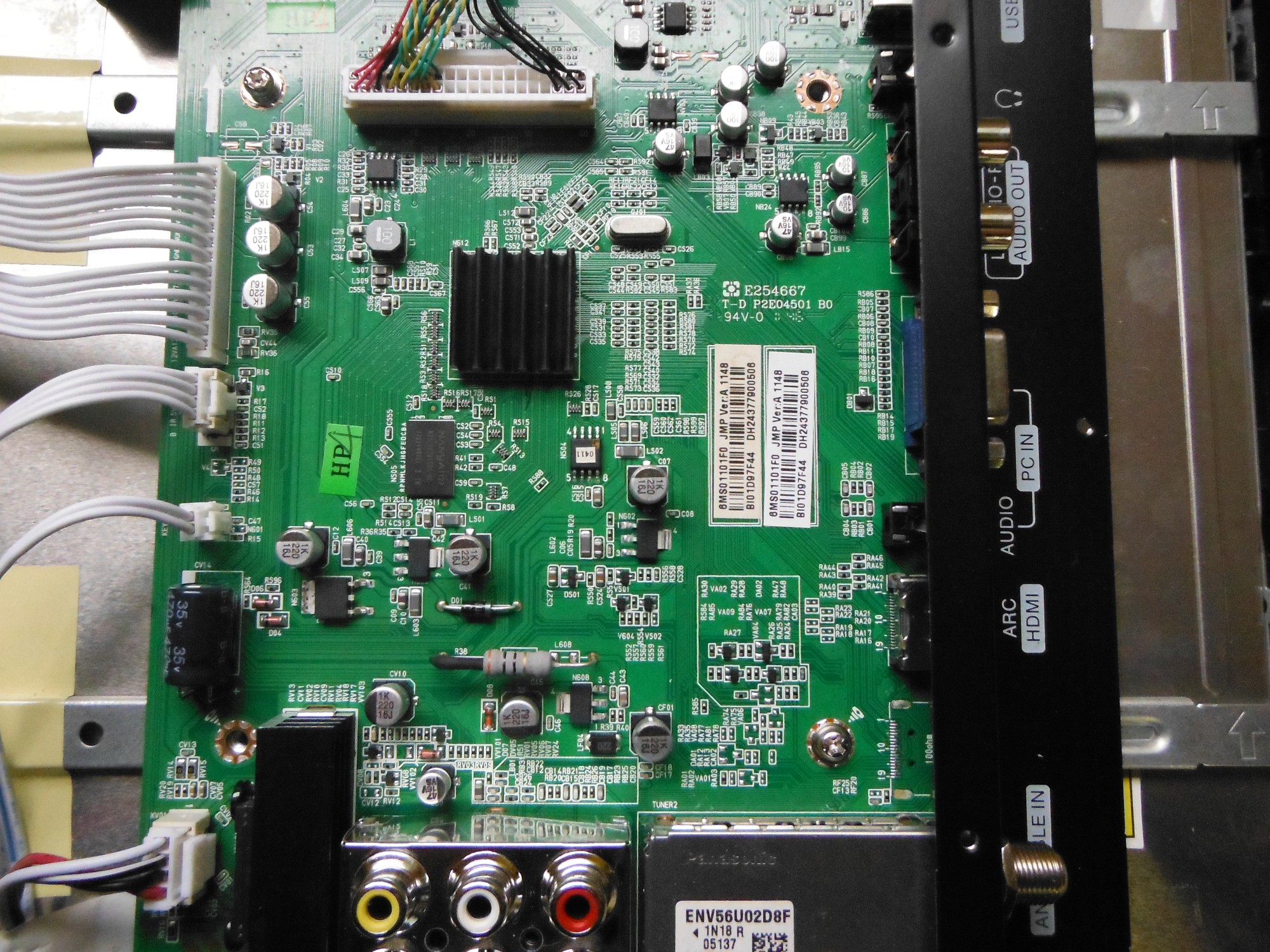

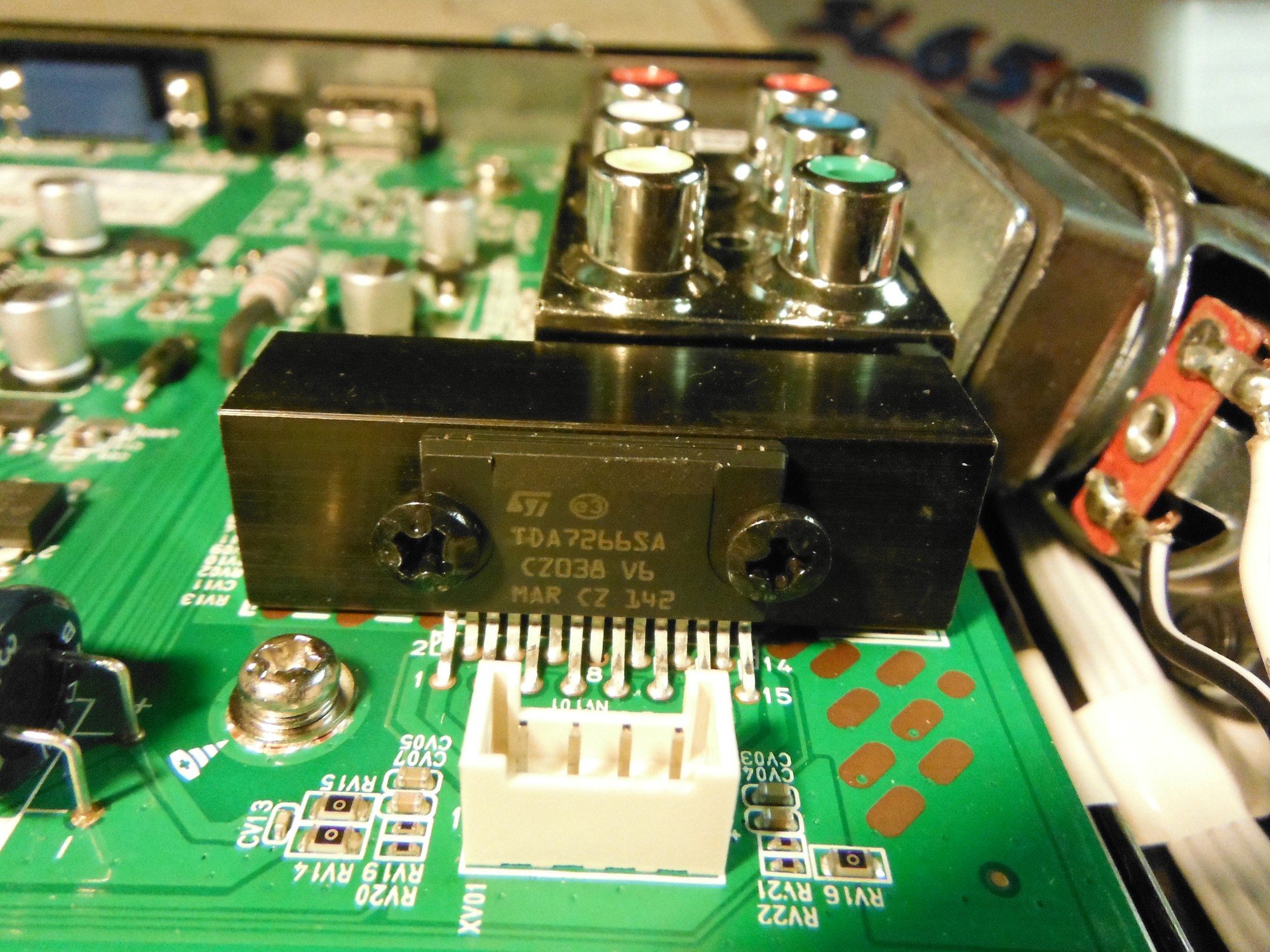

        Also here is the chip that is attached to the heat sink in the bottom left corner of the board.
          Re: Dynex Dx-19E220A12 No standby led/wont power on
          That the stereo power amplifiers that drive the speaker.

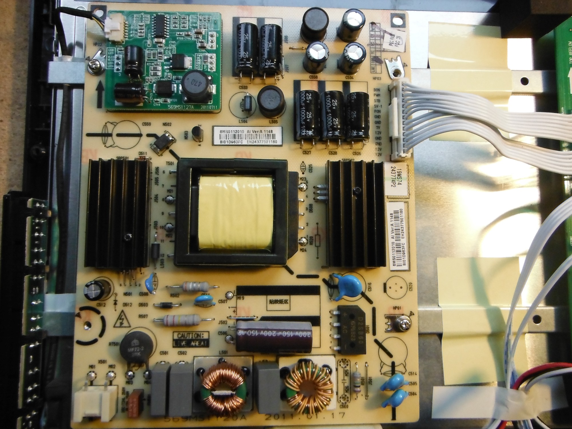

          I think we need to find out why you are not getting 160~170VDC on that large cap. Does that cap look like it has any corrosion on the holes where the legs exit? Do you have at least cap meter. Also I hoe your meter is OK.
          This TV uses LED backlights so it does not draw that much power to cause the voltage on that cap to drop down to 96V.

            My meter seems to be fine as is gives me correct voltages for many other things, haven't tested on dc that high tho. I do not have a cap meter yet but plan on getting one in a few weeks. Doesn't seem to be any corrosion near that cap but did touch it up anyways.
            Also there is a little board on the top left of the power supply board, would I be correct at saying this is the inverter board?

                      Just a quick update, I ended up changing the cap @C506 with closest I could find that I had lying around( 100uf 250v instead of 150uf 200v) and now get 149v at the cap and bridge rectifier.I also get the same voltage in both polarity's now.
                      Can anyone recommend a replacement cap from digikey.ca to replace the 150uf 200v?
