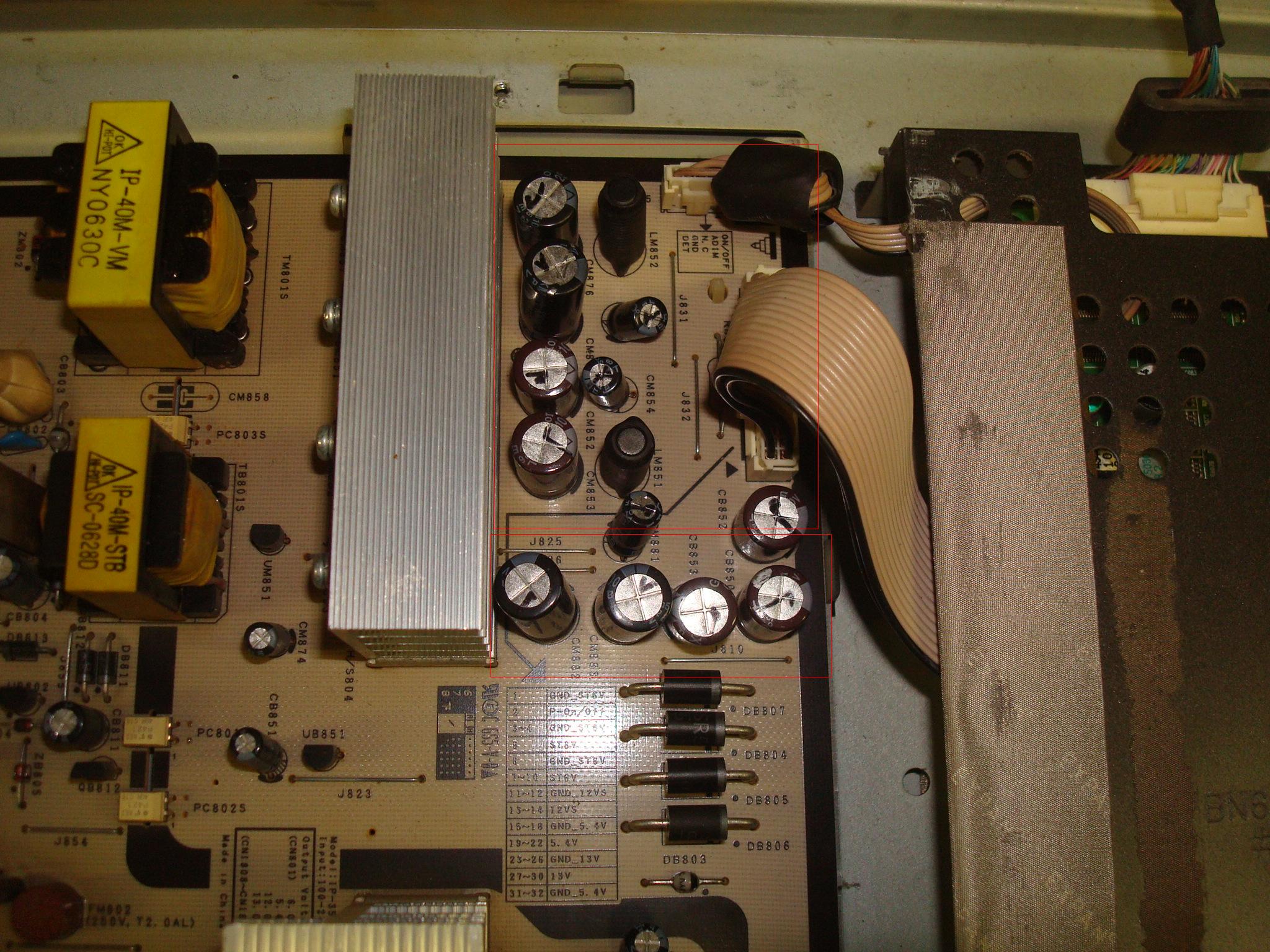

samsung LNS4695DX TV Has blinking power light - No Picture
  • TubeJunkie
    replied
    Re: samsung LNS4695DX TV Has blinking power light - No Picture
    No screen glow at all. I took out all caps (see 1st pic) on power supply board and tested each one out of circuit. None looked bulged, or leaky, but most of the 1000uf 10v caps were at the top 20% of value. Most of these caps drifted down while testing. I ordered these caps last night.
    I pluuged in again, after installing the power board, and there is a beeping noise coming from the middle area of this board. Also noticed a blinking green light on the input/tuner board (see pic). Which is labled OP182. Anyone have advise? All help is greatly appreciated. Thanks.
    Addition: Also noticed SA801 (looks a lamp/bulb) on power board, is not working. Should this light up?
    Last edited by TubeJunkie; 11-27-2012, 12:02 PM. Reason: Added info
    Leave a comment:
    replied
    Re: samsung LNS4695DX TV Has blinking power light - No Picture
    Look at the front and back of the screen in a dark room to see if you notice any glow from the screen.
    Leave a comment:
    replied
    Re: samsung LNS4695DX TV Has blinking power light - No Picture
    I assume since it's a Samsung, you've ruled out bad caps?
    Leave a comment:
  • samsung LNS4695DX TV Has blinking power light - No Picture
    Hello All.
    My Samsung LNS4696DX LCD TV, has no picture or sound. When I push the power button to turn it on, the blue power light blinks. Any common problems with these symptoms? I have the power supply board out, looking for cracked solder joints, and anything out of the norm. Any advise, and all help is greatly appreciated. Thanks,
    TubeJunkie
  • matty24
    Samsung UE50MU6172 - red light blinking
    by matty24
    Hello. I have problem with Samsung UE50MU6172.
    TV won't turn on, red standby light is blinking.
    Power supply BN44-00807A is fine. I replaced it with the new one.​
    Main board BN41-02568B (BN94-12530E)
    I've read a dump (W25Q40CL). Can someone check it od fix it for me?...
    03-02-2025, 08:57 AM
  • kca
    Samsung UN60F8000BFXZA ~ No Picture or Sound - 5 Res Light Blinks
    by kca
    Hello all ~
    I’m working on this Samsung 60” LED and purchased a new main board a couple of days ago that did not fix the 5 blink issue. The original main board’s HDMI ports (all 4 of them) failed to work and no amount of reflow remedied that.
    This 5 red light blink code on the front panel LED is followed (about 15-20 seconds afterward) by an automatic reboot, and results in 5 more red light blinks. Then the entire cycle repeats itself indefinitely.
    No picture. No sound.
    I tested all the voltages coming out of the power supply...
    10-12-2023, 05:23 PM
  • Fergal22
    Samsung UE40F5300AK blinking red light
    by Fergal22
    I have the above tv that just shows a red light blinking twice 5 times, i have taken the back off and all the capacitors seem ok,
    When i disconnect the mainboard from the PSU all the led's light up blinking fast but as soon as i reconnect the mainboard back to the power supply i get the red light blinking again twice 5 times,
    I have attached pictures of the Mainboard, PSU and a small video (zipped) showing what happens when i disconnect the lead from the psu
    Any help would be appreciated...
    02-02-2023, 09:19 AM
  • norbiszoke
    Samsung 50AU7172, only blinking red light
    by norbiszoke
    We have this set here in our shop that is not ginving sign of life besides red light that is blinking one time after pressing the button and nothing more... After detaching the mainboard from the PSU (this set has separate board thank god?! or not...) the backlight comes on. After reattaching nothing besides red light.... Can anyone from the forum help me here? Thank you in advance. Here's a link with images of the mainboard and the memory IC's that are on it.
    Regards, Norbert!...
    04-17-2024, 06:54 AM
    09-07-2024, 05:50 AM
