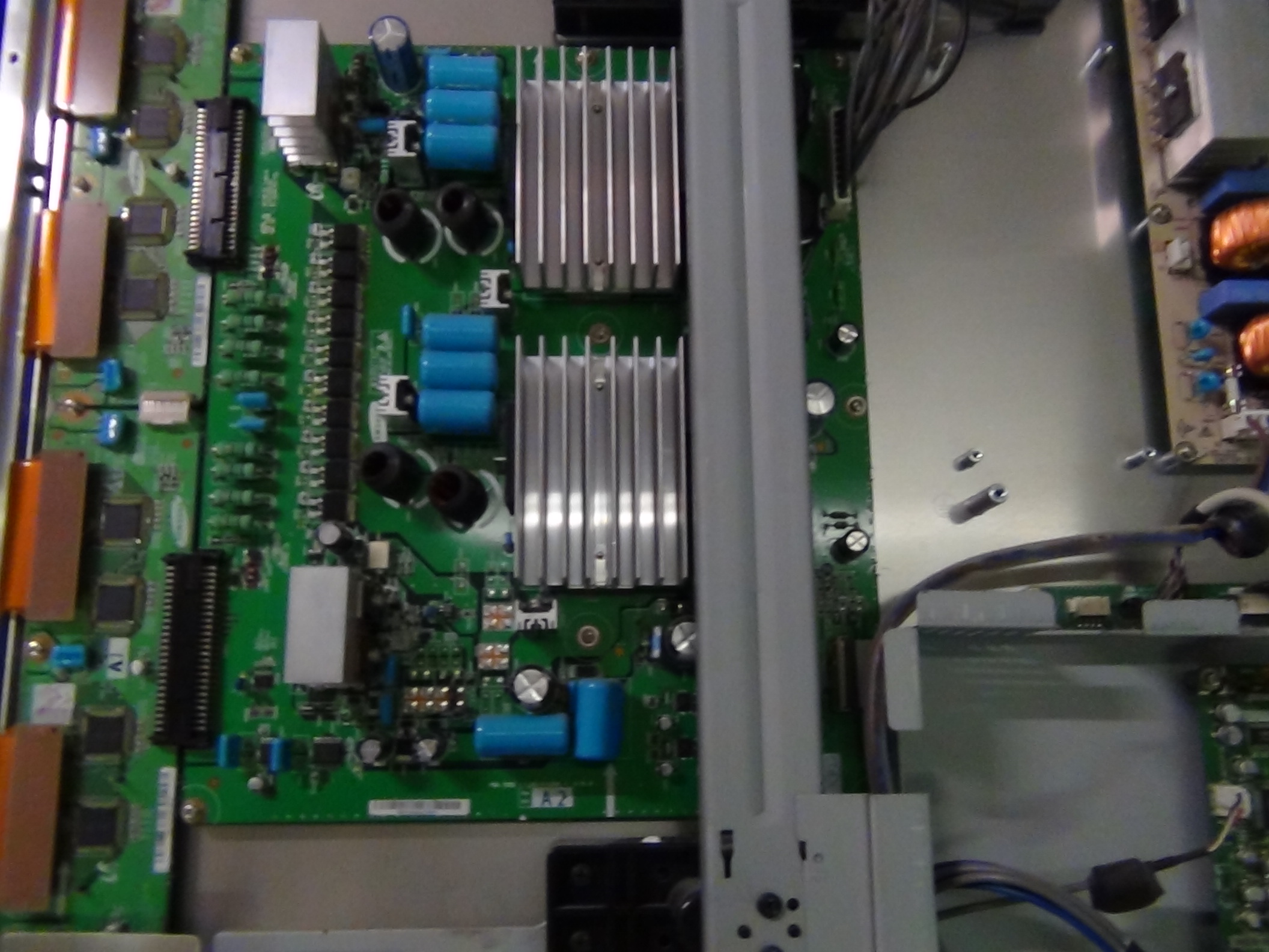

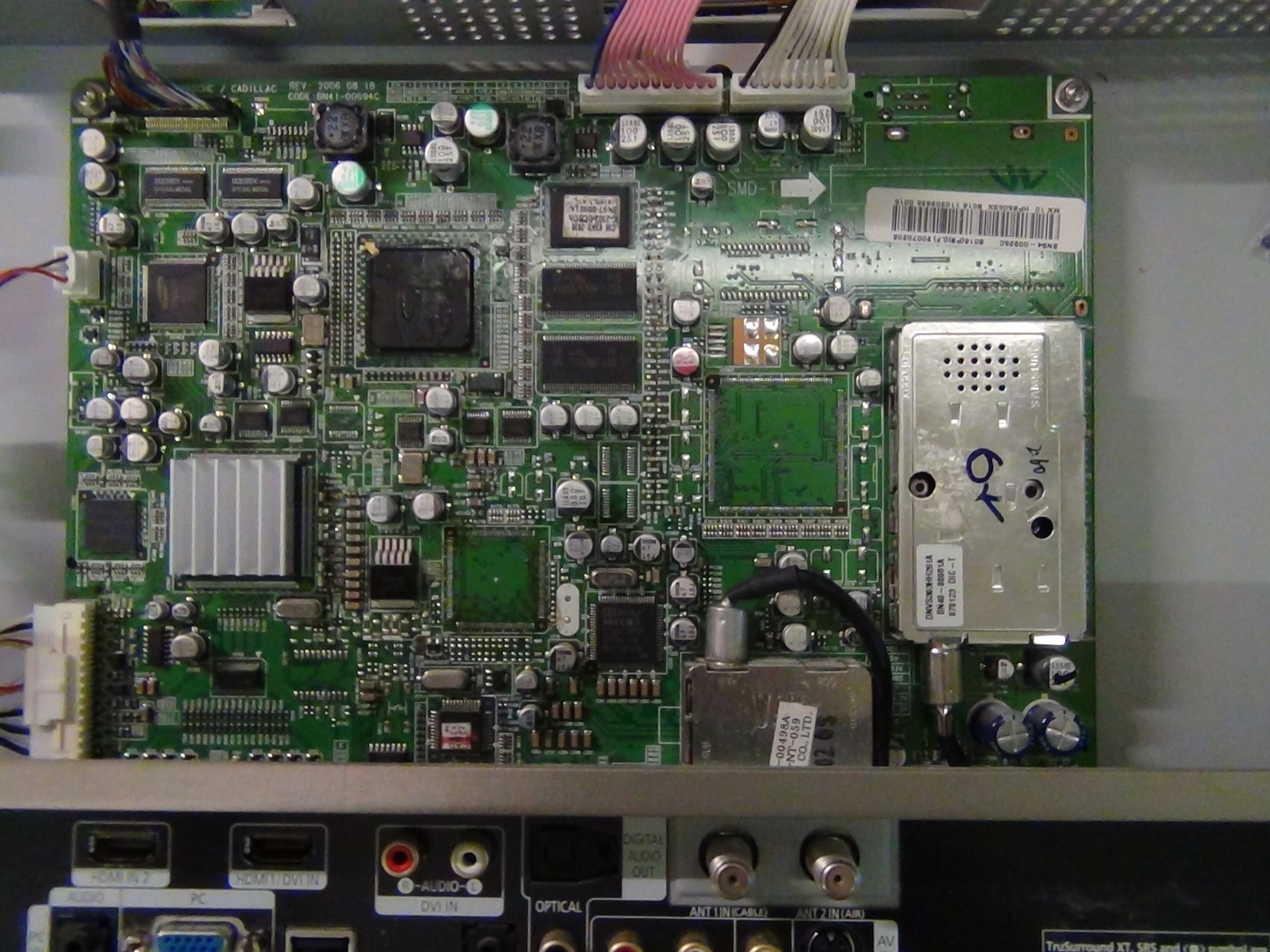

    We have a TV in the shop with no video just audio. We tested it with a 360 console.
    A part timer found zener diodes that were burnt but doesnt know the value. He said i need the service manual to find out, but i can not locate it.
    Would the zener diodes be responsible for loss of picture? I flowed the BGA chip before we found the zeners

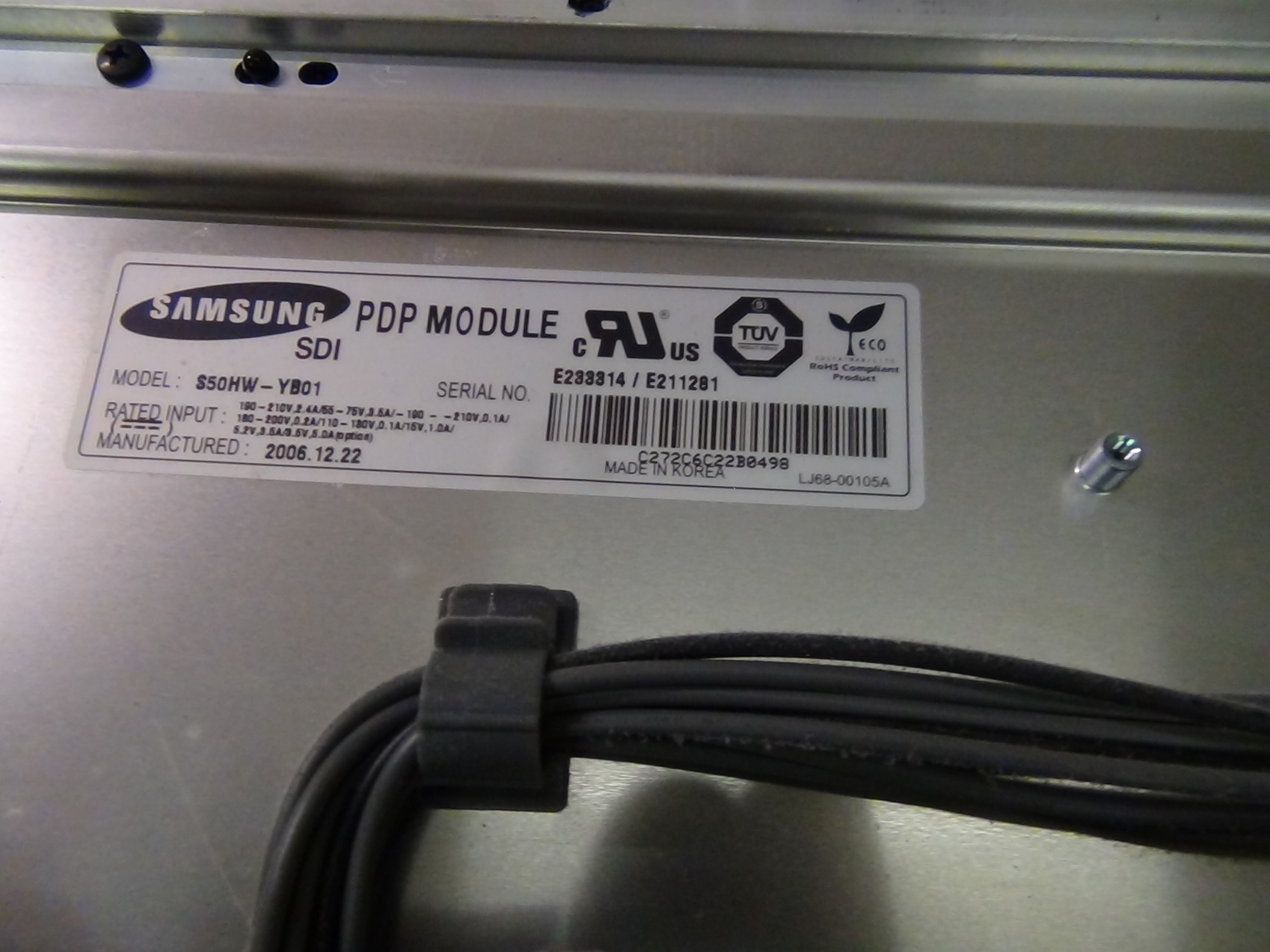

    S50HW doesn't sound like a model number to me; what is the model number of this set? If plasma, it will be PSxxxxxx or PNxxxxxxx, if LCD it will be LExxxxxx or LNxxxxxx
      Re: LCD Samsung TV S50HW Zener Diodes Issue
      I'm thinking Plasma Panel S50HW YD02 or others and also the common blown YSUS & Buffer board. Sound,no picture.
      Pictures and full panel or model numbers would help.
      What BGA are we talking about? What board are the zeners on?
        S50HW YD01, is the model
        PS BN64 00464A
        If pics are needed i can provide those too

          I'm more familiar with the YD02, that's the one I've repaired a few ysus and replaced upper buffers on.
          I have worked on one YD01 which supposedly would lose picture but have sound. I could'nt get it to fault so reflowed some ysus joints and still going?

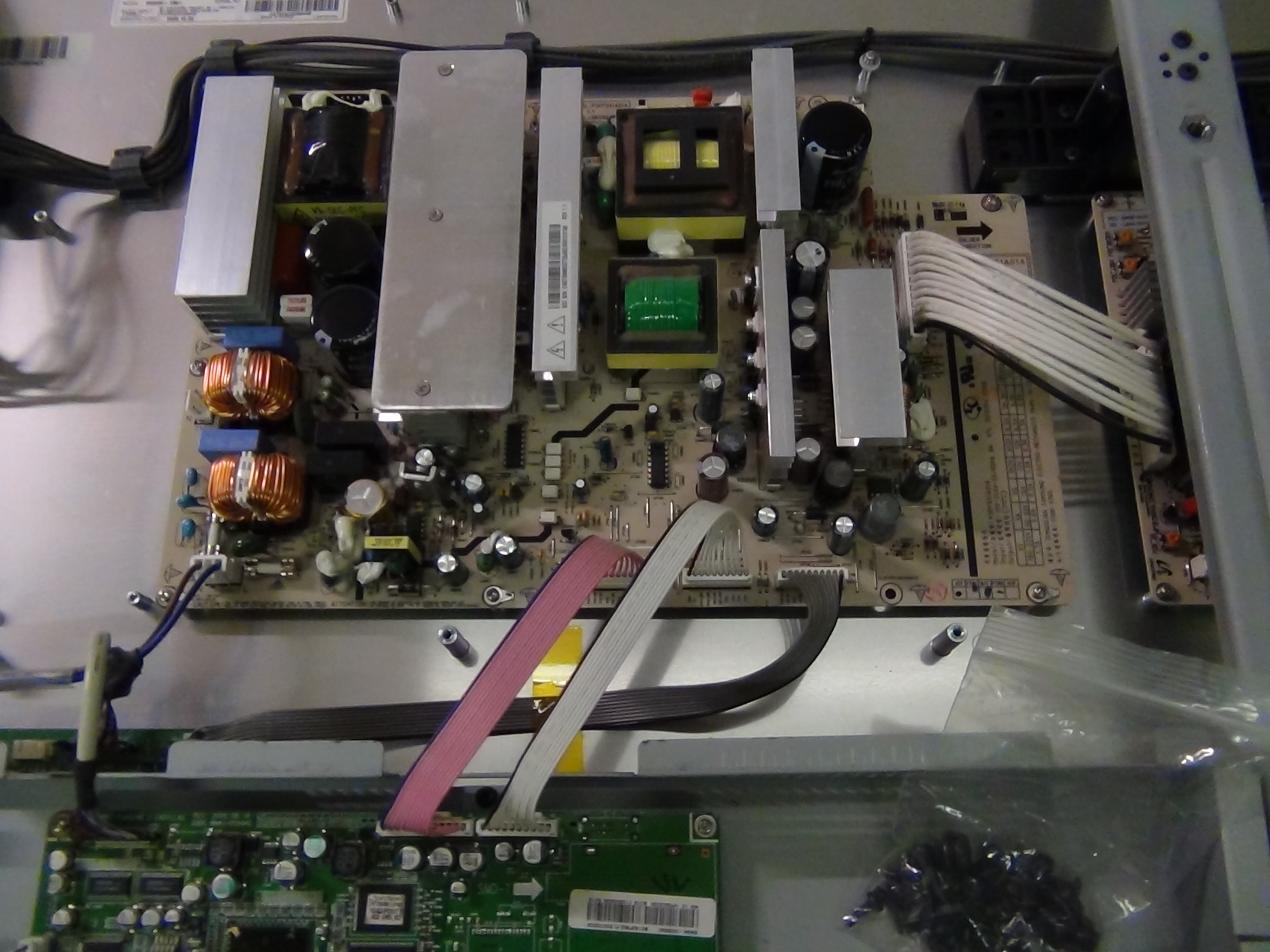

          If the sustain boards are'nt getting power you'll have no picture but that does not automatically mean it's a bad PSU. If it does not get the signal to turn the panel on you'll see no VSus voltage and that can be related to shorted buffer boards, blown ysus or xsus boards.

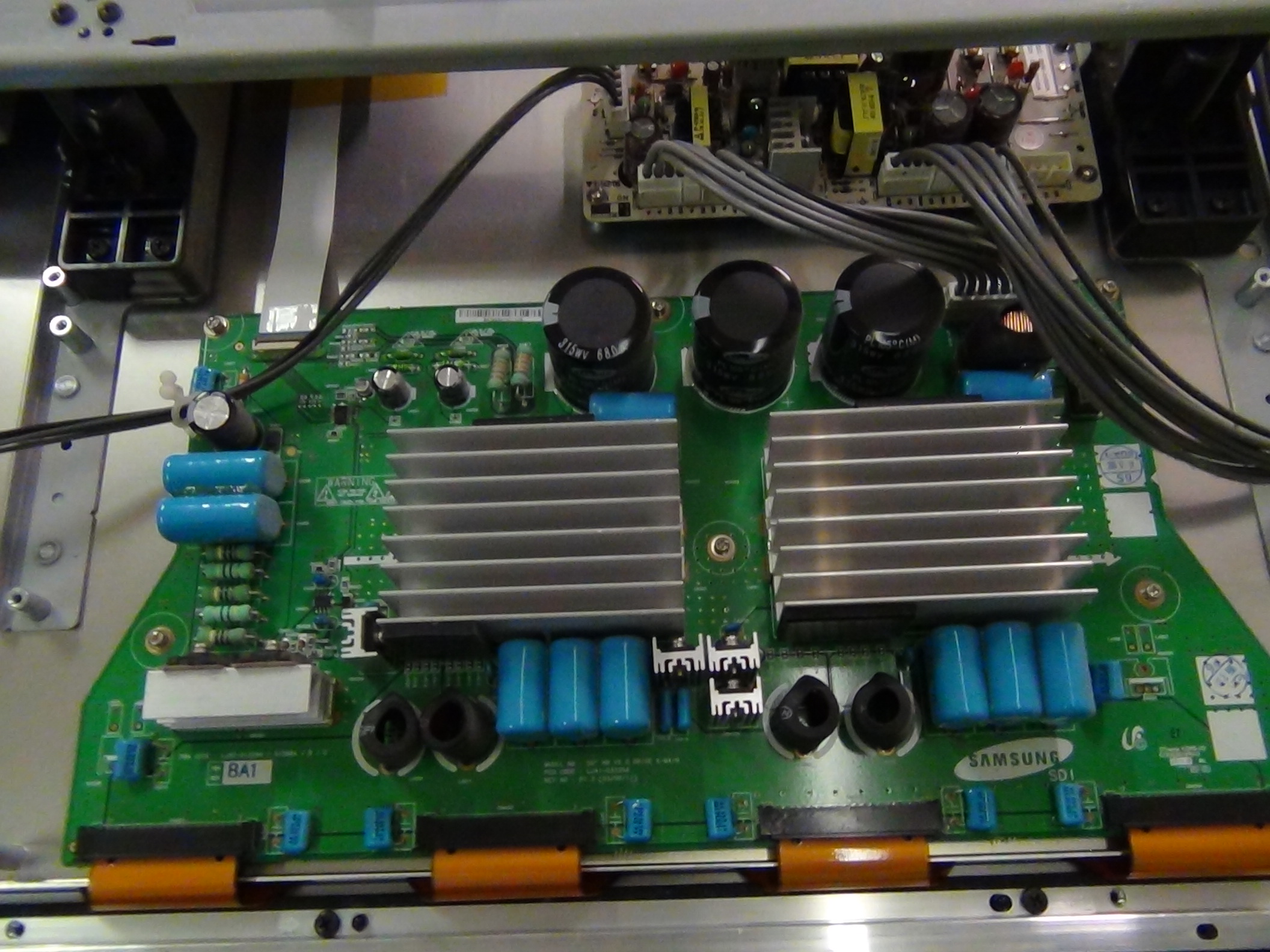

            Is there any way i can find out which zener diodes i need to order
            There may be other issues, but the zeners are obviously faulty
              zeners are in the 3rd pic
                Very toasty. If someone else has the same TV and gets you the colour code. Maybe.
                http://www.shopjimmy.com/samsung-bn9...main-board.htm
                So it's a bad Ysus(ymain) and most likely buffer boards bad as well. The upper is the hard one to find. I actually used these same buffers to sub for the YD02 model I was fixing which had shorted upper and shorted ysus but different ysus design.
                Hopefully the main board is not cooked now with the BGA reflow.
                I don't know if yours is a PS50Q7 but it has similar parts.
                  So the ymain board is the fault and that is because of the zeners blown? If the zeners were replaced then the board would work or are there other faults?
                  How would i determine if the buffer boards are bad? The main board is not cooked since i did a PB flow and not a PB free flow. Since i wasnt sure if the BGA was the cause i did it that way so as not to create additional problems if the BGA wasnt the issue and apparently it is not the issue from the above posts.

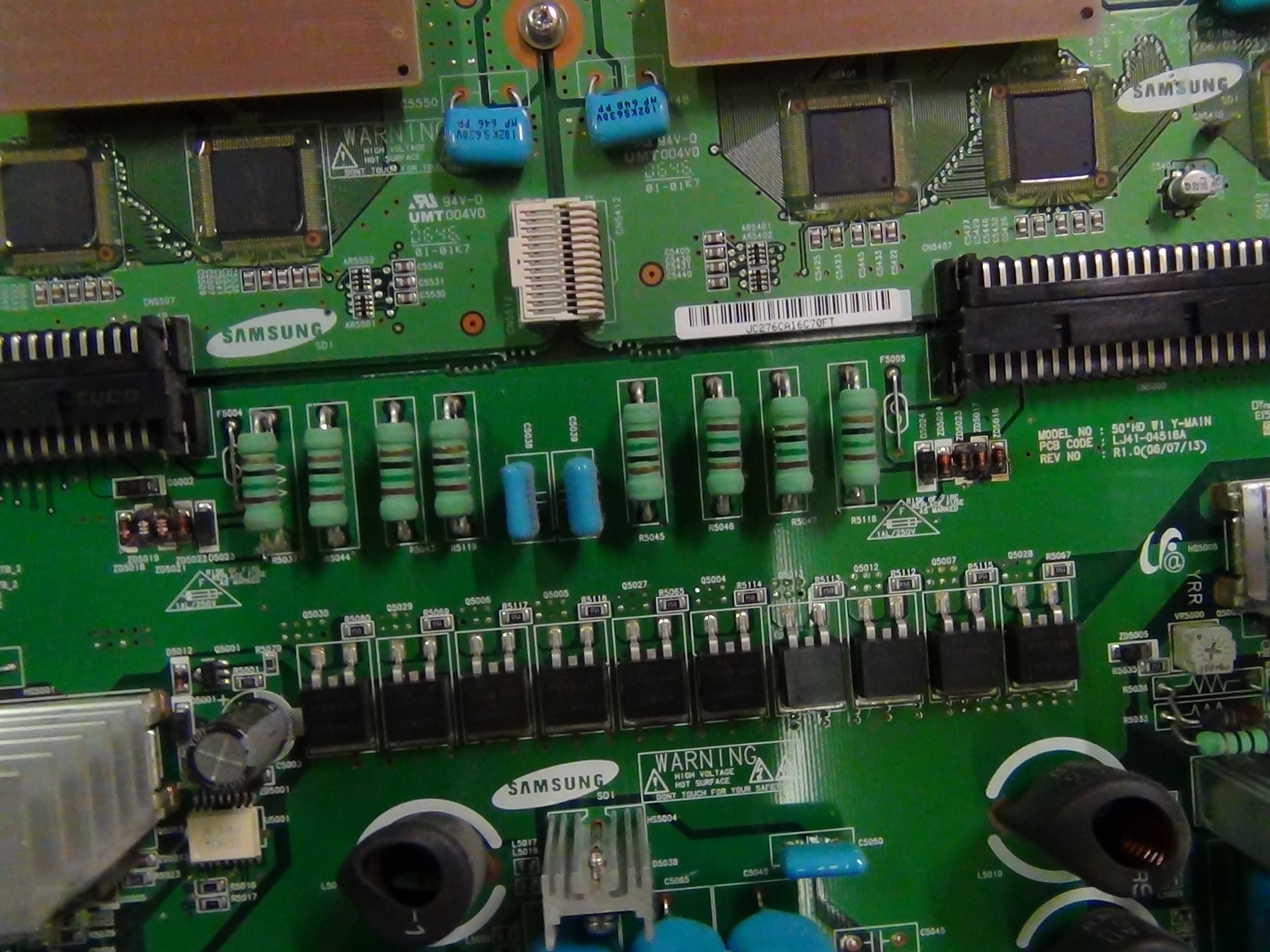

                      Good job tw2005!
                      Damn, those are very fried zeners!
                      Make sure when you replace them, that you are sure there is no carbon underneath them, which will conduct electricity.

                            Those 8 glass zener diodes are 30v. Just replaced some on a board. Not too.sure.as.to why they blow. Seen this a few times on dell, samsung and others using this panel.
