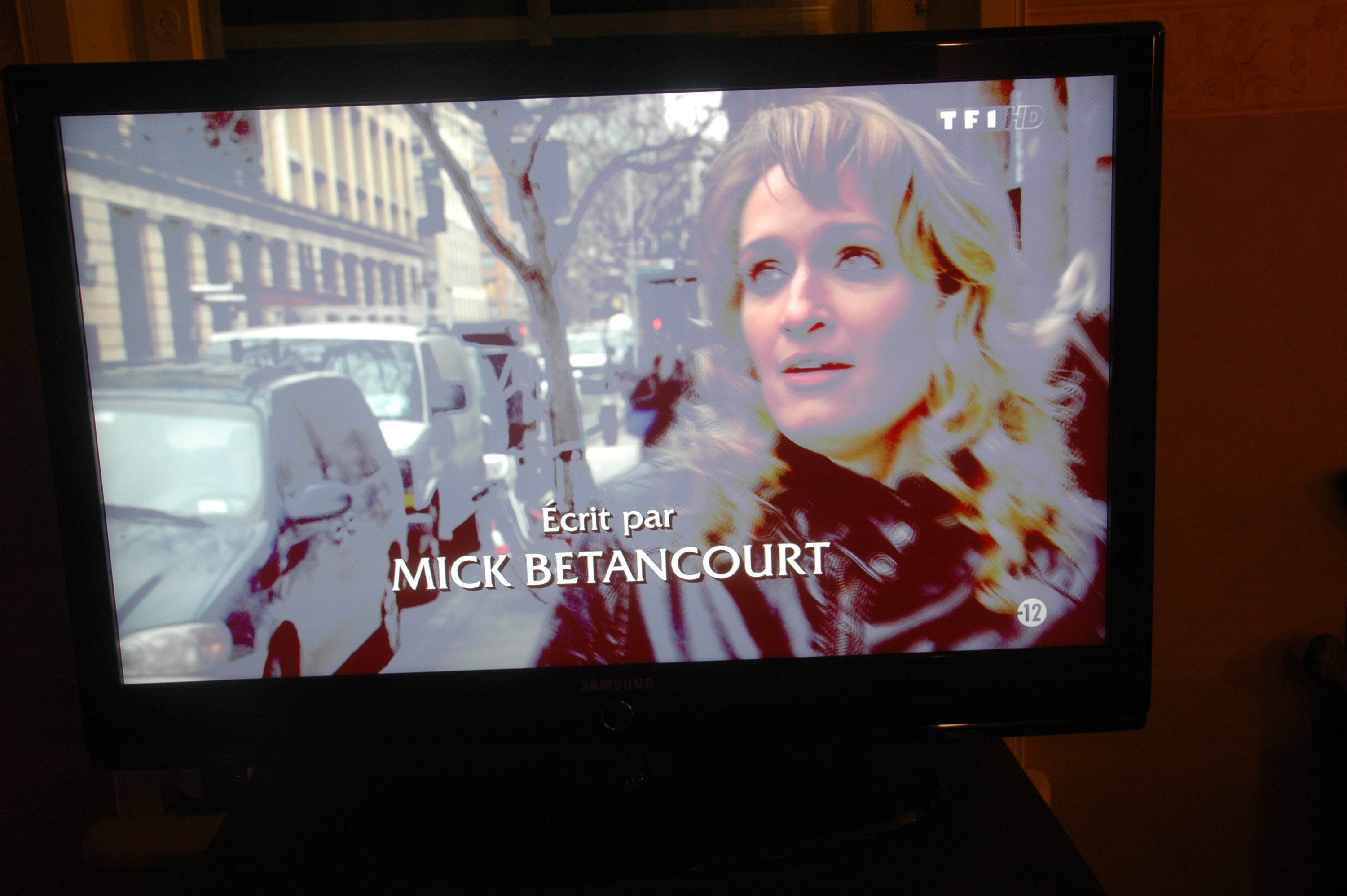

    When switching it on cold there's no problems at all with it, all works perfectly fine and the picture is excellent. (Well, at least as good as it gets on an old LCD like this one - but to me it looks great.) So far so good.
    (One problem it does _not_ have is the on-off-on-off-on-off-on-off phenomenon that I have read happens quite often with Samsungs... (Knocking on wood.))
    Ok, moving along with the error description now.
    -After about 10 minutes-
    The darker parts of the image start to get "strange", and strange in this context means; the color fades a bit to slightly green-ish and the other colors start to get gently washed out.
    -After about 20 minutes-
    More of the above.
    -After about 30 minutes-
    Even more of the above, but not so much if the "green" anymore in the dark parts, just worse colors.
    -After about 1 hour-
    By now it starts to get really annoying to watch the image. The dark parts of the image are really distorted and the other parts of the image are seriously washed out.
    ...And here's a strange part that perhaps might be a good lead to what the problem might be; (?)
    All the black parts are (more or less) fine and the on-screen menus are good. It does not matter if I use the HDMI1 or an RCA input, all the image sources are showing the same symptoms.

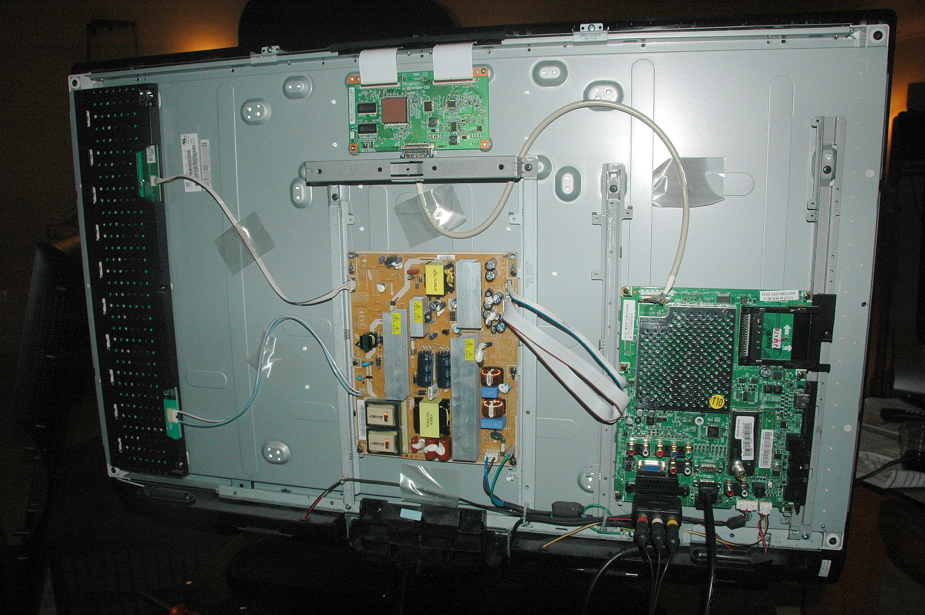

    Opened up the poor thing and had a look if there would be anything "obvious" problem that would catch my eye. Nothing. All caps _look_ ok, meaning none exploded , no bulging at all, no leaks, all FET:s and diodes look good, etc...
    Well, being the curious person that I am, I thought that I would try an old little trick. I let the beast heat up to "maximum bad picture" and then I opened up a can of "Kälte 75" cooling spray. I started quite gently spraying caps, cooling fins, IC:s, individual components and then the PCB:s in general. All with due pause between components and constantly checking if there would be any change in the image.
    ...But there was no change.
    If I switch the beast off for a while to let it cool the picture is -again- perfect for a while but as it heats up it starts getting worse again. (Well, I guess it's heat-related...?)

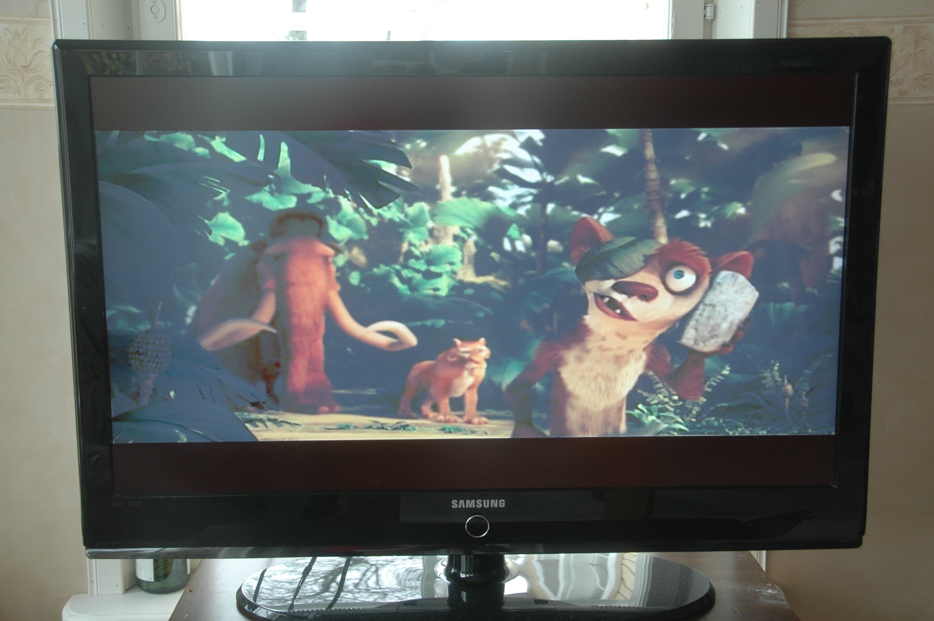

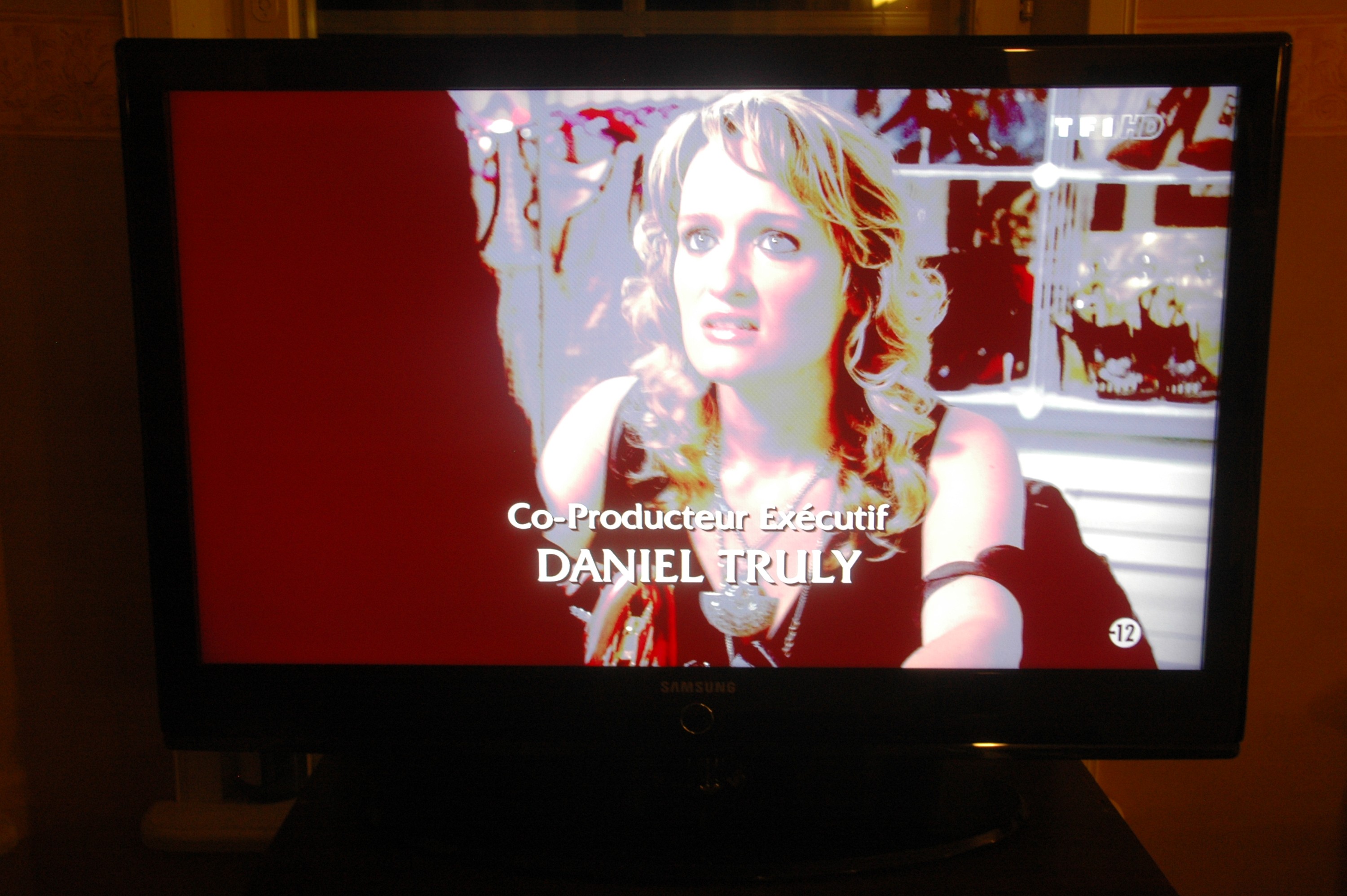

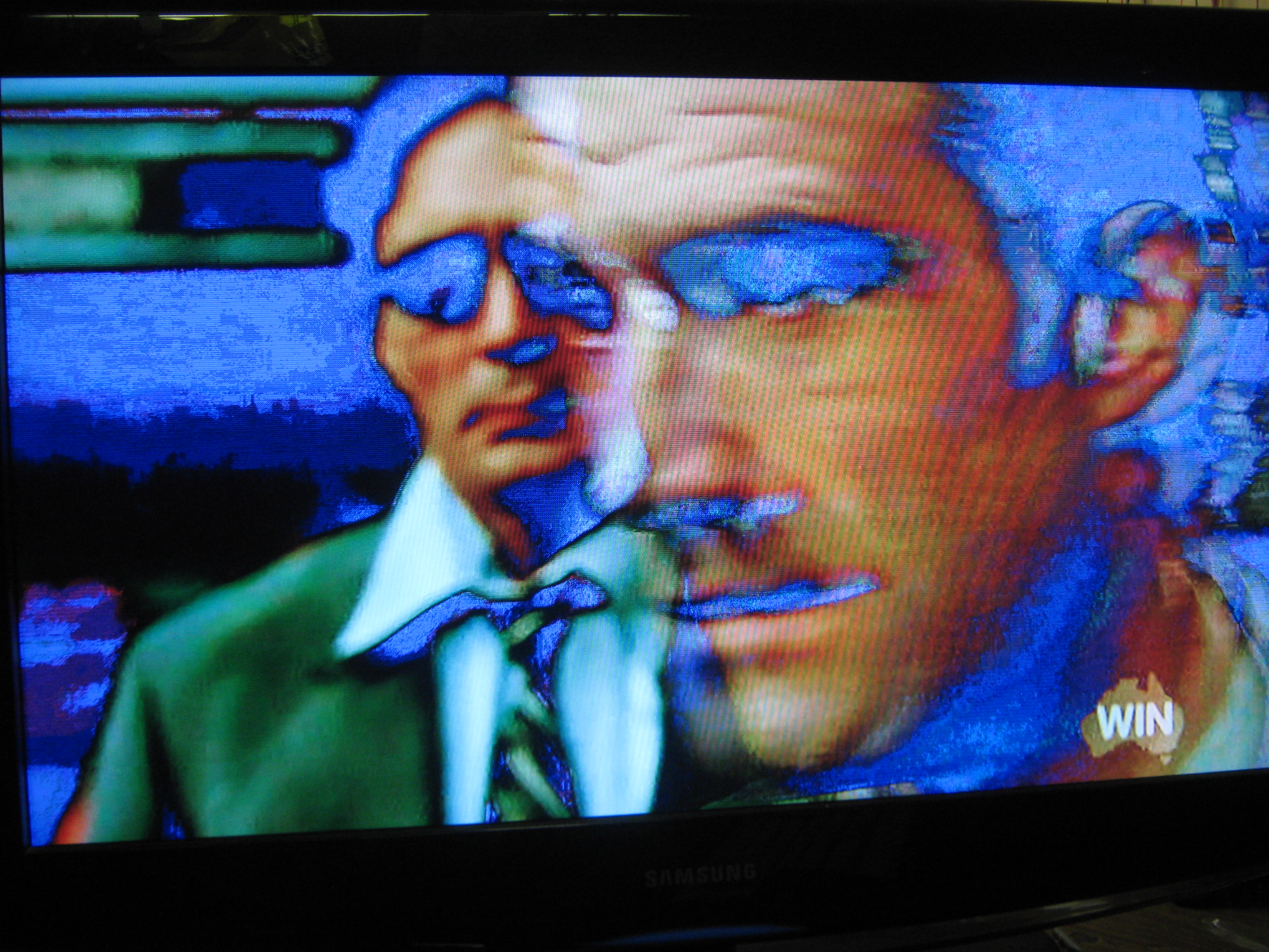

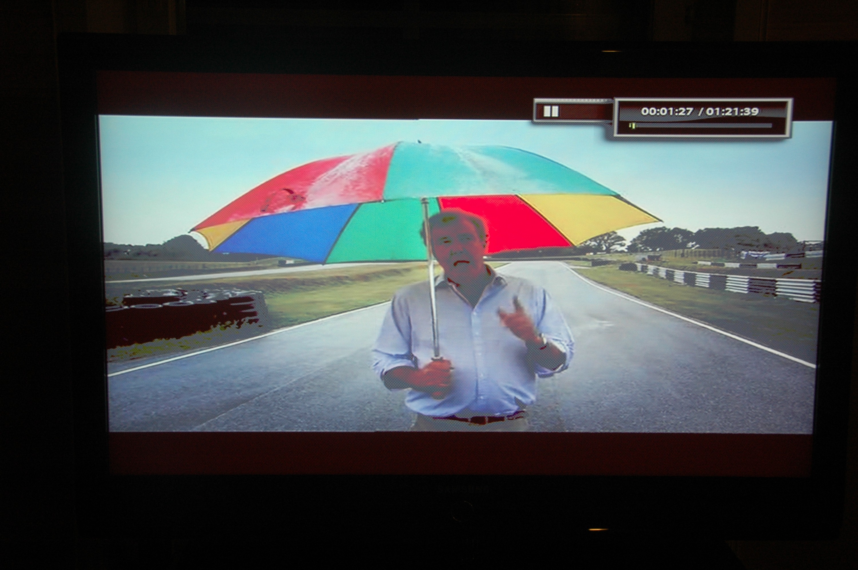

    --- And since a picture says more than a thousand words ---
    ...Here are four pictures where I tried to catch the problem, not really easy to get it photographed. And what's even more bizarre is that the TV picture looks better in my camera than what it does on the TV?
    Pics are; Ice age and Clarkson via RCA (from an old Xbox) and a 2x a local (French channel) in HD.

                        • magnusbjork
                          • Nov 2012
                          • 13
                          • France

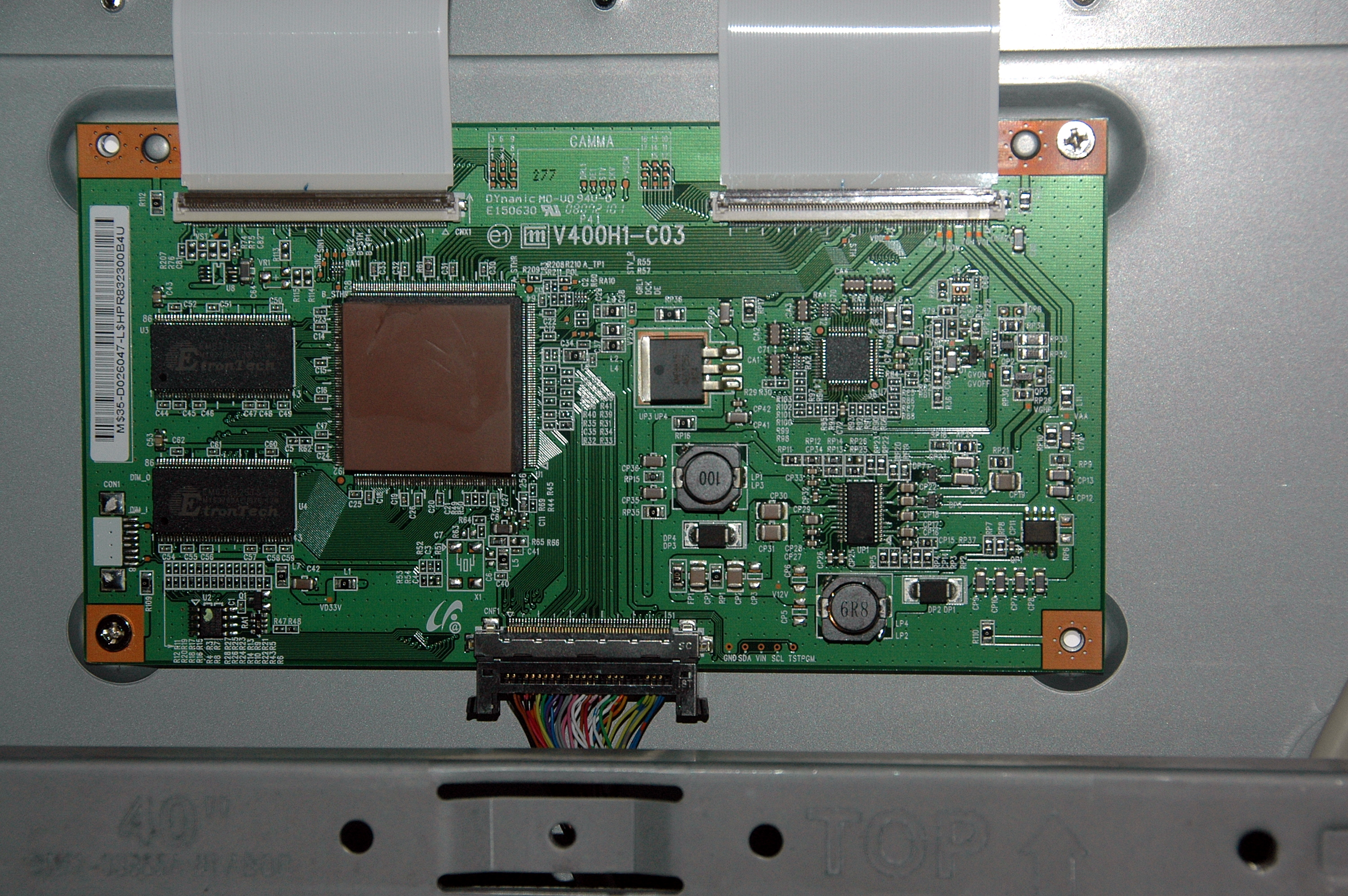

                          Re: Samsung LCD heat problem...?
                          Gurus,
                          I have found the place where the problem comes from.
                          Have a look at the two pictures attached, one is a general view of the rear of the TV, without the metal cover over the "display card" (?). The other picture shows the "display card". On this "display card" I found that the CPU (?) was getting quite hot. (The big IC with the heat transfer "rubber" attached.) If I heated this one gently with my heat gun the image quickly got really really bad. And then, when using the cooling spray on the same IC, *tadaa* the image got back to normal...!
                          I really can't tell why this IC (cpu?) was getting too hot... The primitive metal heatsink was having a solid contact when I had to pry it loose.
                          Anyway, what I'm going to try next is to simply re-use a CPU heatsink with an electric fan. I don't think I'll hear the fan from over the room. Perhaps another card would do the trick but if I can make it work with a simple PC CPU fan I'm quite pleased.
                          I'll keep you posted if it works or not.
                            We have seen this before, I think the CPU itself fails in some manner. If the CPU fan has no affect then replace the T-con. It's about £40 on eBay.
                            http://www.ebay.co.uk/itm/Proscan-LC...item51a3645dd9
                            Ask these guys if they have any in stock:
                            http://flattvparts.co.uk/index.php?m...ord=V400H1-C03
                            And a chi-mei panel in a Samsung, I am disappointed, I would expect a Samsung panel, though it seems to be the norm nowadays.

                            • kevinm34232
                              • May 2012
                              • 1884
                              Those images almost look like the 'negative' images we've seen before on here but no fix posted. Good to know that's probably the T-con board.
                                Dear all,
                                After fixing it my TV has now been working without any problem for weeks!
                                Thanks a lot to all for your help! In the end the problem did indeed turn out to be the T-con board. I'm guessing that probably there's (at least) one bad solder connection between the CPU and the board. (?) ...But since I found a cheap-ish replacement board from eBay, -thanks for the link-, I just went ahead and bought one from there to try.
                                Well, board installed, and all is back to normal, the picture stays perfect, even if it's running for a whole day!
                                Thanks again, hope this information can help others with the same problem!

                                • Techterry
                                  • Jan 2013
                                  • 2
                                  If that small square ic is an AS15F that is your problem seen it bad on several Tcons.
